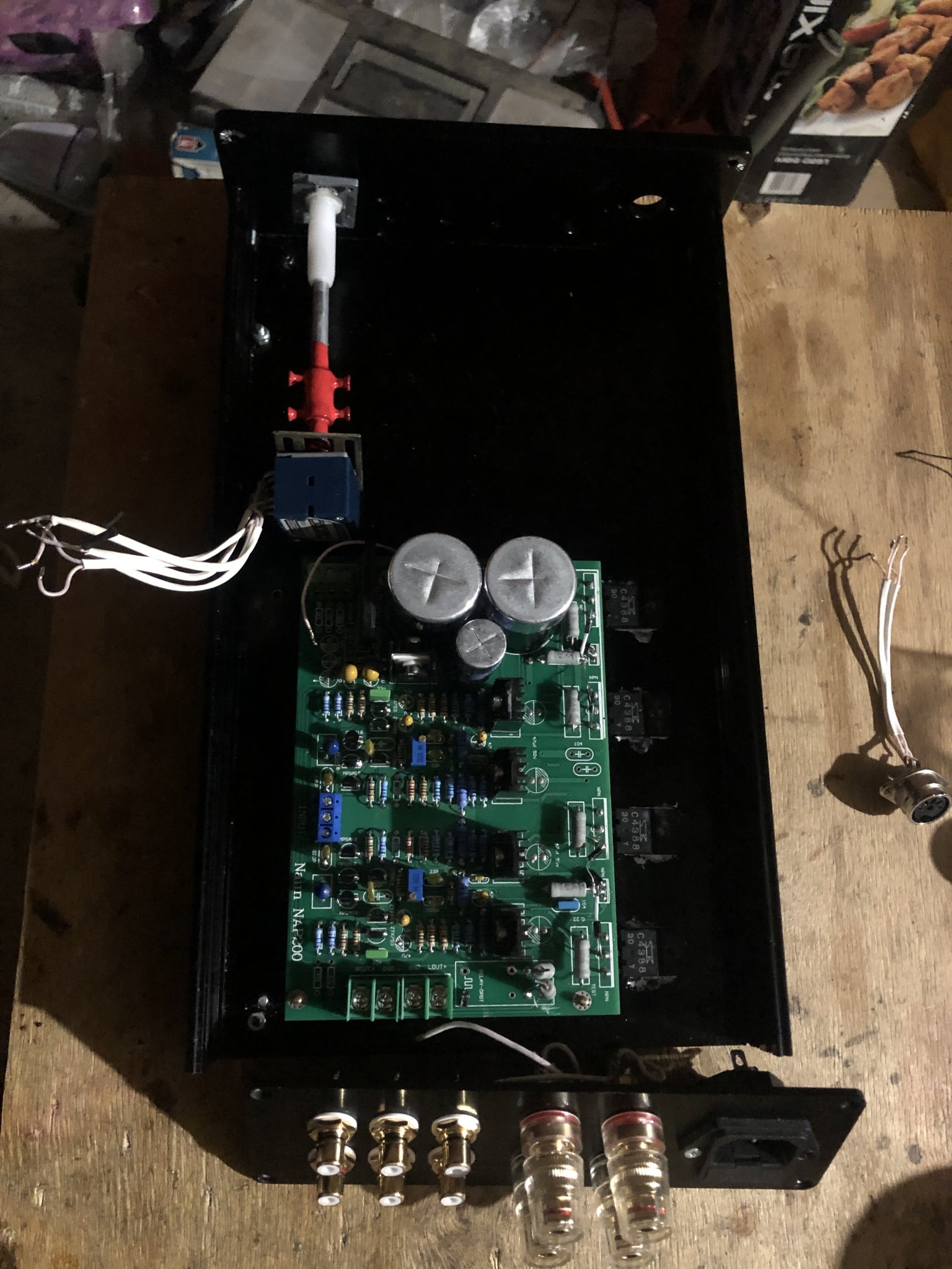

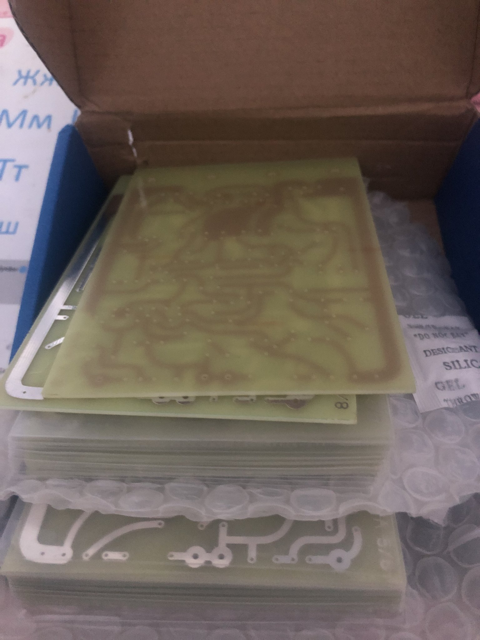

That's a challenge.....Marketing of re-issued 1970s design products like the original NAP series, would be very risky business in any country. Even Naim now have to produce a wide range of products, from showpieces like the Statement to integrated audio systems like the Uniti-Atom, in order to attract today's audio enthusiasts.
If you also want to supply your local market, surely it would be much better to communicate, deal and start up with a local manufacturer.
I don't know how large the market is for audiophile quality in the home. Over the decades it has suffered the inevitable tradeoff of quality for convenience. Mediocrity for the masses. Having physical space for hifi is a limitation for younger generations too.
But there will always be a small market of wealthy people who just want the best (what they are told is the best).

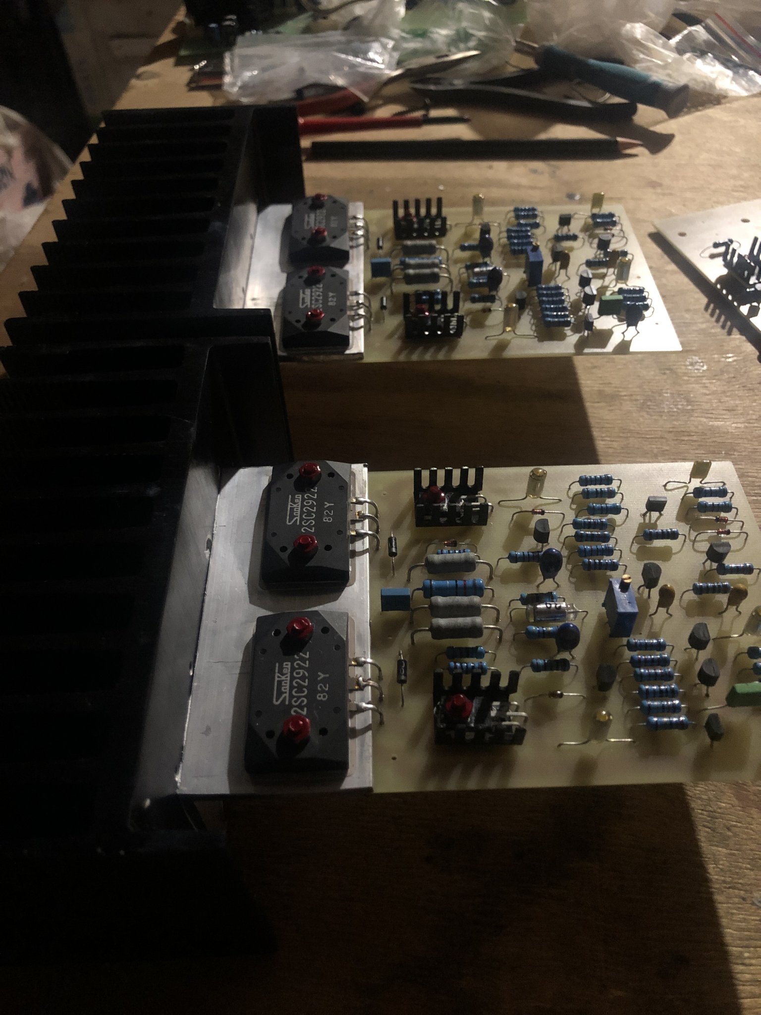

I wonder why the Naim Clones are so big with their PCB's. In the early years, same as in the Mini Crescendo in the Elektor Magazine, i can understand the reason why.
The components were bigger, layout programs very expensive. Talking about the eighties.
All copies offered from the chinese shops now a days are not 100% copies, i think. At some places on the pcb they take other componets or change them.
Has anybody exept LJM decided to make new, smaller pcb ? I must say... i dont read all the threads on 228 pages.
Is there a reason i dont know for bigger pcb's as for smaller ones ?
LJM has designed a Nap 250 Mod....very small and not my amp. Forget about it in my opinion....as i build it, it had only a flat response..loveless

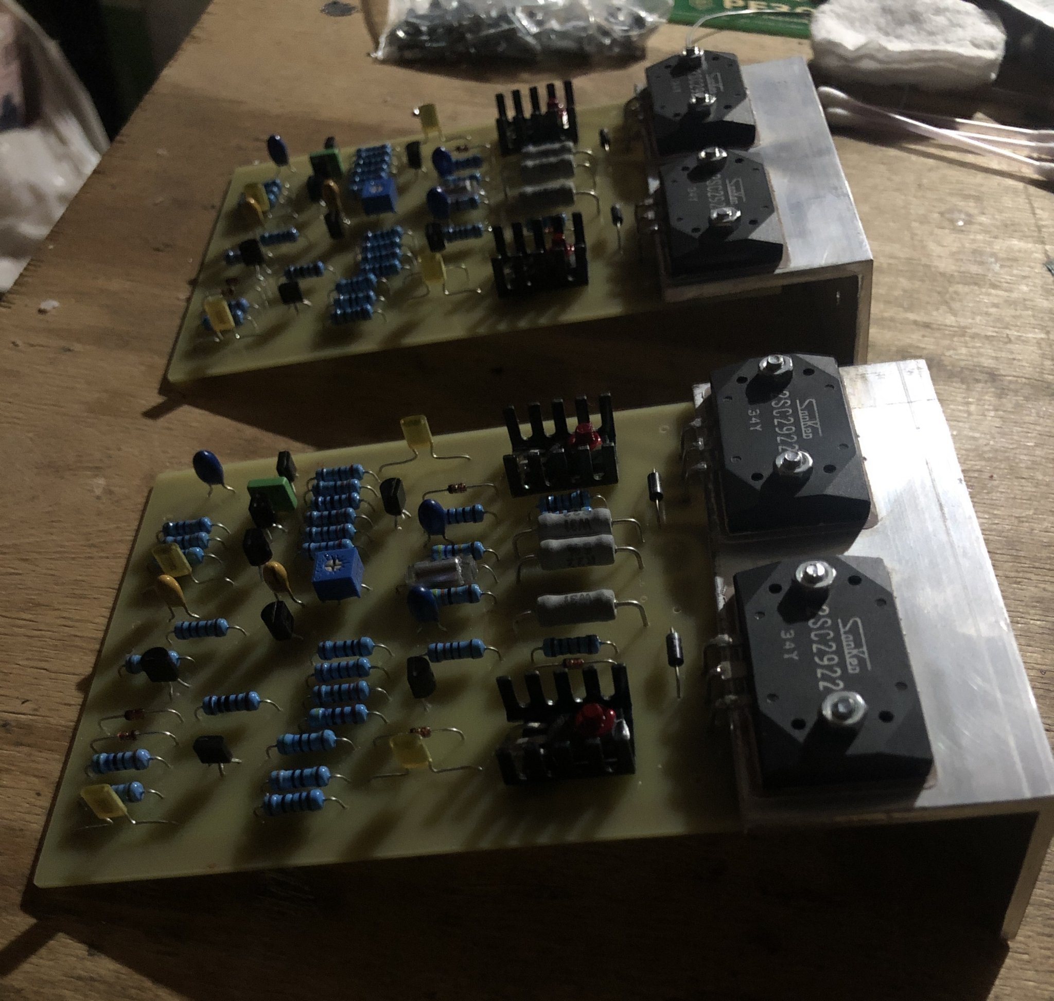

I will think the blue pcb will be a NAP140 Clone, the green one a Nap 180 Clone. There is no great difference between. I choose the NAP 180 for me. But not built it yet.
And for sure you need a PSU. I want to take a Connex SMPS +- 36 Volt, 300 Watt, I can adjust to +-38 Volt, nearly 40 Volt.
But a SMPS is not everyone's business. You can take a transformer 200-250 VA, 2x28 Volt AC with a dual linear powersupply or you search for somethig else.
I remember i have seen regulators for the Nap amplifiers. Dont know if only for the Nap 250 needed.
