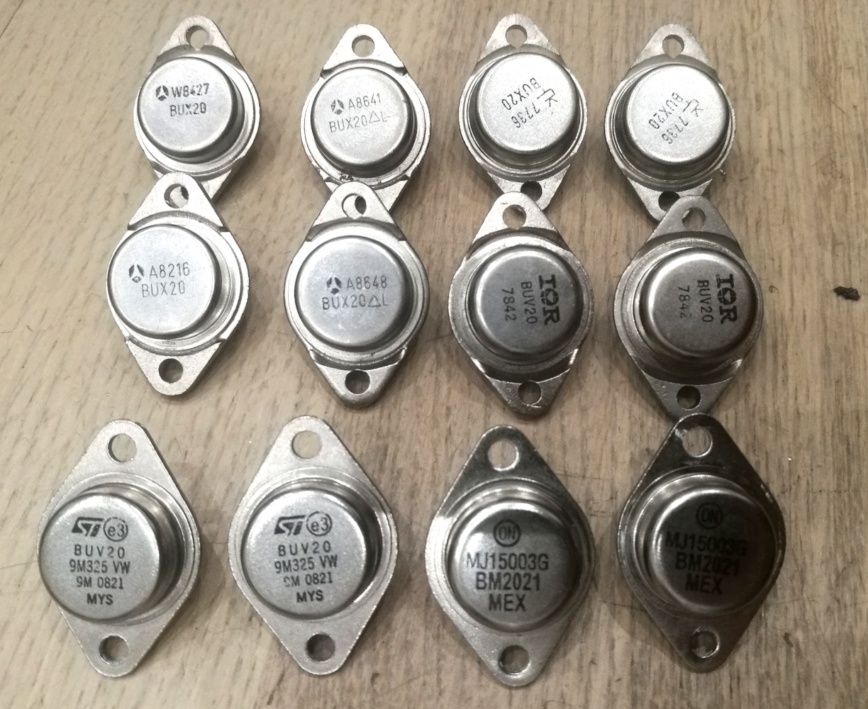

If you are testing with the same Ic and Vce the heat should be the same. Hfe 50 sounds ok but 150-220 is out of spec. Check your measurements.I run my tests with a collector current of 1.7A, HFE for double die devices was around 50. The single die devices developed more heat and gave a HFE between 150 and 220. The question is: which kind should I use first?
This is how I did my measurements: for each device I adjusted voltage to 2V across the 1R22 collector resistor. After 15sec the devices were so hot that it was barely just possible to touch them by hand. Vbe was at 0.65V for all devices, HFE measurement was taken across the 100R base resistor and calculated with the formula hFE=(VRc/Rc)*(Rb/VRb). The calculatings for the Sescosems and Thomsons gave around HFE=50, for the IRFs and STC 150-220: the double die devices read around 3.2V across the base resistor, the single dies around 0.9 Volts.If you are testing with the same Ic and Vce the heat should be the same. Hfe 50 sounds ok but 150-220 is out of spec. Check your measurements.

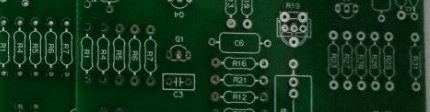

I had exactly the same problem with NCC200 clone boards. Dim bulb tester was like a disco light. After a week or so of trying I narrowed the problem to wrong resister value. See attached picture and double check the resistors in this area, it may help you.
Best Wishes

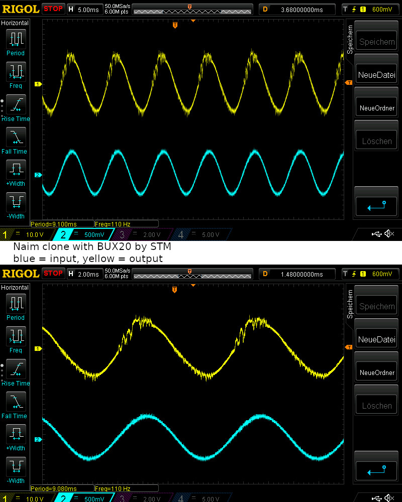

Today I tried various output devices with one of Jeffs boards:
All except the MJ15003s and ST BUV20s had a bad clipping like distortion:
The ST BUV20s are probably fakes, see earlier in this thread: at that time they sounded much better than the MJ15003s, but today it was the opposite: I had 8R2 and 220n (Wima MKS) in the Zobel and can say that this sounds way more Naim like than the previous 20R / 100n I had in place. The MJ15003s sounded thin in the bass and sharp in the top end, now with 8R2 / 220n everything sounds as it should.
Makes me wonder if Naim "customizes" the sound signature of their product range according to the price tag using different Zobel values...?
Also I tried with and without the CCS mod from the HackerNAP (split the 22k near TR3 to have 10k + 12k and connect the junction via a 3u3 film to -ve, with the 12k resistor heading towards ground): it was a nice improvement indeed, I will keep the mod in place!
My conclusion: forget the vintage trannies, use MJ15003s, the zobel makes way more difference, and consider the CCS mod...
