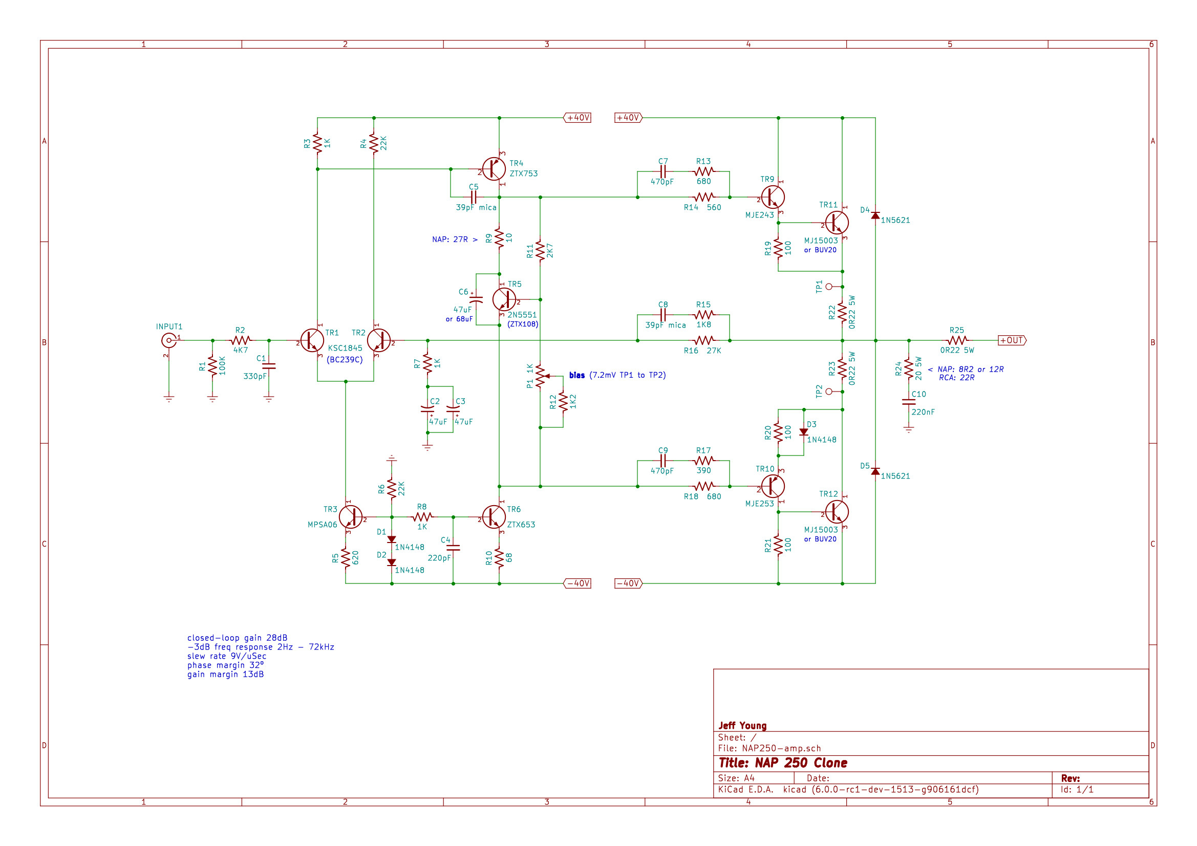

I'm looking at building a NAP250 clone. Since this will mostly be a nostalgia project, I'm trying to be fairly faithful to the original.
However, I won't have the volumes Naim did (for parts matching), and some parts production has since been moved to China (so I'm probably looking at greater variability to start with). The knife-edge stability of the original therefore has me a bit worried.
Here's something pretty dang faithful, but with the standard Miller compensation replaced by transitional Miller compensation (which seems appropriate as it was first proposed by Baxandall, who also has his diode in the quasi-complementary circuit):
It serves its primary purpose of improving the stability without sacrificing the slew rate, although I couldn't get the stability up much without introducing a lot of distortion. So the phase margin is still, well, marginal. On the other hand, the slew rate has doubled, and the frequency response has improved considerably.
Any thoughts on this, including what it might do to the sound signature?

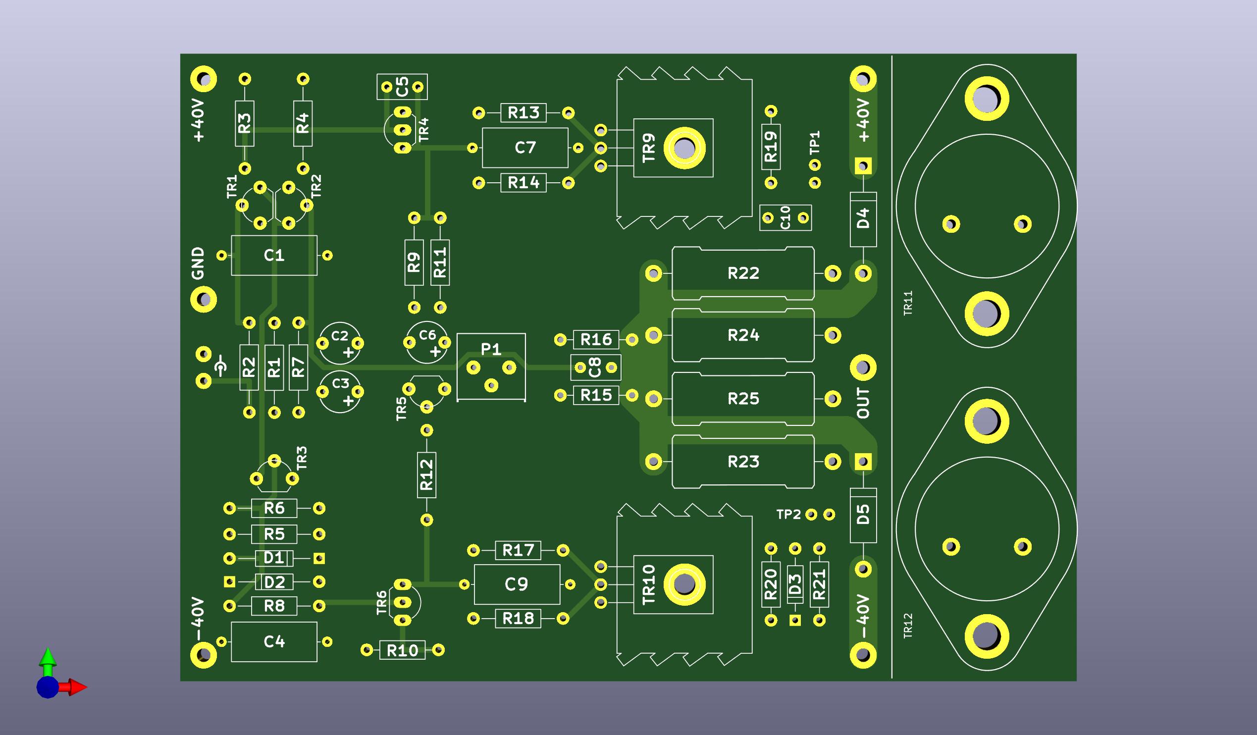

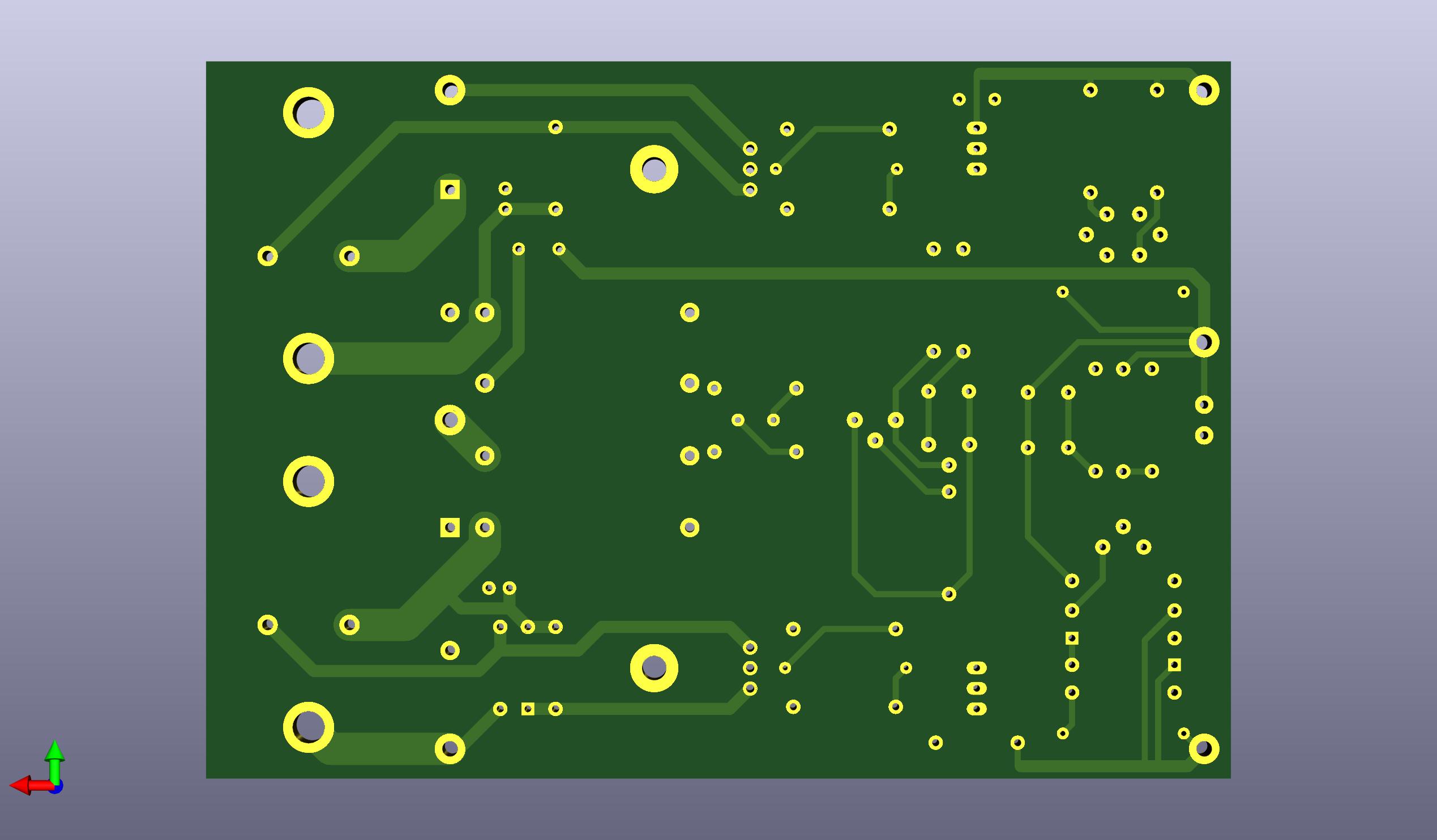

That's an interesting idea. The designs are similar enough that I could do a single PCB design on which either could be built....

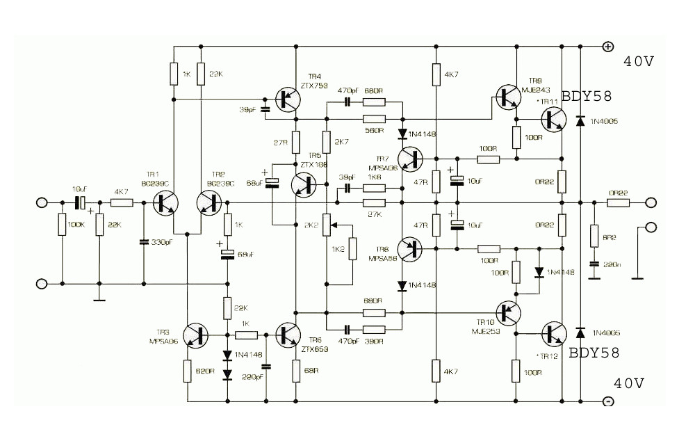

Hmmm... I did a bit more digging and my "original" I had cobbled together from the McBride, HackerNAP and NC200 schematics appears to have been a bit off.
This one:
shows slightly lower values for the Miller integrator and the phase lead cap.
Plugged into SPICE it doesn't do all that bad:
Only one number jumps out: how scared should I be of a 24º phase margin?

This one:
Code:
original TMC version
Phase margin 24º 40º
Gain margin 11dB 13dB
Slew rate 9V/uS 16V/uS
THD @1watt 0.011% 0.015%

Someone on pinkfishmedia pointed out that it's going to take a lot of finesse in the board layout to keep a 5p capacitor at 5p. Definitely gives one pause for thought.
Here's a 3rd version with 39p in the TMC. Even better stability, but you can see that the THD suffers:

original TMC/3pF TMC/39pF
Phase margin 24º 40º 50º
Gain margin 11dB 13dB 15dB
Slew rate 9V/uS 16V/uS 12V/uS
THD @1watt 0.011% 0.015% 0.028%

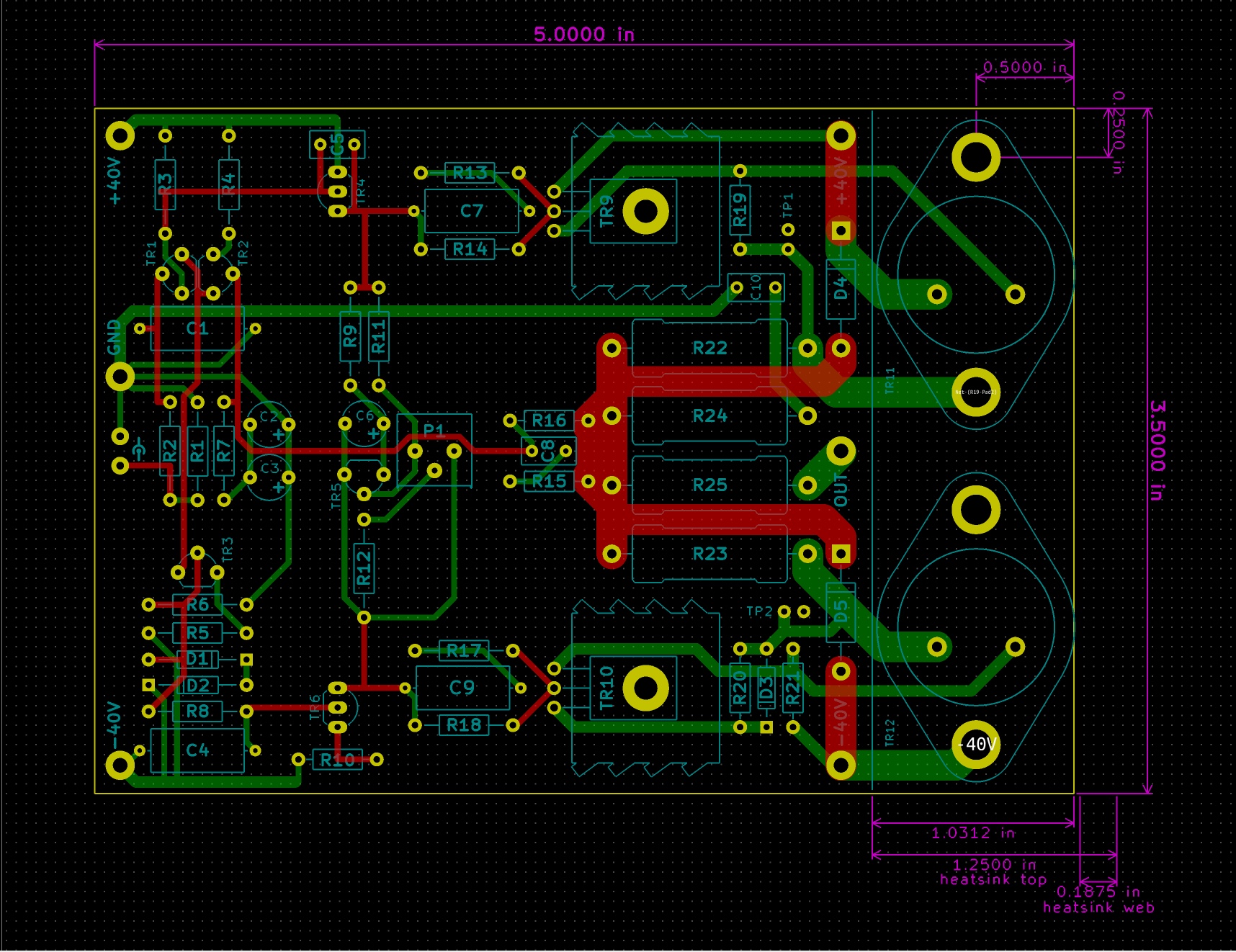

I love how varied this hobby is. Doing my own PCB layout is my favourite part, and finding the parts ranks up there in the top 5 (particularly if they're really hard to find).

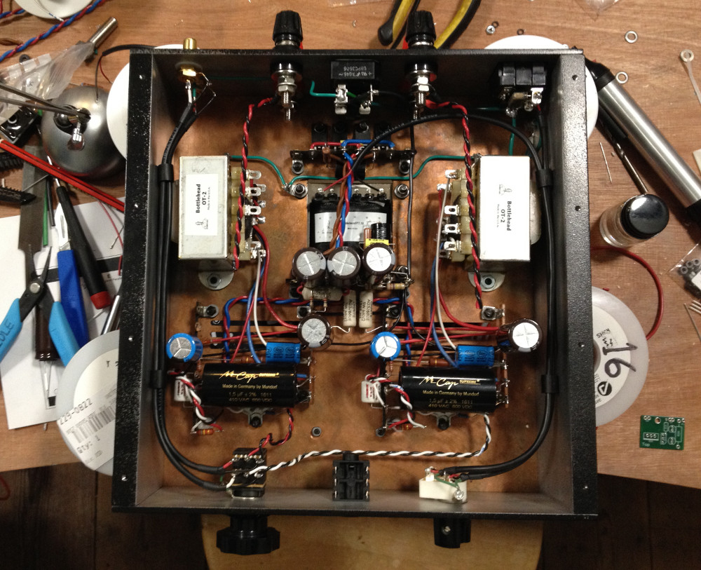

I do enjoy p2p. Here's my Bottlehead S.E.X. about 3/4 done:

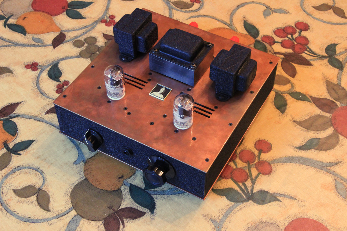

And finished (completely custom casework on this one):
