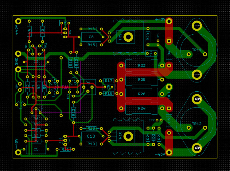

That's very impressive presentation and nice PCB work :).
Incidentally, the bias voltage between TP1 and TP2 should be approximately 2 x 7.2mV for a Naim clone.

Nice layout JeffYoung. 2 output transistor board is useful. I find it strange that all the kits offered by diyaudio store or vendors on vendors forum here are either class A, 10 W (ampcamp), 400 W (honeybadger) or vacuum tube. My point to point Apex AX6 was 70 W with one pair OT, but it took about 100 hours to build. 35 to 70 W is useful with 8 ohm 102 db @ 1W1m speakers in my music room. AX6 fits on a 3.5" X 5.5" card (external OT) as did the ST-120 PC14. Honeybadger is about 6 times the size.
You’ll need a dc blocking cap on the input. The dc resistance to gnd should be the same on both inputs. On the inverting it is 27k. In your schematic the non-inverting is 104.7k.
The input cap doesn’t need to be large, 10uF is plenty.

C10 must not connect to the input gnd on the PCB. It must be wired directly to the psu star ground.
Yep; already fixed that after a comment on pinkfishmedia.

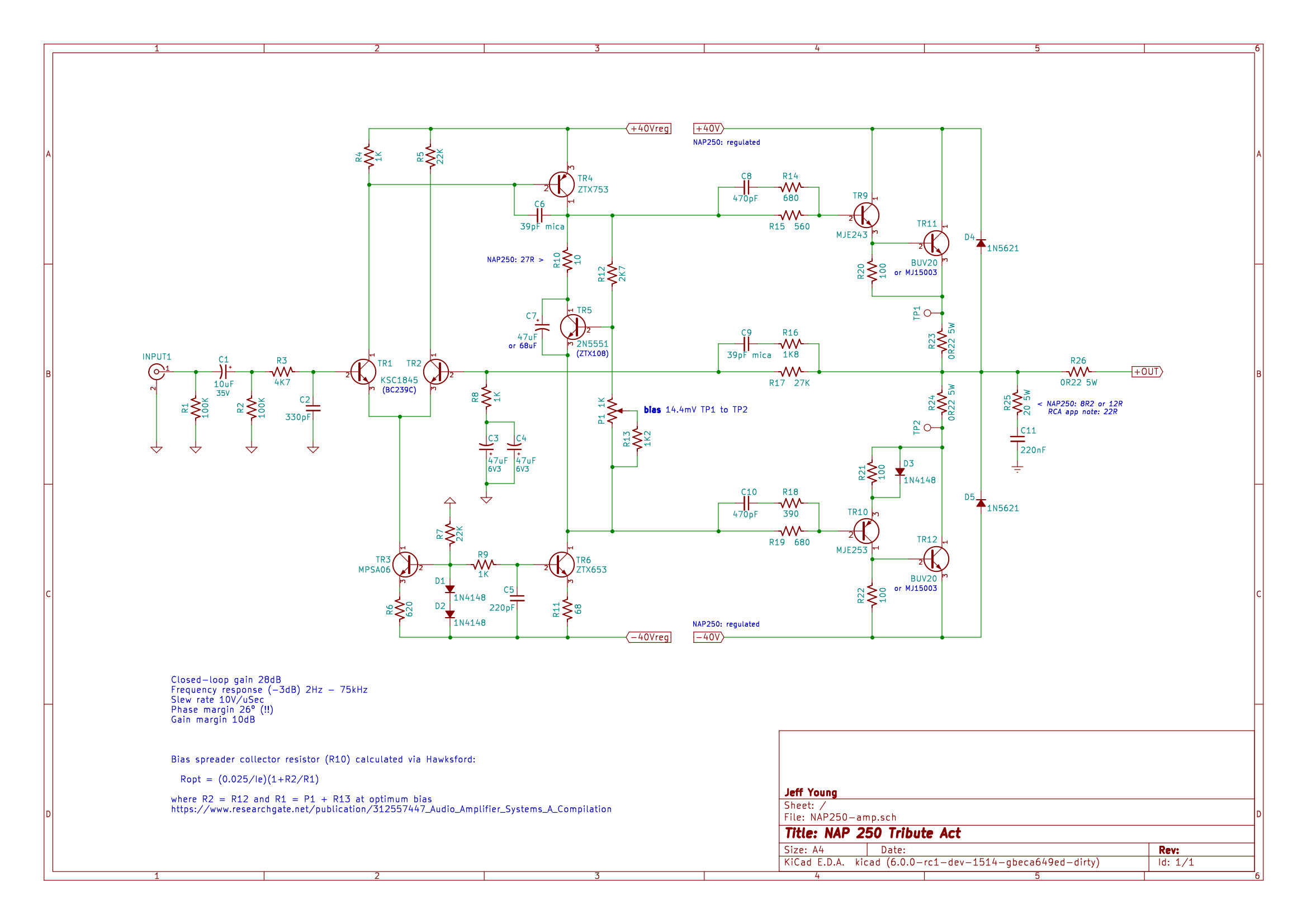

Draft 2:
1) separated IPS/VAS ground from OS ground
2) more copper for OS
3) replaced input coupling cap (with options for above-board tant or below-board polyprop)
4) added more info on schematic

What sort of preamp are you using which cannot drive 27k?
Higher resistor values in the signal path are ok to an extent but add more noise and less signal accuracy as the input stage sees a higher impedance. Up to 50k is probable fine. You would have to play with the feedback path capacitor to trim the phase response.
In draft 2, C1 is the wrong way around...the bases of the LTP should be slightly negative at idle if everything is properly balanced.
I’d put R2 the other side of R3 and make it 27k.
If C1, C3 & C4 are tantalums they need to be high voltage, like 25V or more. This is to do with making sure they have enough reverse voltage tolerance. I don’t think you need both C3 & C4...save some pennies and use one cap. 47uF is fine.
I’d use 47pF or more for C6 just to give some extra phase margin, unless you have the equipment to measure the real circuit. Don’t take a simulators word for it.
