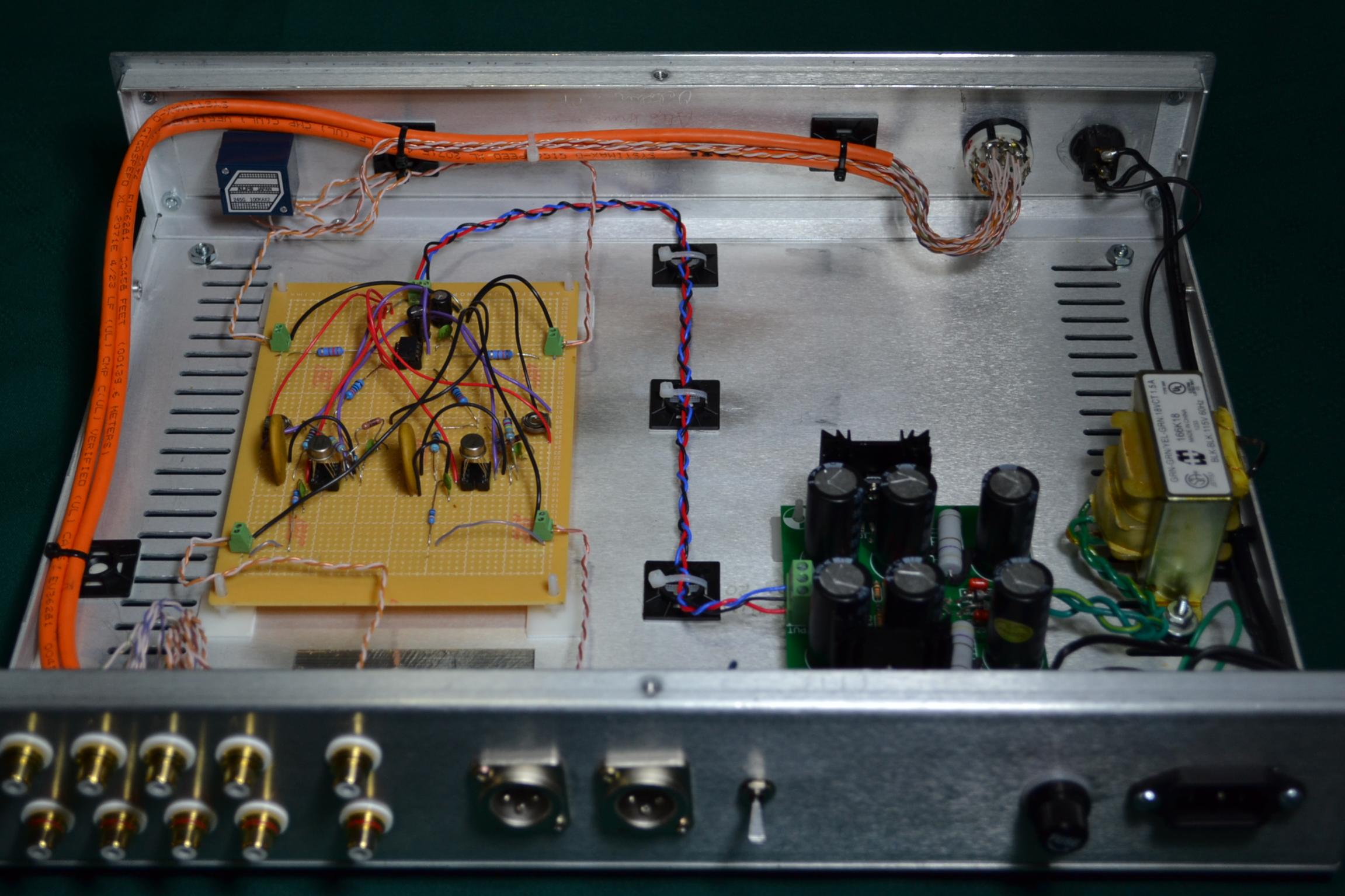

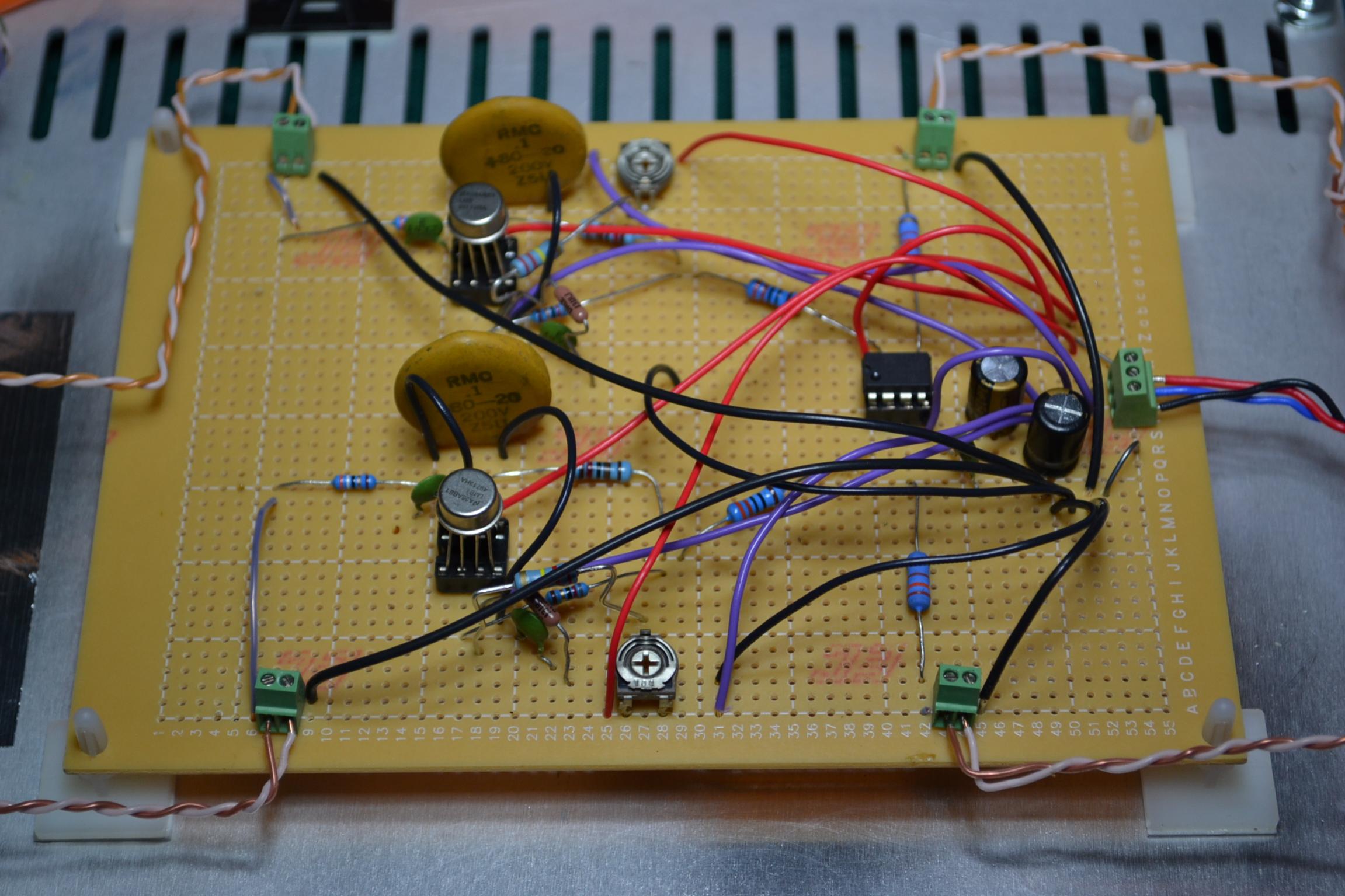

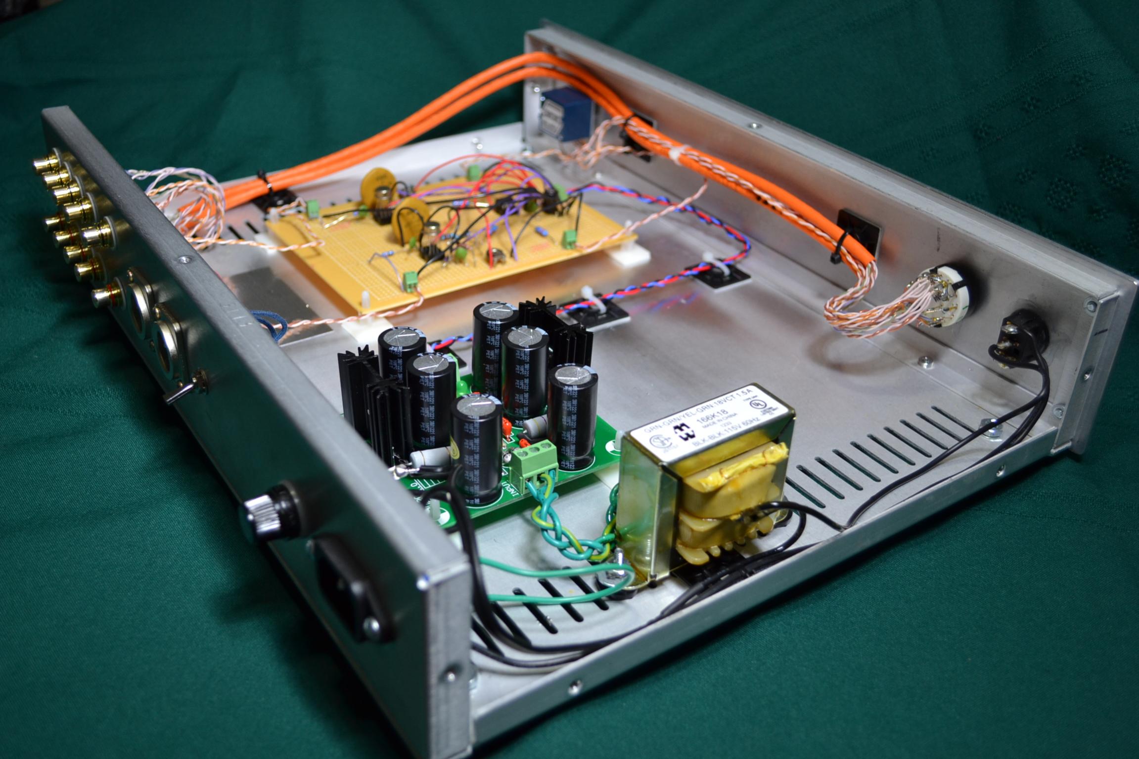

Here is the final product pictures, only measurement I took is of the output offset which is easily dialed to 0.0 VDC. I am sure it will drift a bit here and there as things warm up and cool down, but not by much at all. Maybe tomorrow I fire up the scope.

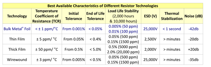

About the overview of different kinds of resistors - thanks for posting it - what do they mean by thermal stabilisation? Another thing I don't quite understand is the noise levels. Is this excess noise @ a certain current through a defined resistance? And how can noise be +20 dB? Against which standard? So many questions, so little time.
Don't use a carbon composition resistor unless the duty demands that ONLY carbon composition can do the job.
ultra low inductance, provided the size of the carbon comp does not increase the loop area too much.Do you have an example where carbon composite would be better than for example thin film?
Yes, metal films are spiraled so they have some inductance.
There is a way though to make low inductance metal film.
The bulk foils are low inductance too because of the etching pattern.
Wirewounds can also be made low inductance with bifilar winding.
I think the noise level is excess noise.
That is the extra noise above the Johnson noise.
I do not really understand that list too.
What is 0dB then ?
Thermal stabilization may be the time it needs from when you put voltage over the resistor until it reaches the nominal value.

Whaleman, looks great except for the input wires all being bundled together. There may be substantial crosstalk when a non-selected input source is active. I recommend using shielded cables for each input wire, but only grounding the shield at one end. Then you should be able to bundle them without a crosstalk problem.
Whaleman, good to see your nice piece of work from the inside. Have you listened to it yet?
I am just starting to get some time in front of it. The attributes I've heard so far is that is quite revealing, very fast, lots of clarity and separation. I have heard some very low bass notes that I had not heard before, it has very good and wide frequency range. It does not glare in any area, but being very fast, loud transients can startle. I think it is a tad better than the 49720, but like Bob said, proper implementation is key. Specifically input impedance.
Those CAT6 plenum wires are "supposed" to be x-talk resistant. But I know I could do better with coax shielded type to prevent the x-talk that does still happen. I just like these too much and have a couple hundred feet spool. If you all turn me on to some small signal coax that does not cost too much, I may just switch.
Maybe tonight the pre sees the scope again.
