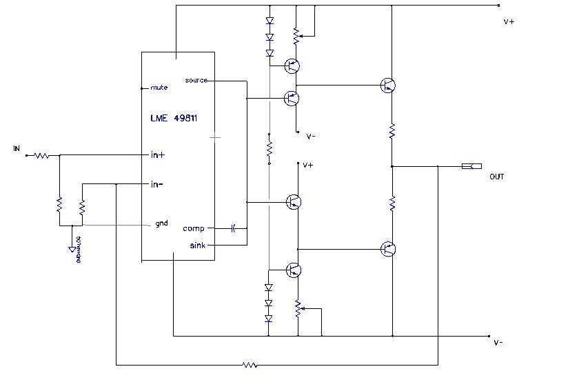

Audioman,
Is it possible to short circuit sink and source inLME49811, and so, to use it as a super opamp.
bobodioulasso said:Audioman,
Take a look at figure 3 on the PDF.

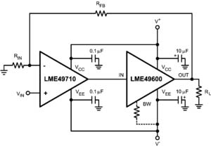

49722 gain section 49600 buffer

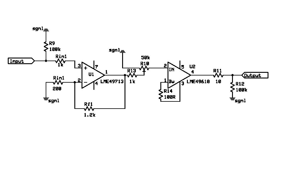

I got this reply on another thread on the same subject. I'm planning on building it this week. Is there a better way than the schematic I've posted?klewis said:Mark,
I've taken a shot at a preamp with the LME49713 and the LME49610. Would this work? or would it be better to follow the 49713 with another 49713.
Thanks,
Ken
"One of the things to watch for in low noise bipolar amps is the input noise current density. That can easily swamp input noise voltage in moderate to high impedance circuitry. The LME49713 data sheet lists a whopping 16 pA per root Hz at 1KHz. The 49713 also shows a typical input bias current of 1.8 uA, which means that the input bias resistor can create a significant IR drop at some settings, the effect of which will cause a varying offset ranging from a few millivolts to around 50 mV (which will be amplified by the DC gain of your circuit) as the volume is changed. The choice of 50K for the “volume” pot may not be the best choice given those facts. Something closer to 5K may yield somewhat better results. I don’t know how much of an improvement the LME49610 would be in this regard, given similar input bias currents and a mislabeled input noise current graph in the data sheet. [/B]
The 49713 is a current feedback op amp -- it will drive a low impedance load with enormous bandwidth -- start with a feedback resistor of 820 ohms as suggested in the data sheet -- i would use a much lower value potentiometer ahead of the buffer.
the LME49713 is surface mount -- you can get an aries adapter if you want to go DIP-- DK carries both.

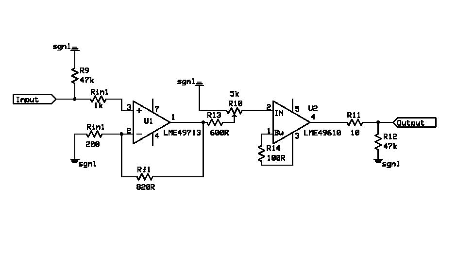

Hi Klewis,
i am very interested to see what you develop. I have plans to implement the same opamp as a buffer but have not had time to begin the project. i am still working on the power supply.
i saw that jackinnj said that the data sheet recommends starting with 820R. It seems to me that it recommends 1.2K as you originally implemented. With a 800R resistor the gain goes up by a couple of dB in the higher frequencies. jackinnj knows a lot more than me so i would trust him but i would be curious to understand his suggestion better.
also, this is what the data sheet says about changing the value of Rf
"In addition to reducing bandwidth, increasing the feedback resistor value also reduces overshoot in the time domain response."
can someone explain what they mean by "time domain response"?
i guess that for the purposes of audio we may not care about gain changes at frequencies several orders of magnitude higher than 20khz, but we do care about overshoot in the time domain response.

Okapi,
I've ordered the parts and hope to have it running this weekend. Wish me luck.
I also saw the reference to 1.2k, but, if you look in the graphs, they also show the response with .8k Rf resistor.
I was reading from the 2007 preliminary datasheet -- my error -- since that time the device is also available in the HA (metal can) package.

Klewis as far as using the LME49600 after the LME49713 only do that if you need more than 100 ma of output current. The 49600 will do 250 ma and the 49600 100ma. Both parts are built on the same process but the sonic qualities of two 49713's in series will be slightly better than a 49713 and a 49600 in series.
OKAPI As far as the feedback resistor goes for the LME49713 we found that for audio a 1.2k to 1.5k resistor works quite well. The apps engineer on that part did quite a bit of testing checking HF peaking with different feedback resistors (gain vs frequency on page 8 of the data sheet-top left) and that range of values was what we ended up using in our audio designs. That is also the same value suggested for the AD811/AD9610 CFB opamps that I previously used in all my audio designs. By the way if anyone wants to buy any of those I have 800 never used AD811 dips in my parts cabinet. Even have some of the metal can AD9610's (dual die hybrid F16 low lever radar mil spec part) that have been out of production for a long time. Those were $300 each when I bought 100 of them over 20 years ago when I owned my own audio business and use them in my highest end designs only. That was the metal can part we went after with the LME49713 metal can.
