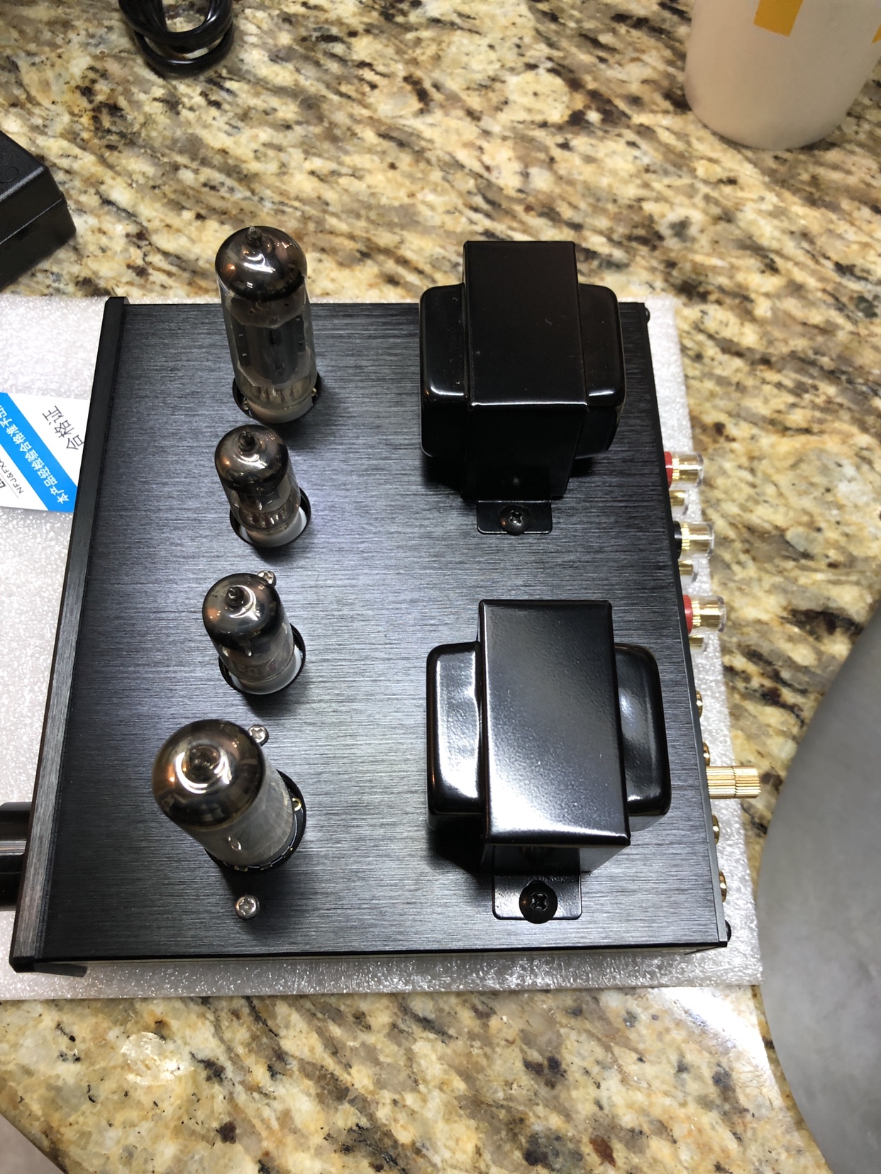

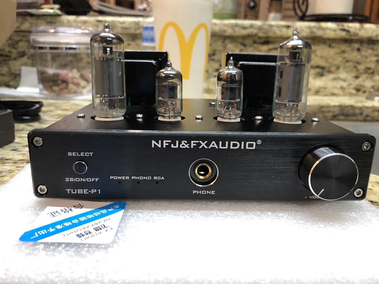

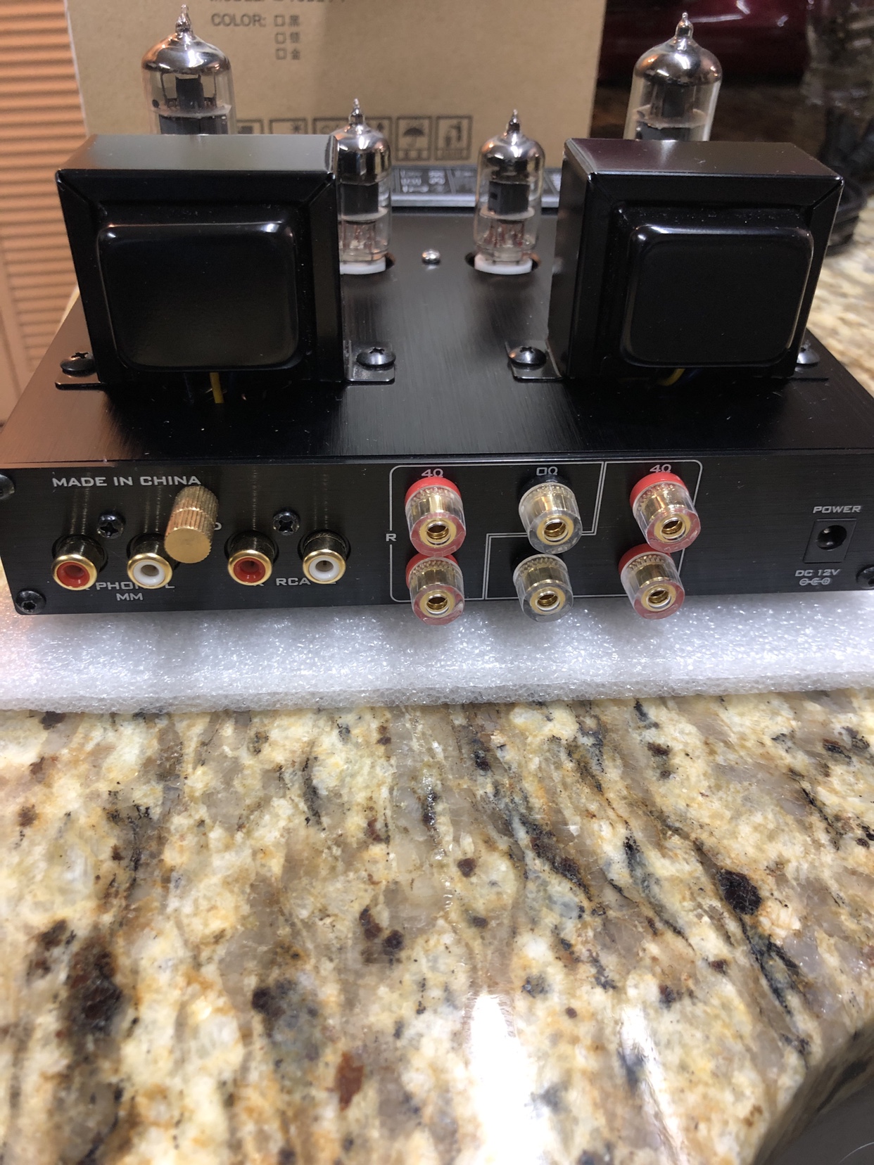

carlthess40, this is the main thing that you like it 🙂 I needed a tube amp kit for my project. The discussion went in such a way that the new kit was eventually developed 😉
So you want one that you can build? Ok sorry. I got this one as it was turn key and has a turntable input and I can roll the tubes if I want to play with the sound
