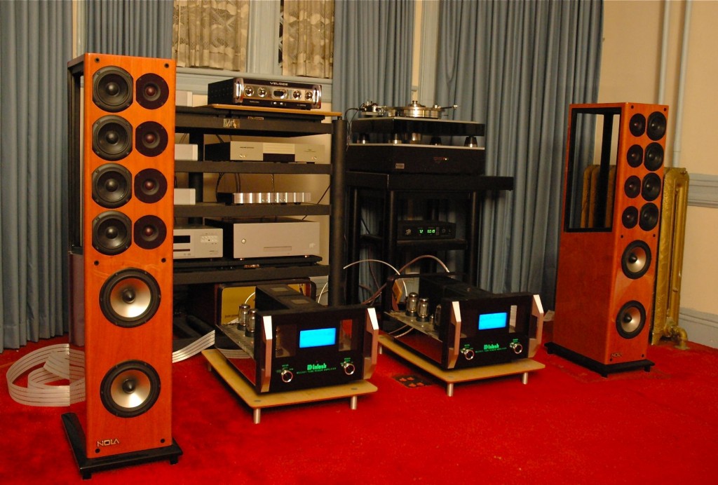

I'm repeating myself here, because I mentioned this in another thread, but here's some random observations:
1) I heard these at CES in 2016, and if you had a blindfold on, you *would* think these are $5000 speakers. They sound really nice. I'd rate them as better than 90% of what I heard at CES.
2) I took some pictures up close. I believe the woofers are Tymphany TC9, and the subwoofer is a Dayton Reference 8" subwoofer. Yes, it looks like everything you need to build this setup is from Parts Express.
3) My only real complaint with the speakers is that they had them *really* far from the walls. That allowed them to image like crazy, but I also heard a touch of harmonic distortion. Not a lot, if anything the distortion may have been adding some euphonic glow to the sound. (Carl was using tube amps.)
To me, the most interesting part about this design is that it bested some of his other designs. Which are way, way more expensive and complex. Here's my hunch: In the other Nola speakers, the designer sometimes have to resort to horizontal arrays. And we've all seen the polar response on horizontal arrays, it's pretty bad. So I think the designer hit a 'sweet spot', where the TC9 has wide enough bandwidth that we can basically get away with using it as a tweeter.
Here's one of Carl's designs, to illustrate what I mean in the previous paragraph
I've built my own 'homage' to the Linkwitz dipole, and I think Carl's design sounds better than mine.
But definitely highly recommended! As far as cardioids go, I think the Gradient Helsinki is still the best I've heard, but for a fraction of the price, Carl's design is awesome.

I've been kicking around the idea of a Nola type speaker for quite a while now. It's all started with Wesayso's line array build combined with my appreciation for OB. I've acquired over 60 TC9s now to do a line array OB/sealed configuration. Top 8 drivers and bottom 8 drivers sealed with 12 OB in the center of the array. Was gonna do something similar to Wesayso but couldn't get my mind arrayed way from OB and couldn't wrap my mind around the laminate style enclosure. I know it's a bit of a departure from the Trio Brio but maybe I'm on to something.
