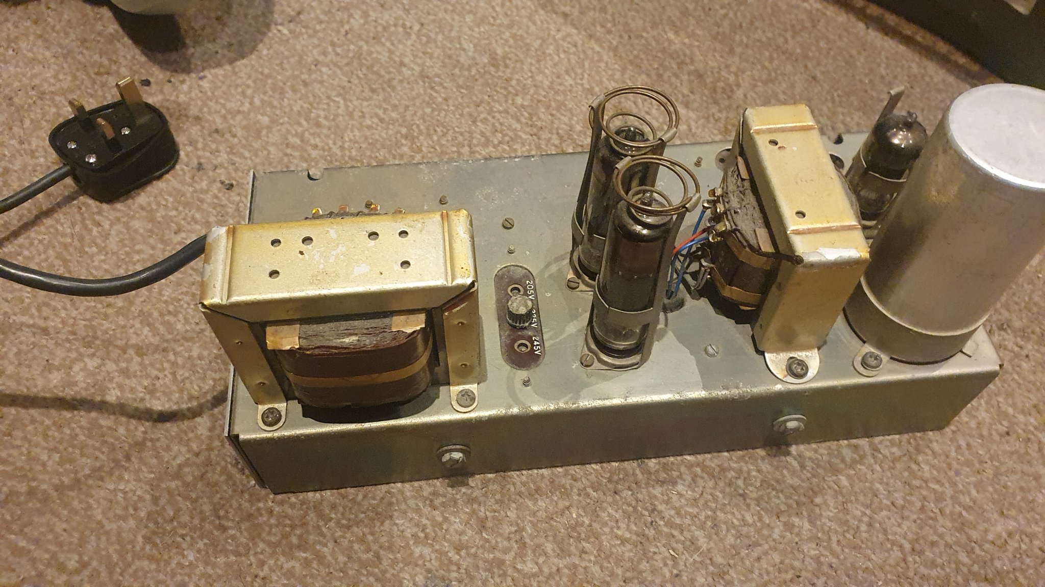

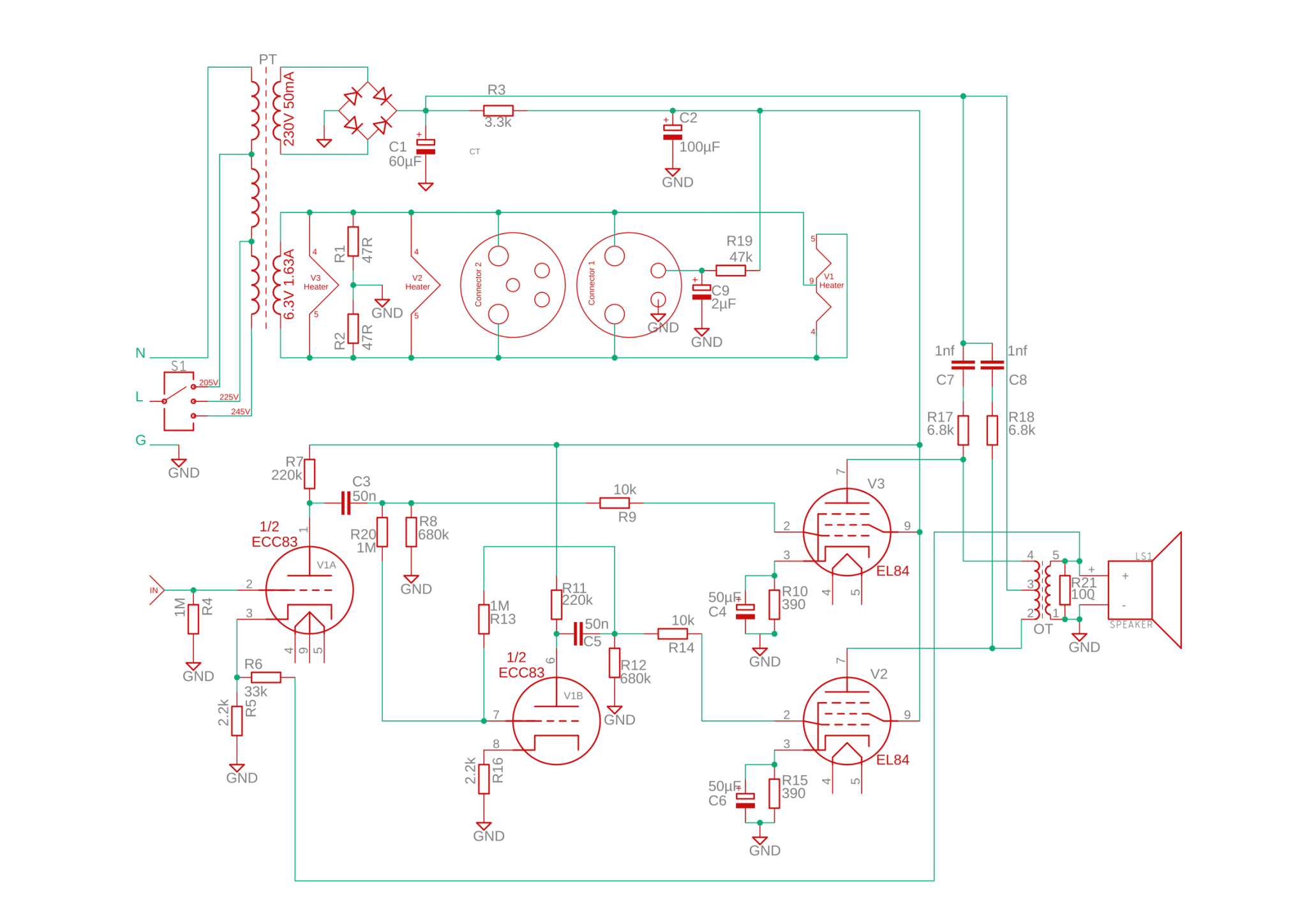

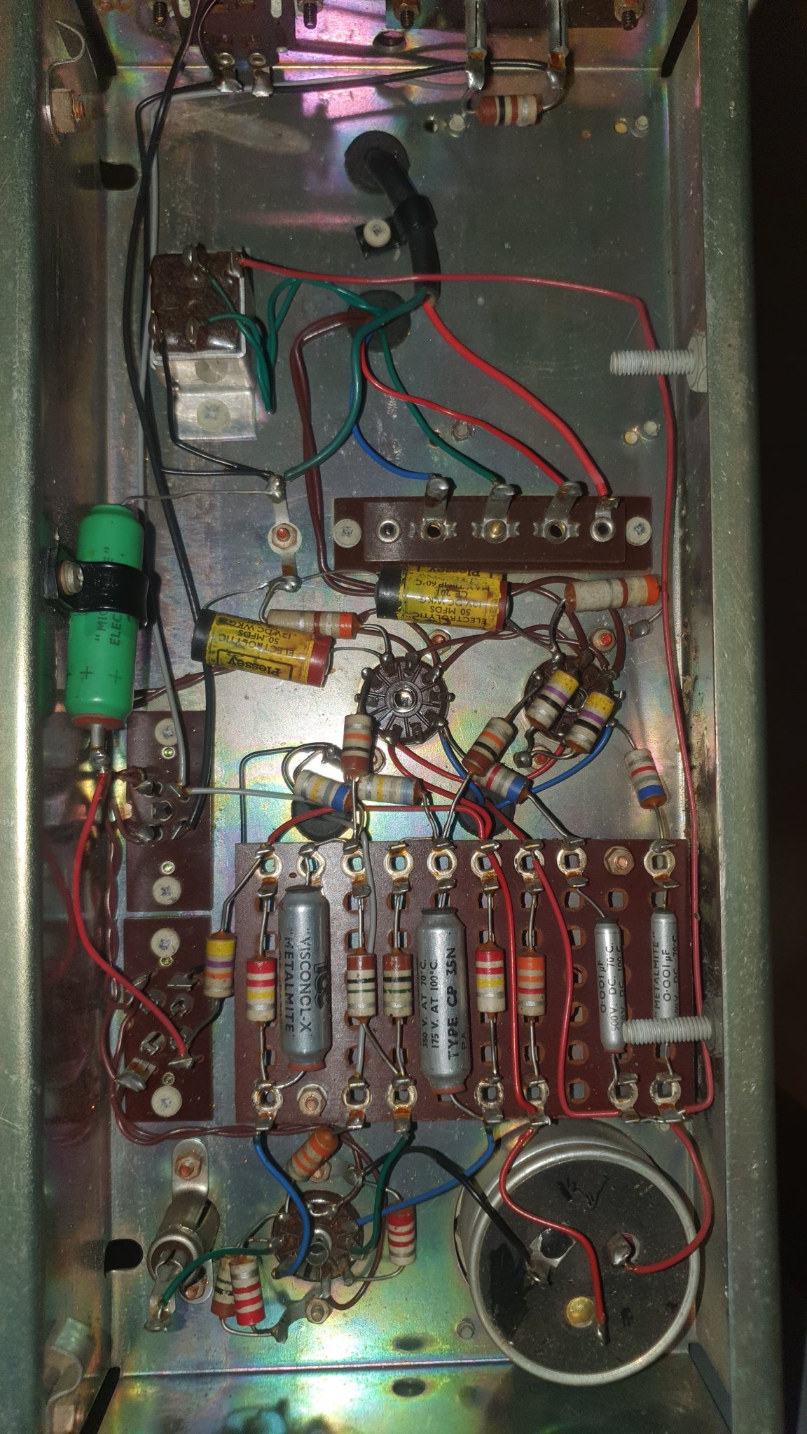

I recently got my hands on an EL84 PP valve amp output stage chassis (from a Dynatron Cavalcade GR1, I believe) and would like to turn it into a guitar amplifier.
Can anyone recommend any resources that would help me design a preamp for it? Or would it be better to just copy an existing design?
I have attached my attempt at tracing the circuit, along with some pictures of the chassis (please ignore the duplicate heaters).
Also, just out of curiosity, what are the two EL84 plate capacitors for (C7 and C8 - the two silver caps in the lower right corner)?
Many thanks,
Alex

It’s a zobel network - on the primary instead of the secondary. You WANT those on a guitar amplifier, to prevent HF peaking which can fry the transformer. It can get to kilovolts, especially if you try to run without the speaker. The 100 ohm load on the secondary helps with that too, but does consume a little of your power at all frequencies instead of just the way upper end you don’t need anyway.
