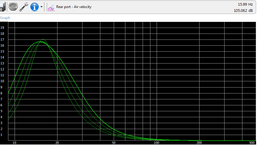

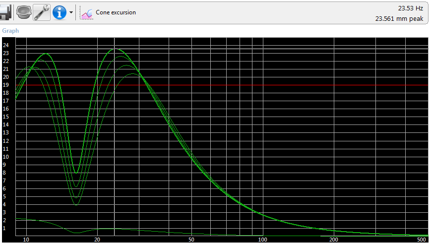

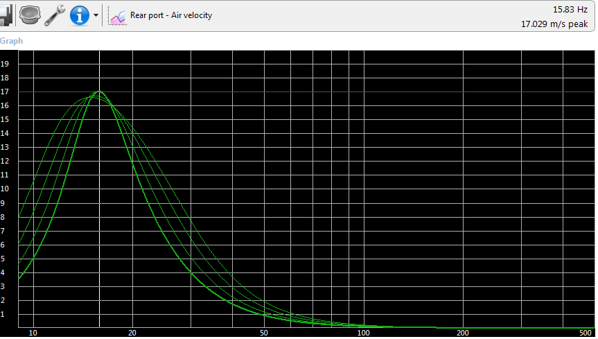

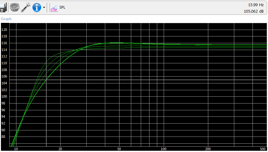

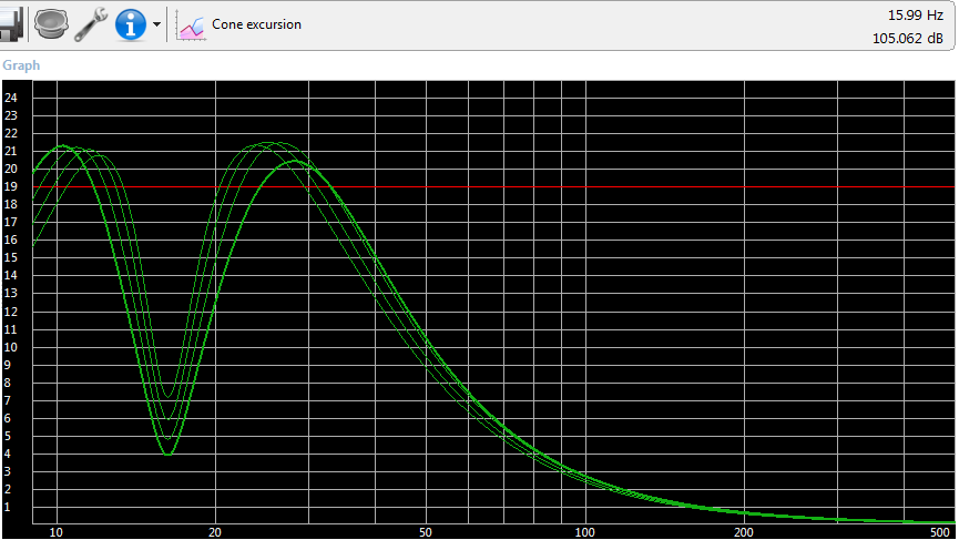

11ft3 is just one particular (auto-generated) alignment AFAIK. It can recommend nonsensical values, depending on the t/s parameters of the driver. Also on the page is the following recommendations:
Here are 4 sizes in winISD, all tuned to 16.2hz, excursion peaks matched in level via highpass, then excursions limited to approx xmax+10% via power, vents sized to keep max velocity under 17m/s:
15.2 ft3, 110.5db, 650w, 17.0hz, 7.6"x25", 1125in3 (.65ft3), 271hz
11.0 ft3, 108.8db, 725w, 17.0hz, 7.0"x31", 1193in3 (.69ft3), 221hz
08.0 ft3, 107.0db, 800w, 17.0hz, 6.3"x35", 1085in3 (.62ft3), 192hz
06.0 ft3, 105.0db, 800w, 16.5hz, 5.7"x39", 0994in3 (.57ft3), 172hz
read as:
net volume not including port/materials/bracing, db@16hz, Power required, highpass (2nd order bw), port dimensions (diameter x length), port volume (air only, not including material), port resonance frequency
Note I am not promising these vents won't 'chuff''; I don't know how to work Flare-It well enough yet to tell anything, so I am just simplifying to 17m/s max velocity. Insert dog-at-keyboard meme here because I'm an amateur 😛
TL;DR: it takes ~15ft3 to get 'flat to 16hz', and is a cs3/cs4 Chebyshev alignment for whatever that's worth. Something significantly smaller may also fit your needs. If you are still considering going big; how about a riser platform for a rear seating position? Gets them closer to you as well as a way to 'hide' them.

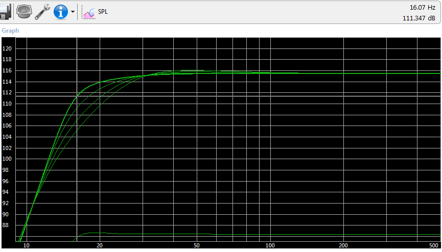

If they can be ran significantly past xmax, here is what the bigger boxes look like at the full 800w rms. Not much different. I didn't recalculate the new port volumes. 8 and 6 ft3 stay the same as above.
15.2 ft3, 111.3db, 800w, 8.0"x28", 242hz
11.0 ft3, 109.1db, 800w, 7.1"x32", 215hz
P.s. I didn't have 'simulate voice coil inductance' turned on for any of these, but they don't look any different under 30hz either way. Also, being winISD, these are 2pi outdoor-on-the-ground models; room gain + corner loading would boost the lowest frequencies significantly. So ignore my flat-to-16hz comment above 😉
