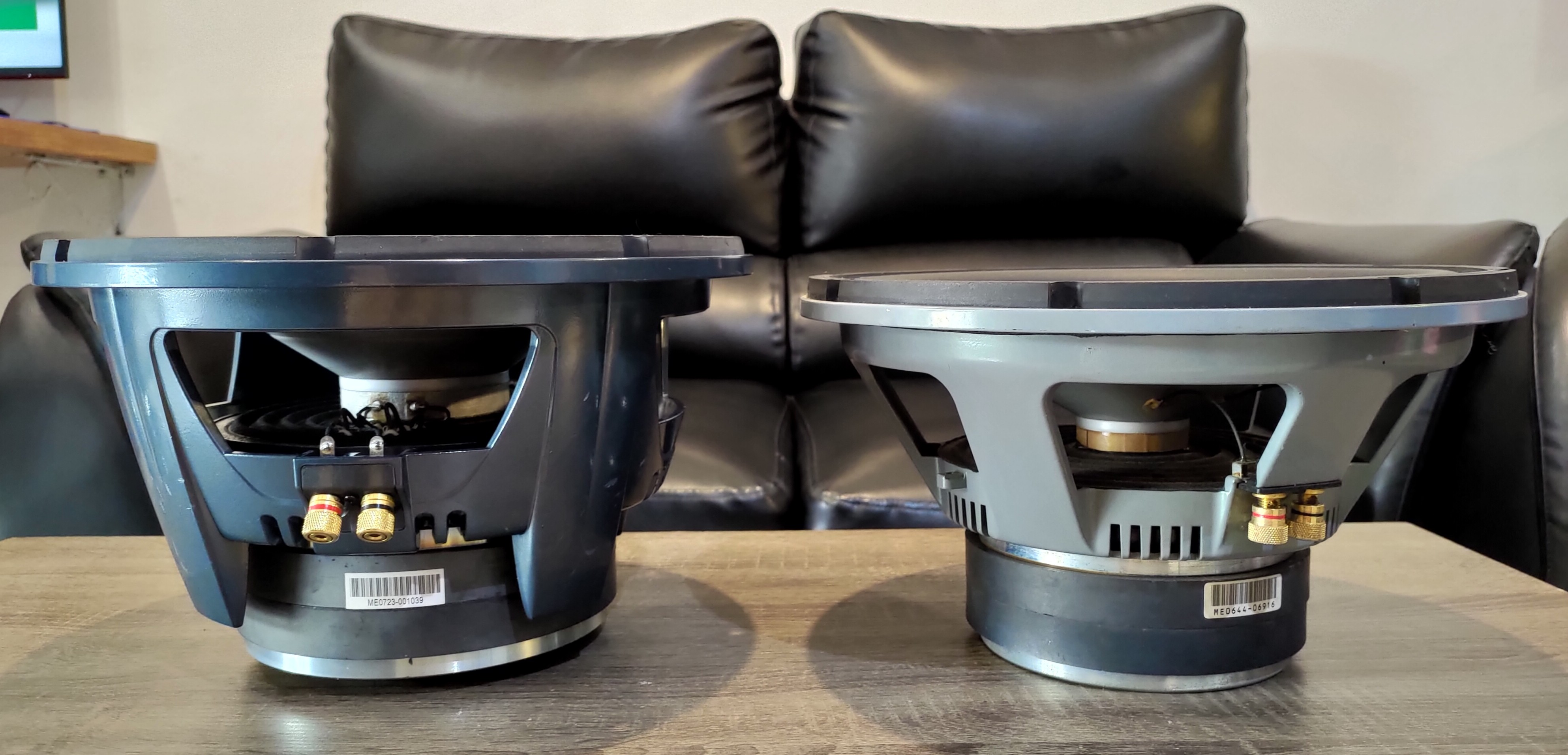

indeed, what a beast. i thought they are all the same basket/magnet but in fact 12 VQ is a totally different driver compared to other series (12 / 12.1 / 12.1d)

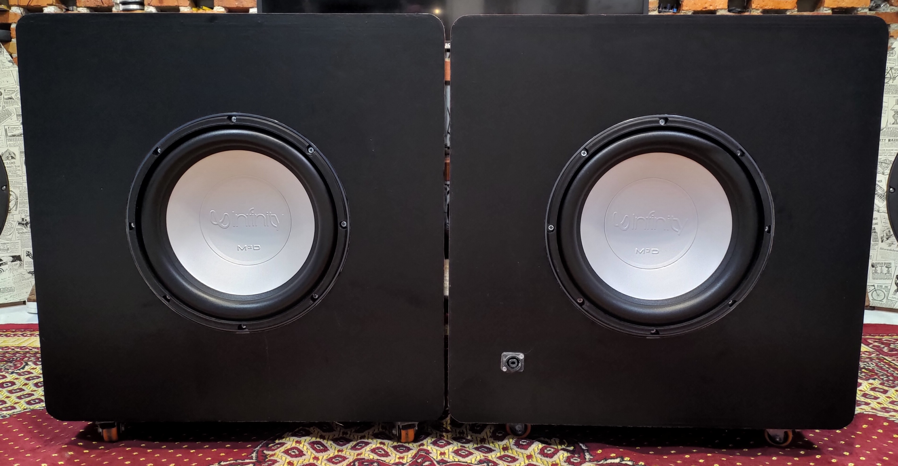

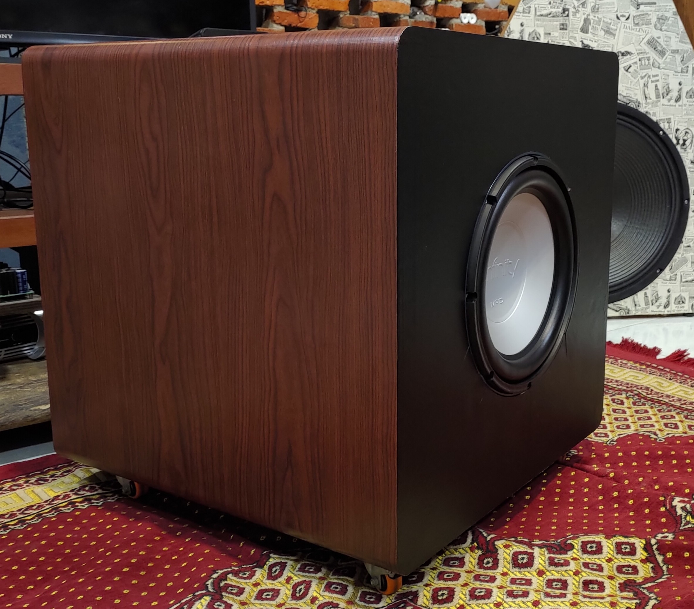

my 1st box use 2x18mm plywood on all 6 walls, but the 2nd one only use 2x18 on 2 baffles for the driver. now i will add extra layer for all walls and corner trim to get identical for both of them
existing finish with an old school newspaper vinyl looks boring 😀 i'm collecting ideas which vinyl colour/texture that will match drivers appearance

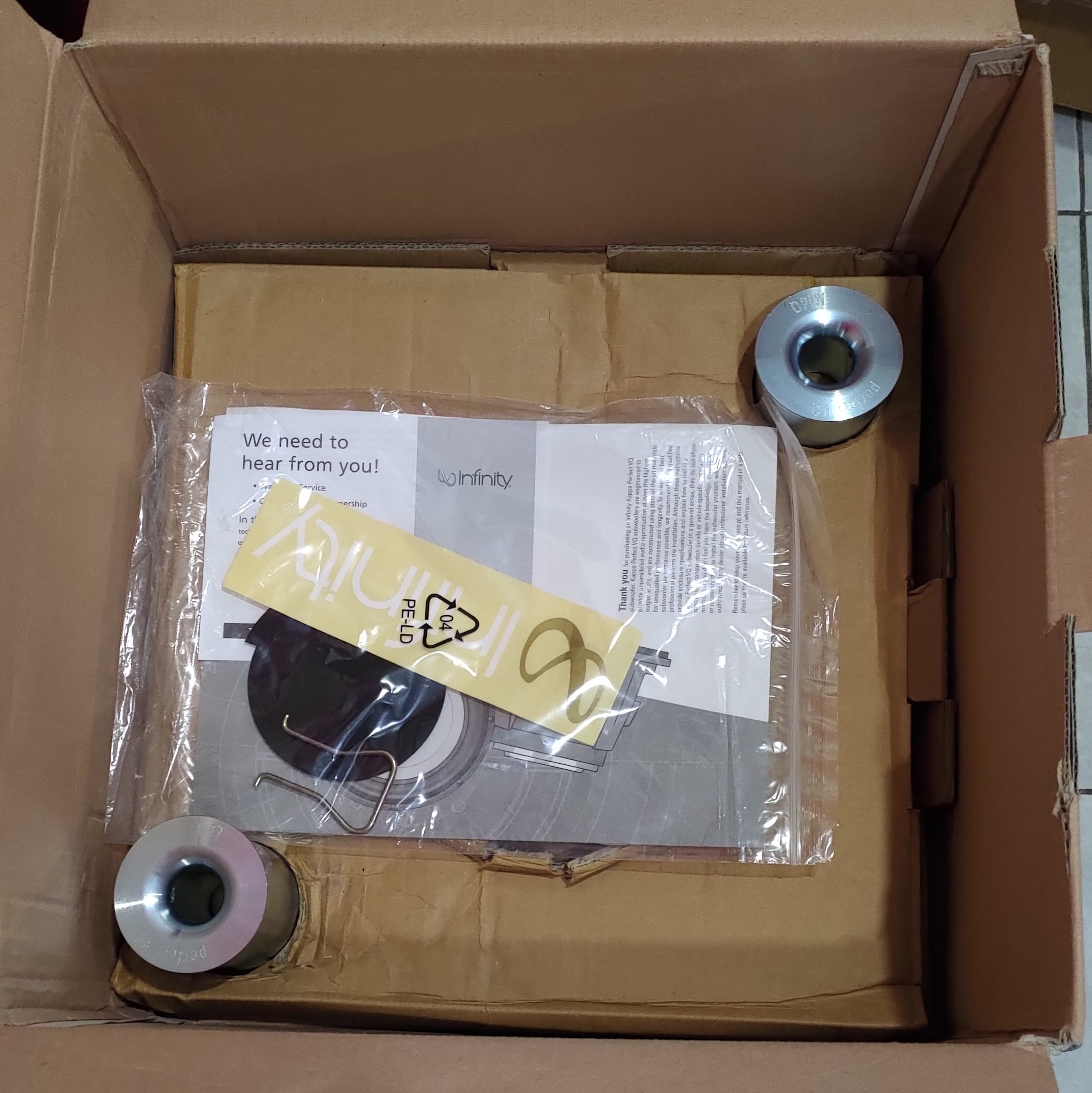

Interesting! Does the pole pieces to tune Qts come with it or have to buy separately?
edit: Never mind, they do. Bummer, could only find some used ones nowhere near me with no clue if the owners saved it or them and dinky clip if used high Qt.

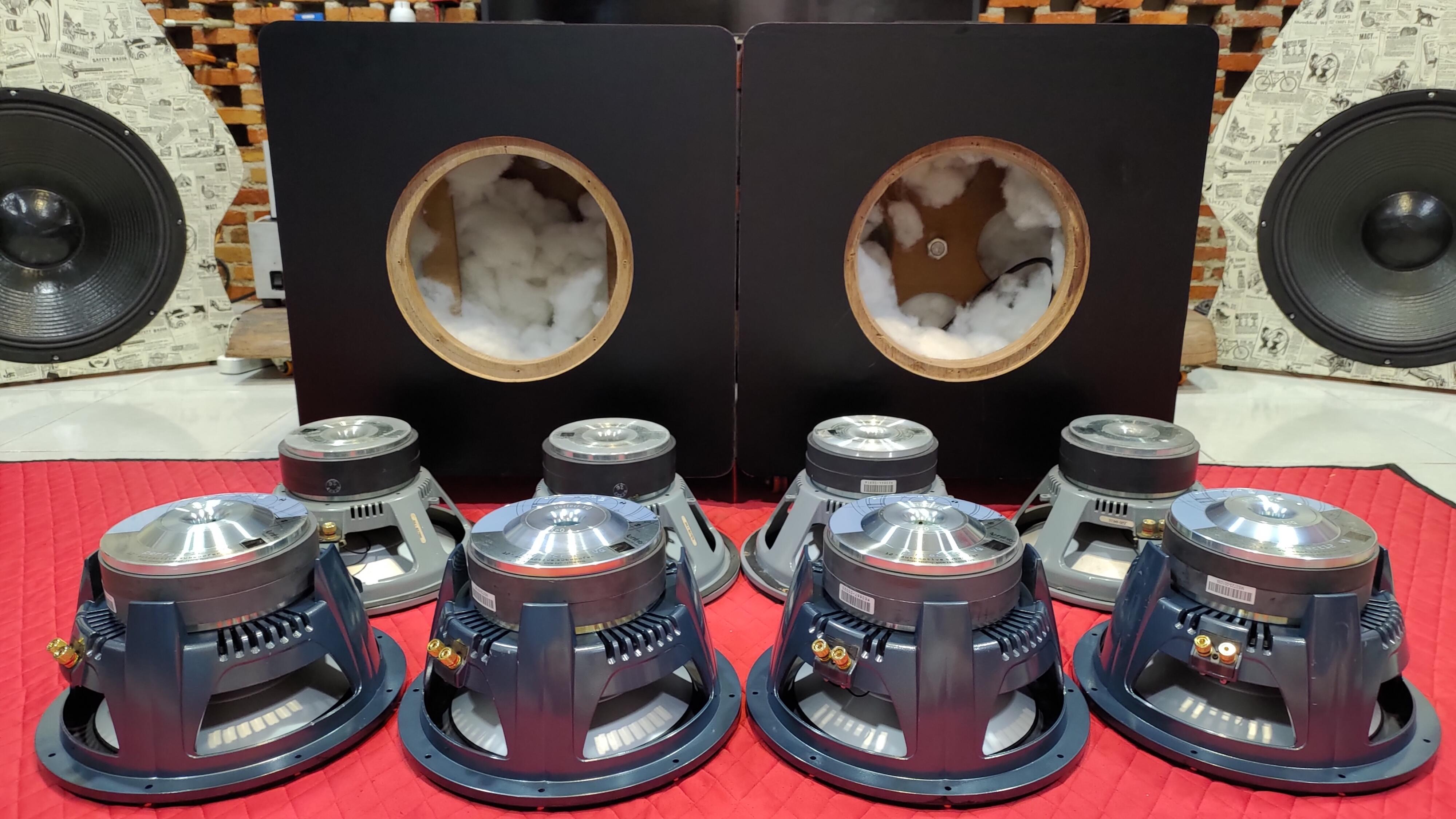

when the package arrived yesterday in the afternoon, i only had moment to open it after finishing zoom session at 9pm. dissambly my existing subwoofer for comparison, but did not have a better look for longer, time to bed

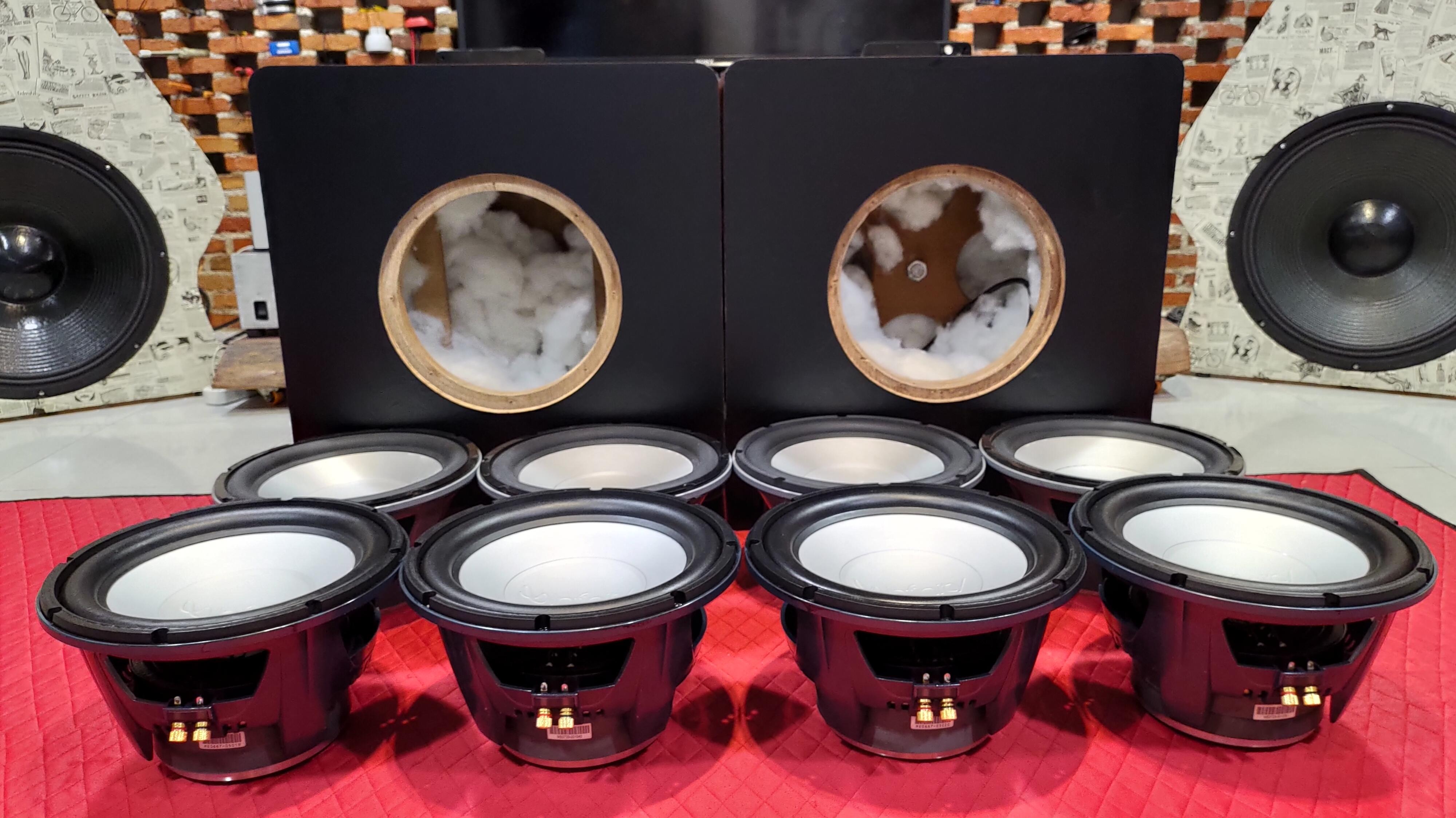

now i inspect more of the package, yes the metal steel to adjust Q are provided 2 pieces for medium and high Q, but i will not use it because low Q is better. my 160L box should be fine
honestly i was not so proud of my build, because all 4 drivers were second hand item. but that was my best effort for high price/value subwoofer that can fit into sealed design, had no idea if other driver option to choose
but now with this VQ driver in new condition, it is time to improve box finishing. still looking for a better look
eventhough it has bigger magnet, but datasheet show that 12.1 and VQ have almost same BL, not sure why. but the voice is totally different, 2" for 12.1 and 3" for VQ
i just contacted the seller that i bought my 12.1 drivers, he was surprised that i could get this VQ driver in mint condition and even 4 of them. for years of selling/buying ex-car audio drivers, he never got a hand of this VQ before.

FWIW, according to the manual the base driver is high Qt with low, middle Qt pole inserts:
BL:
Large "LoQ" Insert: 15.55 Tesla meters
Small "MidQ" Insert: 12.19 Tesla meters
No Insert: 9.67 Tesla meters
Qes:
Large "LoQ" Insert: 0.36
Small "MidQ" Insert: 0.5
No Insert: 0.79
Qts:
Large "LoQ" Insert: 0.34
Small "MidQ" Insert: 0.47
No Insert: 0.74

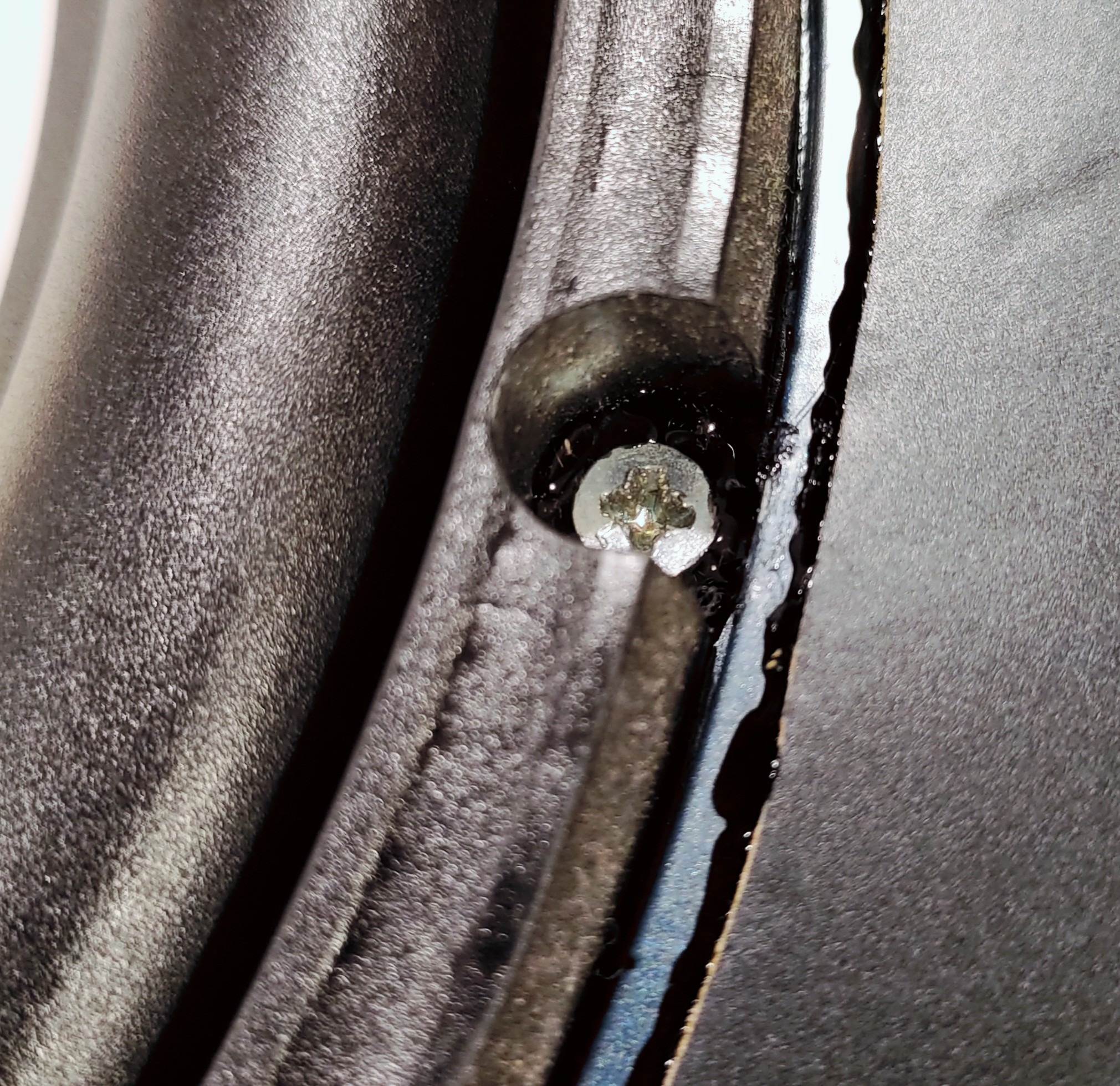

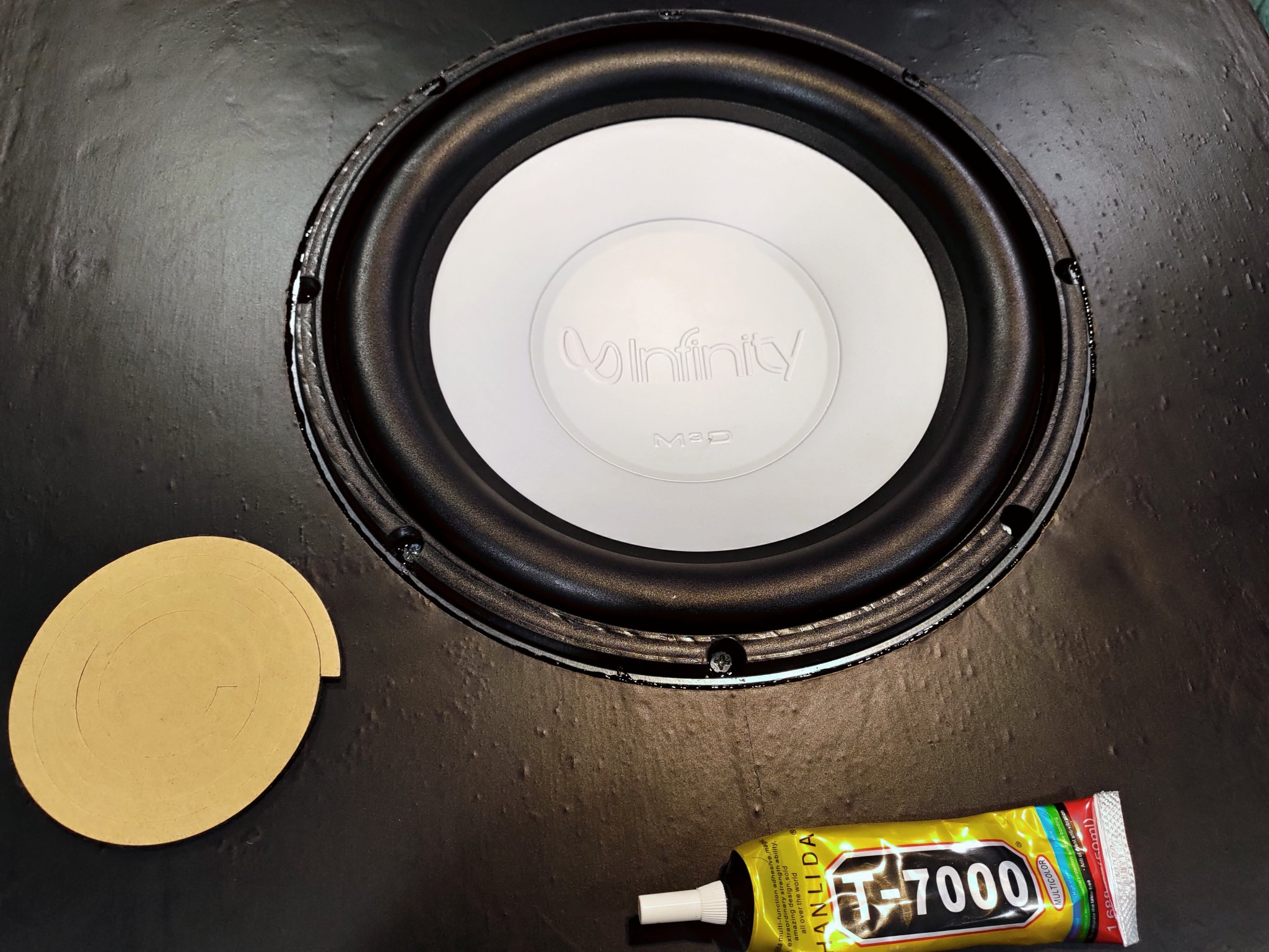

when I clean the boxes, just find out rubber seal that should be applied to the basket. i tried to pull the driver but it was tight fit. instead of scratching it, i just apply alot of silicon glue that I used to replace my android phone lcd.
i hope that no any air leakage, eventhough previous one undetected but this is for assurance
