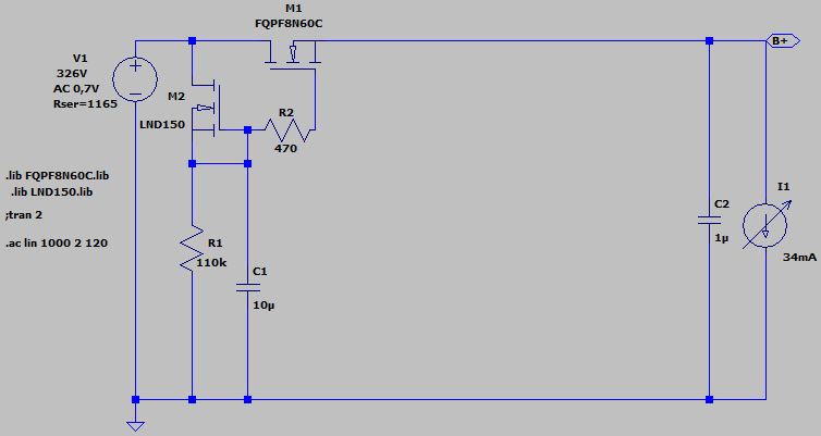

Below is the power section of the schematic. I am out and about, so I scribbled this in the car. I do realize I am missing a capacitor around the voltage regulator tube. That was not intentional.
Let me know what you think. If I am just barking up the wrong tree, let me know if there are any decent alternatives you would recommend.

Consider a VR tube to be like a zener. Good as a reference but not for high power.
You can however pass one with a FET and get a stable reference with more current capability. This becomes a voltage regulator.
...low impedance over the entire frequency range vs a capacitor......
How "high Z" is a modern capacitor?
1,000uFd is not expensive, even at 450V, in SET economics. 1,000uFd is 10 Ohms at the bottom of the audio band. Your amplifier impedances are likely 500 times higher than that. The cap change of Z from 10r to sub-r in treble is really insignificant, swamped by >100r of DCR in everything else.
You are worshiping a principle into a pickle. Slap a fat cap on the end, boom, done.

When you want to go all out, regulation is the way to go. Take in account indirect heated tubes too when your mains is unstable. Be aware of the burdon of dissipation in your build, as all heat sources add up. A perforated deck plate might be a good way to go. I've built some copper chassis in the past and for cooling it's bare to none. There are excellent regulator designs around that come with a clear instruction. Which finals are you planning?
This first amp will be a prototype of a circuit I am working on which will use a 3a5 and a 45 and will be a headphone amp.

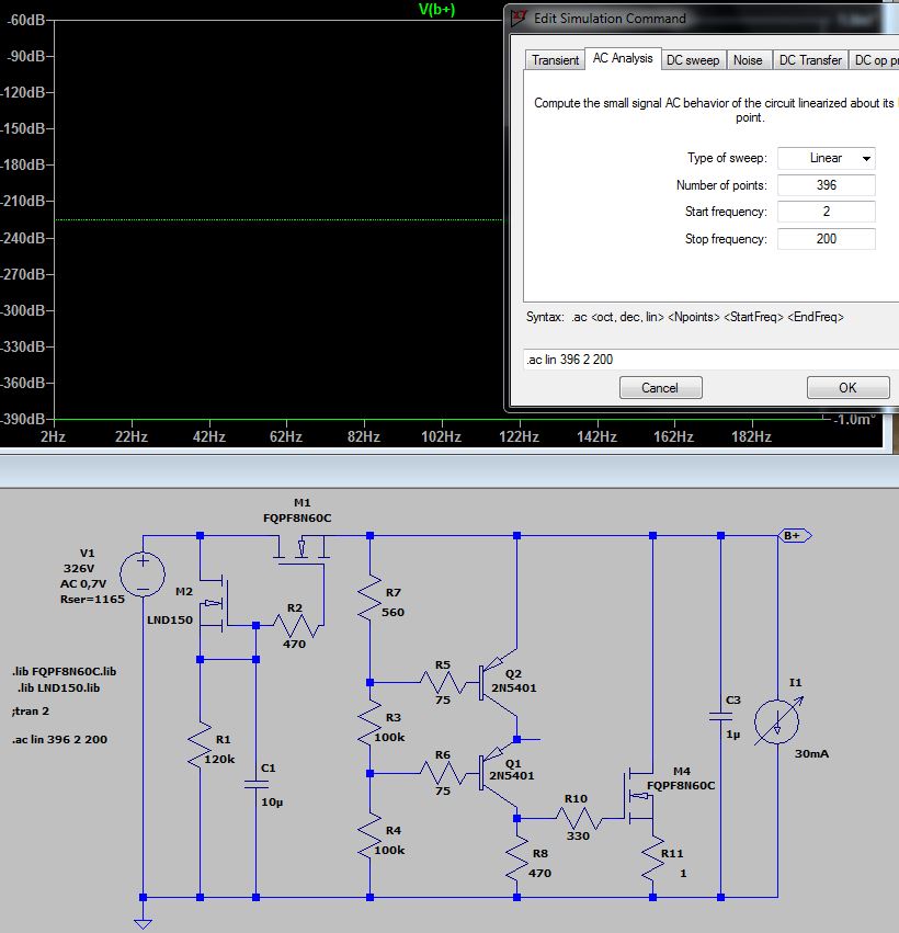

a huge size cap does close to nothing here. A
You are analyzing at DC (at 0 Hz) now, but the signal voltage is AC. For example a 100uF capacitor at the output of the regulator create some 16 ohms output impedance at 100 Hz.
