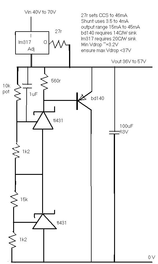

AndrewT said:Hi,
Now calculate the power dissipation in the 431 when (a) the load is drawing maximum current, (b) when the load is drawing nominal current, (c) when the load is drawing minimum current.
Is the TL431 overloaded during any of these conditions?
I have 32mA +-8mA and I opted for the PMA version (which is mistakenly shown in the datasheet with an NPN pass transistor instead of PNP).
Vout=18V and Iout=30mA CCS=52mA, the BD140 gets quite warm. A To92 will overheat.

AndrewT said:Hi Eva,
thanks for looking in and giving comment.
Can you direct me to which numbers/description indicates the possibility of oscillation? Which version, PMA's original, my first single 431, my second single + Zener or the final twin 431?
The traces of 1.2Mhz RF and the abrupt changes in noise floor depending on load current should have been enough to make you think of HF instability (applies to all versions).
Hi Eva,
Vdrop across the CCS exceeds the difference between Vin-Vout.
The result is that the shunt transistor is near enough switched off and there is insufficient current left to operate the two flow paths into the TL431.
That does not sound like a sign of an unstable regulator.
But if you can offer any advice on how to stop even this then please make some suggestions. I ask because during the turn on phase and during the turn off phase these oscillations may be present if the cause was not an interaction between the lab supply and the CCS. As one poster has already noted, the normal smoothing/and/or stability cap before the regulator has been omitted in the test circuit.
Yes, there is a change in the noise floor in some of the arrangements. But the noise does not have any predominant frequency that I could identify nor lock on to.
this condition only arises when the circuit is NOT operating as a regulator.As I turn Vin down further Vout drops in sync, since regulation has been lost and the 20MHz stays constant @ 1.2mVpp.

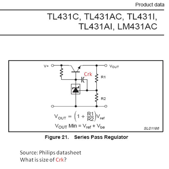

TL431 and a series pass regulator
I am rebuilding a power supply, and raising it from 18V to 23 V, for classical J50/K135 mosfet output.
The schema that is provided by Philips and others for a series pass regulator, based on the TL431 have a capacitor Crk between the cathode (top) and the reference. It is drawn as an electrolytic, so this must be several microfarads.
Question:
- what is the role of Crk (soft start? )
- What size is recommended.
- why is there no capacitor from output to reference, that is what my intuition tells me.
- some say "Consider a MOSFET power amp. - you can use a regulator for everything but the output stage.". Isn't this exagerated?

As I recall this is done to smooth the regulation. It isn't necessary unless there is a lot of fluctuation of the input voltage, or possibly a stability problem at the load.
The value is up to you on an experimental basis. This is often done across a zener in a zener regulator.
The problem is that is slows the response of the regulator.
It depends on the application. I would try the circuit without it and add it if the output is not acceptable.......................as I recall.
The T.I. 431 datasheet shows it to be .01uf, in a similar series regulator circuit.
I recall that it usually made things worse.

hailteflon said:As I recall this is done to smooth the regulation. It isn't necessary unless there is a lot of fluctuation of the input voltage, or possibly a stability problem at the load.
Look around on the web for the Motorola Linear/Switchmode Voltage Regulator Handbook. I recall (or maybe I was just looking for it) seeing it on the ON Semiconductor (formerly Motorola) website about a year ago. Mark
Thanks, [making things worse] this is indeed the type of warning needed.
