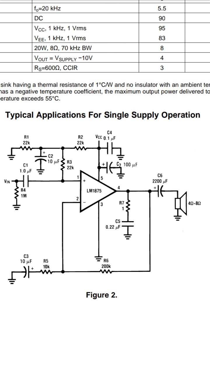

If i was to go direct coupled would something like this work for protecting the speakers ?
Obviously i would do extensive testing to ensure proper operation of this board.

The original manufacturer stopped their production(NEC probably) but if it is from any reliable 2nd source then quite good for spkr protection. Although capacitor coupled amps are more reliable in this case & they sounds pretty decent too.
Anyway if you use 1875 a spkr delay circuitry is mandatory due to their turn on off thump no matter what is the power supply configuration.

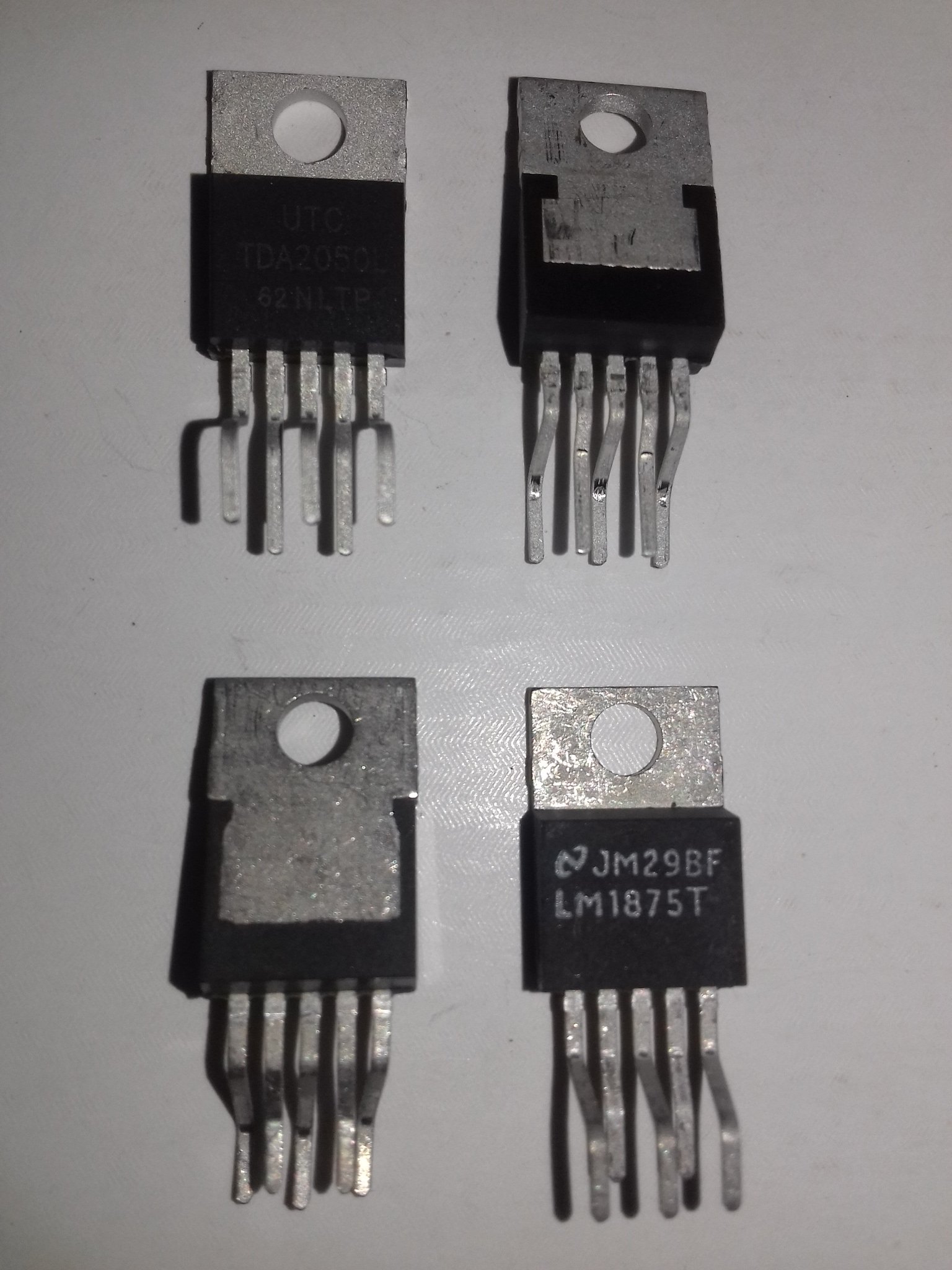

Thanks for the suggestion, but i don't think you got my question right.
I am trying to order authentic lm1875 chip from mouser and there are 8 different options that are all by texas instruments and have the same datasheet.
It looks to me that they are available with different pin angles, But which one do i buy?
https://hr.mouser.com/c/?q=lm1875
The one that fits your board / heat sink combination...
Some do say To-220 audio amp.
Go from there.
Go from there.
Yes, but how do i know which one is which.The one that fits your board / heat sink combination
They are just marked with some numbers. For example LM1875/LB05
You seem new, and are a little confused by the choices.
Which is why I said buy a ready board.
The leg orientation is decided by the PCB.
Alternately, buy a bare PCB, buy the chips that will fit.
In fact, those sellers might indicate what chip is suitable.

All the above audio amps are suitable, I probably violated a copyright, I hope they do not come after me...
All the above audio amps are suitable, leg orientation choice is to be done after ordering PCB.
I find staggered pins easier to work on, it is your decision.
