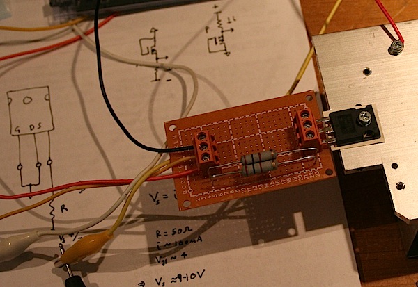

So anyhow, I proceeded to wire it up just like the diagram above and went to town measuring the Vgs of my MOSFETs at a current of 5mA.
Adjust your power supply for 15.0v, make sure your resistor is a 1% 2k2 metal thin film (1/4w will do). I added some gate protection to the circuit to avoid blowing the gates with a bad hookup or a transient using a 12v zener and 1N4148 in series from gate to ground.
Next step is how to attach the big fat pins from an IRFP240/9240 (TO-247AC) packages? Well, it turns out that a 3-pin PCB mount screw terminal block holds the pins securely and precisely without damage (the screws actuate a lever that clamps the pins so no marring or damage to the pins occurs). Of course, a TO-220 will push right into the breadboard and that's what I did for my 2SK2013 and 2SJ313's.
So here it is in action (N channel on left side and P channel on right side):
I then added jumpers to do TO-220's here. These SK2013's and 2SJ313's have some spread but not too bad and certainly, they are proven to be functional in use as an amp and show reasonable Vgs:
It made quick work of measuring Vgs - which I just wrote onto the satin finish of the MOSFET body with a pencil. A large batch of the IRFP9240 that I got from Aliexpress for $1ea were actually matched within 0.01v for 5 of them Anyhow, I am real glad I made this jig, it's going to be really useful and well used in the future. I hope you find this helpful.

The Vgs test is at 5mA so there is no heat generated really. There is a high current test that Mr Pass mentions in the above article and that will require a heatsink.
slight error.
The Vgs of the D to S coupled mosFET subtracts from the supply voltage to leave the remainder across the resistor.
If the Vgs is not exactly the same for each device then you will find that Vrd varies.
The effect is that your jig is not testing Vgs at a fixed 5mA. That 5mA varies.
You can change the resistor (Rd) to a CCS set to 5mA + a monitoring resistor to check whether the CCS holds a steady fixed current for each device.

Thanks for noticing that. I think it might be simpler to put a pot there and adjust until voltage across the sensing resistor shows 5mA - would have to manually be done each time whereas a CCS would be automatic. Maybe a fixed current source diode like a J511 (4.7mA) or a JFET can work here?

I use my lab power supply and adjust the lab output voltage to trim the fixed test current.Thanks for noticing that. I think it might be simpler to put a pot there and adjust until voltage across the sensing resistor shows 5mA - would have to manually be done each time whereas a CCS would be automatic. Maybe a fixed current source diode like a J511 (4.7mA) or a JFET can work here?
Alternatively I can use the current limiter, leave that set to a fixed value. But this is only effective at much higher output currents.

I almost forgot that I have a "lab" power supply now with a trimpot adjustable voltage. I should build a small box with a real pot knob.
To build a free-of-temperature-drift constant current source that outputs anywhere between 2.5mA and 2.5 amperes, get a low-tempco, 1.0 ohm power resistor like this one: -80ppm / degreeC, rated for 7 watts.
Connect the resistor in the source leg of a power MOSFET, and use that assembly plus an opamp to build a precise VCCS: voltage controlled current source. The opamp guarantees that the voltage across the resistor is V_user_adjusted and so the current is (V_user_adjusted / R). Since R is a very weak function of temperature, so is current. Choosing a 1.0 ohm resistor makes setup and calibration especially easy. V_user_adjusted comes from a temperature-independent reference voltage (LM285-2.5 @ 20 ppm/degC would be quite handy) and a potentiometer.
