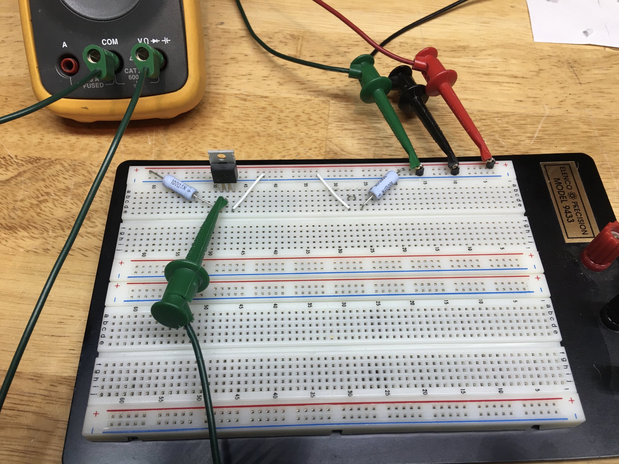

FWIW, I've found the method in the first post works well. At least well enough for me. Way back when I bought a couple full tubes of IRFP240s and IRFP9240s for an A75 build.
Using a generic 12V cigarette lighter type supply (14V actual output) and 100R in series to get roughly 100 mA with the devices in free air. I measured Vgs after 1 minute. The lot was mostly matched within 9 mV. I checked several devices in service and the Source resistor voltages were within a few mV.
Last week I measured the same lot leftovers again for an F5T build at roughly 650 mA. For this I clamped the DUT to a heat sink. Again every device was within 5 mA. I retested each chosen set (0-1 mV match) back to back to try to account for the heat sink having warmed up with no change in Vgs. The Vgs differences between devices matched the Vgs differences at 100 mA, within my meter's resolution.
I don't quite feel comfortable not matching when pulling devices from the same lot, but it sure makes matching easier.

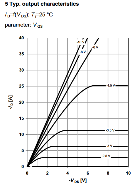

Do you feel 100mA is a better representation of the true Vgs at real operational conditions than 5mA? Did you get to test at 5mA to see if it made a difference? I suppose it will heat up quite Abby at 100mA and Vgs will probably be lower?
I haven't tested output devices at 5 mA. I went with 100 mA and then 650 mA because that is the expected operating condition - the way Mr. Pass suggested matching in the A75 article. I matched that amp's front end devices at 5 mA and the VAS devices at 20 mA.
That said, there wasn't much match difference between 100 and 650 mA. Further down on the curve there might be. Take a look at the Vgs vs. current curves. You may want to measure at a current more representative of your standing bias.

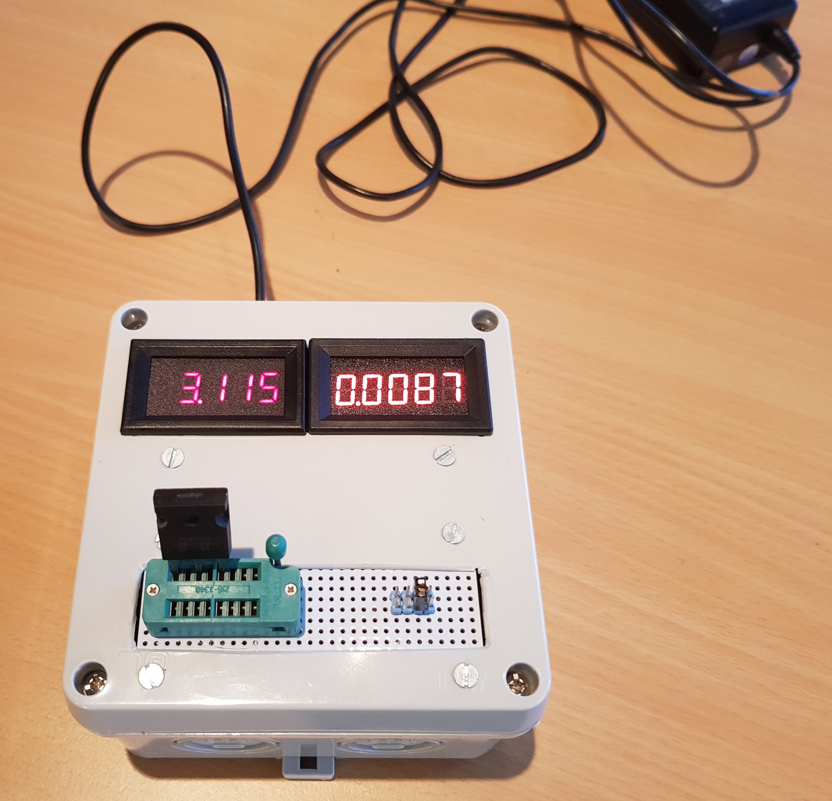

I recently build this tester togehter with a friend og mine. We are both building an Aleph 5 and thought having a permanent tester would be handy. So here is the schematic:
And the box looks like this:
I use a PC power supply at 19VDC, which gives slightly lower test currents. The A and V modules are cheap AliExpress types.

That's a very handy tool to have! Are those just regular 1/4DIN mV resolution LED display panels?

Hi!
The modules I used are these: ammeter and voltmeter
There is no floating measurement possible with the voltmeter (3-wire).
In the schematic you will notice that the voltage drop across the ammeter is included in the voltmeter readings.
But for matching purposes this doesn't really matter.

@m0rten, Thanks for the links! That's an amazing price for a 5-digit LED panel meter! $4.67 shipping included, yikes. I am going to have to buy a dozen or so 🙂

There really is little need for a PCB for my unit. It is made of 2 pcs of Veroboard, one at the top with only the ZIF and the jumpers.
The second is piggy backed below and contains the 4 resistors. The rest is cabling.
PS. Make sure the voltmeter you order has 3 lines, not 2.

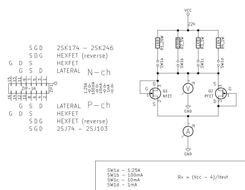

What happened to Easy Peasy? The first post looked do-able and then all hell broke loose and nobody ever presented an easy-peasy tester for MOSFETs.
The tester is in Post 1, seems to work for me. Lots of folks had suggestions to make it better with more complexity. But as a means to do some initial sorting and matching, it works well enough.

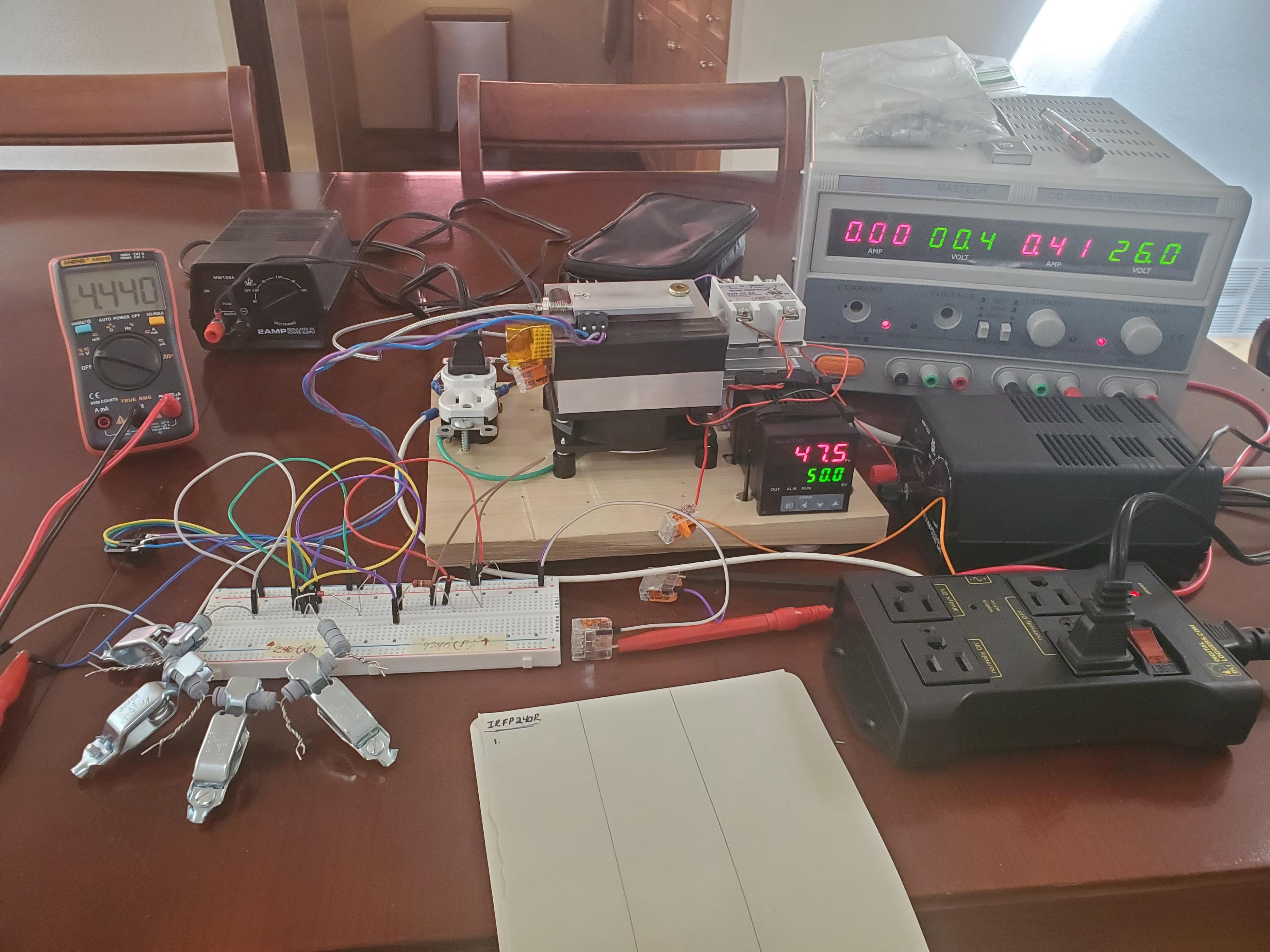

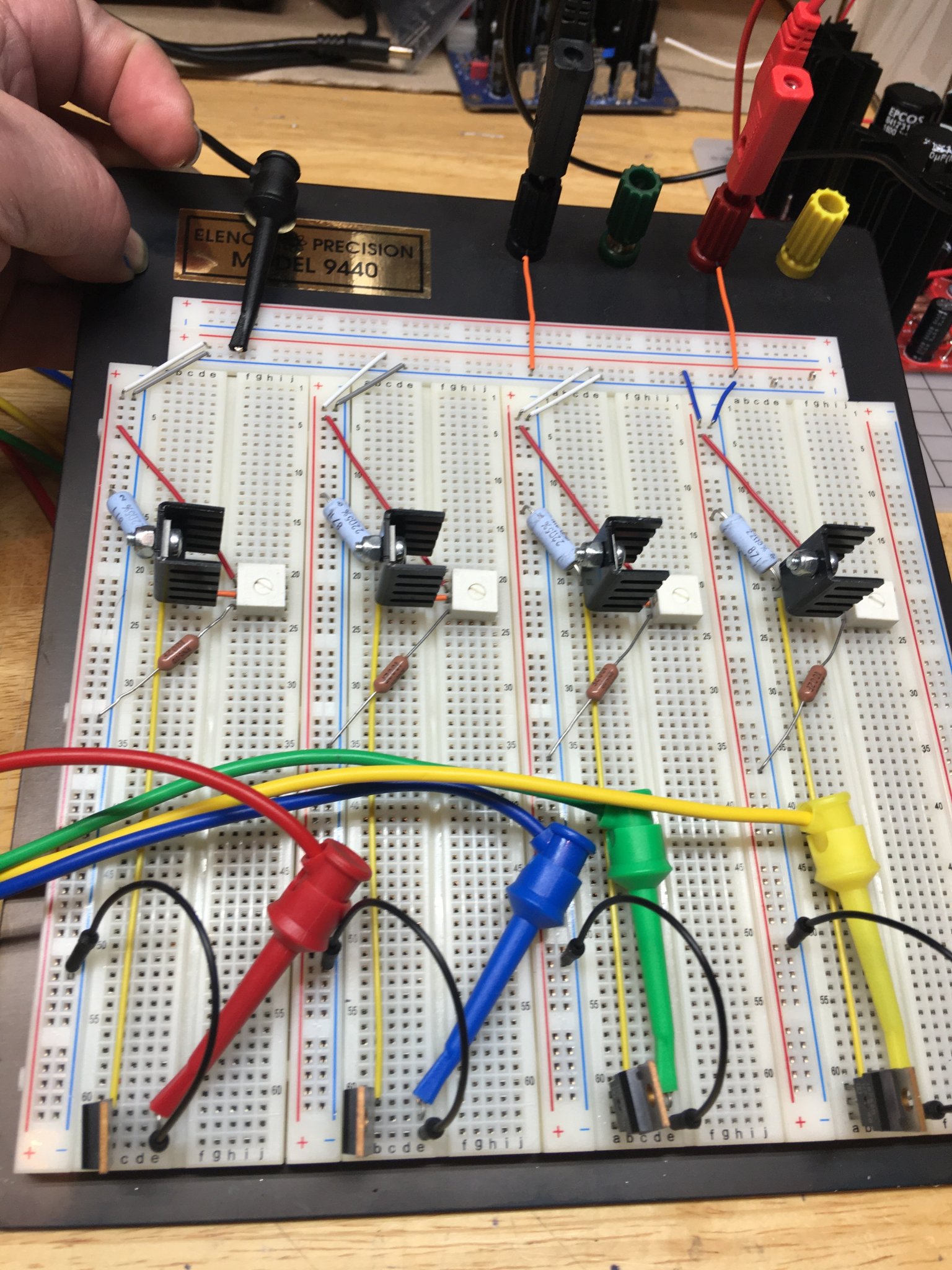

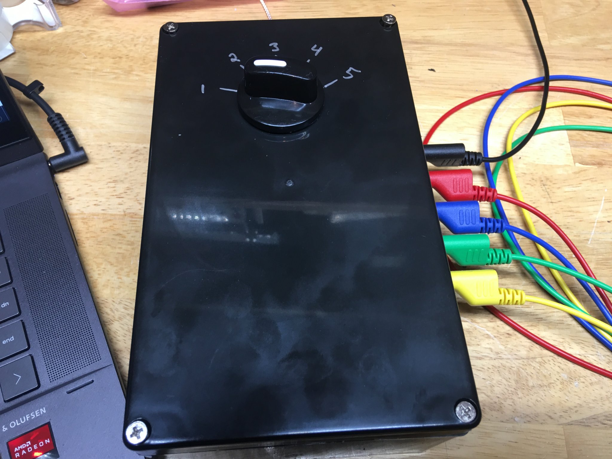

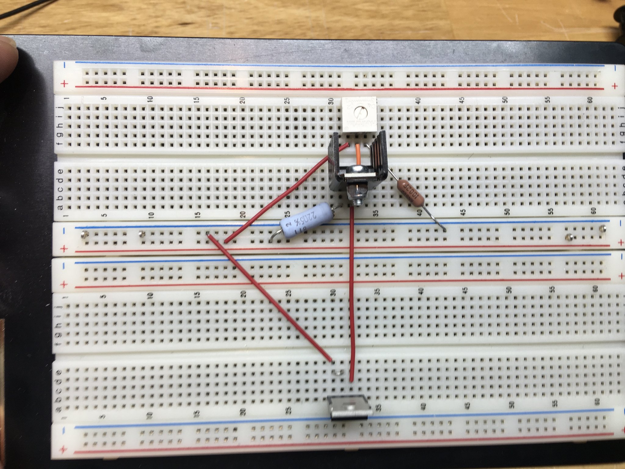

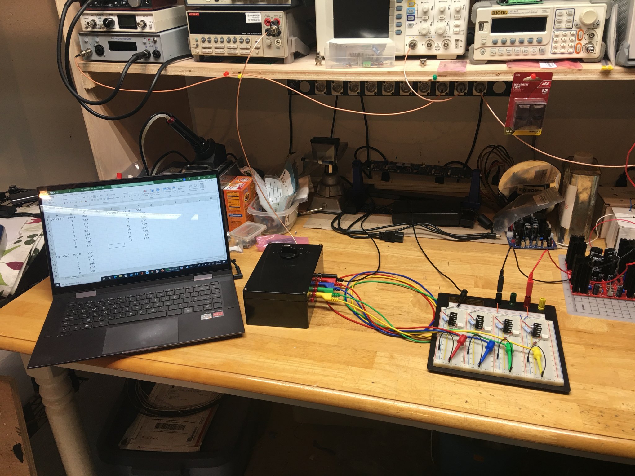

I think I might have taken the easy out of "Easy Peasy" and instead created the Franken-Tester. I started with this thread, so I figure I might as well post here. I began with a simple circuit as proposed here, then graduated to the circuit using a CCS, then to four channels with CCS with switch box to meter. I'm building this to prepare for measuring complimentary pairs of IRF 520/9520 both accurately and quickly. I really never thought to ask for advice (with the exception of the CCS) while building...I just kinda did what made sense to me. I'd love to know how others test multiple FET's.

Hi Kevin,
Nice setup! Woofertester will be testing 1200 IRFP240’s for me to get matched triplets for the cascode portion of the SuSyLu. He’s got a commercial grade Keithly instrument tester with a custom script to automate as much as possible.
