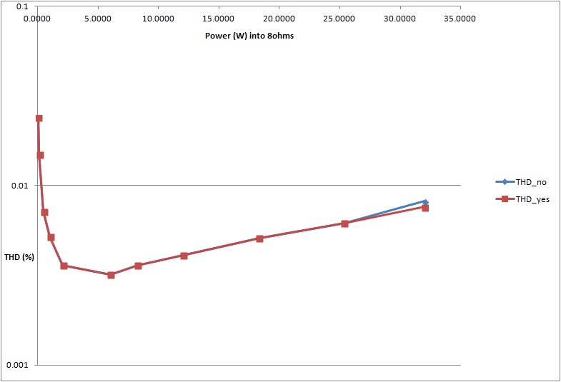

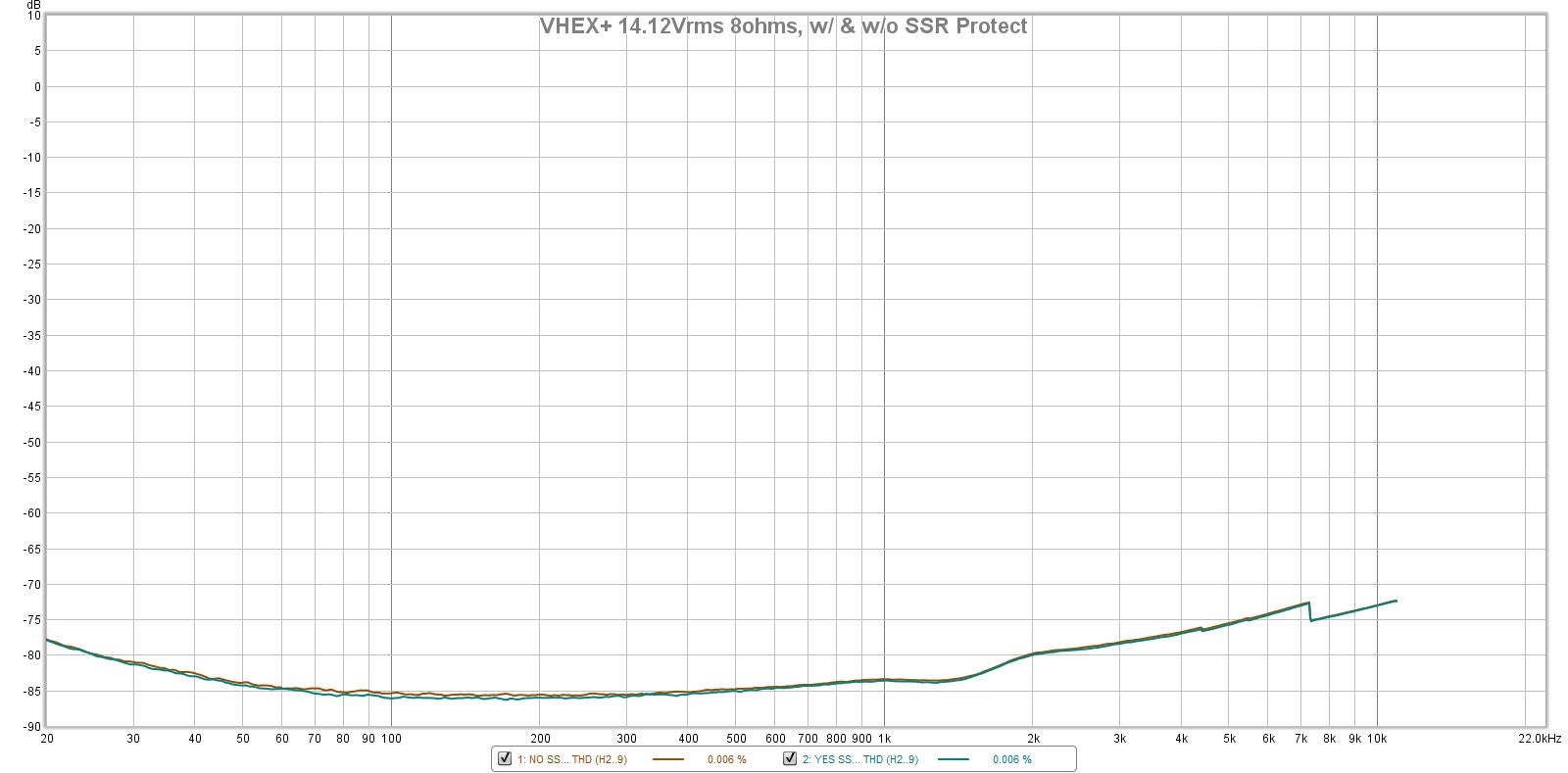

The use of low RDson MOSFETs for solid state relays as speaker protection, if properly implemented, can work very well and indeed, has no audible (or measurable) effect on the sound quality or distortion. And get this, both Tomchr and myself noticed a very slight reduction in THD with the SSR in place!

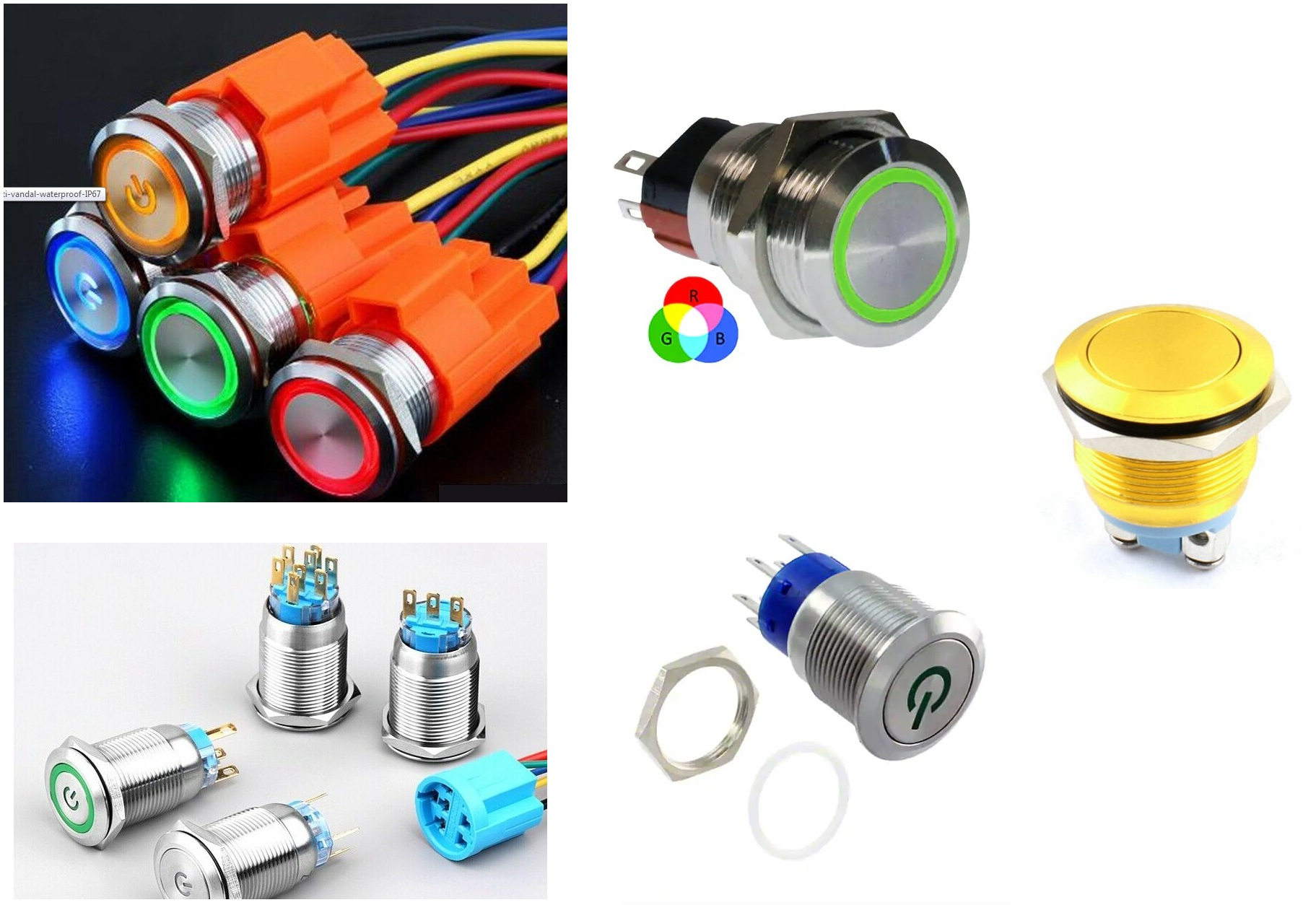

A not-insignificant additional benefit of including a soft start PCB is: almost all of them let you use a low-voltage, low current ON/OFF switch. A lot of DIYers, including me, really like circular illuminated "anti vandal" pushbutton switches which are only rated for 12VDC or 24VDC operation. They're meant for vending machines, pontoon boats, that sort of thing. These relative weaklings can't switch the mains of a 200VA transformer (never mind Anand's 800VA!) , but they certainly can switch a 5V DC relay control circuit, on a soft start board.
MJ,
Yes! I used a Bulgin on mine, it’s what I had on hand, but as you point out, there are several varieties and colors (along with dual color illuminated LED’s) to boot. Beats the usual “rocker” imho.
Moreover depending on your electrical configuration, mounting this circuit at the rear panel (near the power inlet) has the benefit that AC mains wiring need not be run to the front panel where the pushbutton is.

Agreed. Unlike relays which will degrade over time and start to have an audible (and measurable) degradation of the signal. In addition, relays often arc over at high current, so they may not offer the protection of your speakers that you're looking for. You can see some spectacular examples here: Speaker DC protection with relaysThe use of low RDson MOSFETs for solid state relays as speaker protection, if properly implemented, can work very well and indeed, has no audible (or measurable) effect on the sound quality or distortion.
And get this, both Tomchr and myself noticed a very slight reduction in THD with the SSR in place!![]()

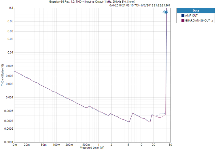

I haven't seen your measurements (my bad), but we seem to agree. See attached measurement of the Guardian-86.
