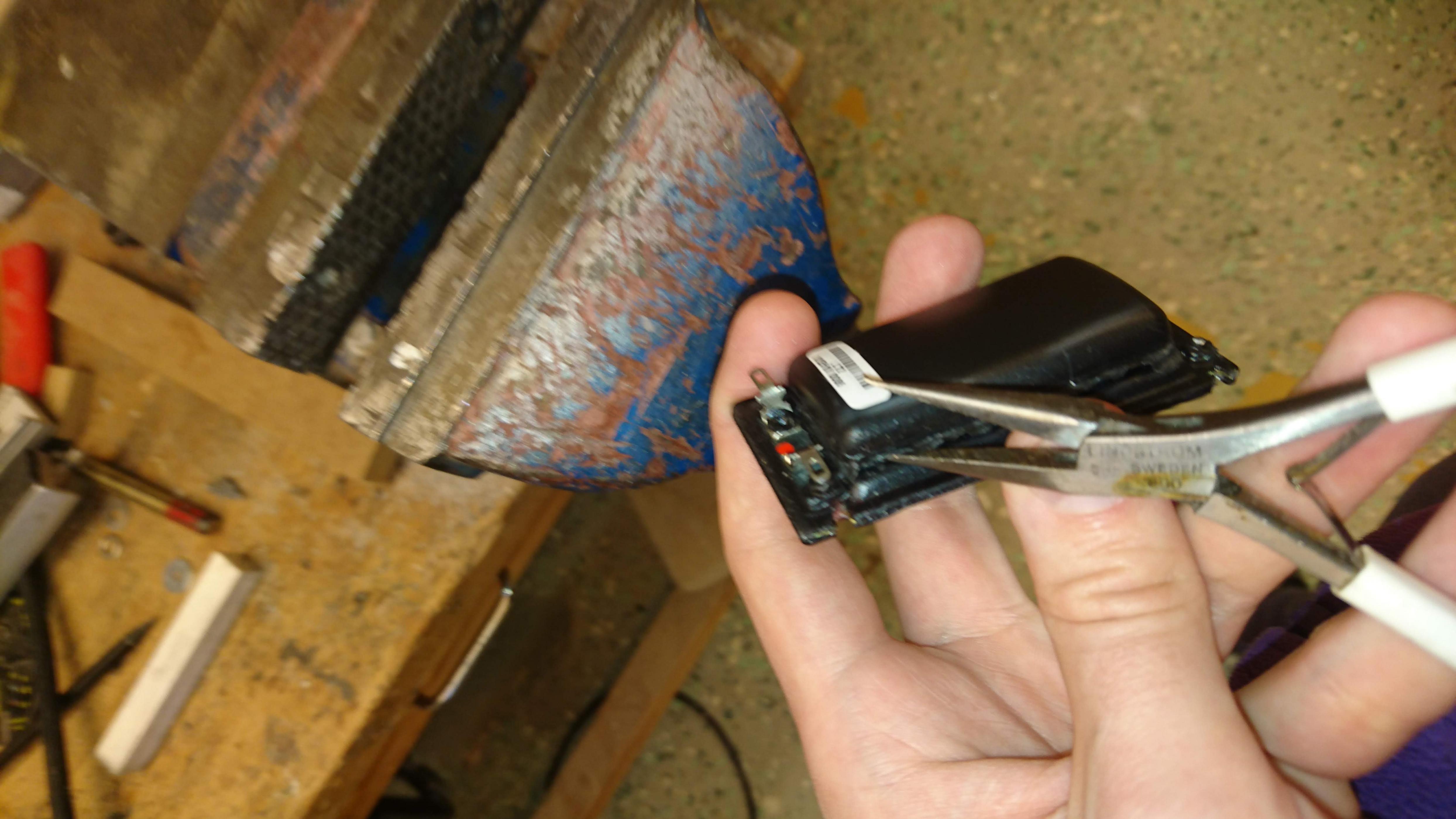

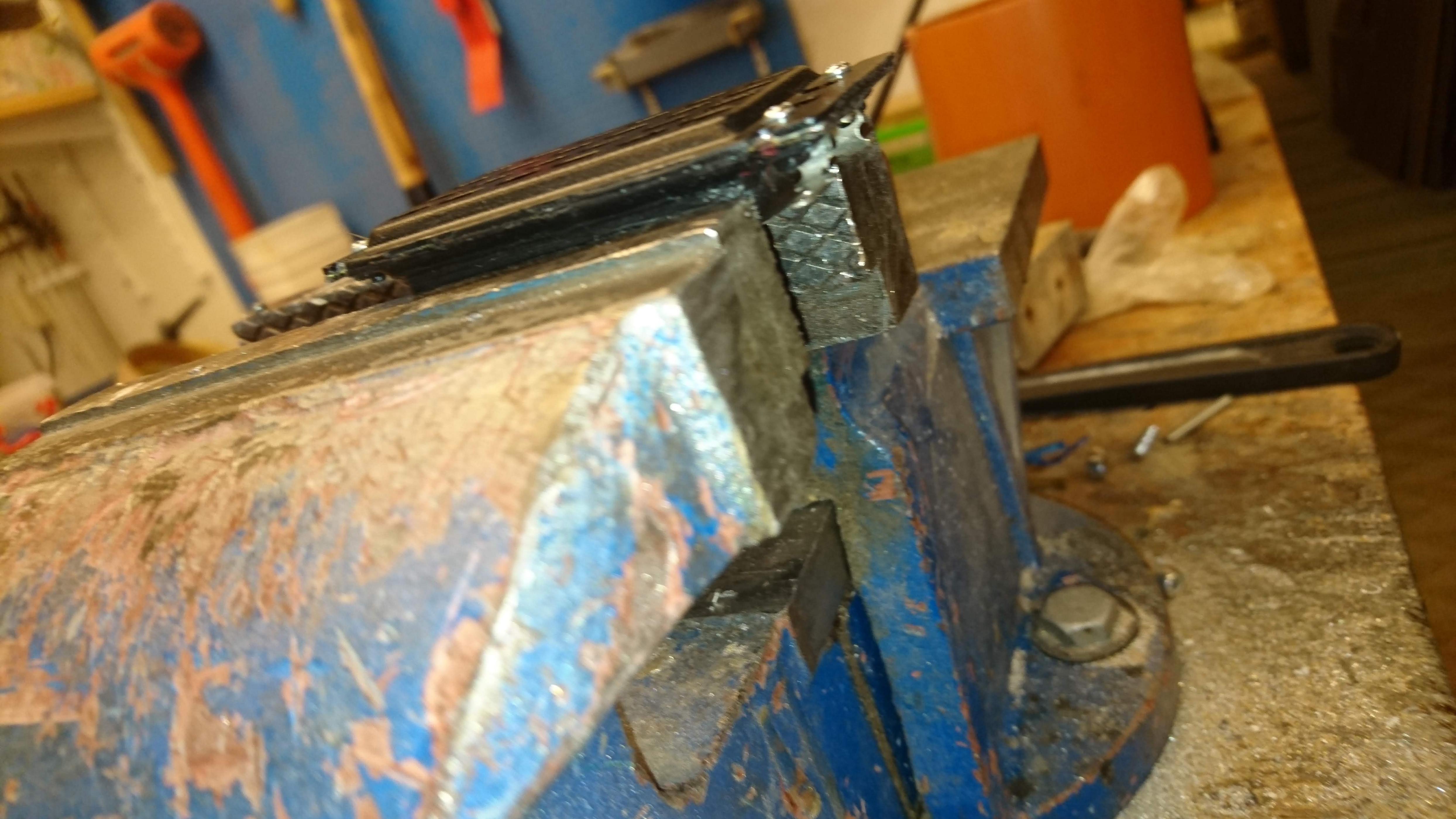

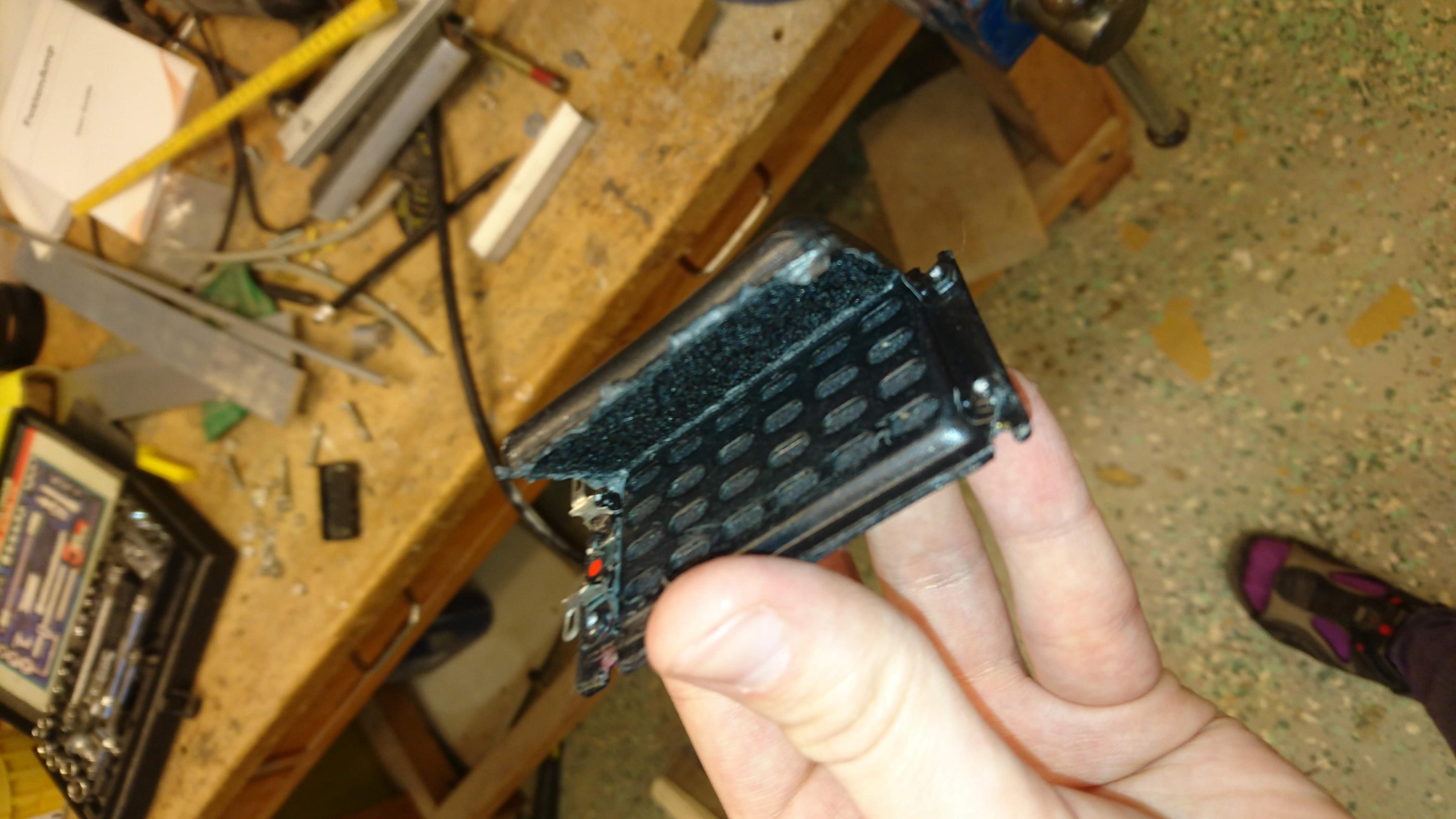

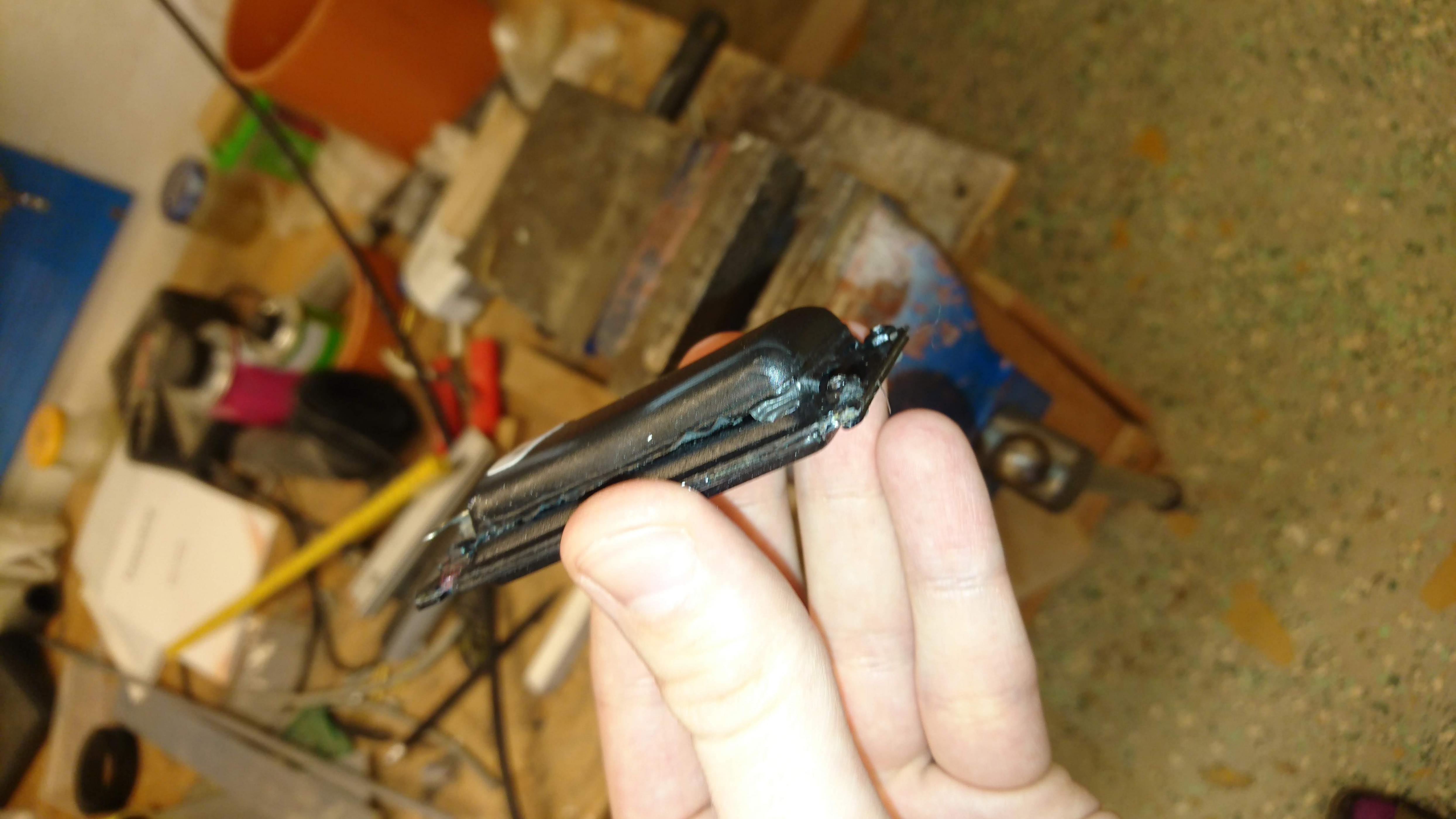

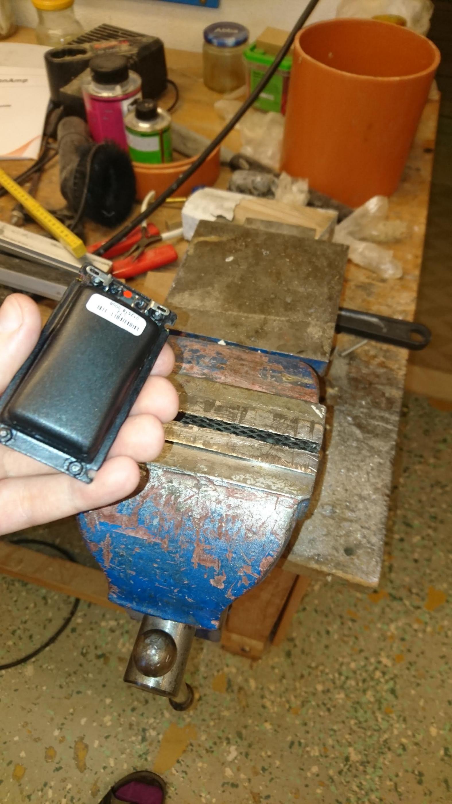

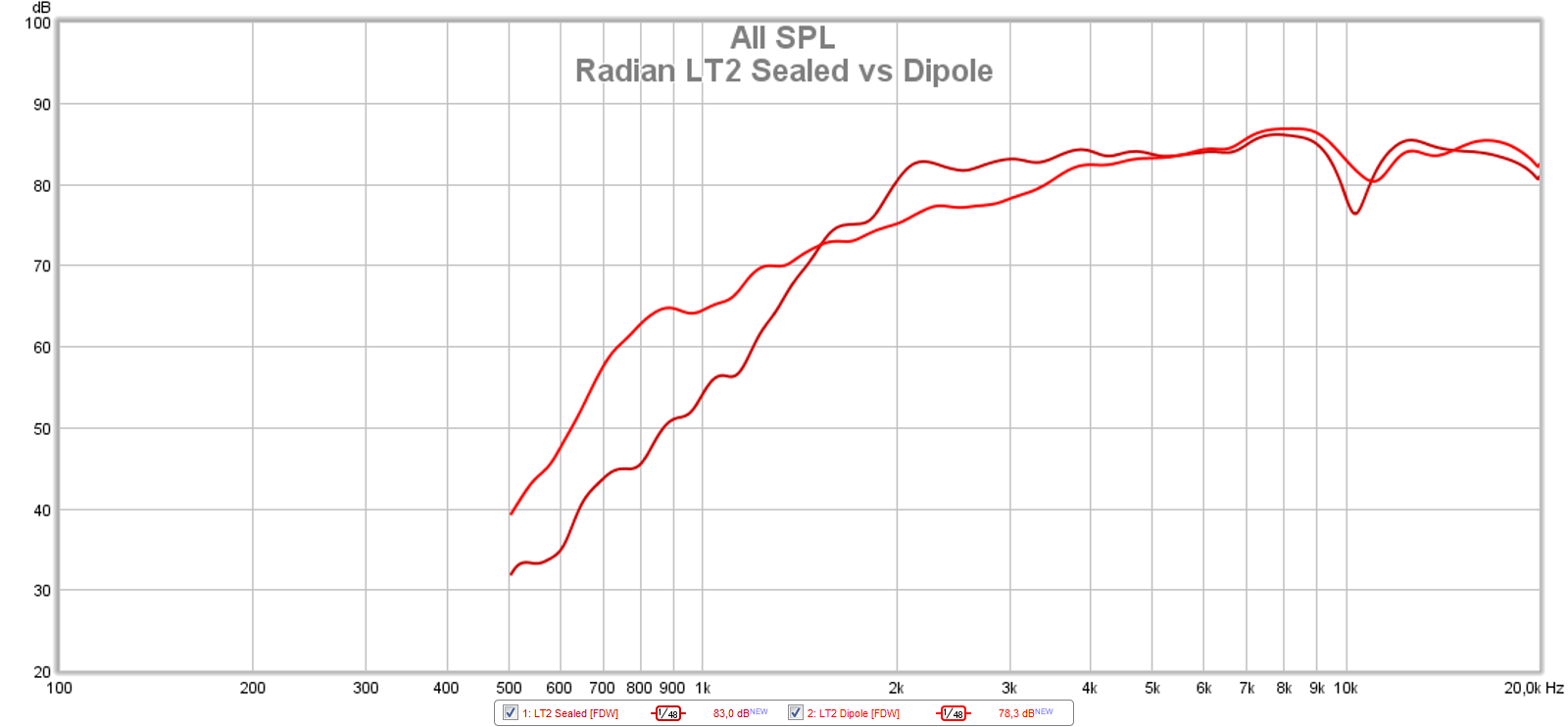

And here is LT2 Sealed vs Dipole and how I removed the back cup:

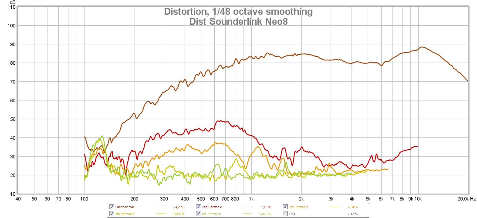

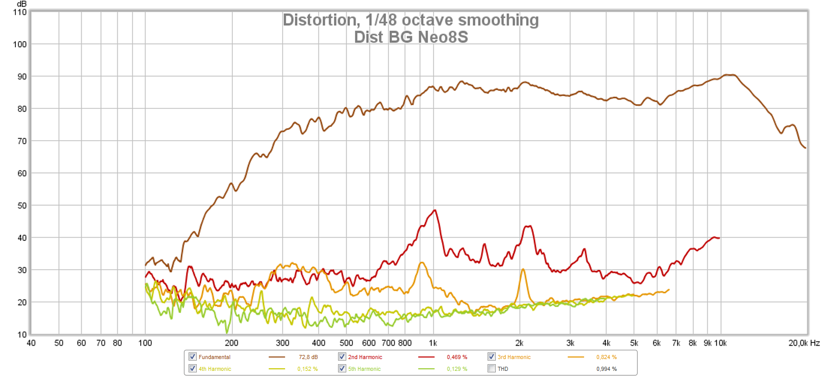

I have also measured the Sounderlink Neo8. Not quite as good as a BG Neo8S:
I had hoped it would perfrom similar to the Neo8S so I could have a column of them and play them full range, but with that performace they pretty much have to be crossed at ~ 1000 hz rather than at 400 hz where the Neo8S can go.

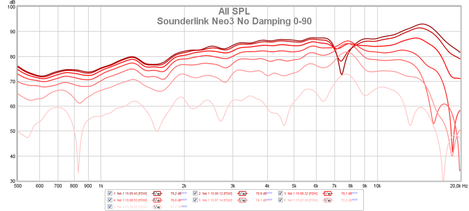

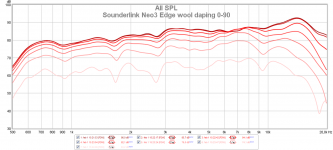

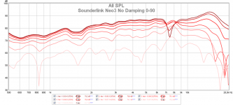

I have also ripped out the stuffing from one of my Sounderlink Neo3s and measured it:
Sadly they are not comparable to the Neo3W which has 5 rows of magnets, the Sounderlink has 3 sets of magnets which I believe is the same amount as the Neo3PDR.

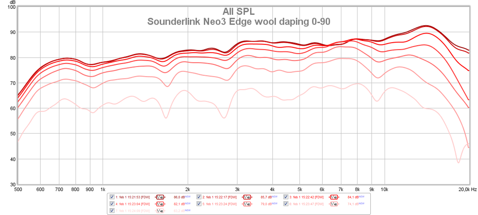

The edge wool damping is where I have inserted some wool yarn on the outer holes like the ripped out stuffing but not as compact.

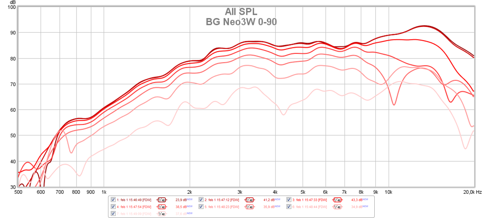

@OllBoll, why do you say the Sounderlink is not comparable to the Neo3W? Are you talking about the amount of magnets or the sound quality or measurement?
The sounderlink Neo3 measures the same as the Neo3PDR, and seems to be constructed in the same way. Both have 3 rows of magnets in the middle and felt on the outer holes.

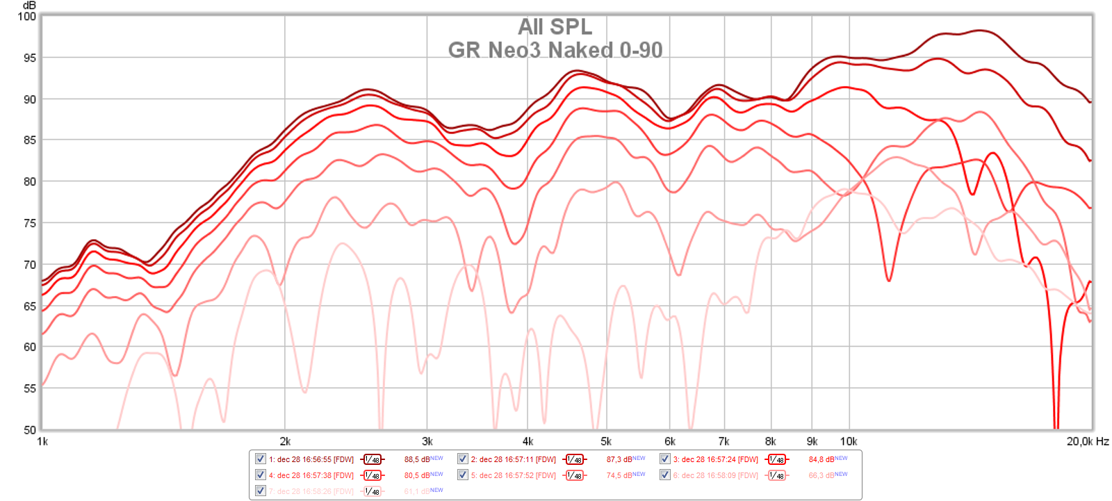

The Neo3W is a bit different. It has no felt and is made of 5 rows of magnets. The GR neo is also constructed in the same way (although in my tests it distorts a lot more than the BG version).

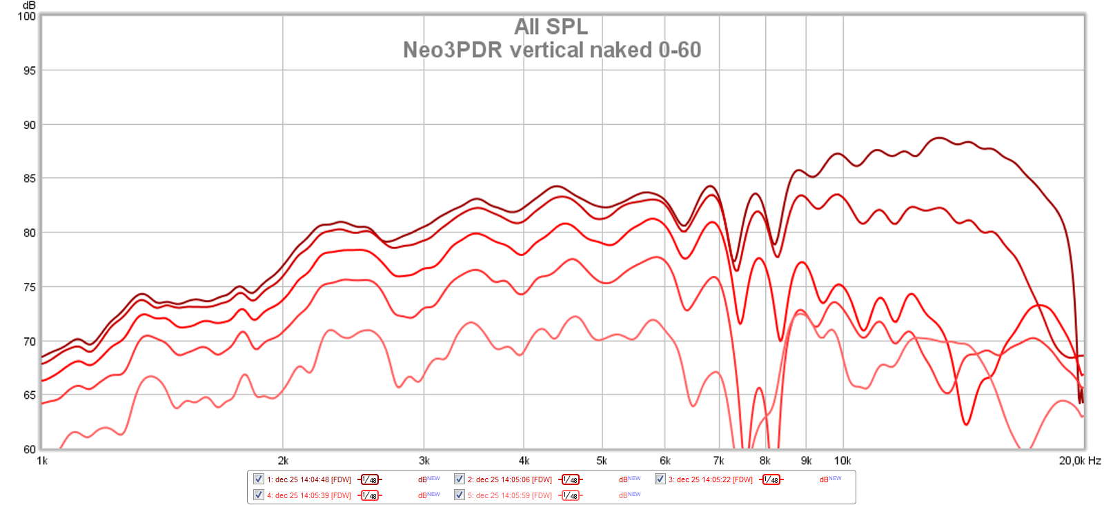

These differences make a difference in the polars, the Sounderlink Neo3PDR and the BG Neo3PDR have "too good" off axis response which causes a mini null on axis at 6-8 khz.
I don't have saved measurements of the PDR naked 0-90 but it performs same as the Sounderlink. This is why Juhazi in his Aino gradient speaker runs the Neo3PDR flipped 90 degrees. I tested that but didn't find the result satisfactory as horizontal off-axis response suffers a lot.
I included a vertical measurement, note it is 0-60. On the Neo3W in standard config it measures same on 0 and 15 degrees, but the vertical PDR already differs a lot between 0 and 15 degrees above 6 khz. And 30 degrees is already -12 dB @ 10 khz.
interesting. I bought 7 of the sounderlinks. some of them shows that 6-8k null but some barely have it. I will try to measure their vertical dispersion and see how they vary.
Your Sounderlink vertical measurement (3rd on your previous post) looks good. What dampening do they have?

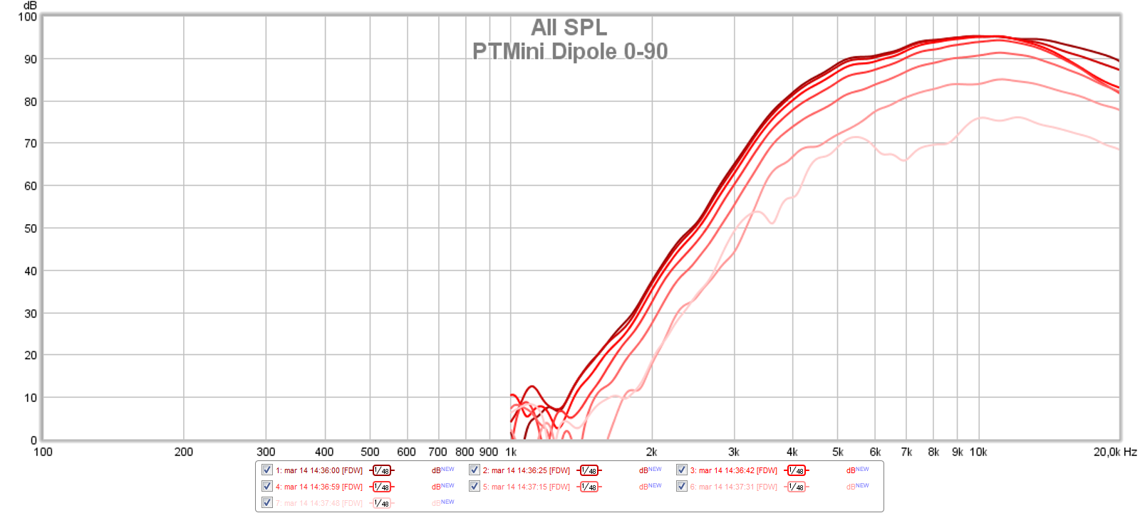

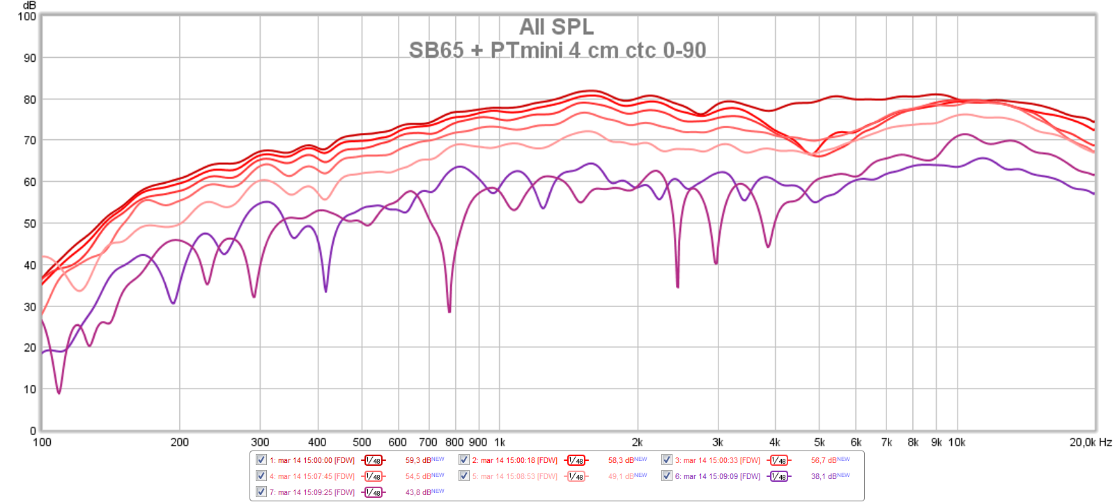

Two Dayton PTMini-6 mounted back-to-back and wired as a dipole. Measures pretty good, as long as you can cross it high as distortion @ 4 khz and below is a bit high.
I tried here with a 6 khz crossover as I'm building a CBT array but the result was not great. I get massive lobing at the crossover frequency due to the large ctc distance to the PTMini and the wideband driver below, and ofc the response is not consistent on left vs right sides either.
EDIT:
The combination is using a ~ 6 khz LR 24 dB / oct filter. I guess a steeper filter could solve that issue although I haven't tried. Most of the threads discussing steep filters talk about the problems they have with ringing so I've kept using more gentle slopes.
EDIT:
You're not the first to try it but probably first to report it here. Another member I know is working with these, in a line along side a full ceiling-to-floor wideband array. He loves the sound, says it's great >8kHz in similar back-to-back dipole arrangement.While not a Neo3-derived driver it is a planar: Two Dayton PTMini-6 mounted back-to-back and wired as a dipole... I tried here with a 6 khz crossover as I'm building a CBT array.

As far as I can remember I did not calibrate the SPL. The distortion measurements in the first page comparing the BG vs Sounderlink vs GR Neo3 are all calibrated and comparable to each other.
And on radiation pattern the measurements I have are in this post.
I should have time next weekend to do some calibrated SPL and distortion measurements and compare it to say a BG Neo3W if you want.
My guess is that it will perform kind of like the Neo3W but shifted up an octave or so. So it would prefer a crossover in the region of 3-4 khz @ LR4.

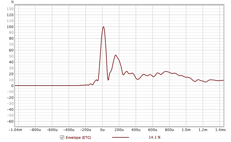

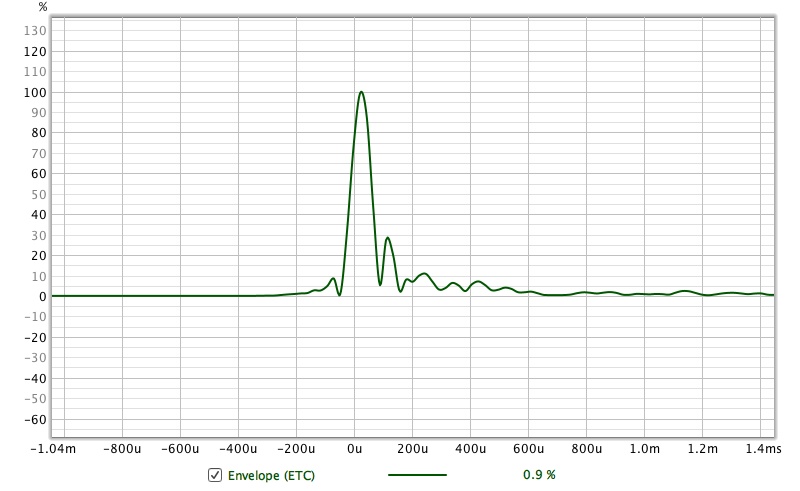

Here is a comparison of impulse response of a friend egg and a Foster E110 ribbon-like tweeter (good above 3500 Hz) - may have been the top end of the famous Infinity Servo-Static.
Mic was about a foot away. No XO. The quality of the pulse and the unwanted activity up to say, 1 milli-second reflects on quality, I think. On that basis, the E110 (right image) is better.
Ribbon THD distortion can't be beat as well. My testing was at a low loudness with ambient noise, but even so, the ribbon came in OK around .3% and the dome about .9%.
Seems to me that's a good way to look at 'em. I can't attest to the history of these old drivers, but I am just illustrating that impulse is revealing.
