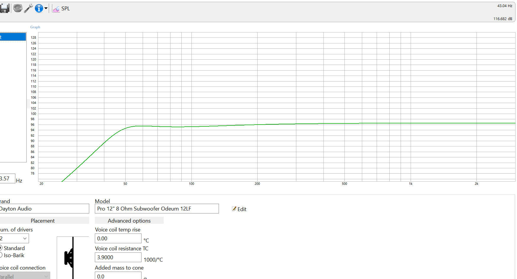

Hey guys I was just looking for PAL12 plans but I can't find them! do we have to pay for them or where can we find them? even on the forum I made a search and no results for the plans! so how can I get them?

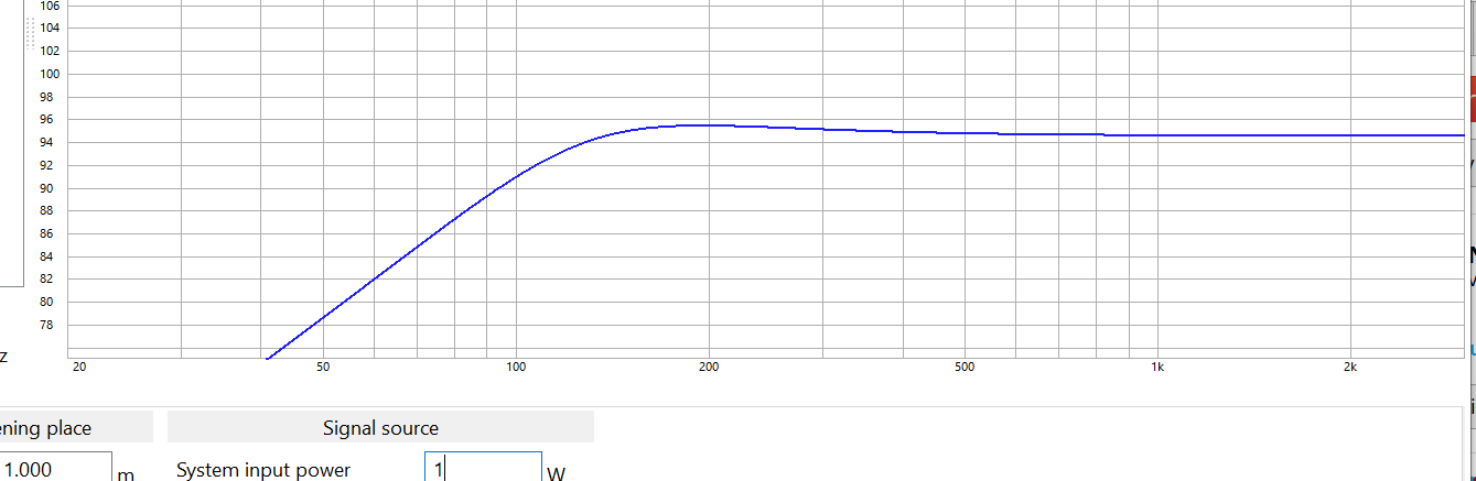

mine is the same... except for some thiele small LAB12 discrepancies , i copied mine from the eminence page
but they are a little different from the original post
more below I simmed the PRV 12W1600, it have 4" Voice Coil and 22.5 BL
Hey bogger
so does the PRV looks ok for the PAL12 ?

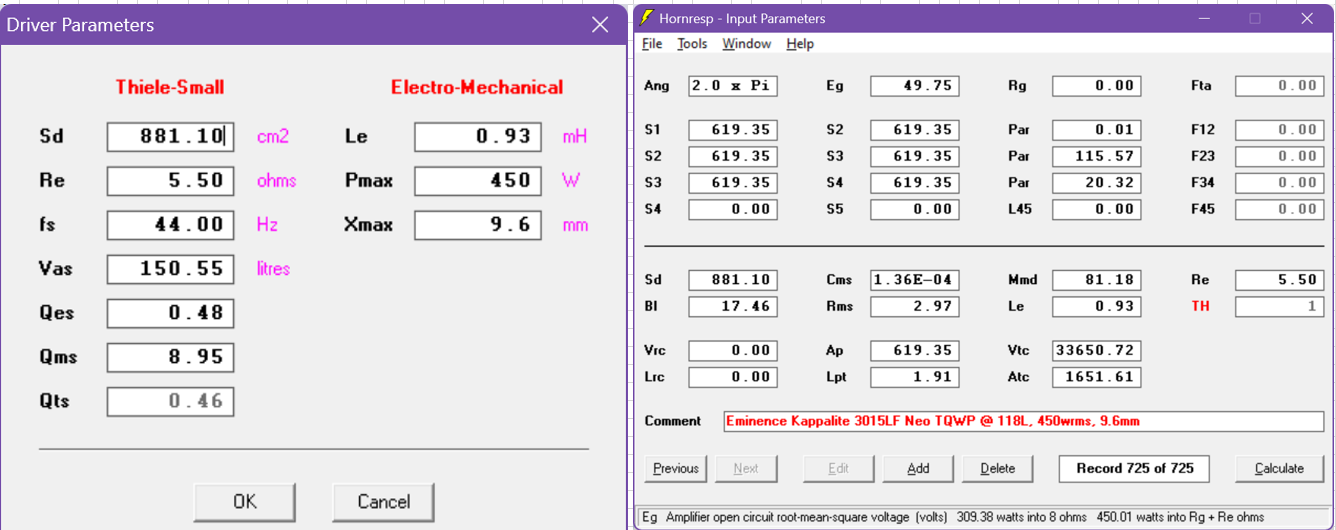

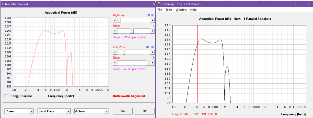

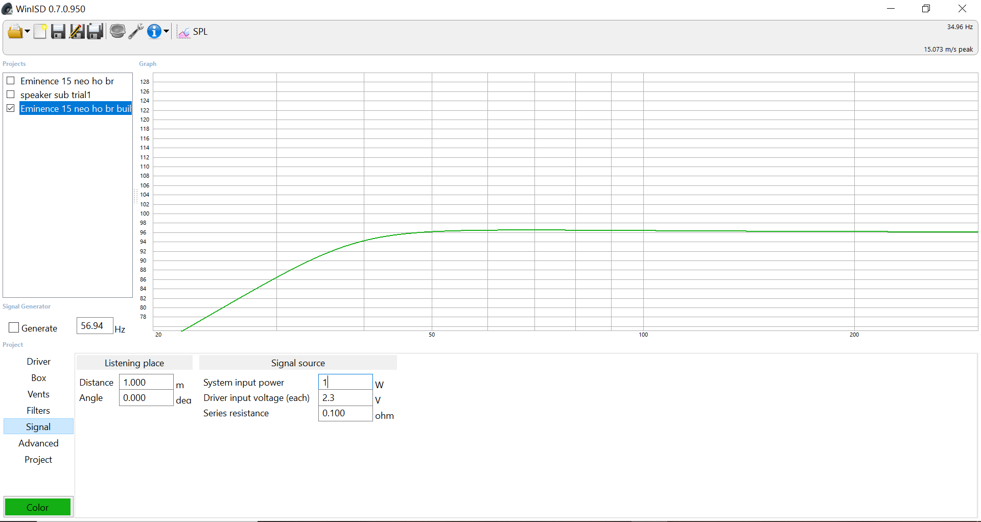

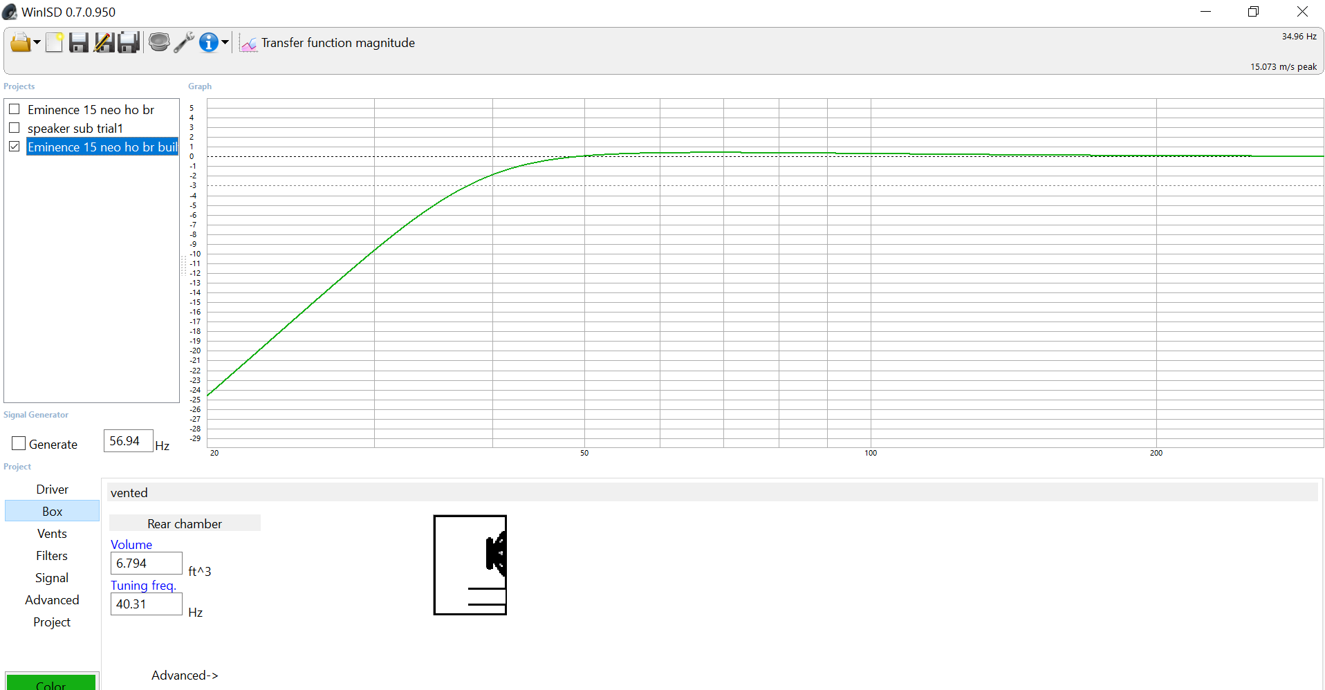

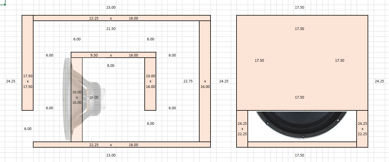

My updated plan:
Build a BR with the HO 15" version of https://www.parts-express.com/Eminence-KAPPALITE-3015LF-Neo-15-Driver-290-598?quantity=1
The box would be 28*23*18" for a volume of 6.7 cu ft. This would be 18" "high" with the driver and ports on the 28x23 side facing downwards, about 8" off the ground.

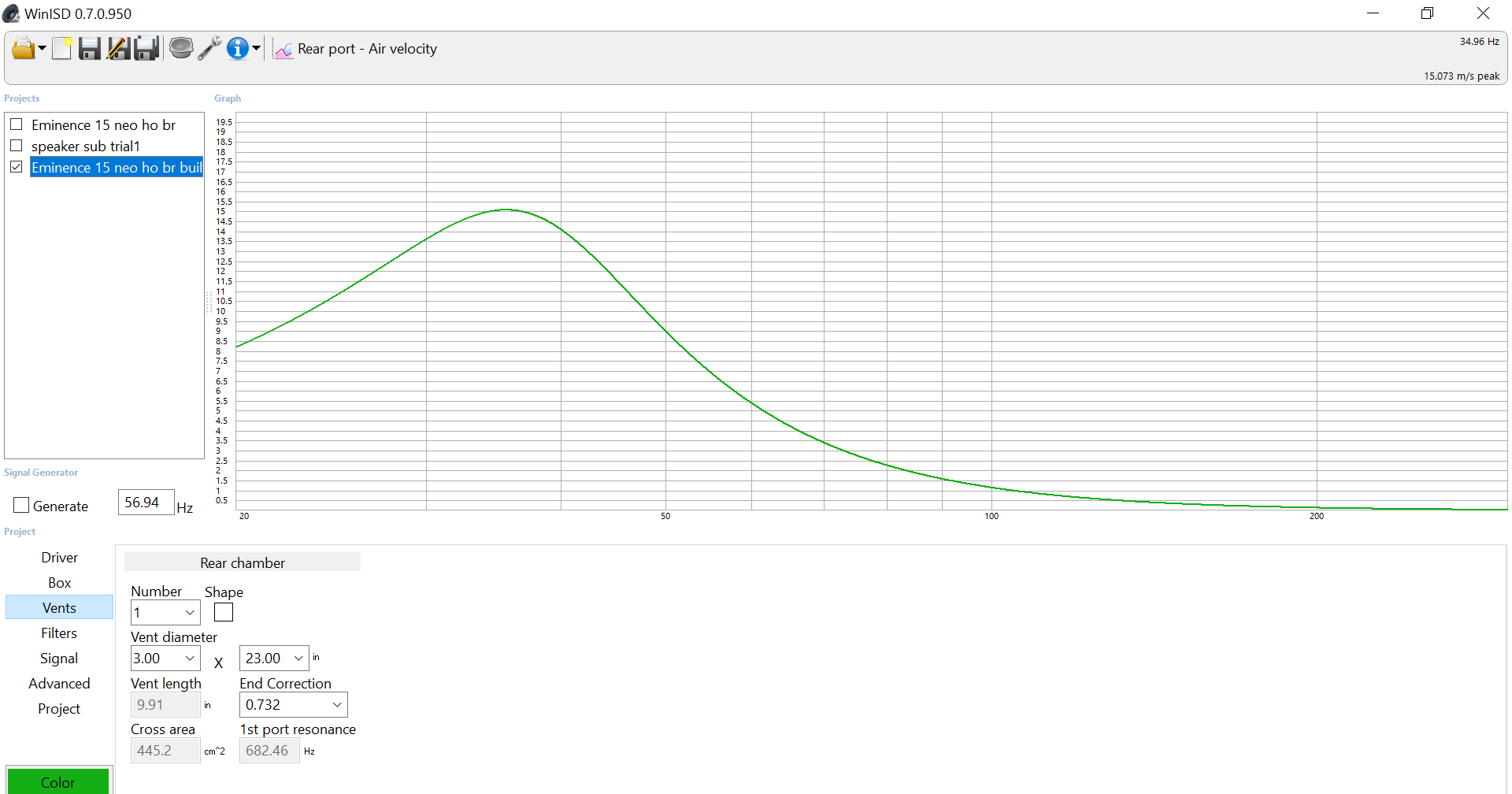

Tuning the port for 40 hz requires 4 4" ports which is... expensive. (or 2 6"). So rather than spending $100 on ports, I'm thinking of building it out of wood - having a 23x3" hole in the front, with a 9" long piece of wood inside, making a long rectangular port.
This means the port would be occupying 0.3 cu ft in the box; so I should increase the 'height' of the box by an inch, which will compensate and keep the size at 6.7.

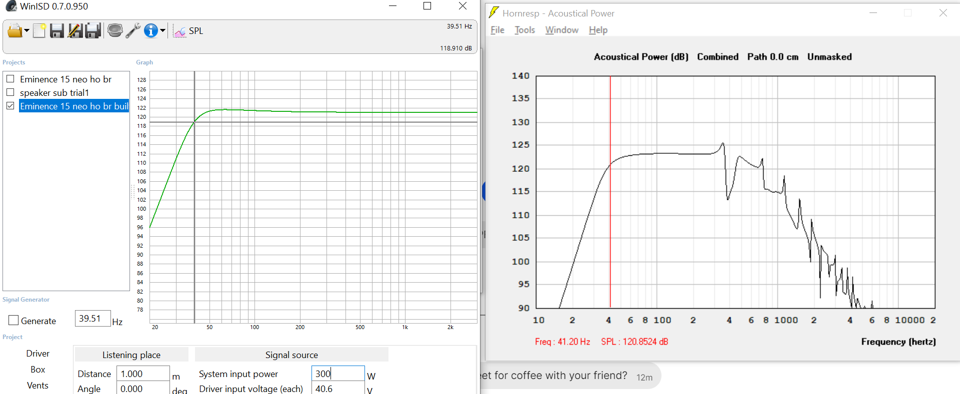

WinISD graphs below.
I would build this ideally out of 1/2 ply... how should I figure out how much bracing to do and where?
How does this plan sound? What changes would you recommend?

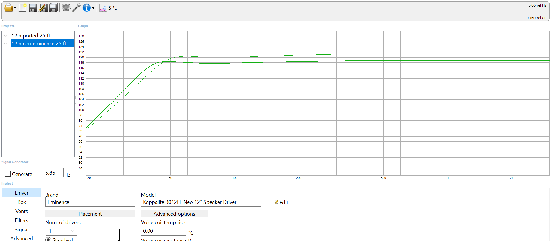

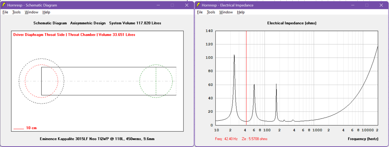

Simulating it in Hornresp showed similar results, but with a more realistic high frequency behavior.

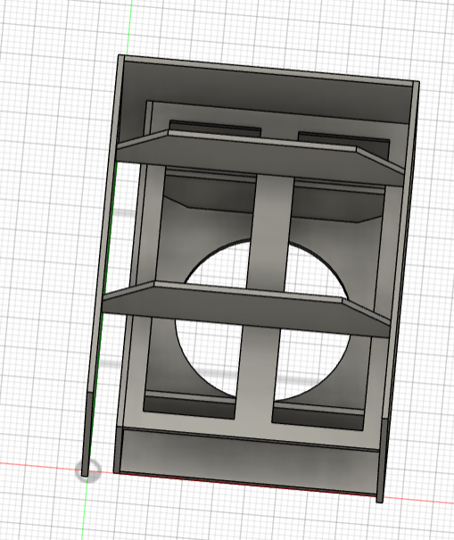

And my bracing plan below

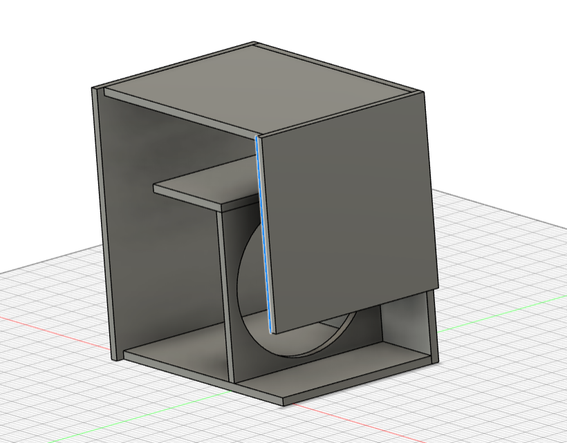

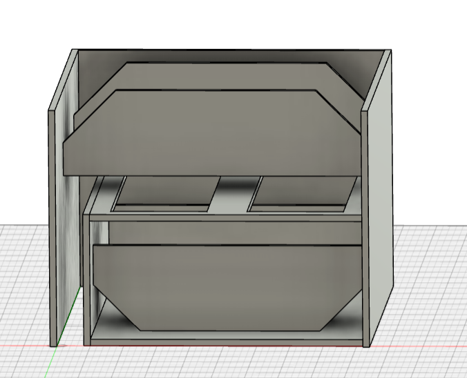

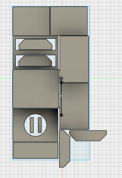

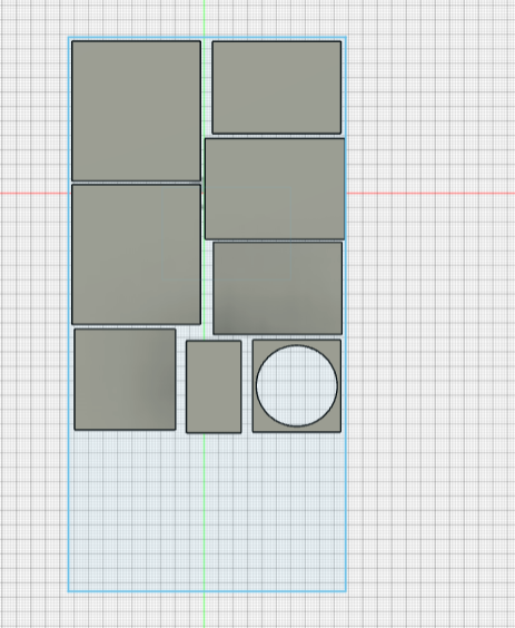

Thanks @BP1Fanatic ! I'm guessing you are recommending building that? What kind of horn would that be called? transmission line?
What are the benefits of that horn? It seems to have about the same power as the one I designed with a narrower less stable workable band.
I modeled it in F360 and it does seem to be a bit smaller and use less material. And it would be firing facing front/back/side rather than straight down.
Compared to the parts from my design, when overlayed on an 4'x8' sheet. With mine much of the extra wood is due to bracing. What kind/how much bracing would your design need?
Using a bass tube with 2 inch pvc pipe to lengthen the port would be a whole lot lighter to tow. Adjusting the port length to the desired sound . A pair of ported 6×9 speakers may work really well
@stocktrader200 what do you mean by 6x9 speaker?
Otherwise when I looked at traditional ports even with 2 4" ports the port air velocity was far too high. I had to have 4 4" ports or 2 6" ports to have a reasonable port air velocity
Yes. It's a tapped quarter wave pipe or tube (straight flare tapped horn with a compression chamber).Thanks @BP1Fanatic ! I'm guessing you are recommending building that? What kind of horn would that be called? transmission line?
View attachment 1397825View attachment 1397826
Your 1st pic is missing the panel behind the speaker panel.
Higher efficiency, lower distortion, and built-in speaker protection are the benefits.
Also, my design is smaller than your design with better output in the frequency range you prescribed.
Also, you can move the mouth to side exit or at the bottom. You will have to make the front panel the full height of the enclosure and shorten the bottom panel by 6".
This comment made me go back to the tape measure to visualize... and I realized my design while perfect for the trailer would not fit in my storage area in my apartment... and your design is better but still... a little too big.Yes. It's a tapped quarter wave pipe or tube (straight flare tapped horn with a compression chamber).

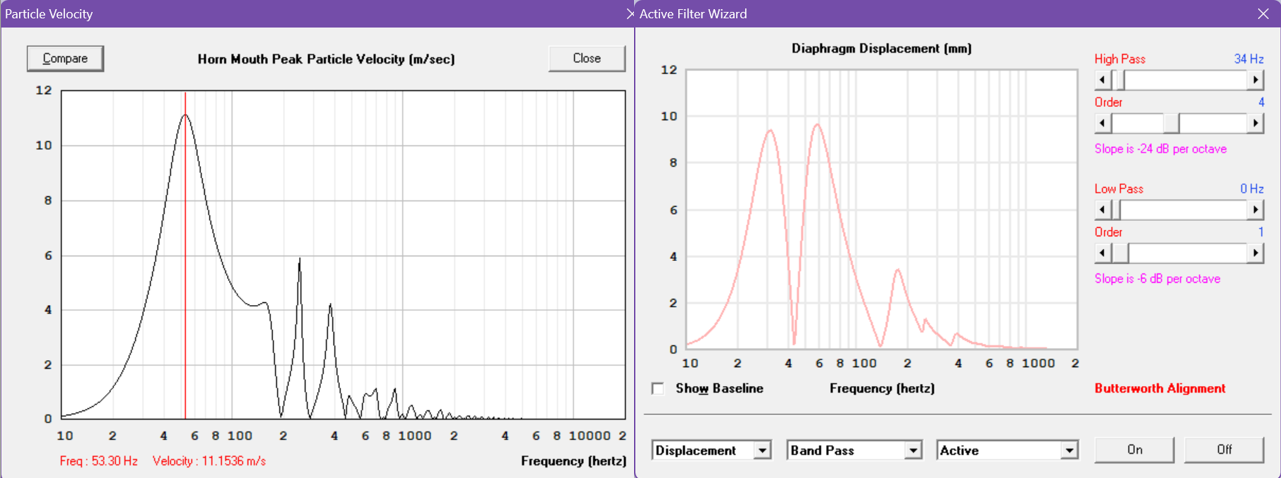

So i'm back to the initial plan of building a tham12 (14x20x22inches)- just bought a 18awg nailer for it.
That will go up to about 150hz (see graph)... though with good DSP programming (which i hope to do) would I be able to push it to 200?

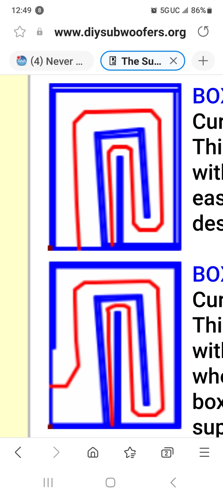

I've not found a good primer on MLTLs; please share if you know of any because i don't know enough to compare or design one.
