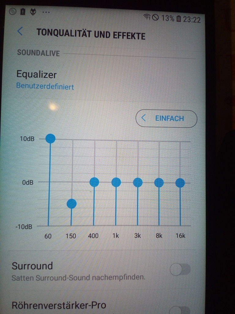

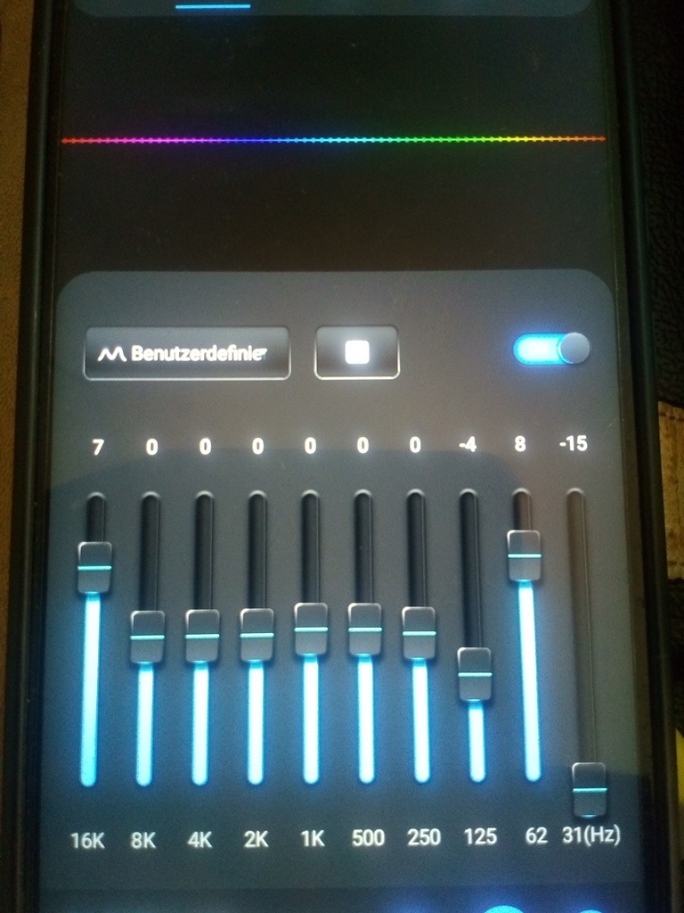

I almost exclusively listen to music via PC and I have already played around with an equalizer (Equalizer APO with the Peace UI) to fine-tune the Tang Bands, so fiddling around with the 12" Fanes will be doable.
Treating the symptoms might not fix the core problem, but if I should have the same reaction as you (which I doubt... I don't really have finely tuned "golden ears" as some on this forum 😀 I can make out details and things, but as long as the speaker is halfway decent, I can enjoy listening to it ). I think I could get by with the equalizer for the time being.
I have read about working on the hardware of the speaker, thinned wood glue, tin foil, accoustic tissue around the whizzer, etc. But I haven't really read much up on it, that's still to come.

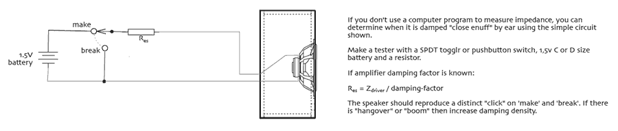

........but we can cut (Vb) in half as long as we maintain tuning, though of course the vent will be a lot longer, which in turn ideally requires 'critical' damping to quell the vent's pipe organ modes comb filtering with the driver's output, rolling off the LF even more, though often a good compromise in a small room and/or corner loaded; or if we maintain the same vent length/higher tuning it too may need 'critical' damping due to being too under-damped in a lively room.
