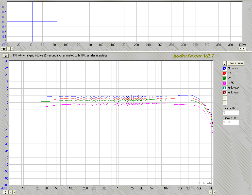

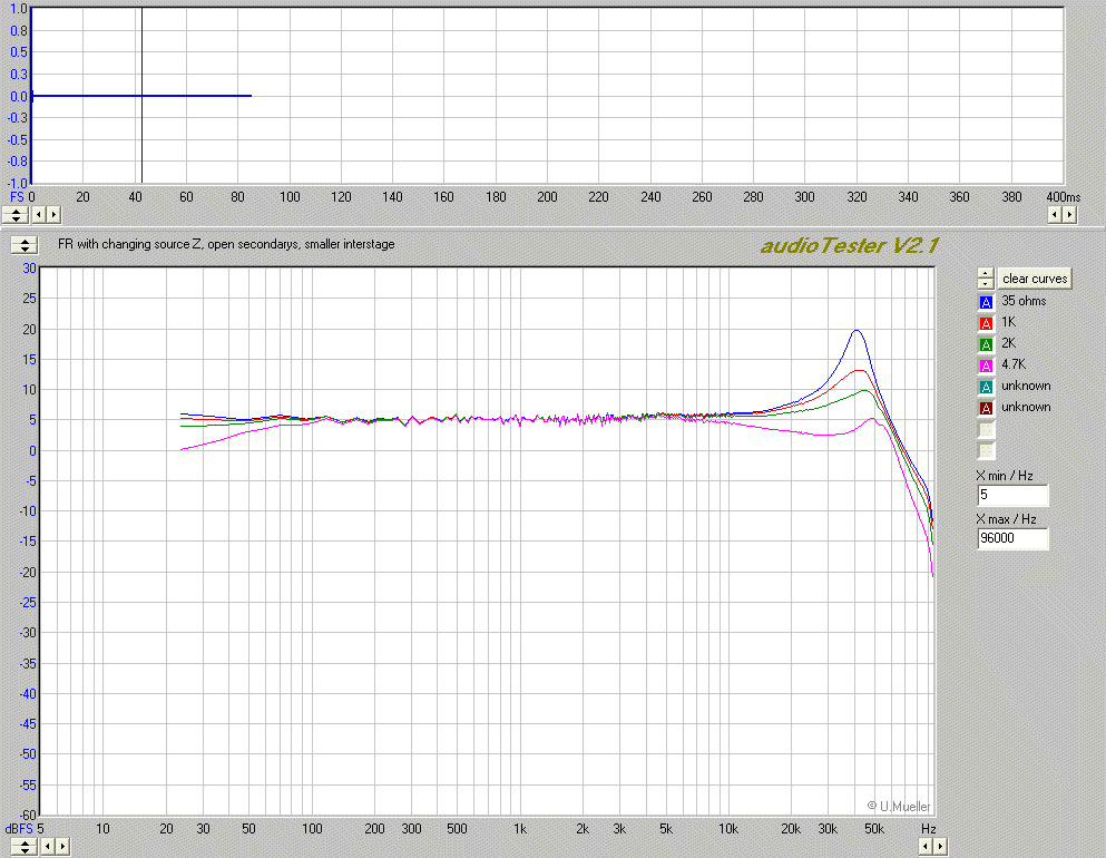

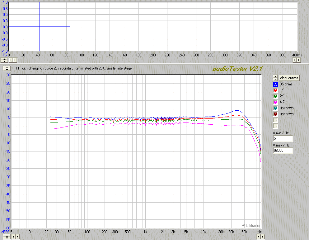

I will post three FR plots of the driver IT you are using in various states of loading. All are fom Gary Pimm a few years ago.
This first one is with the secondaries unloaded.
Thanks, Bud, for reposting GPimm's info about the IT's. That's a good point about the miswiring - it took several tries with the Lundahl's to figure out which set of wires went where. Fortunately, they don't need to be in-circuit to do the test with the signal source and the scope. Just attach the clip-leads and go for it.
The comment about the independent trimming of the RC loading was meant seriously; use the same R's, but independently trim the C (which only need to be a few Pf anyway) for each half of the secondaries. If I recall right, Peerless even disguised small balancing caps inside one of their famous PP output transformers just so they could be capacitively balanced at HF - so it's not like it hasn't been done before, and by famous Western Electric engineers at that.
