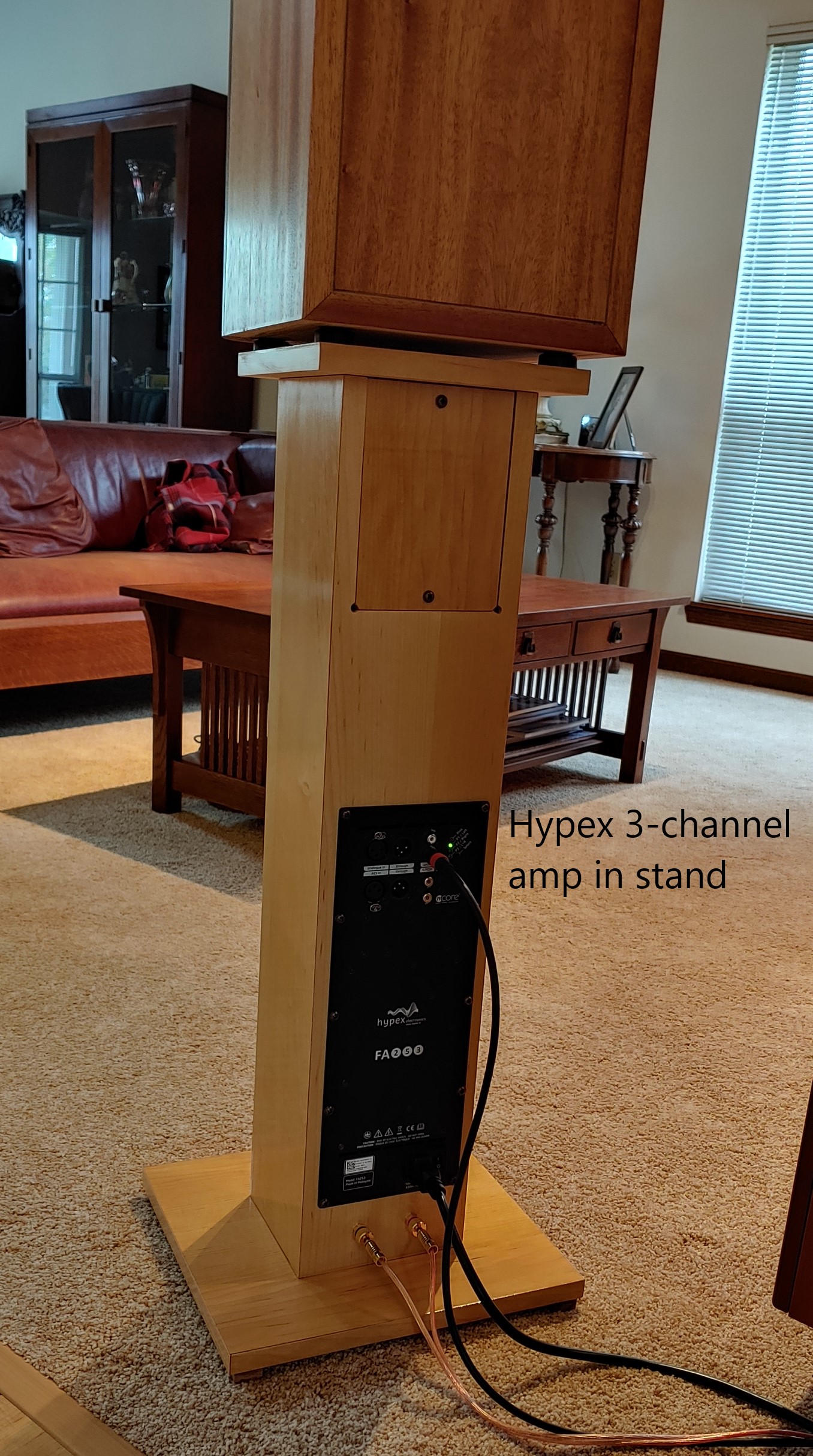

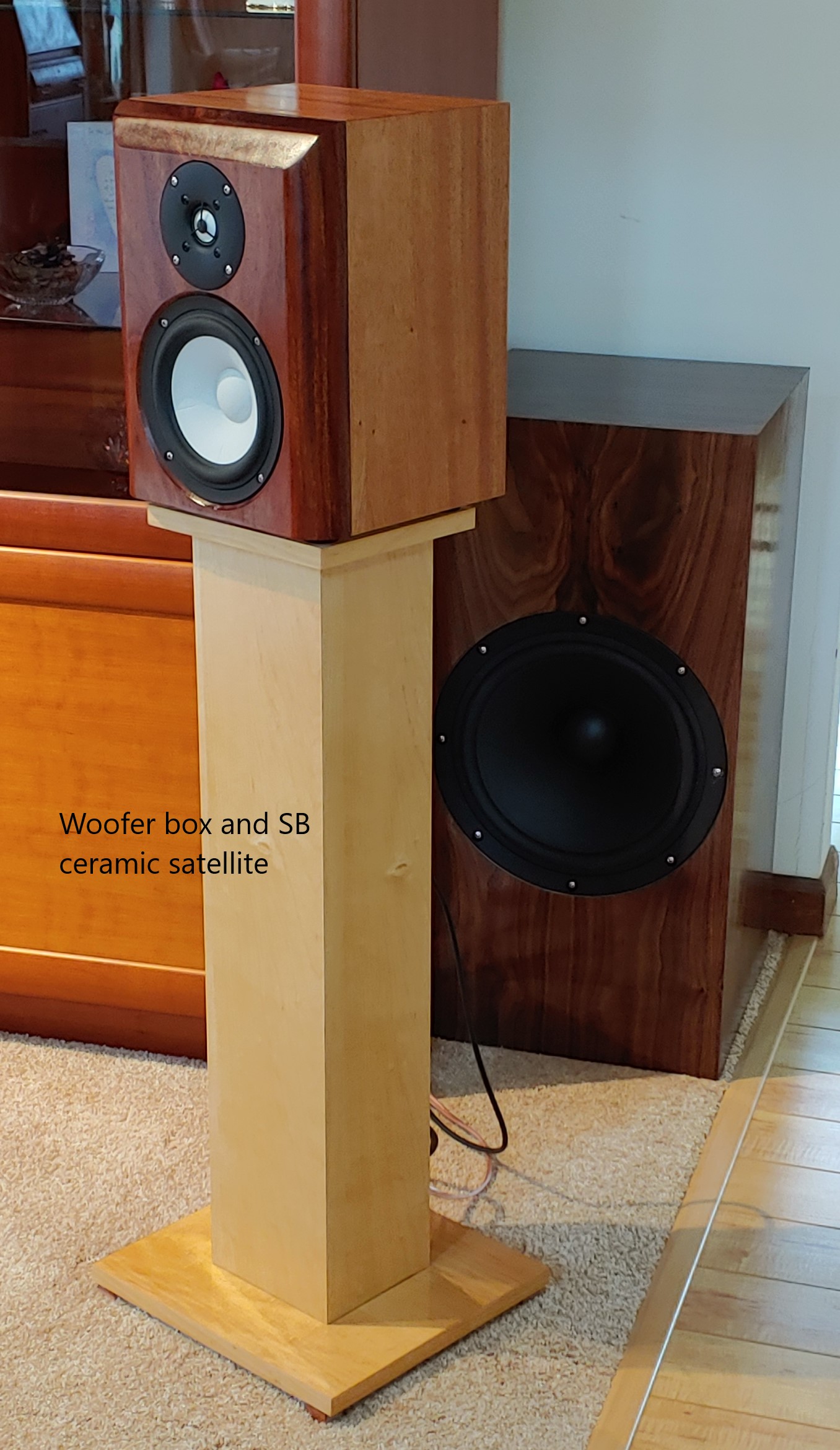

Last year I completed an active 3-way system with SB 12” woofer, SB 6” ceramic mid driver, and SB 1” ceramic dome tweeter. The Hypex amps located in the satellite stand, providing 250 W for the woofer, 250 W for the mid, and 100 W for the tweeter. The bass driver is mounted in its own cabinet, located a few feet behind the satellite. Crossovers are 200 Hz and 2 kHz. I have been astonished at how excellent the SB ceramic drivers have been. https://www.diyaudio.com/forums/multi-way/352767-active-3-hypex-sb.html
I always intended this system to be a learning experience, and I had always planned to build a more refined system later using better drivers. Originally, I was leaning toward ScanSpeak revelators or illuminators. I plan to keep the woofer boxes, and with the modular design with the amps in the stands and separate woofer boxes I can painlessly update the satellite speakers.

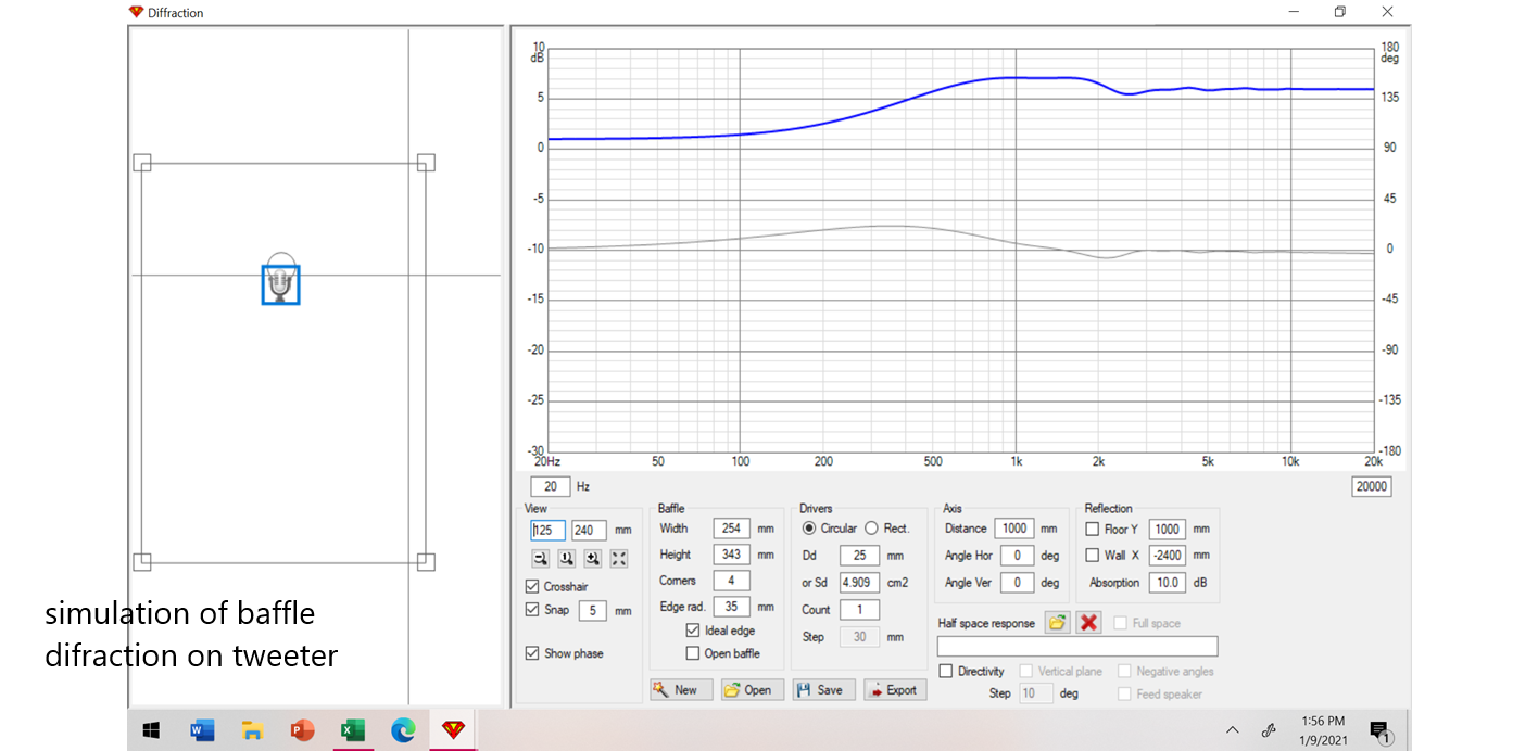

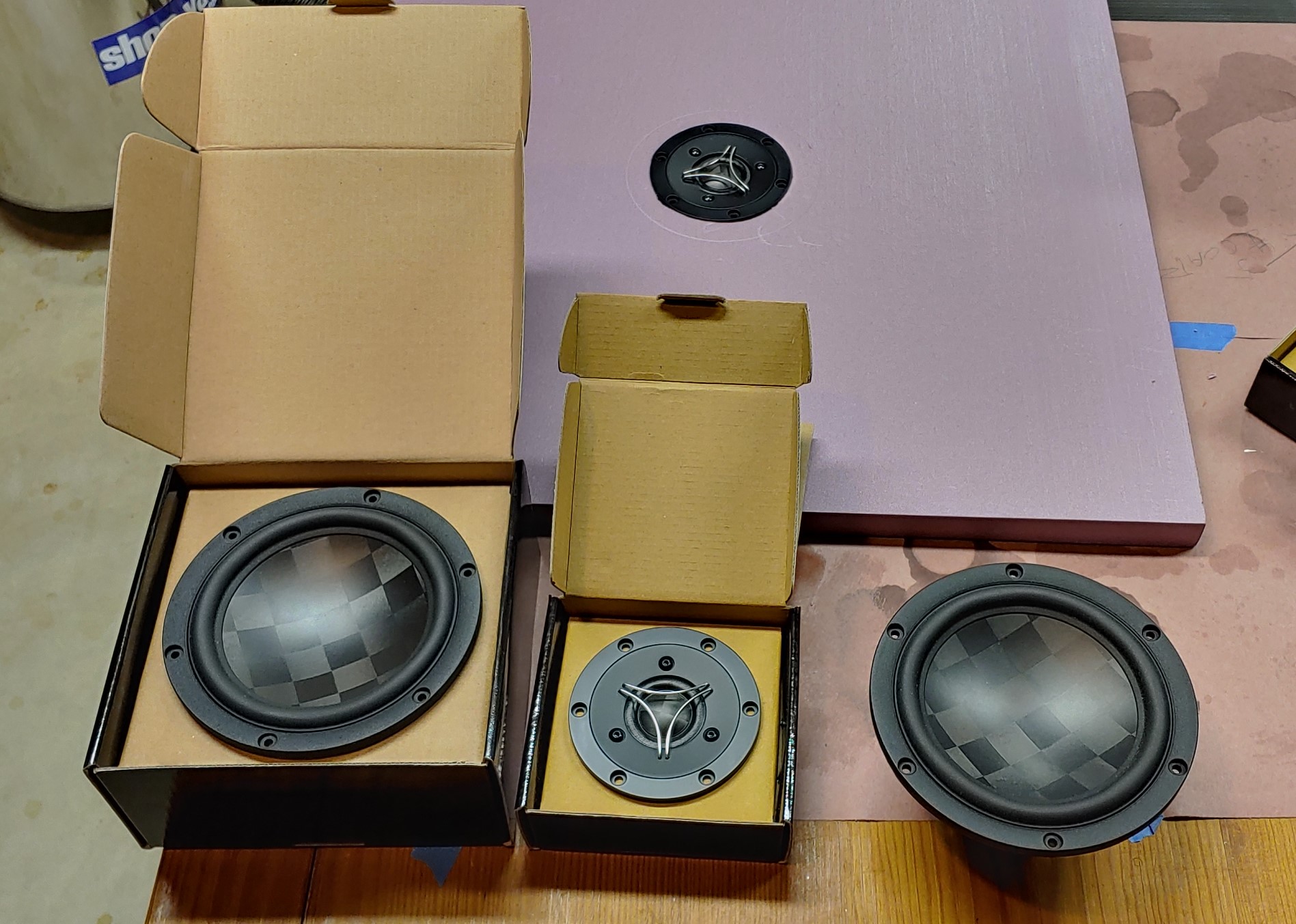

In October I purchased a pair of Satori textreme tweeters and a pair of Satori textreme 6” mid drivers. I made a set of measurements using a 24” x 24” test baffle, and later a prototype box. I posted the results here Link. https://www.diyaudio.com/forums/multi-way/343831-sb-acoustics-textreme-61.html post 608

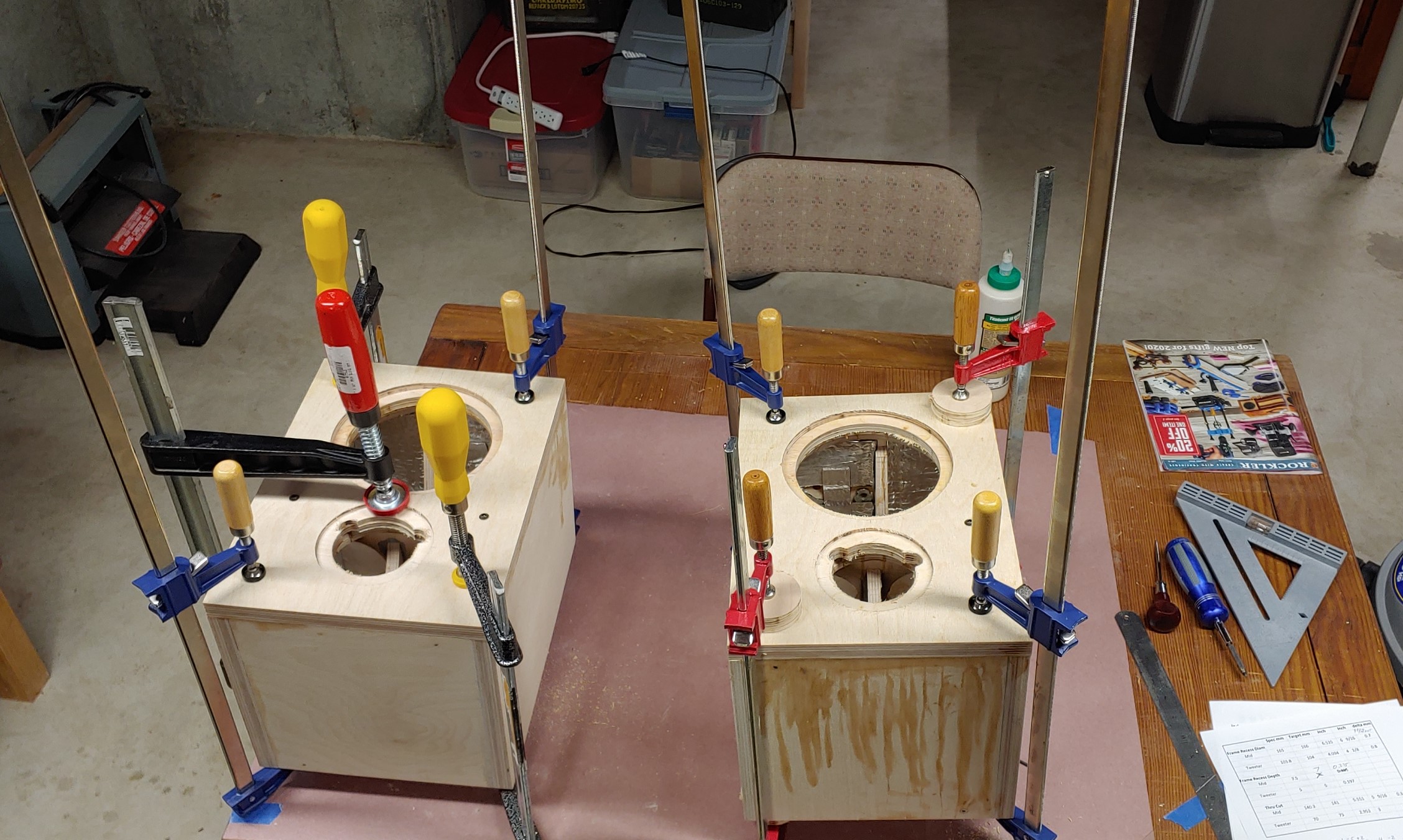

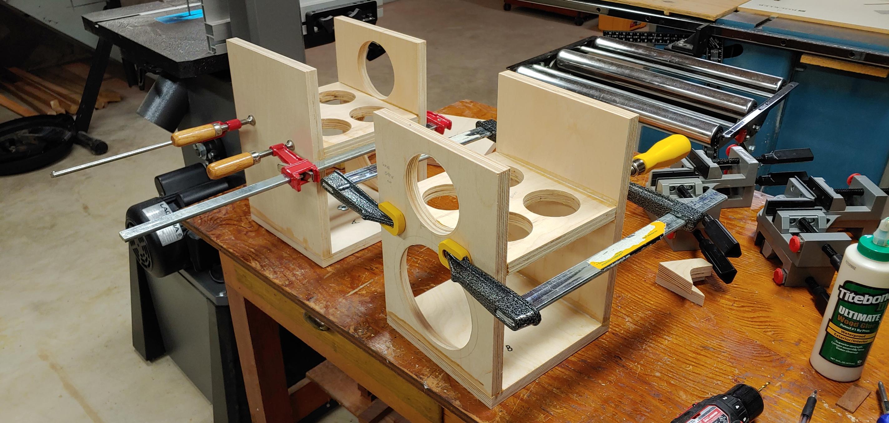

I have begun construction of the new satellite speakers. The new cabinets will be similar, but not quite identical to the old ones. Like the SB ceramic boxes, I do plan to build a double thick front baffle, 1.5 inch thick. The sides will be profiled with a 1.5 inch radius round-over bit, exactly like the SB ceramic boxes. This new build will use a 2 layer plywood baffle instead of a composite solid wood / plywood baffle. Before I did not have enough experience with veneer to confidently apply it over a curve, so I used solid wood. Now I know I can do it with veneer. The top edge will be chamfered at 45 degrees to a depth of 1.5 inch.
The SB ceramic box is 13" H x 10" W x 9" D. The new box will be 13.5" H x 10" W x 9.75" D. So slightly taller, slightly deeper. The arrangement of the internal braces will be different. I learned a lot while making the first cabinets ("learning" is code word for screw-ups). I attached my simulation of the baffle diffraction effect on the tweeter response.

An update: Construction is going well.

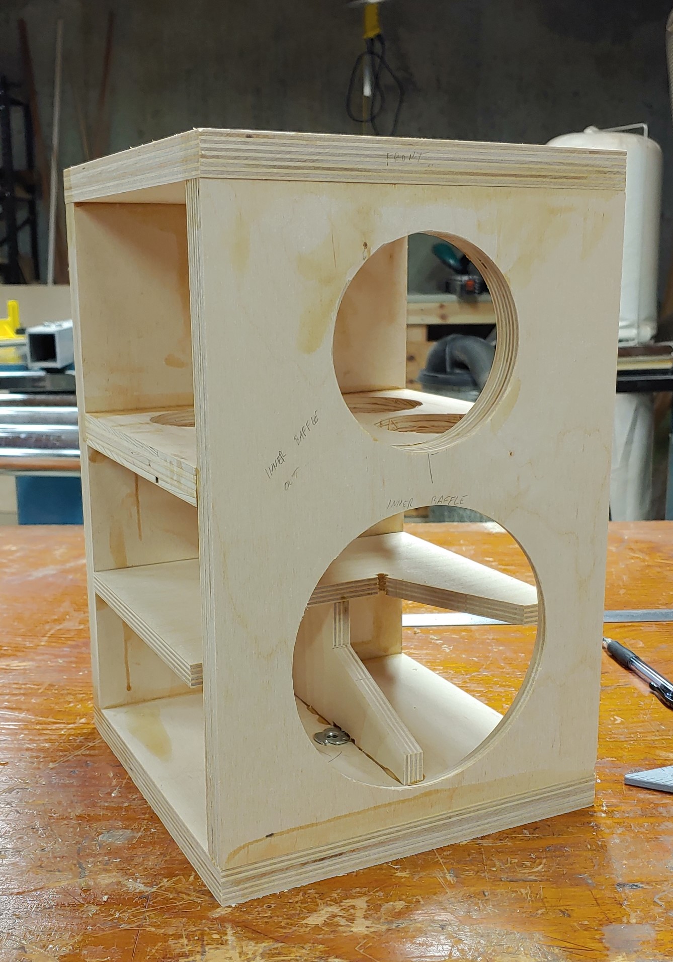

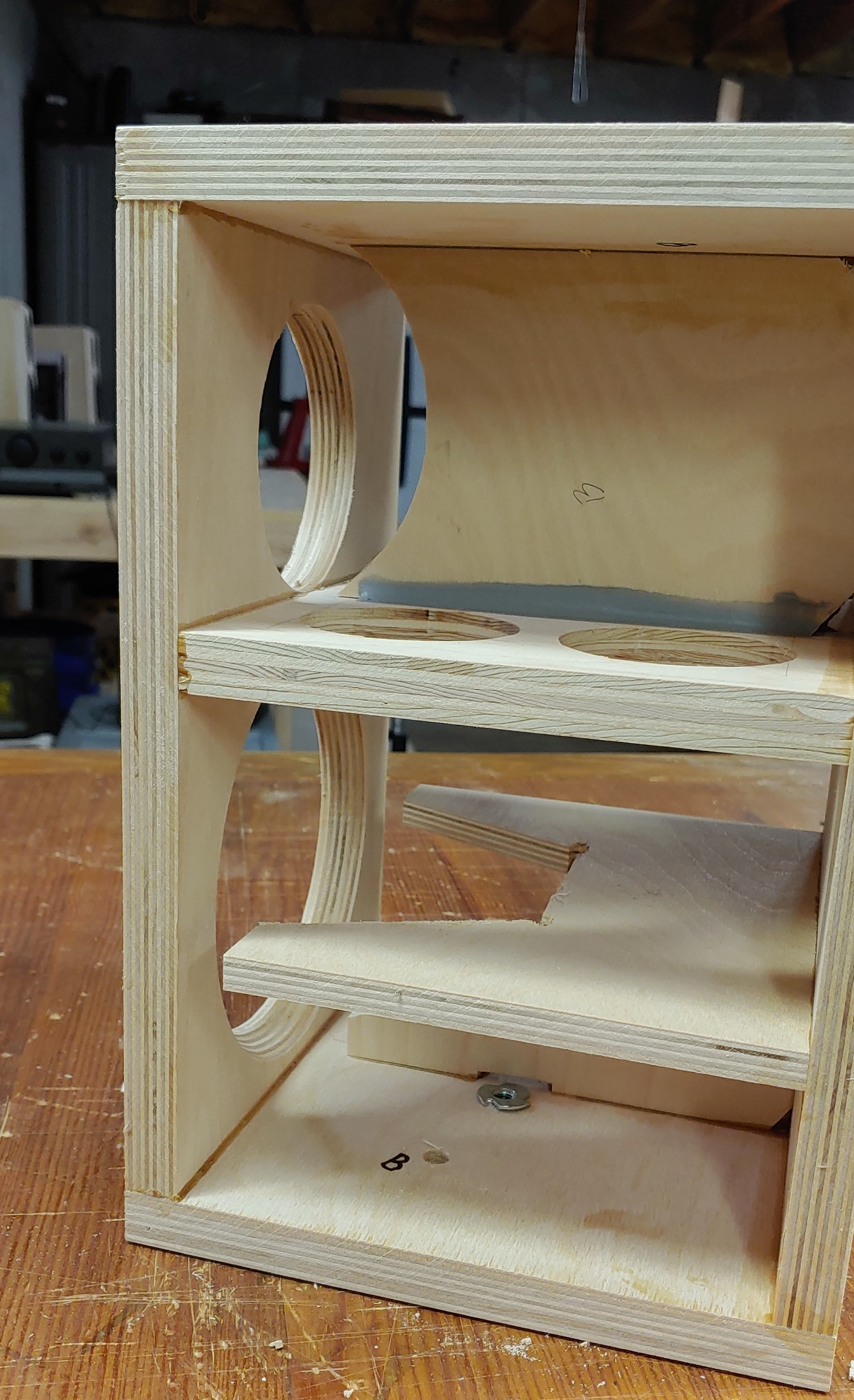

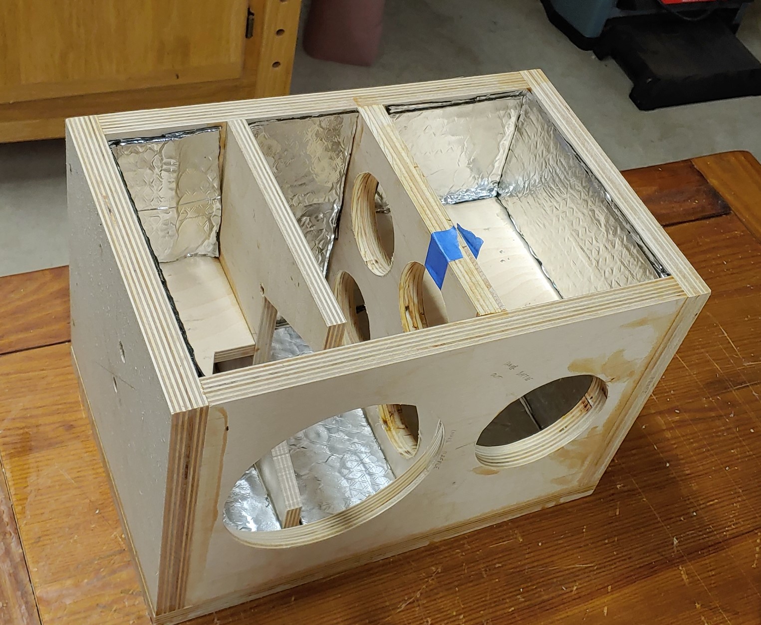

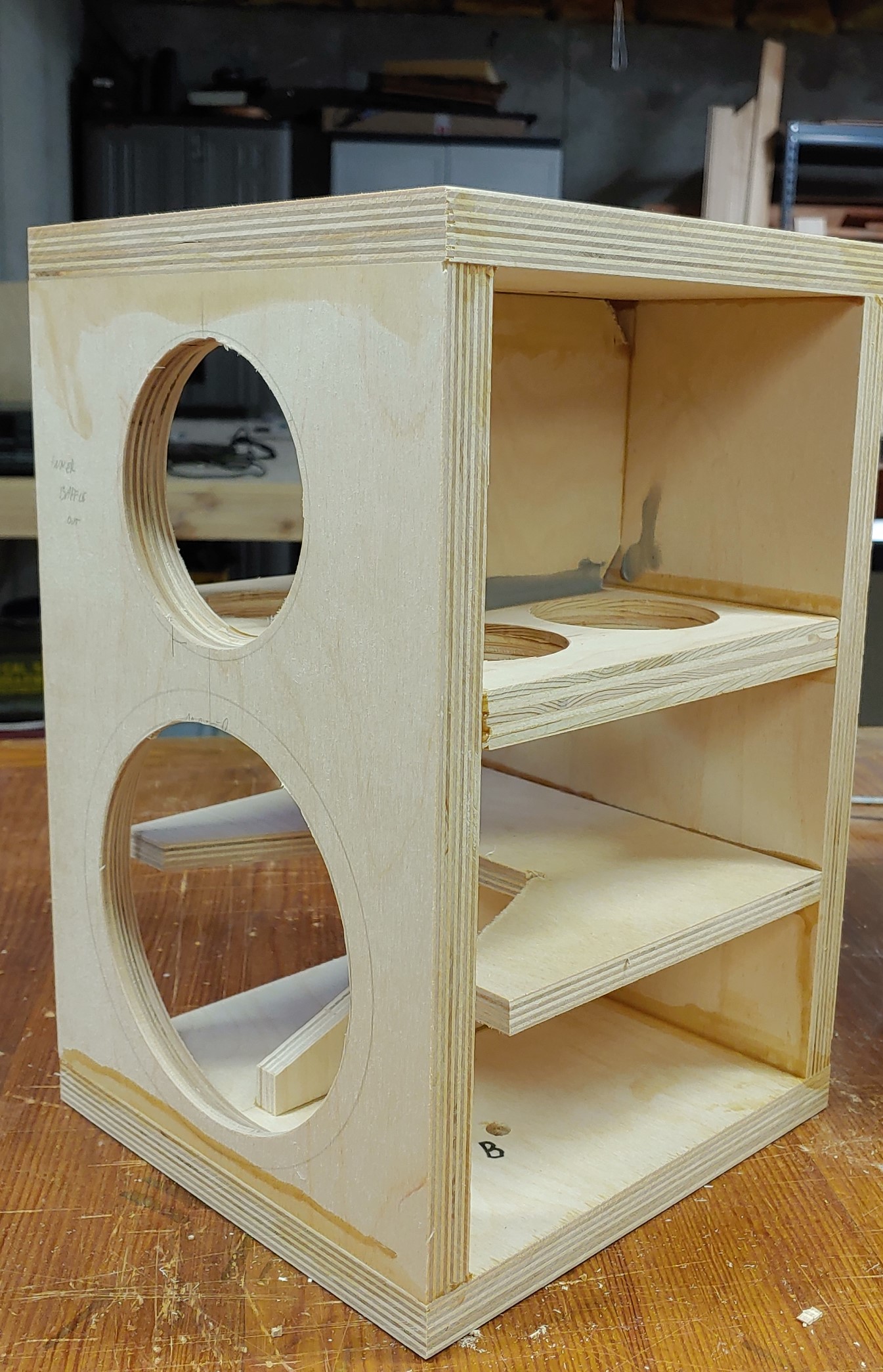

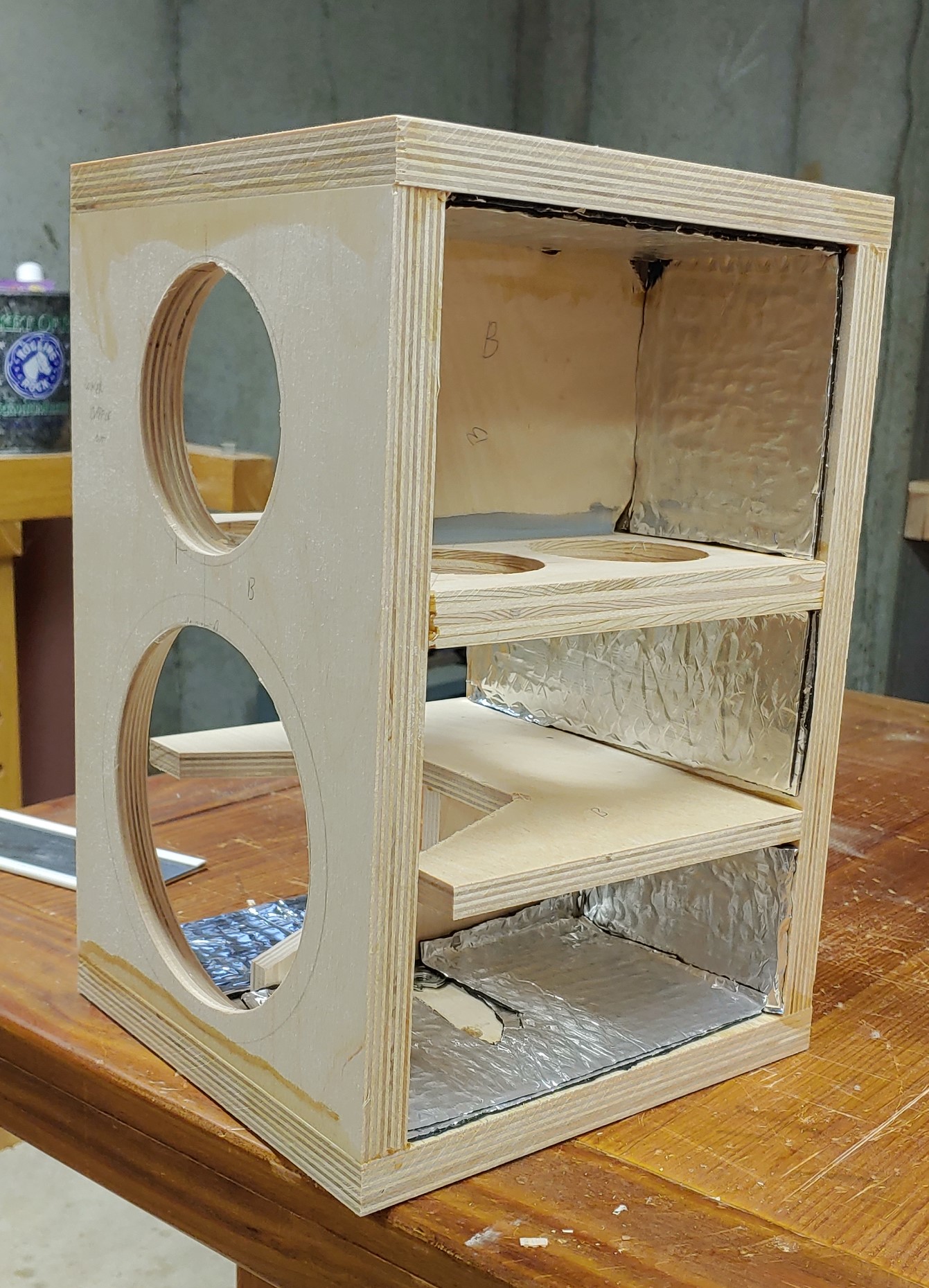

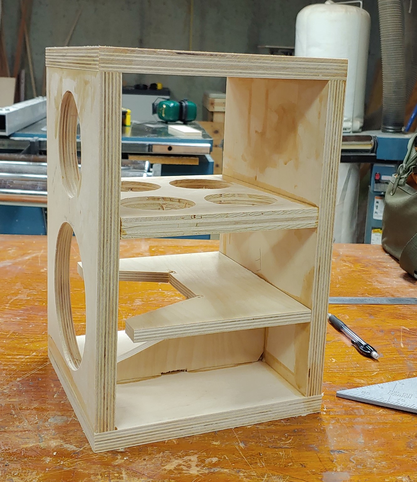

I have included some photos to show the complete bracing scheme I am using. In my SB ceramic build last year I used a full “wall to wall” matrix design. It was a difficult construction because of dimensional tolerance build-up in all the internal parts. Every brace had to have a precise meet-up on all four edges. This time I thought about how to achieve the same level of stiffness but with a design that was more forgiving of small variations in dimensional tolerance. With this new design, only the main bulkhead brace (the horizontal shelf with four holes) is dimensionally constrained on all four edges. The other bracing is constrained on just two or three edges.
I am covering the interior walls with Noico butyl sound deadening mat. I am using two layers of 80 mil. I do not expect this to have much effect on structural resonances, but it will help with ordinary sound transmission. ¾ inch plywood has a transmission loss of 15 dB (low frequency) to 25 dB (high frequency). I think this Noico will add another 5 to 6 dB to that.
I will use long fiber wool for the acoustic damping (stuffing). I may not have enough, so I will augment it with some Ultratouch shredded denim as needed.
After the two side panels go on, the outer baffle will be fitted and the outer holes cut with a router. Then I will profile the baffle side edges with a 37 mm radius roundover bit. The top edge will be profiled on the table saw to a beveled edge of approximate 45 degree angle.

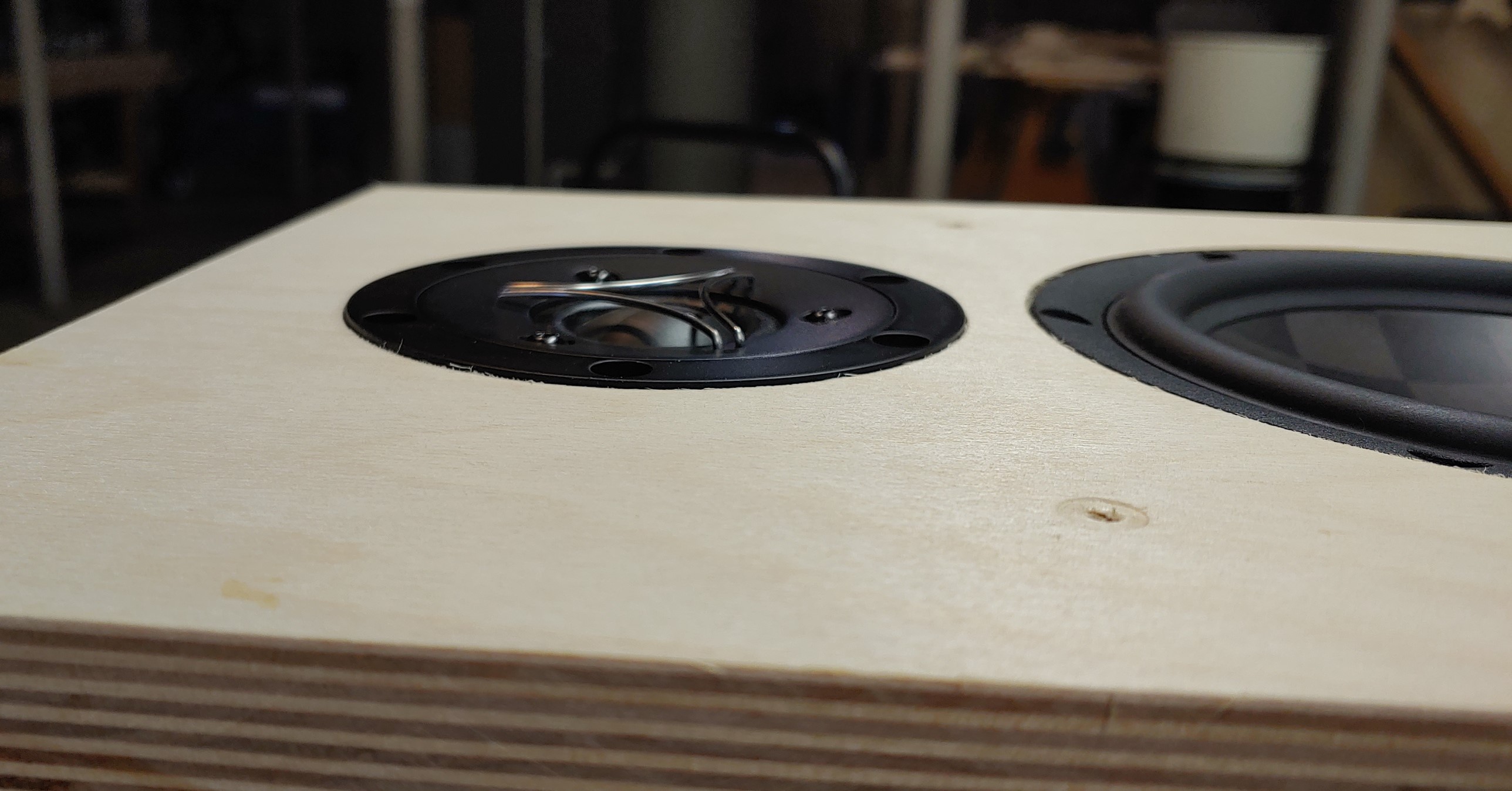

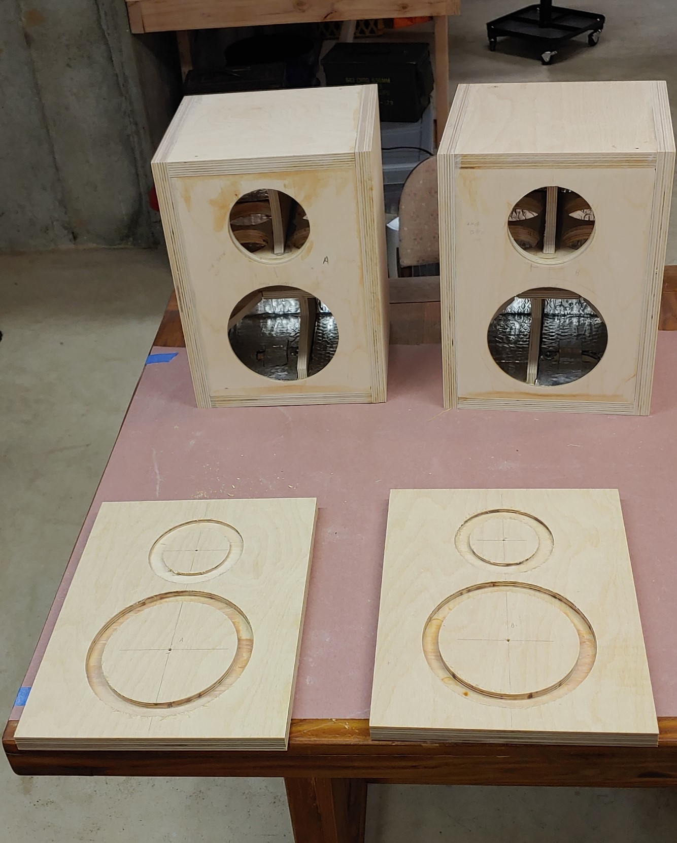

Another update: the main carcass of the cabinet is assembled. Now I am machining the holes in the outer baffle. Just this morning I routed out the frame recess for each driver... after lunch I plan to router out the thru-holes.

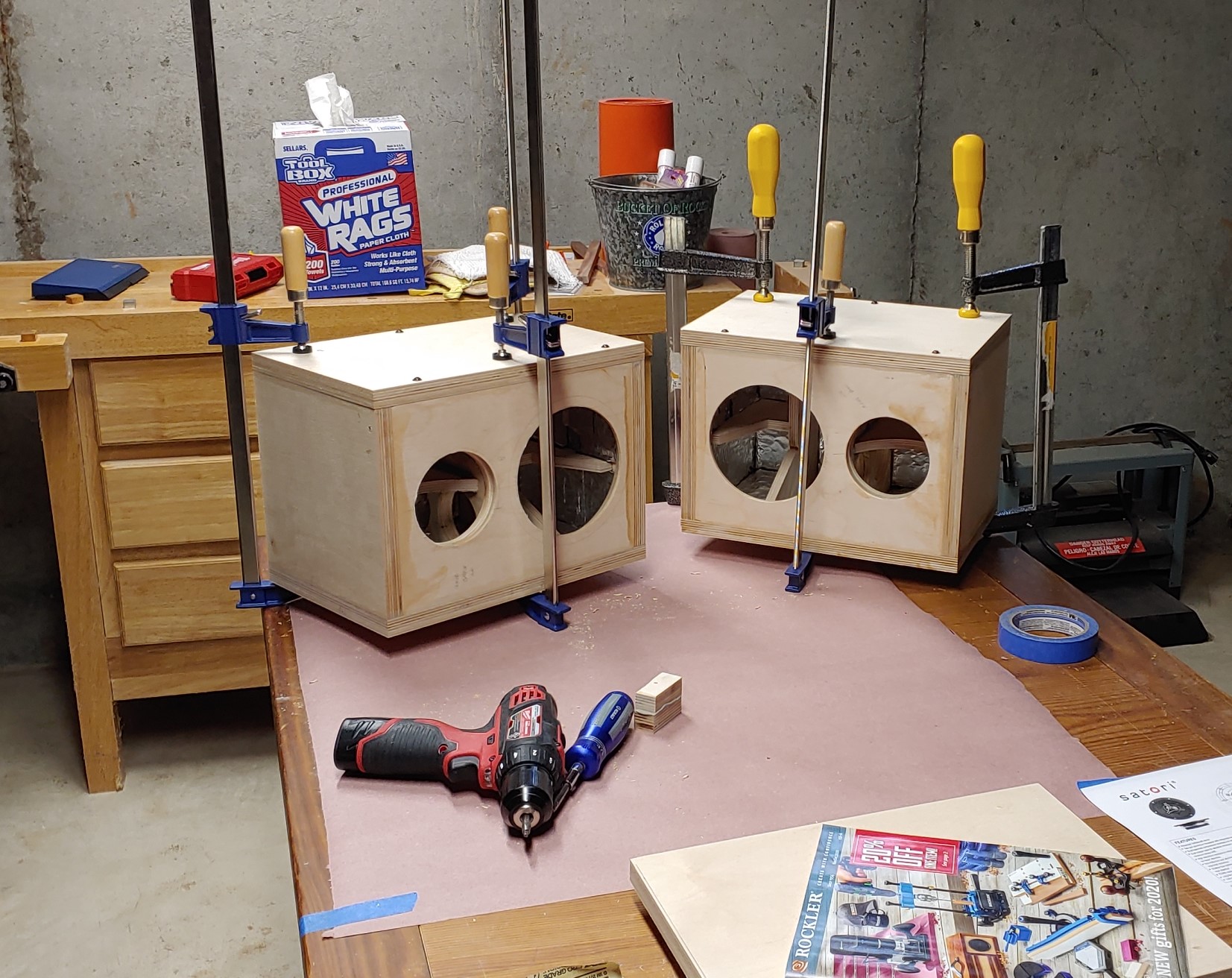

More woodworking... almost done making wood chips and dust (!)
I glued on the outer baffle. Mtidge - Interesting that you used dowels to align things. I have done that a few times on furniture projects. In this case I use temporary screws as alignment pins. Since I am going to fully veneer the cabinet, all those holes will get filled with a little bondo. You can see the screws in the first photo. I use #8 washer head 1-1/2" screws, and I re-use them for a lot of jigs and fixtures in my workshop.
The next photo shows a check for driver fit. The recesses look perfect (this is the first time I got them all perfect the first time).

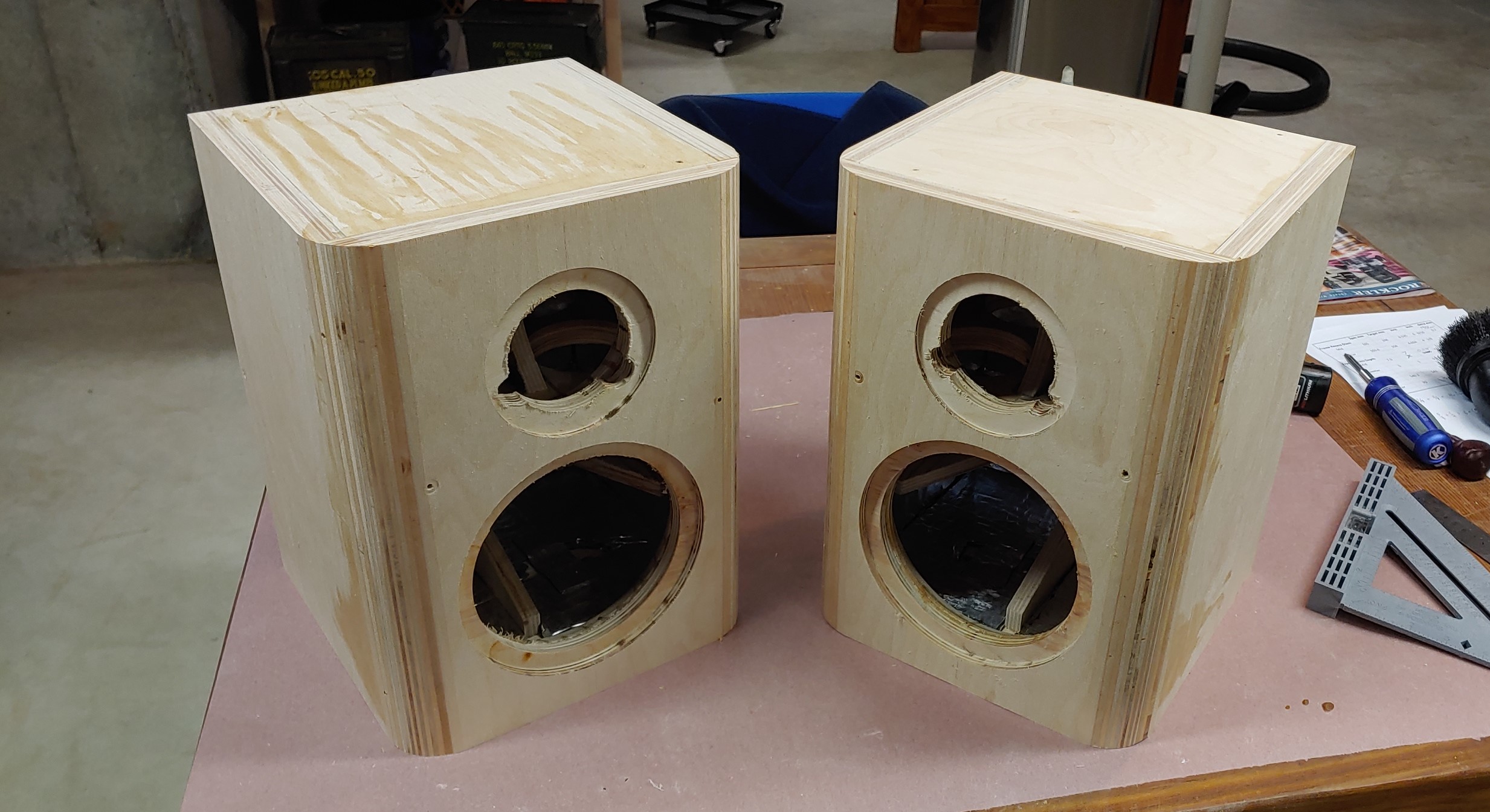

The next photo shows the round-over cut on the sides. This is a 37 mm radius round-over. I think I made over a cubic foot of shavings. Running the router table is my least favorite part of any woodworking project.
Next step is to bevel the top edge, which I will cut on the table saw. Fedex will be delivering the veneer this weekend.
A few words about glue: Up to now I have always used just two adhesives in speaker cabinets... Titebond (PVA) wood glue was used for most joints. Where I needed gap filling capability, I used West system epoxy thickened with microfibers and colloidal silica. I always have West epoxy on hand for boat repair work and I have a lot of experience with it. However, I was advised by several folks on this forum to try Loctite PL. So instead of epoxy, I used Loctite PL-Max whenever I needed a gap-filling adhesive. It seems to have worked really well, and was significantly less messy.
