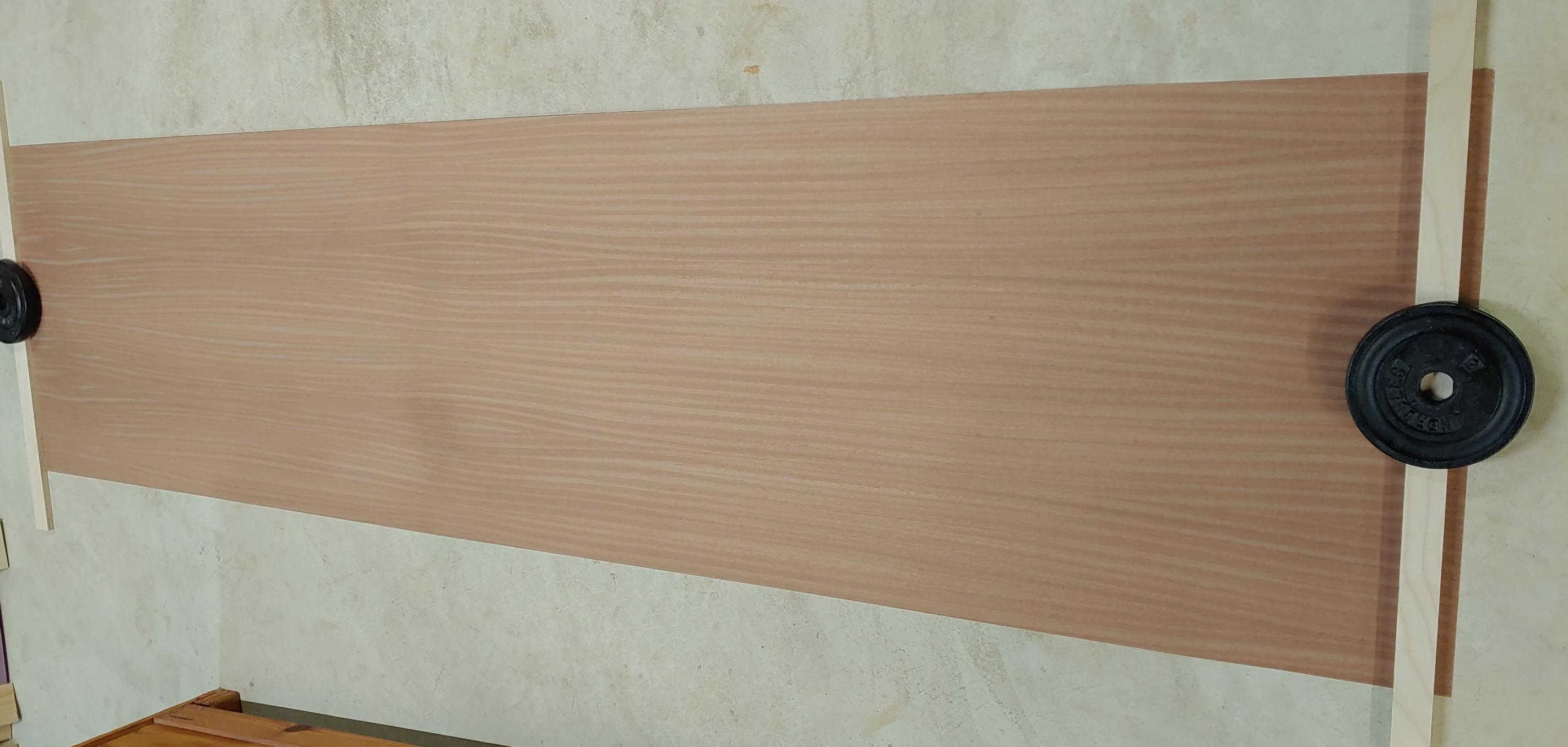

The veneer arrived yesterday. This is the first time I have worked with sapele veneer. The sheet I have is 24" x 96", with PSA backing (peel and stick). This quarter-sawn veneer looks quite nice, and will offer some variety in my living room. Some woodworkers poo-poo PSA backed veneer, and for really large projects like dining tables, conference tables, large display cabinets, it is better to use paper backed veneer and contact cement... But for the relatively small sizes of speaker cabinets (in comparison to large furniture), I think PSA has enough adhesion and is very convenient.

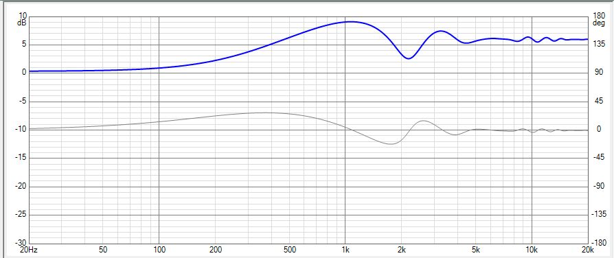

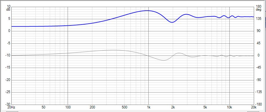

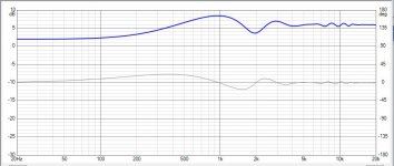

I made a baffle diffraction simulation with Vituixcad and I showed it in the first post. Since this is an active design, I can compensate for the baffle step easily. But upper-level diffraction (i.e. above 1.5 kHz) is difficult or impossible to compensate for with DSP eq... So my thought is to just minimize diffraction as much as possible. The simulations show that as the radius increases, diffraction effects drop. By the time the radius increases to 30mm or more, diffraction has been almost completely mitigated. Nearly any baffle shape results in a good response if the edge radius is 30 mm or more… rectangular, trapezoidal, elliptical, square, circular, all are good. Bottom line, even though I am using DSP EQ, I think it is important to simulate the baffle to ensure it does not have a diffraction problem which would be difficult to correct later.

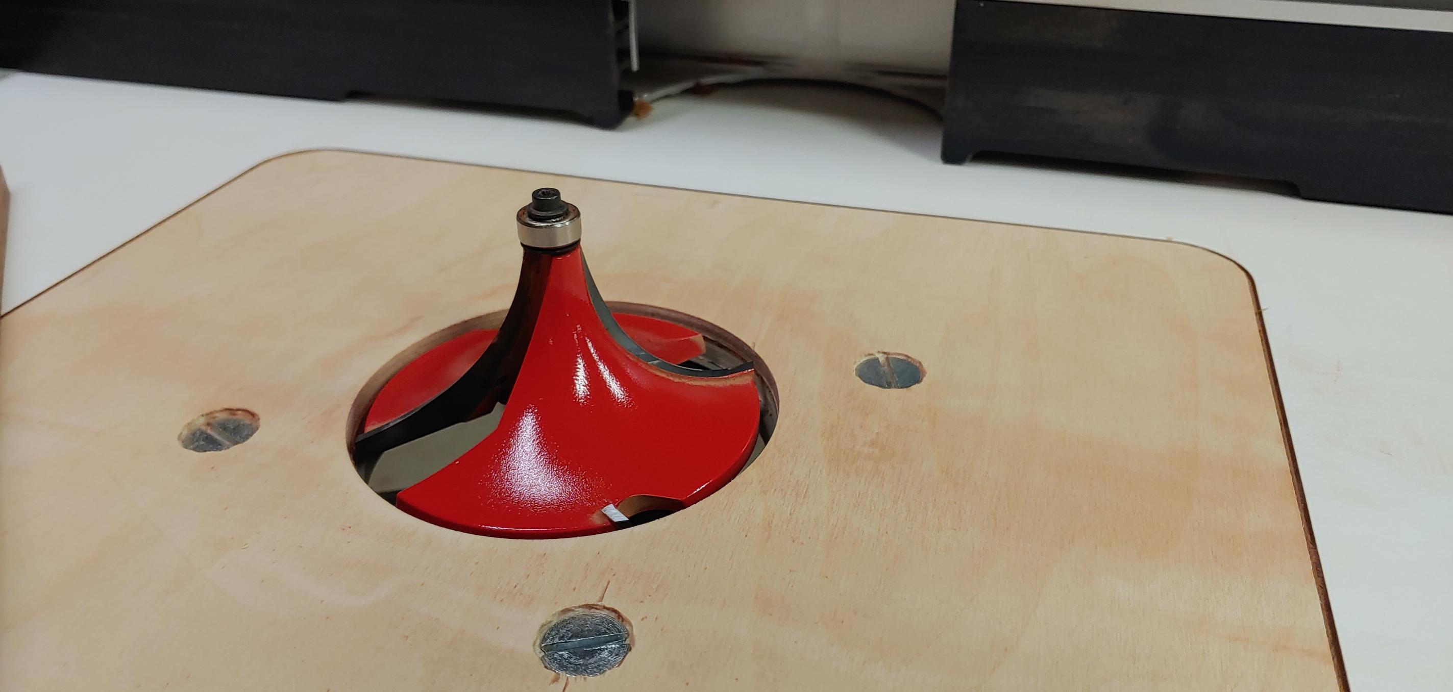

Here is a picture of the bit I use… It is a Freud bit, and it performs very well. It is the "Freud 1-1/2" Radius Rounding Over Bit, 1/2" Shank (Quadra-Cut) (34-140)". Highly recommended. When using this bit, we need to use a powerful router and a speed of no more than 12000 RPM. It is so large, it does not fit in the standard base plate of my router table... I had to make a special base plate from plywood with a extra large hole.

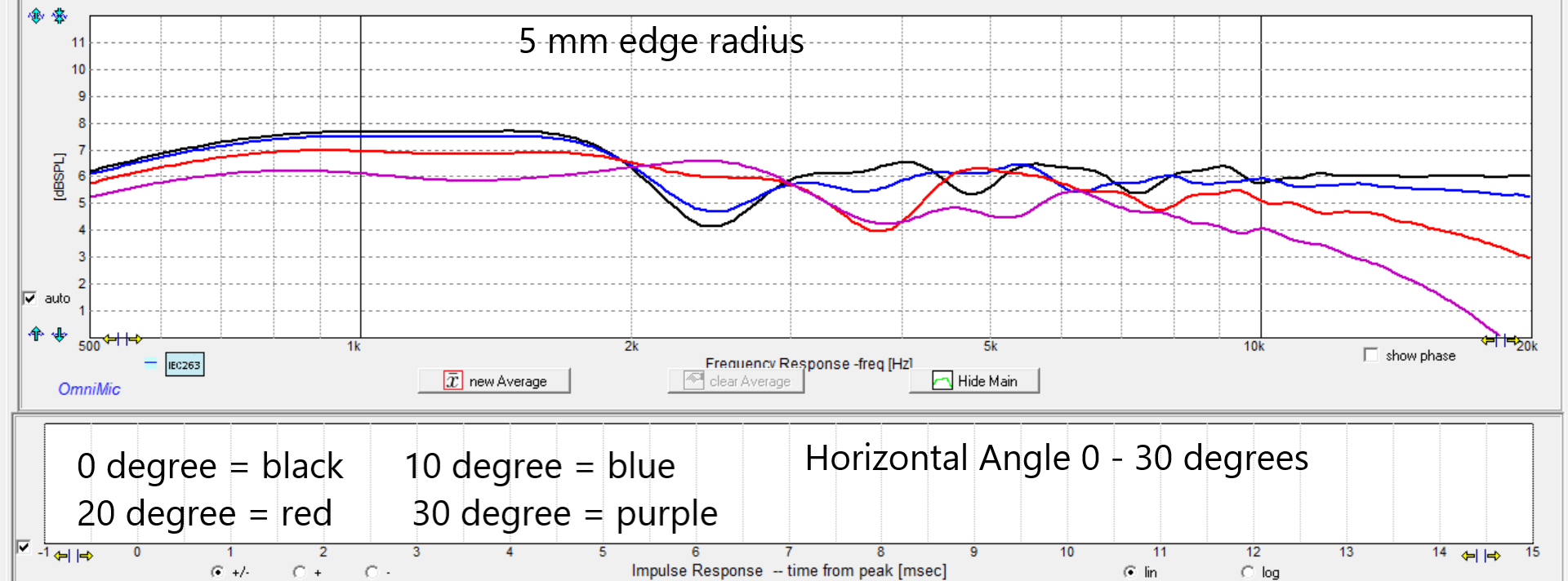

I wanted to pull on the line of thought that zman and YSDR brought up. Baffle edge diffraction. We all know it affects the frequency response of drivers, mainly above 1500 Hz. I believe that that cabinet edge diffraction has an effect that goes beyond its impact on frequency response. It affects the 3-dimensional quality of the music. This shows up mostly on music that has preserved that aspect through the recording/reproduction process. So there is no doubt that I was going to build a low diffraction cabinet for this system. But there is another advantage to a low diffraction cabinet: It simplifies the DSP filter design process.
One of the steps in designing a DSP filter is EQ’ing the drivers to be flat in the pass band and for at least one octave beyond the crossover frequencies. The drivers should be EQ’d to the point where they appear flat when viewed with 1/6th octave smoothing. However, the response we want to EQ is not the on-axis response, but the listening window response. Without getting into too many details, the listening window response is the average of many responses across +/- 30 degree horizontal and +/- 10 degree vertical.

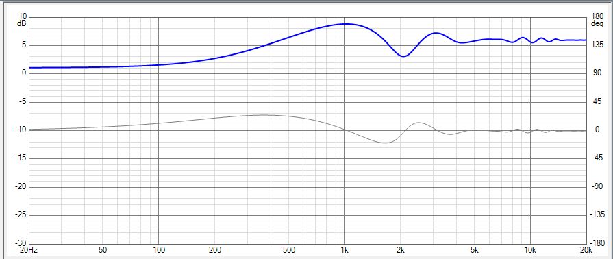

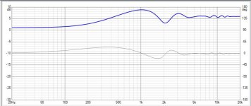

The first graphic shows a simulation of my baffle with a 5mm edge radius. We can see the response at 0, 10, 20, and 30 degrees horizontal. This is purely the baffle diffraction response, thus it is the response we would measure if we were using a perfectly flat driver. There is a lot of variation from 2k to 8k in the range of +/- 1.5 dB. When averaged across the listening window, it might turn out to be mostly flat, i.e., all those peaks and nulls might cancel each other out. But every time we make a DSP filter adjustment, we would have to re-measure the entire listening window again. The diffraction makes it difficult to identify driver response anomalies. We will have to make sure that any narrow band EQ we are applying is actually correcting a driver anomaly, not correcting a diffraction response (we do not want to do that).

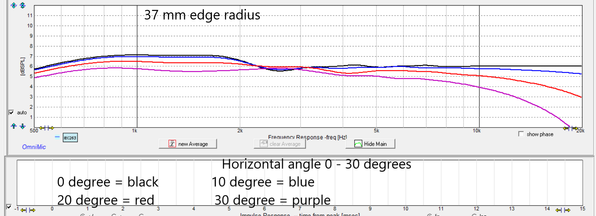

The second graphic shows the same simulation but with a 37mm edge radius. Now we see there is much less variation at 0, 10, 20, and 30 degrees horizontal. Other than the expected high frequency roll off above 8k, the curves are very similar. The simulation tells us that the on-axis curve will be nearly the same as the listening window curve. Once we verify that with our preliminary measurements, it frees us to simply use the on-axis curve as a proxy for the listening window. As we make DSP filter changes, we can simply make an on-axis response measurement. We can have confidence that whatever change we see in the on-axis response will be reflected in the listening window response. I like this freedom. It means I can make a preliminary set of off-axis responses from 0 to 90 degrees horizontal, and then do all my development work without having to change microphone or speaker position. Then at the end, I can make a final full set of off-axis responses 0 to 90 degrees horizontal.

Thanks for sharing the sims. The 37mm radiused baffle does look much better in this regard.

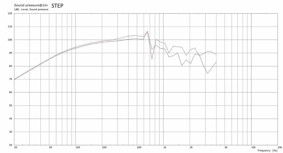

There isn't a huge difference in the effectiveness of a chamfer vs a roundover. Bigger is better for both, a large chamfer beats a small roundover.

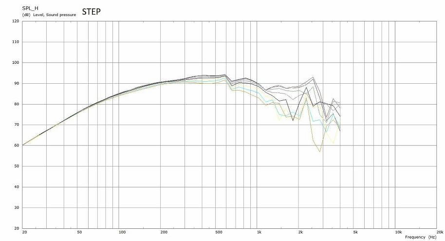

Here is a comparison of the simulated effects of a chamfer, roundover, 13mm step and flush connection of a woofer to a baffle. The outer edge of the baffle had a 36mm roundover in all cases so this is a fair comparison.

1m
With off axis angles

So far I've only tried out VituixCAD's diffraction module and I'm disappointed with it because something in the algorithm is not giving the same results as the other well know programs. Specifically, the correlation above about 1000Hz between the major programs is very good but below that, VituixCAD's BD response varies with the mic distance such that the baffle step loss goes from just under 6db at 3m to just 4db at .5m. Pic 1 below at .5m. Pic 2 at 1m and pic 3 at 3m.
Unless there's some new info about baffle step loss that I'm not aware of, I see this as potentially a serious enough problem for me to give the module a pass most of the time.

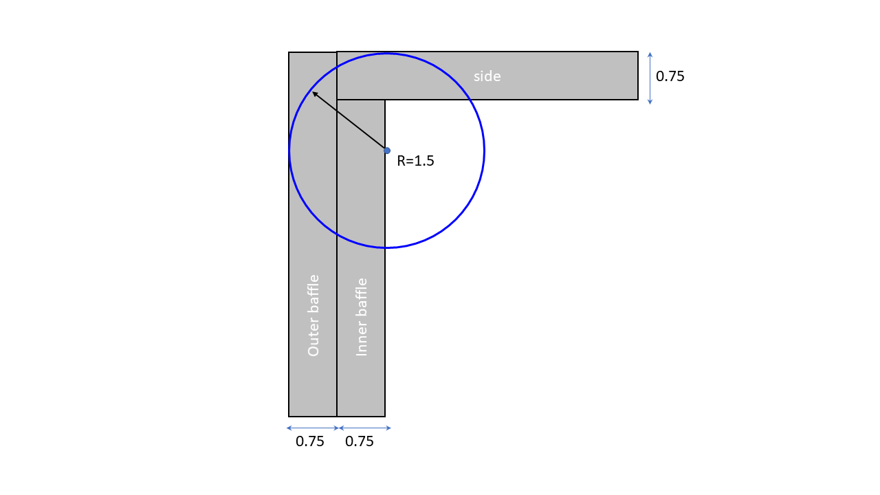

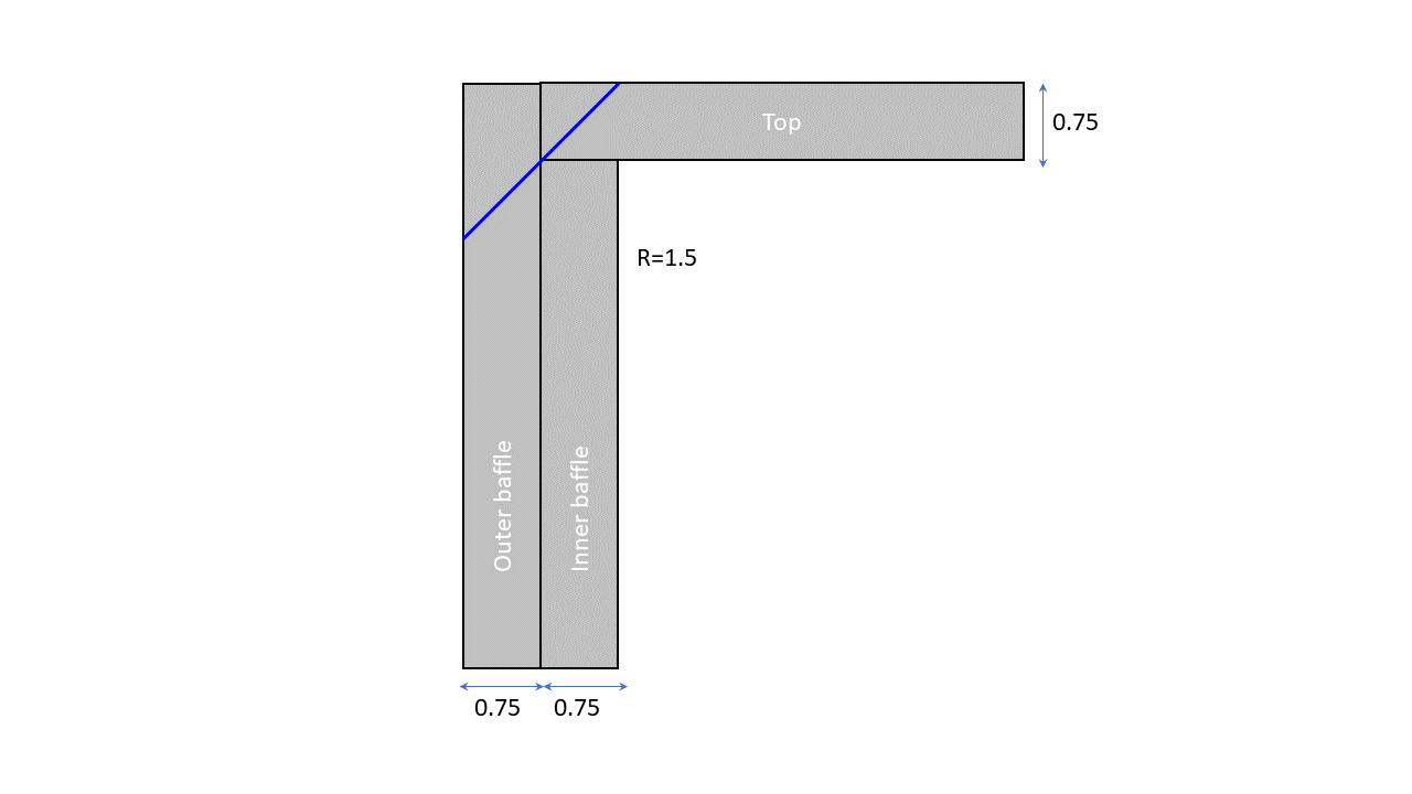

This brings up a question I had, with a 1.5 inch baffle and 3/4 inch sides how thin did it get on the front corners after the 1.5 inch round over? My concern when I see these huge round overs recommended (sometimes > 3 inches) what happens to the structure of the enclosure?

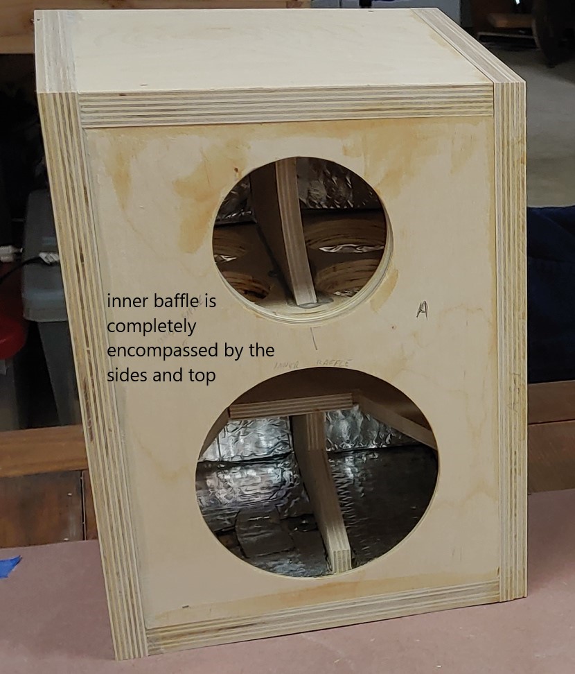

The inner baffle is completely encompassed by the side and top panels. The outer baffle overlays on the inner baffle and the edges of the sides and top. This provides a lot of glue surface. As you can see in the graphic, the 1.5 inch roundover leaves quite a bit of material, and a lot of glue surface area. The 45 degree bevel on the top leaves less material, but there is still a glue joint along the full 0.75 inch thickness of the panel.

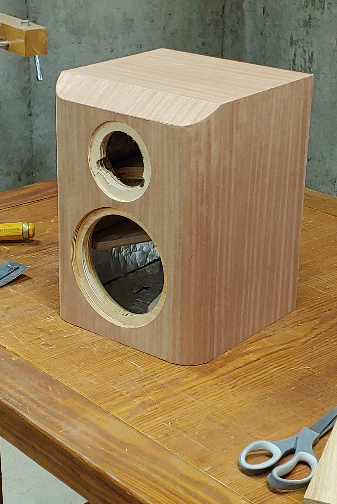

I was able to get one of the cabinets fully veneered. Getting the veneer trimmed flush and the curves and the bevel is "challenging"... I am a veneer newbe, and I struggled with this all afternoon. The second cabinet will be easier (trying to be optimistic). I definitely needed a beer when I was done.
I found a Veritas Flush Plane to be very helpful for this sort of thing, as well as many other's if you have or want to get one. Or a really sharp chisel, but that can be risky, for me at leastI am a veneer newbe, and I struggled with this all afternoon. The second cabinet will be easier (trying to be optimistic).

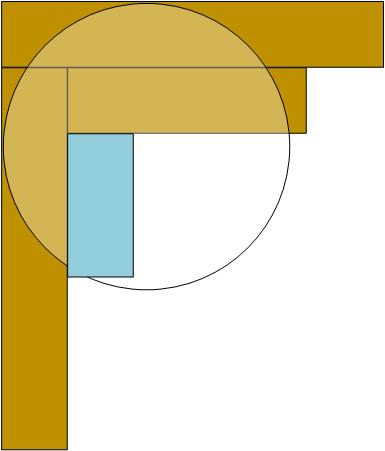

Funny, I just made a similar drawing. My concern is if I have 1.5 inch baffle and cut the corners I don't have a 1.5 inch baffle anymore, at best there is maybe 7/8 on the very corner and maybe less on the side. The blue strip glued to the inside helps my OCD.
