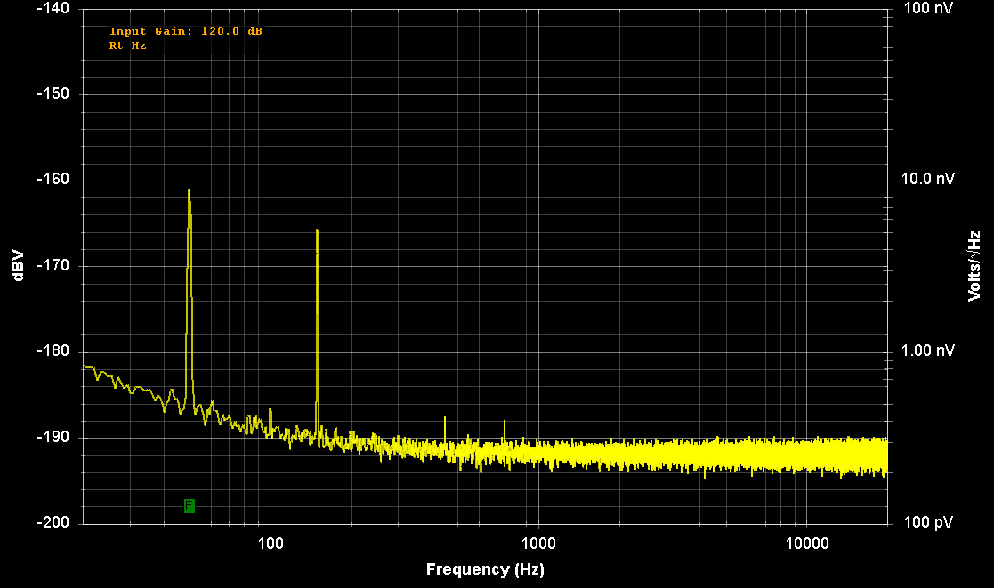

Now that I've had time outside of other preoccupations to actually think about this I'm guessing those harmonics are ADC artifacts. As far as the displayed peak amplitude can be trusted, that 50Hz mains hum fundamental at 1.2nV is only 1.2uV as presented to the QA403 input, factoring in the 60dB pre-amplifer gain: about -118dBV.
Probably asking a bit much of the ADC to sample a signal that small without distortion. I need to jury rig an intermediate amplifier to give at least another 40dB of gain after the pre-amplifier under test; tomorrow - too late now.

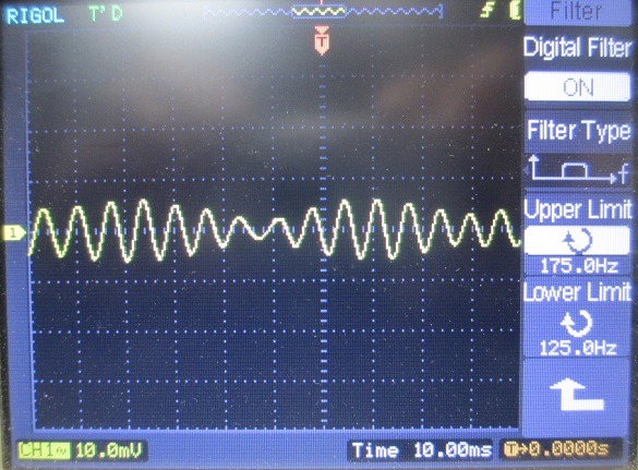

Well so much for that theory. An additional 60dB of broadband gain lifted the 50Hz hum to a healthy mV level, but the 3rd harmonic is still there:
On the DSO rather than QA403, with the digital filter applied to band-pass 150Hz:
That rules out the QA403 - I'm verifiably sitting in a 150 Hz hum field here.
Nothing on my property is radiating this. Has anyone else experience this? Are any major appliances such as HVAC systems notorious for 3rd harmonic distortion on the mains? Electric lighting controllers? Is my neighbor doing something hydroponic in his adjacent shed??

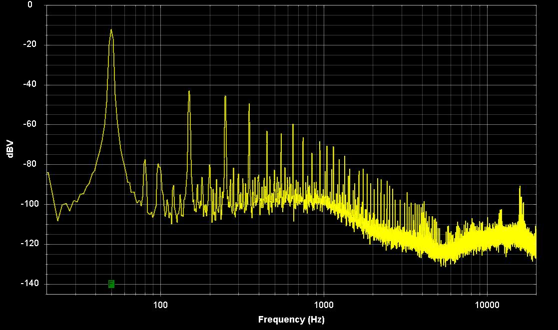

I decided to directly probe the mains. Ignore the amplitude scale, I am using a 100:1 1500V probe plugged directly into the ~100k input of the QA403.
Pretty ugly. It's funny how, aside from the fundamental, it's only the 3rd harmonic that is giving me a headache. 150Hz must be some kind of ULF sweet spot for the radiation efficiency of the mains wiring of my lab.
I looked at the mains waveform on the DSO and the tops of the sinewave are heavily flattened. In fact, the mains waveform here looks exactly like the mains transformer secondary voltage of a conventional rectified and filtered DC power supply with the peaks of the sinewave flattening due to winding resistance limiting current as the filter capacitor(s) are topped up.
