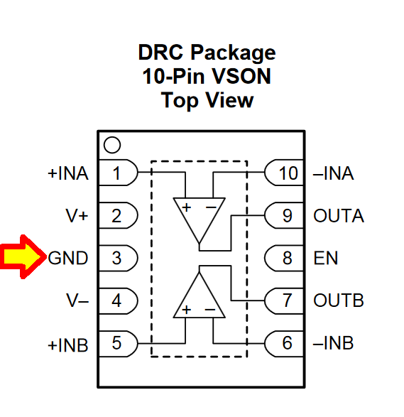

Unlike NE5532 / LM4562 / LT1124 / most existing dual opamps, the TI OPA1622 explicitly includes a GND pin, and connects its compensation capacitor to GND (for excellent technical reasons). To make OPA1622 work as a dual opamp you need 9 I/O pins. The tenth pin, Amplifier Enable/Disable, might be considered optional in mains powered gear. Battery powered devices, on the other hand, really do benefit from the Enable pin.
_
The GND pin can be connected to the negative supply voltage and the part will still operate, albeit with a reduction in PSRR. On the bench this typically degrades the high frequency THD in headphone applications (high load current causing supply ripple) where even harmonics from the supplies starts to creep in. But the performance is still very good. During the development phase we planned for some users to attach the enable pin to VCC and GND to VEE and treat it like a regular op amp.

You are absolutely correct, I had completely forgotten about this!
Wow, that's very good news. Thank you John! I thought I read the documentation carefully but obviously I missed this little nugget. Would you please tell us which document (and which page#) discloses this fact? I'd like to re-read that part and maybe figure out why I didn't remember this little gift of design flexibility. Thanks!T ... During the development phase we planned for some users to attach the enable pin to VCC and GND to VEE and treat it like a regular op amp.
Looking back now it's probably not as explicit as it could be. If you look at the absolute maximums table (page 4) , it states that those pins can withstand voltages up to 0.5V outside the supply range of the device. In the enable pin section I also say "The enable pin can be driven by a GPIO pin from the system controller, discrete logic gates, or can be connected directly to the V+ supply" (page 16).
If you look at the internal schematic of the pins (page 16, figure 43) you can see that there is a bunch of protection on the pins specifically for this reason. But hindsight is 20/20, I should have more clearly stated that these pins can be tied to the supplies, with a small degradation in performance.
I will say that if you tie the enable pin to V+ and GND to V-, don't expect the part to power-up pop-free. There will be a period where the V+ voltage is above the logic high threshold, but still below the minimum supply voltage of the amplifier. For that brief period the output can have some unusual behavior. This was a compromise made so that the enable pin logic levels could accommodate 0.9V logic. This is also why I show the voltage divider circuit on the enable pin in Figure 48.
