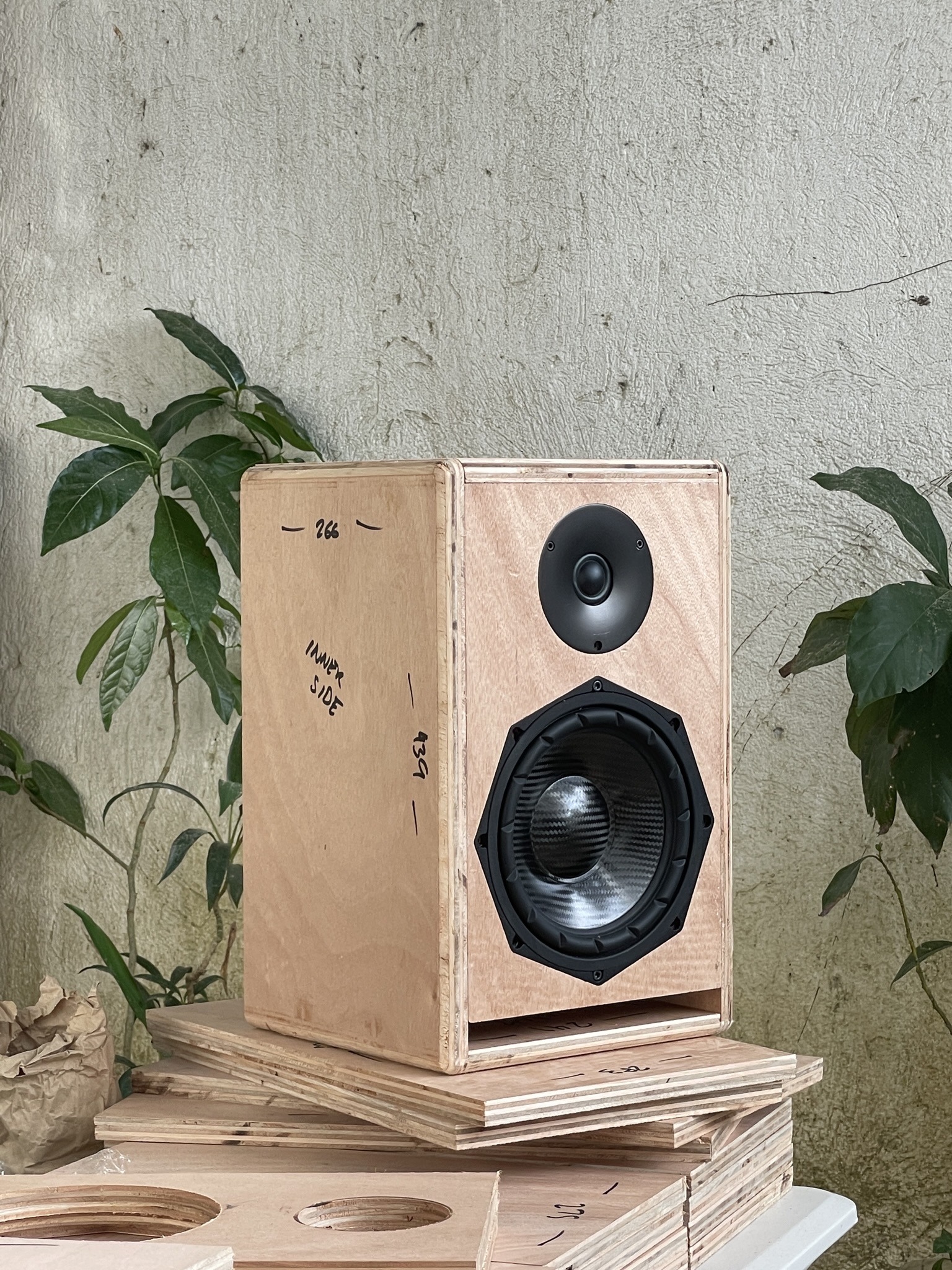

I see your point, but even for a manufacturer, recessing an octagon with sharp corners is a way more complex machining operation than recessing a circle. If the corners of the octagon frame had a 1/4" (6mm) radius, then a CNC cutter could cleanly make the cut. But sharp corners complicate things.
I like anything that permits closer driver spacing, but some of these weird format frames are very hard to recess, which I think is more important than tightest possible spacing. If its an absolute necessity for the design, I'd rather physically notch the driver frame to obtain the clearance. Thats one reason I like polymer frame drivers, but they aren't that rigid compared to aluminum or magnesium.

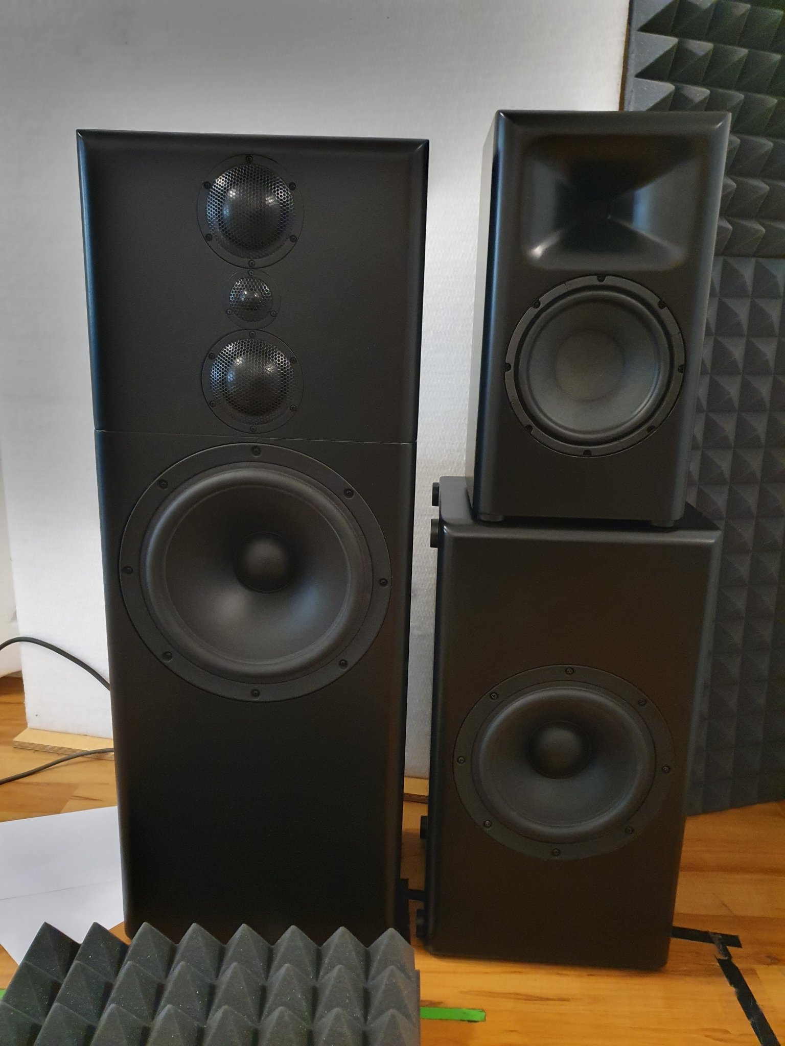

This one would fit in my cinema system (right) where I landet with a Kartesian 8" (PHL was also good - both are better as all the others). Would be interested in a few THD curves if it behaves up to 2-2,5kHz.
