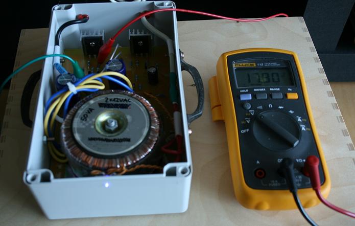

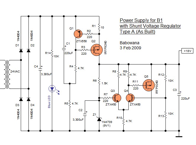

When I do power-on, the regualted rail voltage starts to increase . . . 12V, 13V, 14V . . . and after few seconds, reaches to 18V and stops there. About eight hours later, I measure the regualted rail as 18.08V. And, I measure the temperature on the surface of Q5 as 45 deg C.
The constant current through Q2 is 60mA. I can say that about 10mA is shared by zenner, diff pair and output voltage sampling circuit. And, the remaining 50mA is shared by Q5 and load (B1 buffer). As I roughly estimate total current of about 20mA through B1 (with 4* 2SK170BL), I believe the remaining 30mA is wasted by Q5.
I have used Diff pair of non-matching TRs. I have not considered the thermal coupling of them either.
I'm not using heat sinks for Q2 and Q5 partly because the current flowing through them is low and partly because this is built for a quick test. Result? I'm fully satisfied with.
By practicing this project, I feel better self-confidence, better understanding of Papa's CCS used on Zen amps and Aleph amps. Oh . . . more . . . better understanding of Papa's diy opamps . . .
I believe this shunt regualtor has all necessary parts to be a good shunt regulator--CCS at the entrance (Q1 and Q2), reference voltage, error detector (Q3 and Q4), control element (Q5), sampling circuit and soft starter.
Am I missing any other points . . . ?

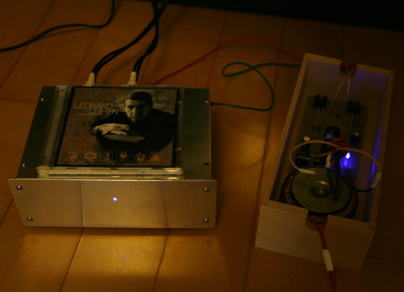

Nevertheless, I will replace the ac adaptor with this shunt

You are welcome Good work on the BaboSalas shuntreg

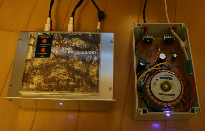

I have powered on both PSU (type A) and B1 for four days (As you see from the photo, actually, I don't have any power on-off switch. Once I plug on the power, tha's it . . . ), and measured the regulated output voltages to see how the new PSU reacts to the real operation. The output voltage has been measured at 17.80V as a constant value. Now, I fully believe that PSU works stable. I have not measured any professional interests tho . . .
What is the next . . . ? Build the type C . . . ? New TooleReg (soon) . . . ? Or, any other . . . ?
