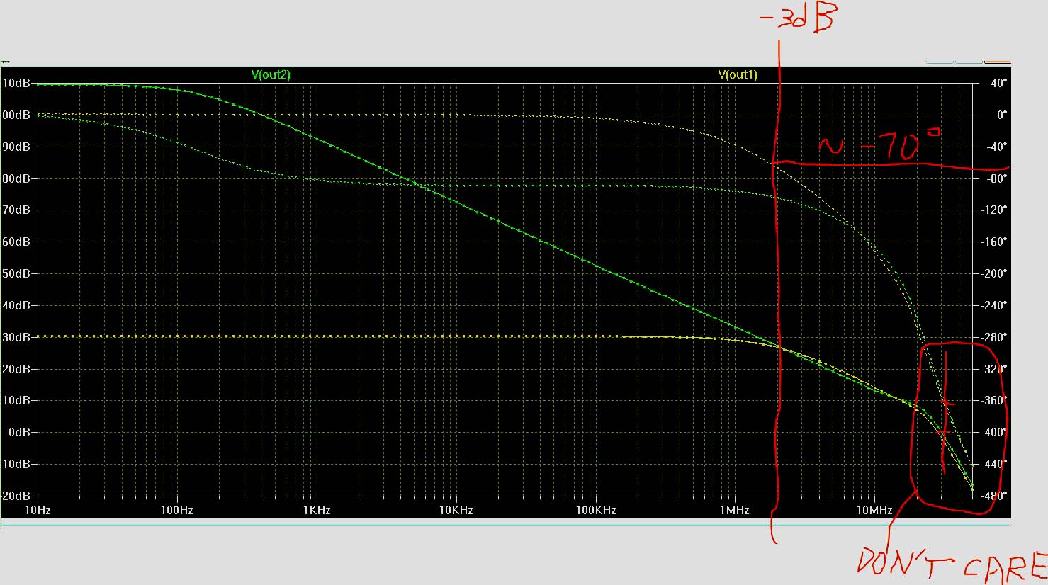

I finally got it going with the LTSpice. It was my fault.........I've been spending a lot of time on this the last few days, the simulation is so so slow. Just made a stupid mistake.
Anyway, I think I was right, the simple circuit is stable from my understanding on the simulation on the open and closed loop gain phase plot. I attached the new file with two identical circuits, one with closed loop gain of 21( the right). I change R33 on the left circuit from 1K to 0.1ohm ( in the feedback gain setting) to simulate openloop gain. I plot the gain and phase plot of both the open loop ( green) and closed loop (yellow/light grey).
You can see it's a single pole roll off from about 100Hz to about 5MHz before going to 2 poll roll off and the phase gone south. BUT we have a gain of 21, at the -3dB point of the amplifier ( vertical red line labeled -3dB), the phase shift is only -70deg. I have 180-70=110deg phase margin. The phase at 0dB is irrelevant as circled "Don't care".
The circuit should be stable. But then again, this is on paper/computer. Real circuit might be different.

I try to look for Tien probe, I don't quite follow. But I think the way I make R33 to 0.1ohm should work close enough. When I search for Tien probe, I saw description using Spice derivitives which I don't understand. I am not very good with simulations.

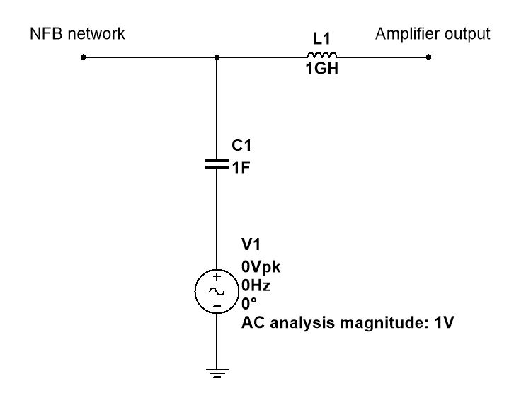

I don't quite understand Tien probe, something borders me about adding a voltage source to break the loop.

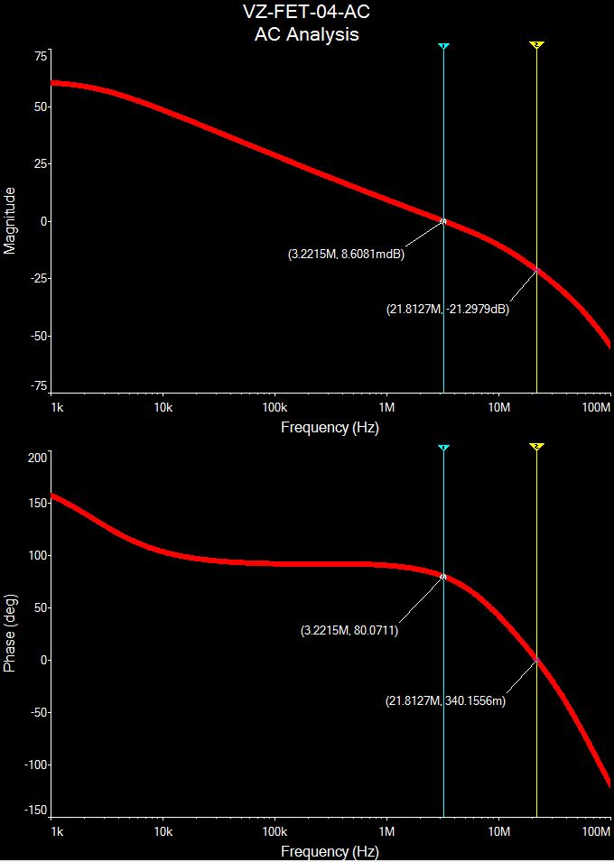

As you can see in my post #161, I use 0.1ohm resistor in the feed back to make closed loop gain of 20K/0.1= 200000. essentially making it open loop gain to look at the phase margin when at -3dB point of the amplifier(2MHz).
Unfortunately, the way it is shown, it will not work in the real world.
102db loop gain at 1KHz (huge), only 4db gain margin (almost none).
Meaning - it's unstable. Even in simulation - if you send it into clipping (which is rather awful - full of artifacts), it starts oscillating on recovery.
102db loop gain is rather difficult to stabilize. Possible, but you will have to sacrifice many other good things. Not worth it.

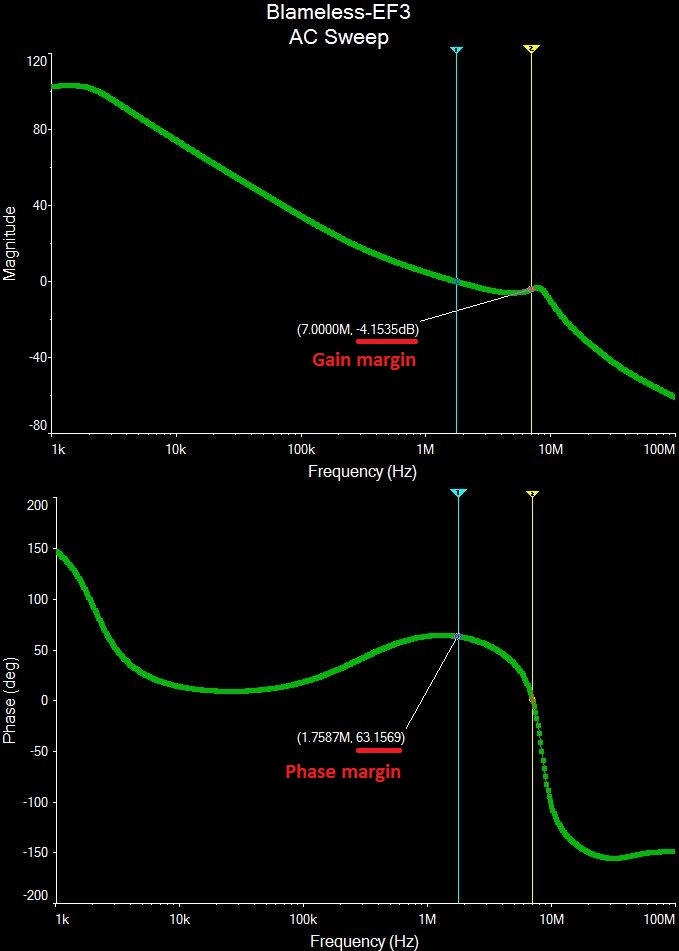

Feedback loop analysis of your circuit is attached.

I may be misunderstanding you, but phase margin is defined by the phase at the frequency where the loop gain goes through 0dB (also called the gain crossover frequency).
The closed loop -3dB frequency will almost always be at a somewhat higher frequency because the phase margin is usually somewhat less than 90 degrees. The closed loop frequency response -3 dB frequency is thus enhanced somewhat by the departure of the phase margin from 0 degrees.

Yes, phase margin is defined at the freq where loop gain=0. If the closed loop gain is 21, the phase margin is defined where the open loop gain curve intersect the close loop gain line( at about 27dB).
If you look at the plot in post #161, I showed exactly that with markers on. I think my simple amplifier is unconditionally stable.
Can you verify that I am correct?

I think you are referring to the pole formed by the feedback network impedance and the effective input capacitance of the input stage. If this pole is significant in terms of adding lagging phase shift, it will indeed be pushed to a higher frequency when closed loop gain is increased by decreasing the resistance value of the feedback network shunt resistor. However, if for no other reason than noise, the shunt feedback resistor should usually be on the order of 1k or less (thermal noise of a 1k resistor is about 4 nV/rt Hz). I usually choose a shunt resistor value of about 500 ohms. This keeps the feedback node pole at a reasonably high frequency (500 ohms and even 10pF creates a pole at 32 MHz, pretty far above a typical gain crossover frequency of 1 MHz).
Nevertheless, if one wants to increase closed loop gain for evaluation purposes, it is better to do it by increasing the value of the series feedback resistor, or center-tapping it and add an intermediate shunt to ground.
The inductor method is fine in simulation, but impractical for implementation in the real world on a prototype amplifier.

Hi Valery
I kept looking at this post. I don't know why your simulation looks a little different from mine using LTSpice. you have a slight peak at about 10MHz and LTSpice does not have that. LTSpice just show -40dB roll off at about 20MHz.
But even if you look at your simulation, if you draw a horizontal line of about 26dB to represent the closed loop gain of 21, the line will intersect at a point you have a lot more gain phase margin. We only look at the -3dB point of the amplifier gain, not at the 0dB point of the open loop gain.
Let me know what you think.

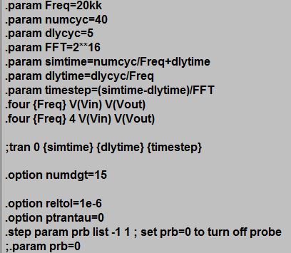

The difference is because I'm looking "inside the loop". One of the simple methods of analyzing the feedback loop (including stability margins assessment) was described by Bob Cordell long time ago. See the attached diagram. The amp's input is grounded. The AC signal source is injected into the feedback path, being isolated the right way with huge capacitor and inductor - advantage of simulators, GigaHenry is no problem.
In this case, you see the magnitude and phase responses vs frequency of the feedback loop. You can see ULGF, phase and gain margins, poles and zeroes of the feedback system. Tian probe is more sophisticated, but this simple method is accurate enough, at least for me.
I attach your loop analysis again (green) along with a stable one (red) for a reference.

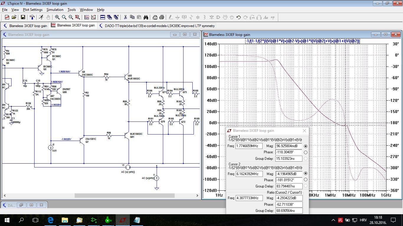

Here is the Loop Gain simulated with Tian probe, PM=62 dB, GM= 4 degree. I changed some models as I don't have them.
You have to work on it a bit more.
Pretty close to what I've got with simple method
Hi Dadod
Sorry some how I missed your post until Valery mentioned this.
I just simulated, it looked strange. Can you explain how does this work? You have a voltage and a current generator.
I have to read the new stuffs you added like the image attached. I never get this advanced.
