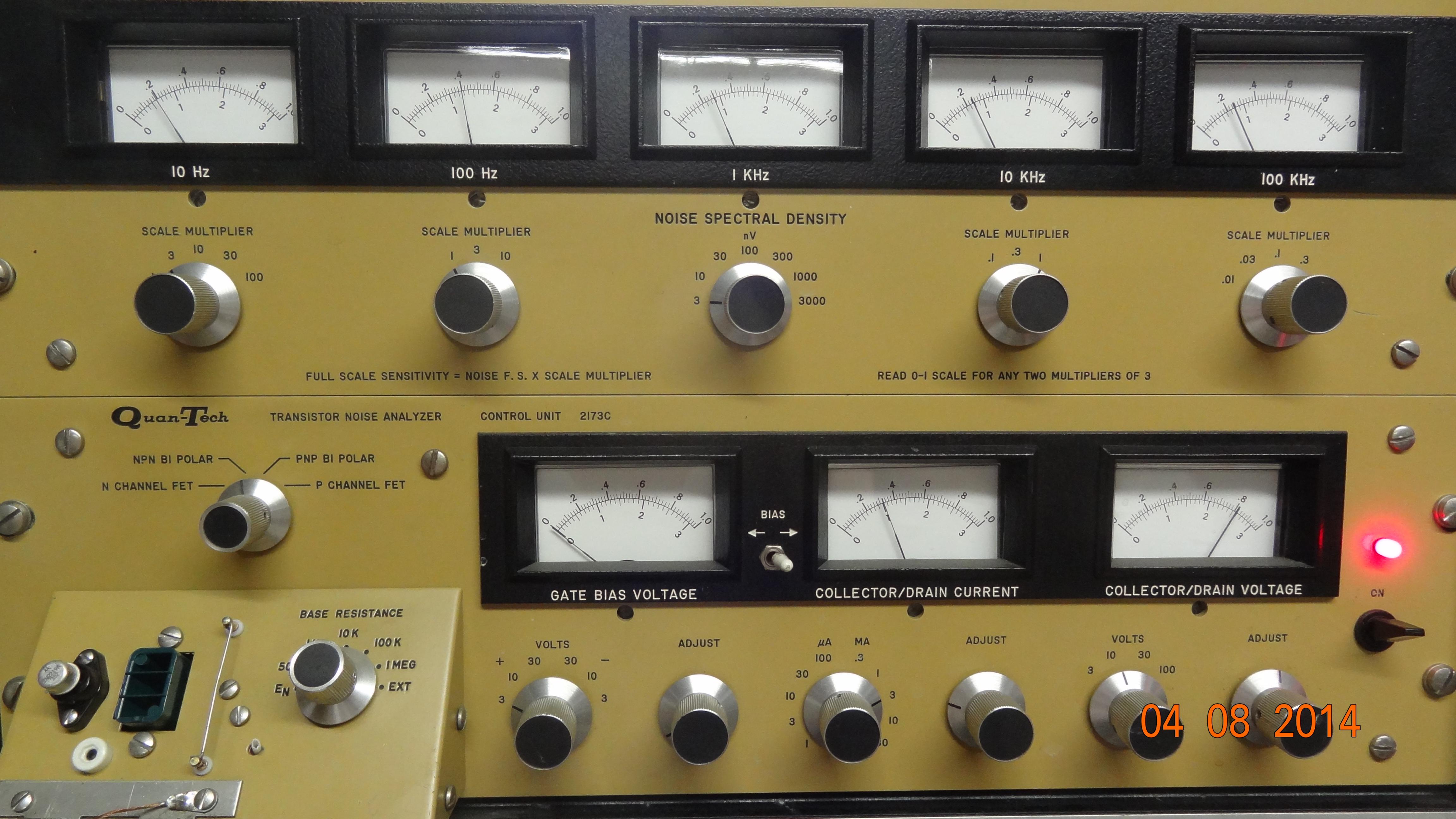

Here it is...... if you zoom in - you will see that the transistor is an oldie-but-goodie type 2N2219A. Just below 1nV/sqrtHz ! At 1mA.
I do not have the IC noise analyzer unit.... but I know where I might get one. Can only check transistors for now. And resistors with the other Quan-Tech model.
Just found it on Ebay and made an offer. It's a benefit of being retired and not have to spend money on house payments any more. So, I can use that money for other things. Paying some piece of property off for this freedom is a really big incentive for me.

Today, I added to my test equipment a transistor noise analyzer -- It is a Quan-Tech 2173C/2181. I still do Discrete transistor circuits. 0.3nV per sqrhz full scale. But it sure is BIG. And HEAVY.
THx-RNMarsh
I believe it was Scott who said that the tech from Quan-Tech was in the ADI laboratories so often he had a cot there.
I have a 5173 and people are looking to buy it all the time.
yes, you read the nv/sqrHz directly from the meters.
I opened it up and the insides of my unit looks new--- no corrosion to parts or oxidation. i just cleaned the switch contacts and closed it up. But, I will replace certan electrolytics to be sure they have the full C value as marked on them.
Now I need to find the manual for it, somewhere.... just in case I have to fix/trouble-shoot it. The unit still has the pcb extender boards for repairing attached to the rear panel.
It is one of those specialized instruments for R&D and production, QA/QC. because after I test everything I have here and buy a few more transistors and test those also, I wont have a use for it any more and it will sit on the shelf. Later, I'll sell it to make room for something else. Meanwhile, I'll learn all I can from it. Good info for a LNA of any kind.
