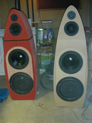

That is exactly what I was picturing!

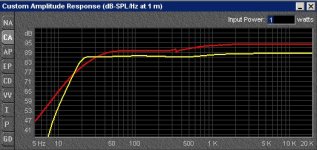

Did Solan already have Frequency plots of your drivers or did you have to measure the reponse once they were in the cabinets?
Again, they look great!
69stingray,
The plots I had at my disposal were the following:
1. The manufacturer's plots.
2. Free air plots, simulated, provided by Solen's software, X-over 3 pro, free of charge. No bass extension, no passive effect.
3. In-box plots, including bass extension and passive effect, simulated with BassBox 6 pro, using the driver's Thiele-Small specifications. These plots were almost identical to those of Unibox and WinISD, which were both actually a little more optimistic.
As for the ACTUAL response, I currently do not have the equipment to measure it, and I'm still not done with tuning, sorry.
However I do have a frequency generator, and I do hear that gut-liquefying 20hz very well. As best as I can tell, the current F3 is around 21hz, which at less than 2 hz away from predictions, is pretty good for a first shot. Yet more fine tuning can still be done by tweaking that weight inside the passive radiator.

Yeah.... But nearly all components are still available today!Seventeen. 😆
I think they aged pretty well! 🙃
