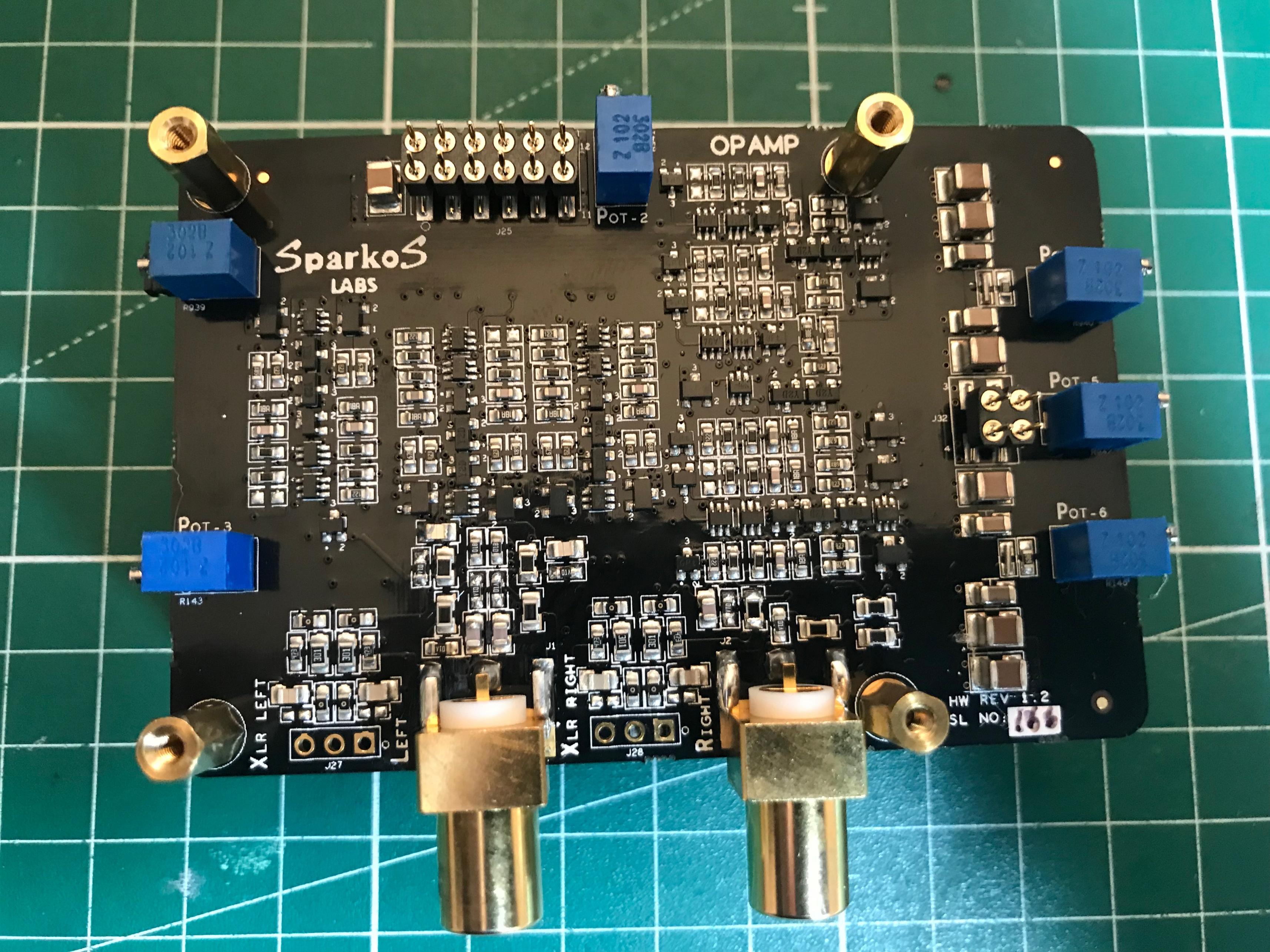

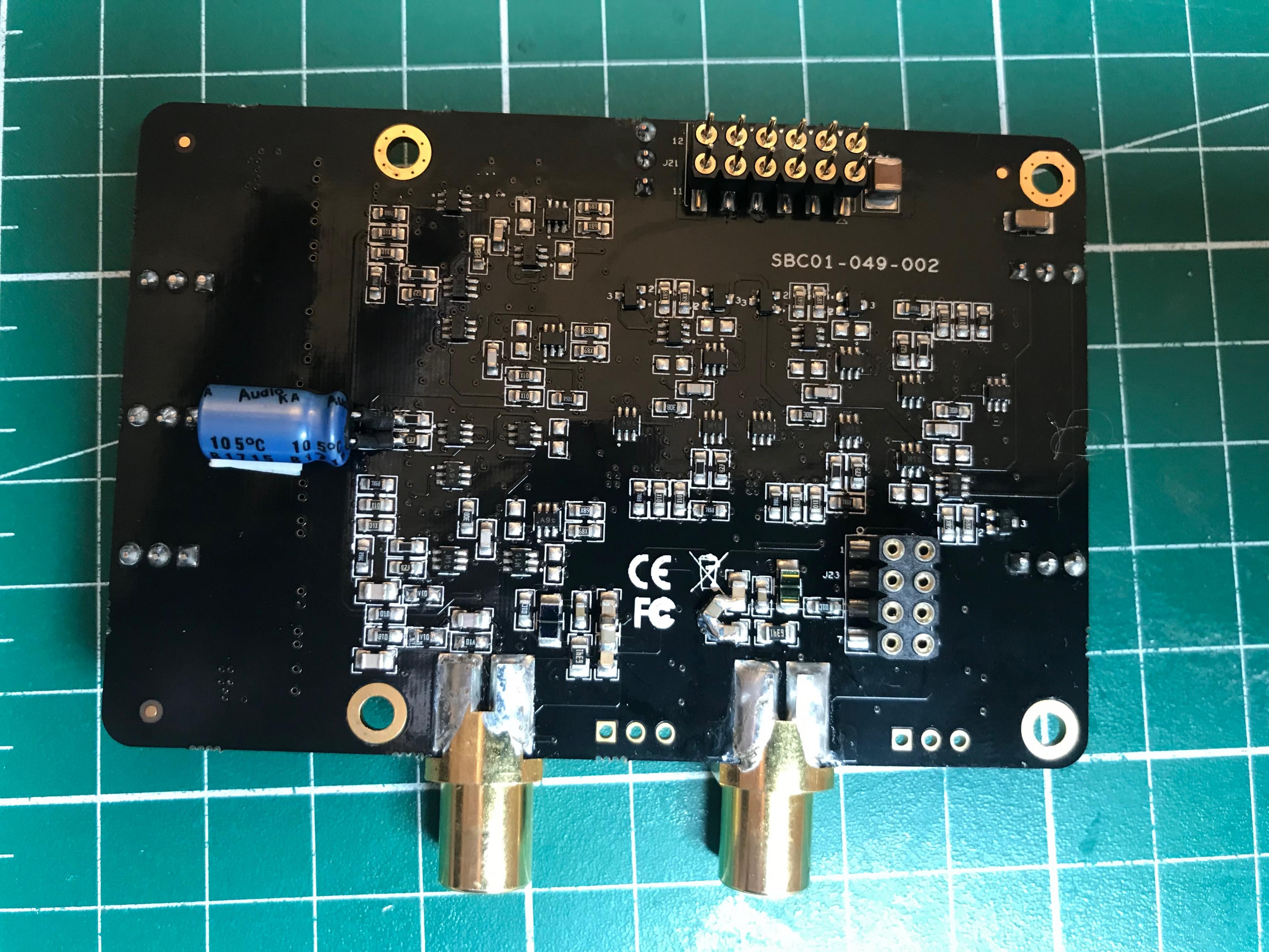

Hi Cdsgames,
I just received my Katana 1.2 from euro stock.
Very fast shipping but I have a problem.
I received only one of the two output stages that I ordered.
I will contact allo support this afternoon about this issue.
Is there a way to know which output stage I received?
what are visual differences between pure thd and sound quality?
thank you for your help
Hello Terry,
The box is labeled with the configuration.
Either THD or Sound Quality.
I suspect you have the THD version stack and the Sound Quality will be shipped to you soon as we are waiting for stock to arrive in Europe.

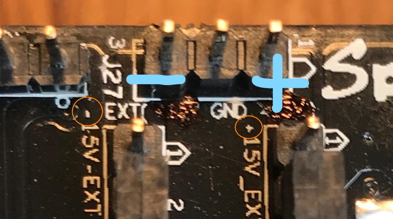

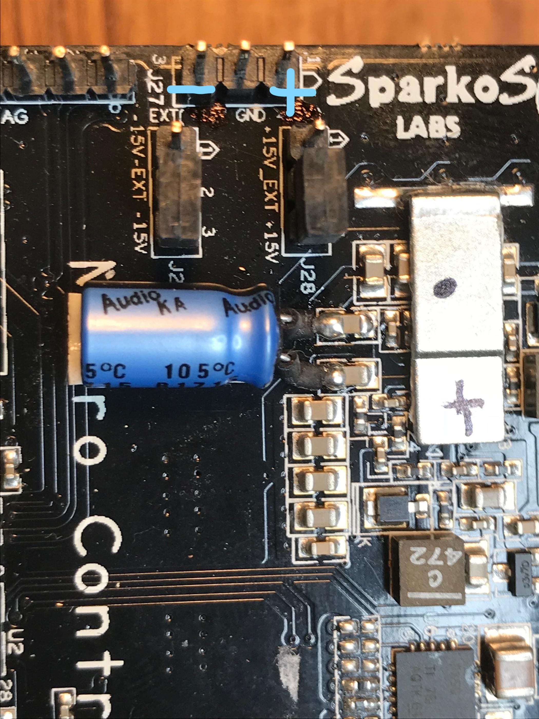

Hi André,
Thank you for your quick answer.
My order is : 4458
so you can reach me by email, no need to pollute the thread more than I did.
I didn't received an email about the missing output stage.
I don't see thd or sound quality on the board.
but maybe I missed it.

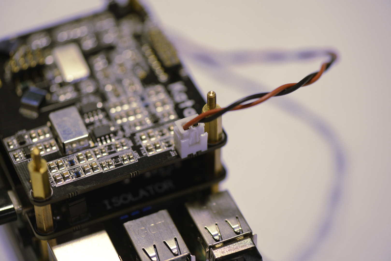

Hi John
.... in your pic the cable has 2 polarities inverted. We are checking our stock , here in EU we have no such cable , but in India they already found a few. Seems that our chinese manufacturer , inverted wires on some unit.
Please send me the order number and I will courier it today.
Thanks.
Order no. was #003840.
I'm sure that the incorrectly made up cable came from this original order back in July. I didn't initially use the cable from the replacement Katana kit as the original was still connected to the PSU. Hence both the original Katana and its replacement are now toast, or at least one regulator certainly is. I've no way of knowing yet whether damage was also done to the Opamp or Micro-Controller boards or indeed the RPi it was sitting on. We'll see.
FWIW I'm no longer upset, just relieved to know it wasn't something stupid that I had done. Looking forward to cracking on with getting the best from the Katana stack. Very promising indeed so far.
Regards and thanks.
John

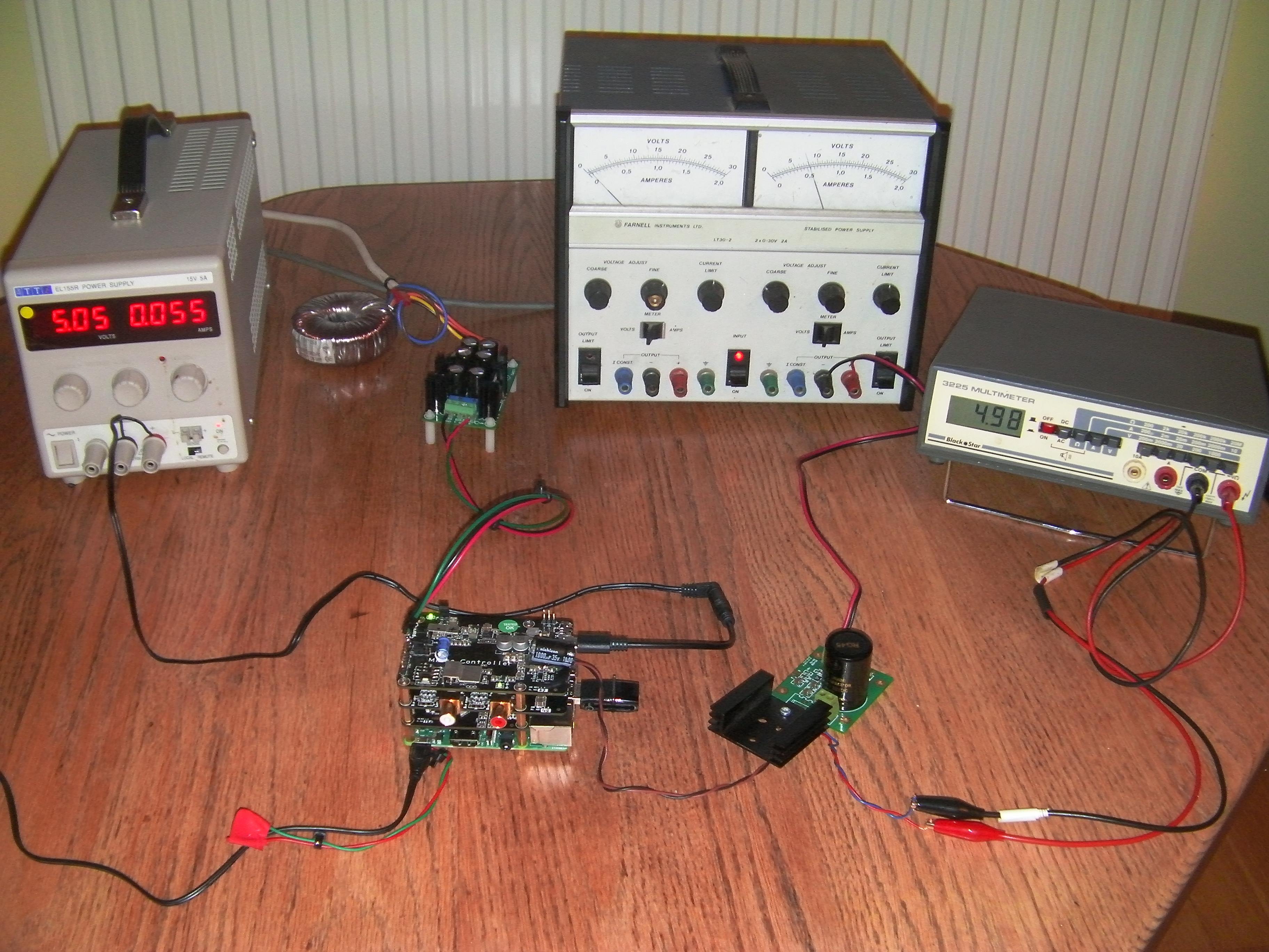

Hi Mark,
Best so far is a difficult one to be precise about. What is best is different depending on what each user is looking to achieve. Some might want it to be small and simple. I can't advise on that. I can say what I've tried so far and what I believe may be the best available that I am aiming at, based on numerous previous trials with Pi and non Pi based DACs. All very subjective and therefore likely to be controversial:
Best I have tried on the Katana Stack:
RPi - LT3042 with PNP pass transistor preceded by its own 10 volt bench power supply.
Katana - Another of the above.
MCU - Same again
Output stage - a dual 15 volt twisted pair LCBPS.
I've not yet used the isolator with the Katana.
I think you can see an example of the board I used in my earlier photos on this forum a few pages back.
https://www.diyaudio.com/forums/attachment.php?attachmentid=718489&stc=1&d=1543353793
What I'm aiming for:
Separate supplies for each using a modified Jung /Didden Super reg. (available in DIYaudio store), with an
LT3045 based tracking pre regulator. Each preceded by a capacitor multiplier and its own transformer. Depending on whether it can be heard or not the addition of choke regulation on the boards with steady current load. two diode centre tapped rectification for each supply. Snubbers on each transformer secondary.
That lot makes for a very big and quite expensive supply. In the past I've made single upgrades at a time to try and gauge the merit of the improvement. Only twice have I made it all the way to the above.
In general I have found consistent improvements as I've gone down this list in order:
1 SMPS
2 LM317 based single regulator
3 LM317 with LM317 tracking pre-regulator
3 As above but with Zener or diode string in place of lower voltage setting resistor and remote 0v sensing.
4 As above but with Capacitor multiplier
5 LT3045 based reg preceded by cap multiplier
6 Basic Jung.Didden super-reg
7 Improved Jung/Didden reg, added RC filters to improve current source and Opamp supply and remote sensing.
9 As above but preceded by a cap multiplier
10 As above but with choke regulation and snubbers on the transformer.
Perhaps the easiest place to start is between 4 and 5. The boards are easily available on Ebay and just need an appropriately sized transformer for their onboard diode bridge.
Hope that helps a little.
John

I think I got sent one of the rogue Katana power connectors and now have a toasted Katana. In any case I have no Katana LED on 3 way power, blinking controller status LED on 2 way power and Alsa not recognising the Katana in both cases. I've raised a help desk and hope Allo acts responsibly 😱
