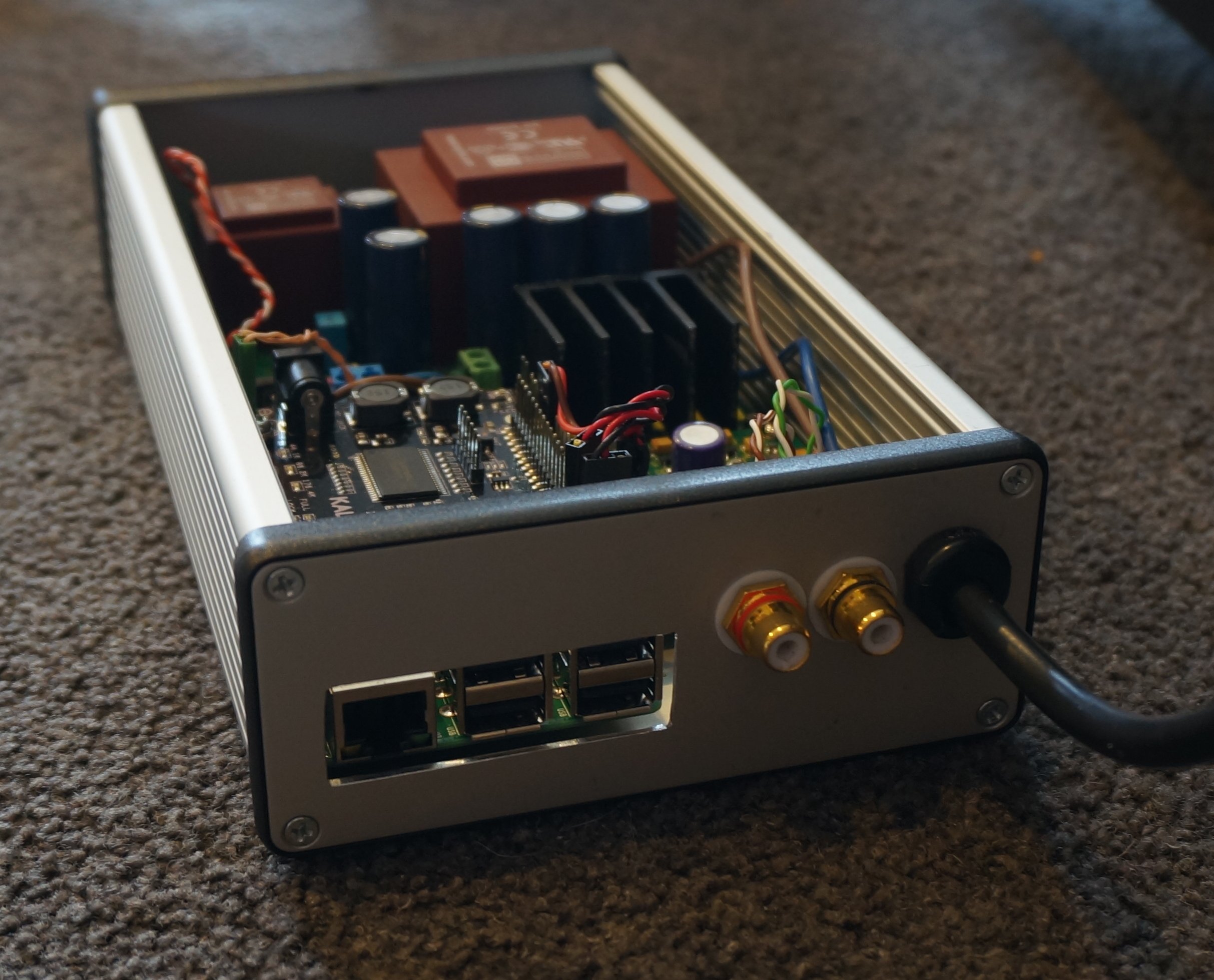

How on earth can I encase these boards ? is there someone who has thought about that ?
I agree regards layout of most SOC boards on the market, not set up for audiophiles for sure. But the RPi has the sockets of most interest on one side at least - the ethernet and USB ports.

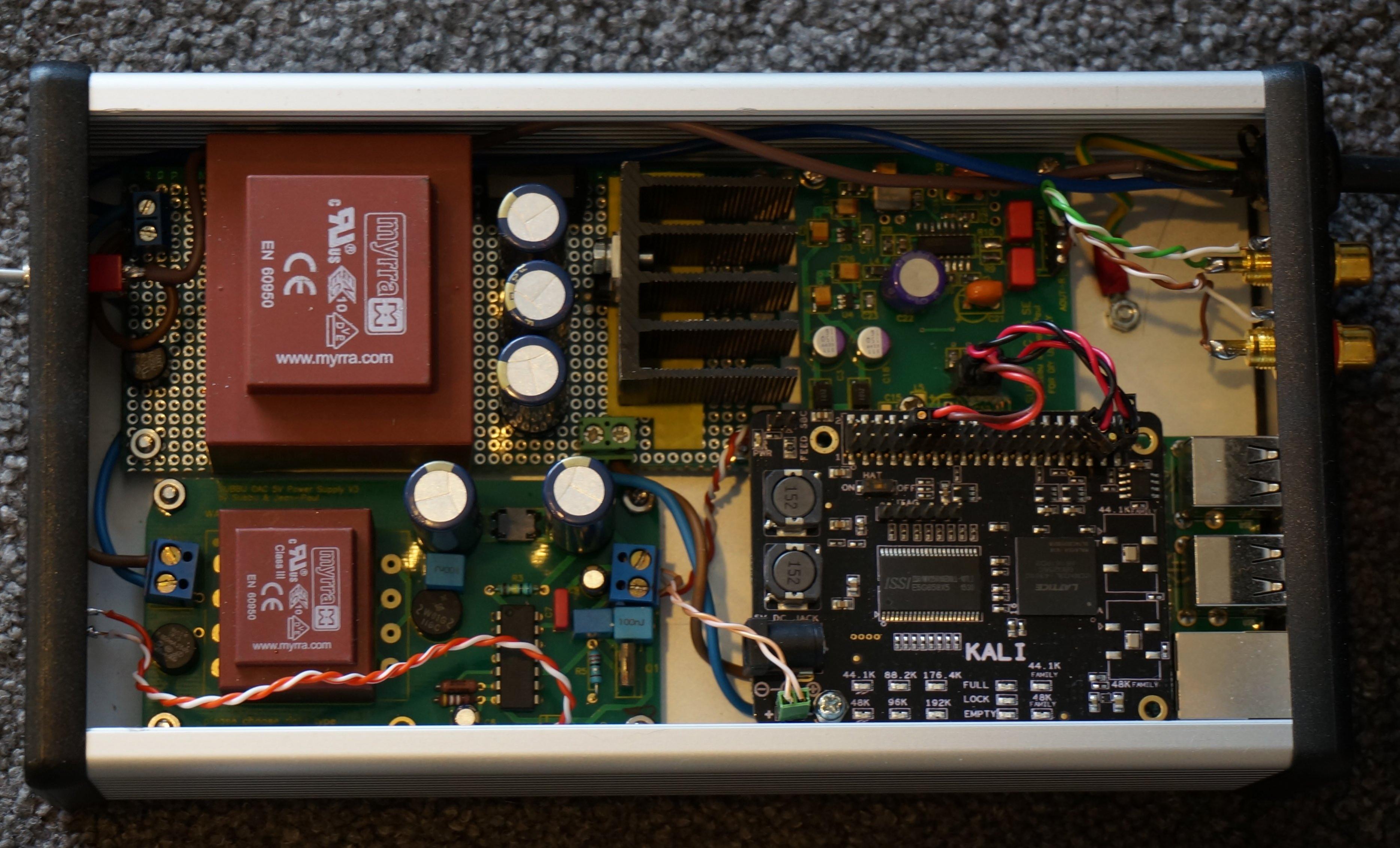

Quick pic of my player with RPi3, Kali and a DAC I am sure you will recognise Jean-Paul.
SPDIF portion of the SUBBU hacked off and I2S header attached to the Kali. Kali and DAC powered by the SUBBU supply, RPi has its own chunky supply.
Not a lot of space left but result is a neat little box (in my opinion!).
Wow it is possible ! I like it except for the mains wire that should (IMO) have been at the backside. Mains wiring is very close to sensitive circuits too. Your device gives inspiration for sure.
I would have donated the SBT PSU to go with it but I see you don't have any space left for that one, let alone for the Rcore transformer.
Normally I do try to keep mains wiring separated but the layout was dictated by the case I had to hand. It was a bit masochistic of me trying to squeeze it all into that box tho the Kali was a later addition.
Isn't there space for an IEC inlet at the mains side of the transformers ?
Unfortunately not, the PSU boards are a couple of mm away from the front panel. I do like the look of that socket tho and maybe one would fit but that would mean the mains came it at the front panel (the 2nd pic was from the rear of the box) and I would lose that nice clean layout. Just a thought, is EMF from the mains the concern here? Would shielding help?
To be honest this is in my less critical system anyway, I really only use it as background music during the day. The player in my more critical listening system has much better separation of incoming mains. That uses a Beaglebone black with external oscillator/clock (similar to the Chronos set-up) and Miero's sw. At some stage I must compare the two players.

Super neat Chris! I've modified a Mamboberry DAC which fits right on top of the R-Pi for a similar setup, but have much larger power supplies, so it wouldn't case nearly as nicely.
For many, that setup of yours should be pretty darned good!
Greg in Mississippi
I should add the Mamboberry R-Pi DAC HAT also uses the ES9023 chip. If someone wanted to duplicate Chris' setup with a slightly more compact DAC, use the newer Mamboberry LS which has slightly better regulators and also has separate regulators on the DAC chip and clock chip.
Greg in Mississippi
Greg in Mississippi
.... and also has separate regulators on the DAC chip and clock chip.
Greg in Mississippi
Subbu DAC has this also.
Jean-Paul,
Yup, could see that in Chris' great picture. Thanks for the clarification. I am sorry, I should have said that the LS with the better and dual regulators was a better choice than the original Mamboberry. I was NOT trying to imply it was a better choice than the Subbu (which I have no experience with).
From looking at Chris' picture, I also think the Subbu MIGHT have a better clock AND looks to have a more extensive (not sure if it is better) power network.
