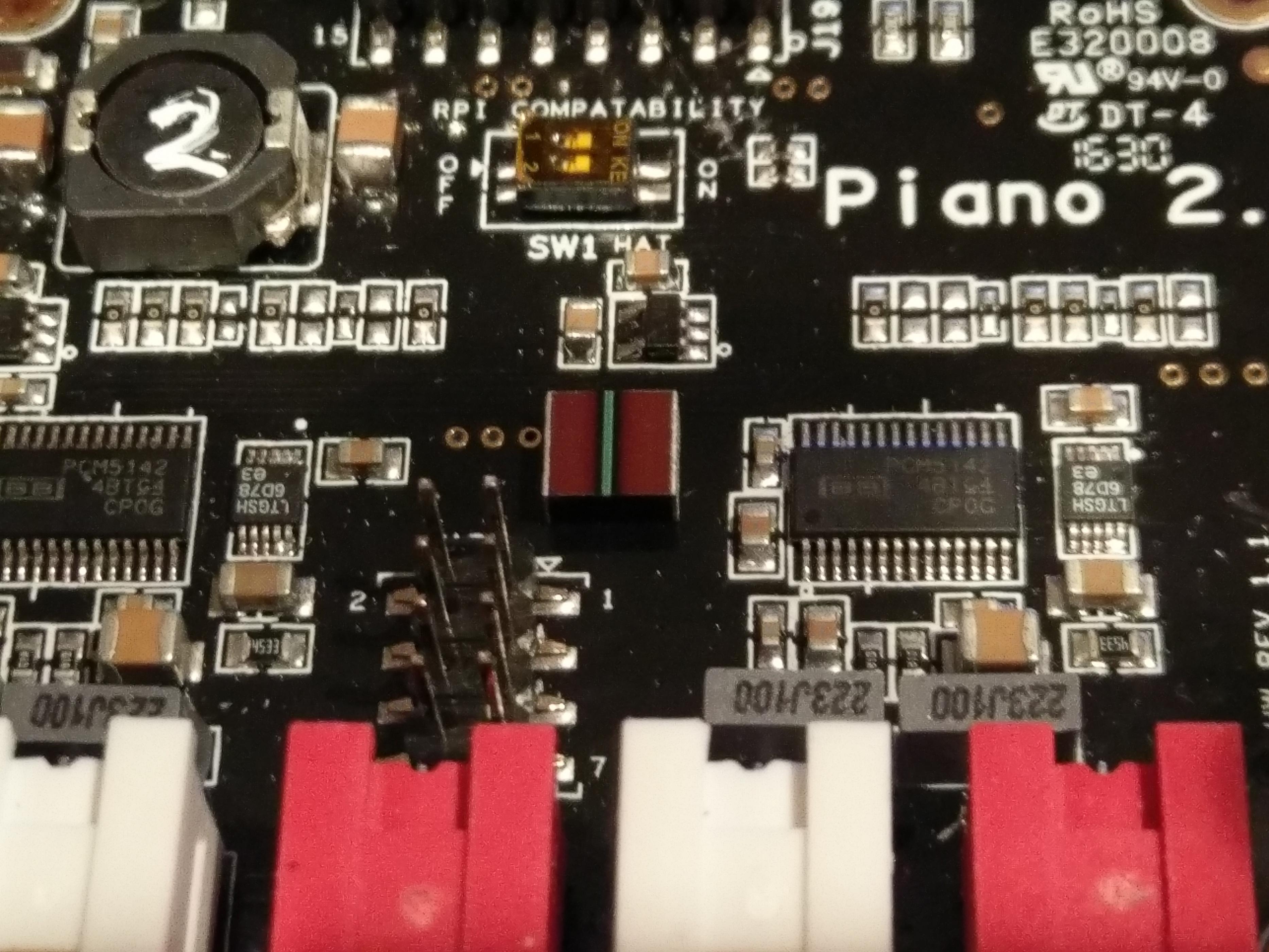

The "2.1" mode has to be chosen for dual-mono in Alsamixer, since there is no "1.1" mode to choose. The designer is well aware of this "workaround" btw. In "2.1" mode the right firmware files will be loaded into the DAC.
The outer RCAs will carry the signal. The others are dead. So - it's a "dual mono - single channel"
setup.
Benefits: At least crosstalk should be improved. And a little less load on one channel per DAC might
also do some good. Beside that ?????
On the CON side we have a DSP in the loop and we can't run 384kHz ?!?!?
I meanwhile think that the volume controls "digital" and "subwoofer" with alsamixer refer to the "DAC1" "DAC2" standard 51xx HW volume controls btw.
These controls should IMO be at 100% anyhow! I never liked the PCM51xx HW volume control.
BUT:
My right channel generates strange click noises/distortions every couple of seconds!
It plays music though.
I already switched cables and speakers. Replaced/disabled my realtimekernel/tunings asf.
No change.
Hmmh. What now?!? Are there any known HW issues with the Piano2.1 ?

Hmmh.
There are problems with the firmware - I guess.
It seems that buffers are not properly cleared when changing tracks and/or configurations, or something like that.
This might lead to the crackles. I e.g. did some config changes in alsamixer and rebooted.
The first track played OK. The next track was messed up again.
I do also face phase issues. My phase test-track does not produce correct results.
Then . Sounds that usually are on right show up on left. If I run a left-right test-track it sounds OK again. Hmmh.
Not nice. Seems difficult to nail down. Running out of ideas. This goes beyond my capabilities now.

Just to let you know. I tricked the Piano!!
Just tried a quick and dirty hack:
I disabled the MUTING of the subwoofer DAC in "2.0" mode in the driver:
Then I removed all firmware to force the DAC into 2.0 mode - without DSP .
That'll happen without any firmware files under /lib/firmware/allo/piano.
Guess what happened.
"2.0" mode and two DACs playing music.
( something for you to try scramer
And. Most important!
The DACs play clean. No more distortions, phase issues or other hickups.
Next challenge would be to mute one channel per DAC.
Enjoy.

What are you thinking for upgrading the AVDD cap? See my picture of the area of the Piano 2.1 with one of the 22uf PPS caps on the board. I just cannot see how to fit those in that space without a board re-design. AND that's the cap I'd like to use there... actually a stack of 2-3 of them.
The cap that's currently there is likely 100uf... & I suspect that the Piano sounds as good as it does due to the size of that & some of the other caps on the AVDD, charge pump, and DVDD pins. I would like to preserve that... and to do that with the SMD film caps (+ some small conductive plastics to add bulk C) will be difficult to impossible to do without a board redesign.
Also I'll go back and look at your blog post on upsampling again. I'm going to use these files (192 & 384) for testing the IsolatorPi with master mode DACs.
