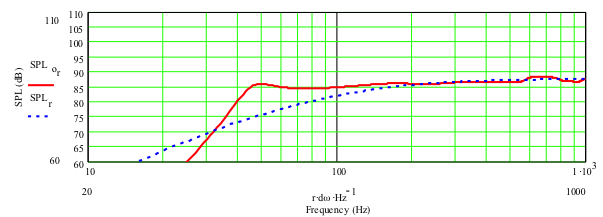

Bjorn, were you able to take a look at the Tang Band W3-2141 3" in the Tabaq?
Thanks,
Mac
W3 2141 in TABAQ
Hi
To get the max out of this nice driver, you should modify the TABAQ design:
Please find the sim with this adjusted TABAQ.
The small bump in the bass will not show up in real life.
Have fun !
Greetings form Bjørn
Hi
- Internal length of the line extended 3 inches (internal).
- Port length 5 inch.
- Driver 9 inch from closed end.
- Stuffing 80 gram in the upper 2/3.
Have fun !
