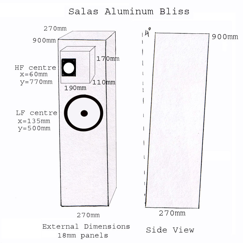

Fortunately the Bliss shows ~50Hz box resonance giving out enough bass just before that small room's 40Hz suck out. Further away in the room 30Hz comes up but this closed box has no resonance there to sustain a drone like a lower tuned bass reflex would.

That's even closer to a 60Hz halfwave resonance.
I had to look up the formula. Let me write it down here for myself and for those who are feeling lazy. Assuming your graph shows a resonance of ~58Hz, we can calculate the half wavelength using the formula:
λ = v / f,
Where λ (wavelength) = v (the speed of sound in air – approximately 343 meters per second at room temperature) / f (frequency in Hz).
By plugging in the values for v and f:
λ ≈ 343 / 58
λ ≈ 5.914 meters
Half-wavelength = λ / 2
Half-wavelength ≈ 5.914 / 2
Half-wavelength ≈ 2.957 meters
This is very close to the provided room width of 2.98 meters.
