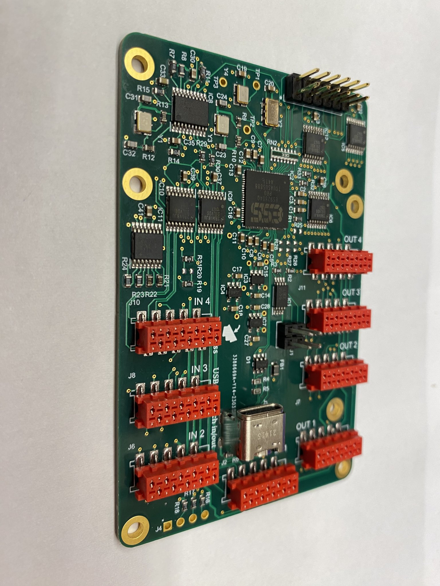

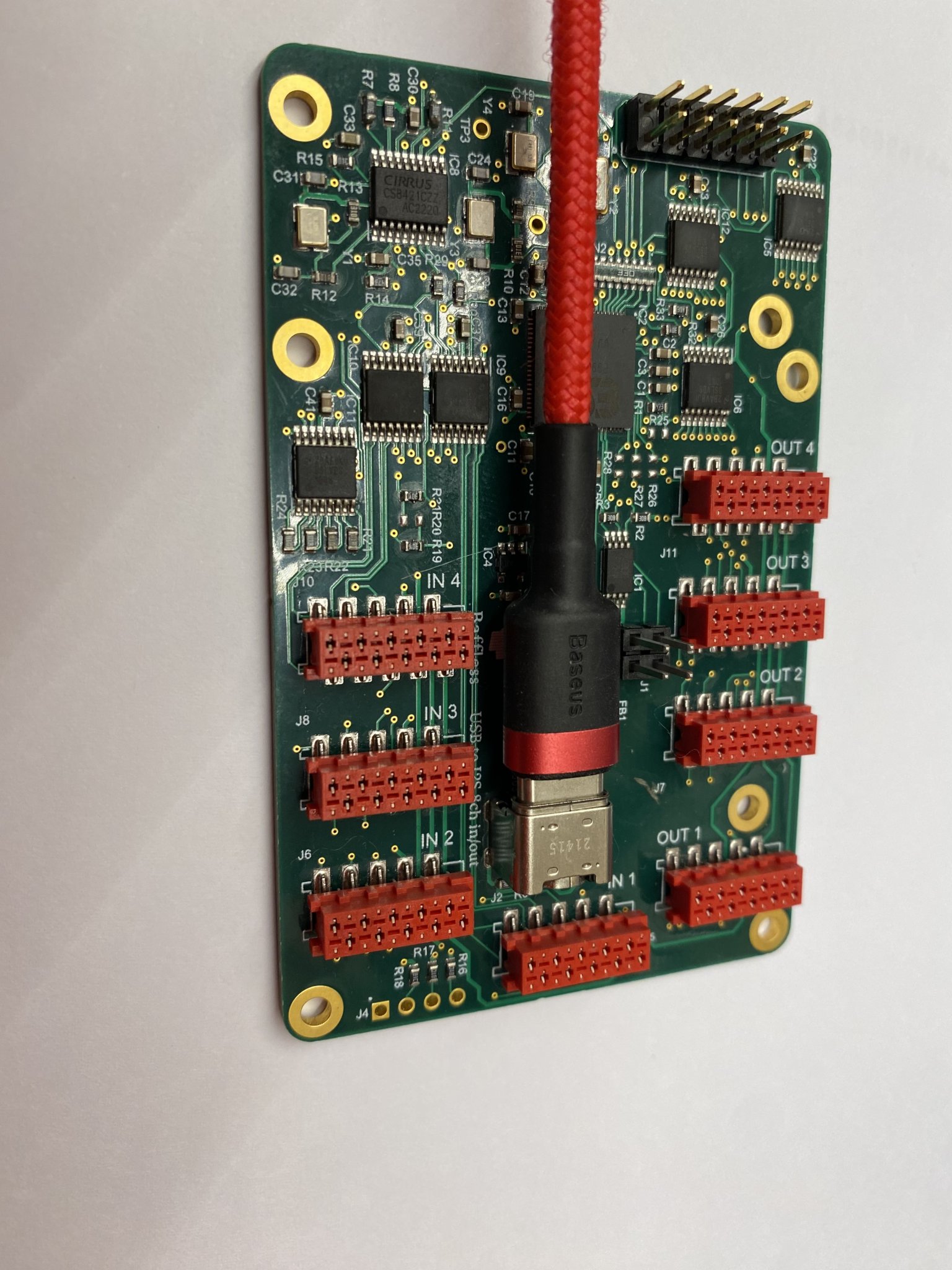

Hi. Wanted to share my newest USB to I2S 8ch board. As always ready to buy boards doesn't fit my projects perfectly, so had to make my own version. It is 8ch out/8ch in USB to I2S. All outputs and inputs are with lvds drivers for longer lines communication. Up to 192khz. First input channel has hardware ASRC if needed. I developed it for use with linux for embedded purposes for interfacing sabre DAC's Mounting holes fit khadas vim3 board or RPI. Based on sabre chip.
Not very universal as it has only I2S no SPDIF or other nonsenses

It works only with linux.No Mac no windows. Call it a feature or a bug as you want.Don’t ask why 🙂 it was for my projects so not very versatile. I am not aware of any comercial adc or dac which uses lvds interface. It is probably only for someone who does its one DAC with lvds and don’t want to bother by doing its own usb i2s converter. Not very usefull probably outside my own gear..

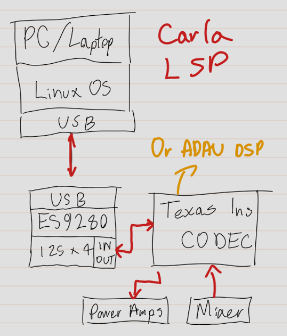

mmm no, essentially i wish the usb to i2s bridge with multichanel capabilities, the thing is that I liked the ES9280 option (I've seen xmos 6OUT/4IN i2s https://dub.sh/7lpdSxO before). I really want to power a diy sound processing system based on linux dsp libraries like CARLA (falktx) with LSP plugins.Not sure how good linux can handle two boards with identical names VID and PID. Also would need to add coaxial connector for common clock signal to prevent drifft. Did’t try that so can’t say exactly. Theoretically yes, practicaly don’t know

That was my error at a previous attempt, I made this other example with AliExpress parts (https://github.com/har-in-air/STM32F411_USB_AUDIO_DAC), it worked fine with high sound quality in single board stereo but when I tried to connect 3 kits of these modules at a same laptop (all in a same USB hub too), but Linux only recognized one at a time (2 of 6 theoretical channels), I couldn't try it with other computer that has 3 independent USB ports since thenNot sure how good linux can handle two boards with identical names VID and PID. Also would need to add coaxial connector for common clock signal to prevent drifft. Did’t try that so can’t say exactly. Theoretically yes, practicaly don’t know

In linux USB devices should be identified not only by their VID/PID, but also by their USB port. An appropriate udev rule would assign unique alsa names to each USB soundcard, based on the port.I tried to connect 3 kits of these modules at a same laptop (all in a same USB hub too), but Linux only recognized one at a time (2 of 6 theoretical channels), I couldn't try it with other computer that has 3 independent USB ports since then
As of the identification - perhaps does your USB hub not have enough of fullspeed->highspeed transaction translators? https://www.infineon.com/dgdl/Infin...N.pdf?fileId=8ac78c8c7cdc391c017d0d4c6b726c40

Just looked at the BOM and schematics. So there are several variants possible. The most naked without LVDS drivers i could make something around 110eur.PD:
Could I know your board's total cost?
The most expensive 8ch out 8ch in lvds +2ch input with ASCR converter to interface to any other i2s source could sell for 180eur. And over versions something in between. Fastening holes are adapted to raspberry 4 board and khadas vim3 board.Board is i2s master.
