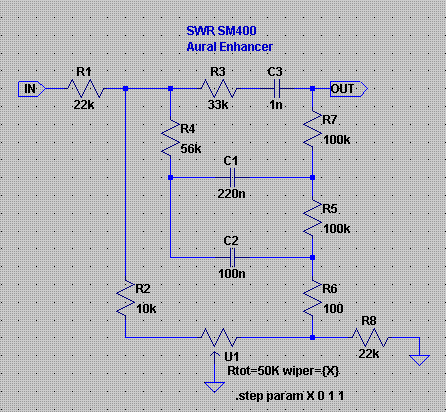

JP Hugsley, if you look carefully at the SWR Aural Enhancer, you will find that this is exactly the same filter as in your preamp (with added two resistors and a pot). Only the component values are slightly changed - this is a bass guitar preamp and the frequency response has to be different.
I've seen similar filters in many guitar and bass amps - it is not specific to SWR.
Mark

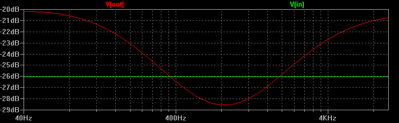

Well, I replaced R 6 & 7 with a pot so I could have an active adjustment. It works fine. It's the Very high freqs I want to cut down, and I think raising C6 to 100pf should do the trick. I'll let you know when I get it done . . . if I ever get time; work, work, work. Ah well, the bucks gotta come from somewhere.
Thanks for the tip though. The graph shows much about the filter charateristics.

The original version of the preamp has high frequencies boosted much more than low frequencies (by several decibels). This may be good for a bass guitar with old strings but not good for Ferder Stratocaster which has already a lot of high frequencies. But by tweaking filter parts it can be corrected. Next week I'll have boards for this preamp and I'll finally check it with a guitar.
Mark
