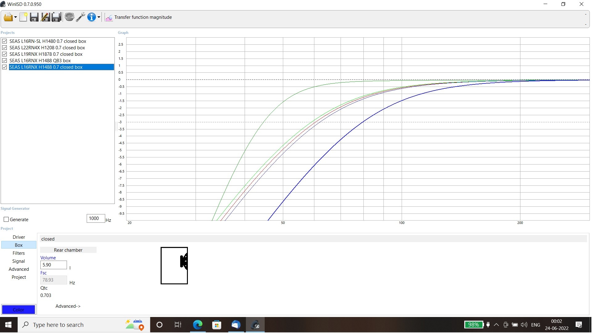

2. Agreed again. Usually trying to wrench too much bass extension would lead to other issues such as ringing. I assumed a QB3 alignment is not very aggressive. Below are a few SEAS drivers simulated in an 11-14 litre QB3 vented box. Are these slopes too steep?

I just compared 3 SEAS drivers simulated in an 11-14 litre closed box (0.7 alignments) against the L16RNX H1488 in an 11 litre QB3 vented box and the same driver in a 5 litre (0.7) closed box. For the 3 drivers simulated in a sealed box and I get an F6 of in the mid-40s and an F10 in the mid-30s.
![WIN for SEAS woofers closed vs vented QB3.jpg WIN for SEAS woofers closed vs vented QB3.jpg](https://www.diyaudio.com/community/data/attachments/974/974069-010a886fe764070a38576102bf33be56.jpg)

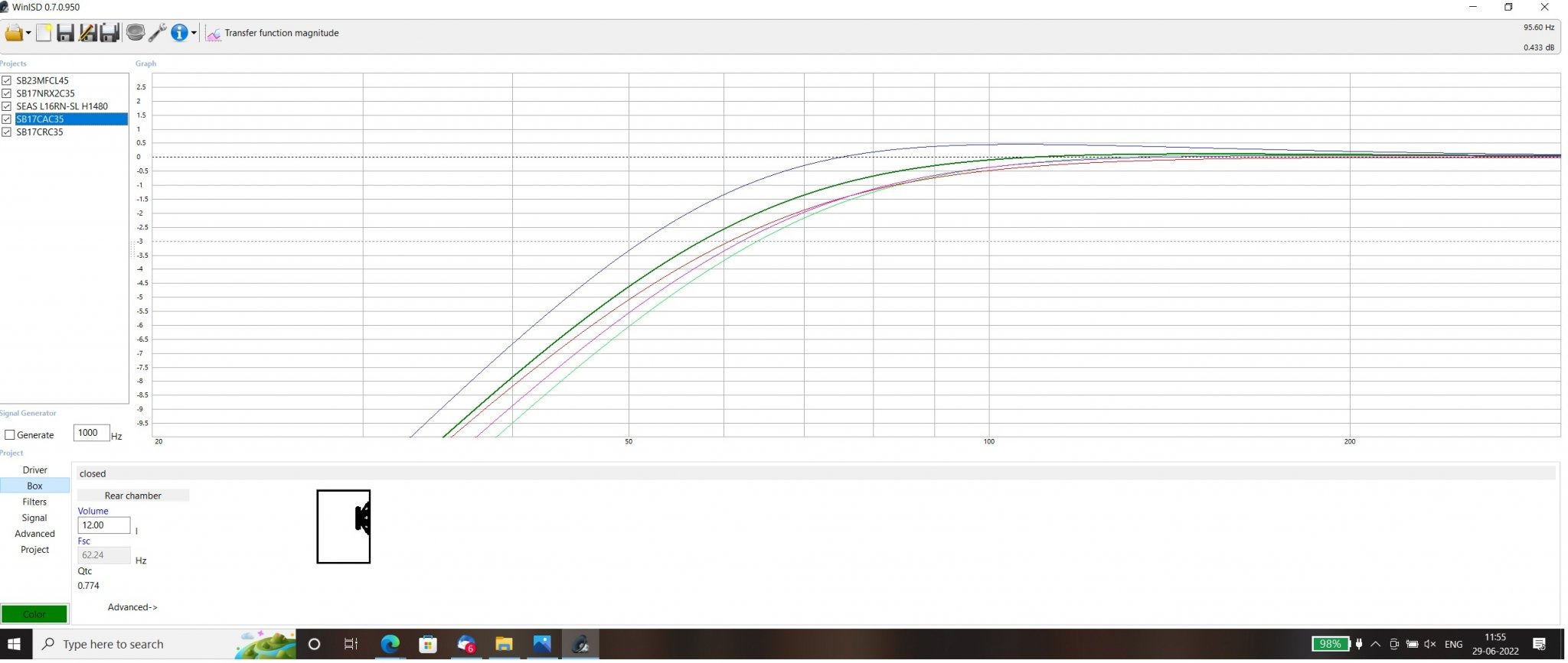

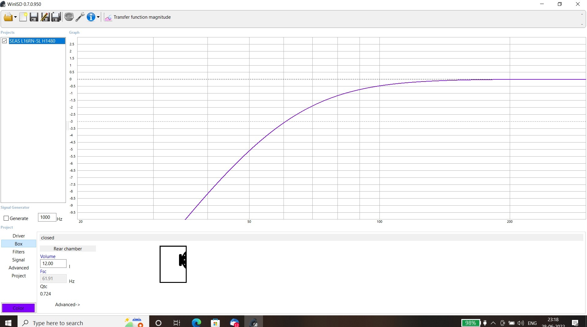

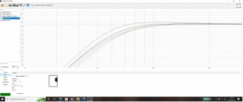

Thanks, since the SDX 7 is not available I simulated several (under $125) woofers in 12L sealed using WINISD and figured that the SEAS L16RN-SL (H1480) has the closest response to flat (Q= 0.7). What do you think?
I kept a budget of $1000 for all 8 woofers. This means each woofer should be less than $125 (from Madisound).
Thanks, Allen, I did not get what you meant by "properly shape your passband and manage to deal with the modes". Could you elaborate? Thanks.Any one of those slopes in that attachment should be perfectly good.. as long as you properly shape your passband and manage to deal with modes.
So much depends on how you get the sound into your room, whether it properly and evenly presents the whole range which supports what you hear as bass.
Sometimes people can add some extension, and the changed balance feels like an improvement. Sometimes it doesn't.. However there is much more that goes into good bass than extension.
I agree, the blue curve does look best.
What I like about it, is that it's no more than a fraction of a dB up at 200Hz but half a dB up at 100 and holds down below 80Hz.
In spite of what I have been saying, any of these curves could end up looking like any other if your room doesn't play along.
That driver is classified as a "subwoofer" by SB Acoustics.The blue curve looks best.

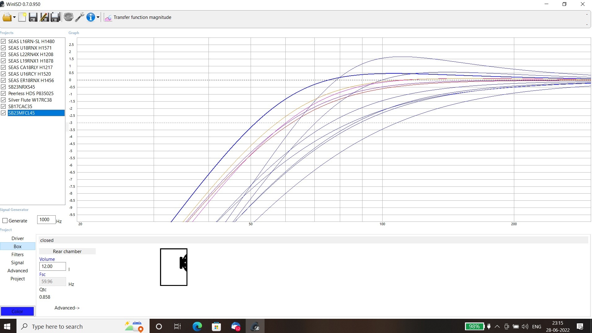

But I understood the kind of curve I need to look for. I was looking only for curves that were flat with no rise in response whatsoever.
I simulated that subwoofer against a few other woofers (all of them in a 12-litre sealed box).What I like about it, is that it's no more than a fraction of a dB up at 200Hz but half a dB up at 100 and holds down below 80Hz.
Blue line - SB23MFCL45 - the curve of the woofer both Dave you liked above.
Dark Green - SB17CAC35 - the curve I like most now
https://www.madisoundspeakerstore.c...coustics-sb17cac35-8-6-ceramic-woofer-8-ohms/
Light Green - SB17NRX2C35
Red - SEAS L16RN-SL (H1480) - the same woofer which was my earlier preferred option (post #2128)
Pink - SB17CRC35
![WINISD SEAS H1480 in 12L vs 3 SB woofers and 1 subwoofer.jpg WINISD SEAS H1480 in 12L vs 3 SB woofers and 1 subwoofer.jpg](https://www.diyaudio.com/community/data/attachments/975/975804-bf9f4236fc5c52563358338ab72f697b.jpg)

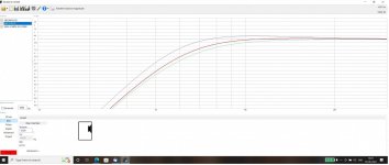

Thanks, Dave. I will have limited internet access for the month of July (I'll be in Poland, trying to keep safe). I am keeping the SB23MFCL (blue curve) subwoofer as well as 2 alternates (due to availability issues) as my choices. I understand you don't see any issues with using a "subwoofer" instead of a "woofer" in this application assuming that the driver would be crossed over around 300Hz.Looks to reach high enuff and is fairly flat.
dave
The alternates I have in mind are the SB Acoustics SB17CAC35-8 (red curve) and the SEAS H1480 L16RN-SL (green curve). The former is my "1st runner up" and the latter is almost always available.

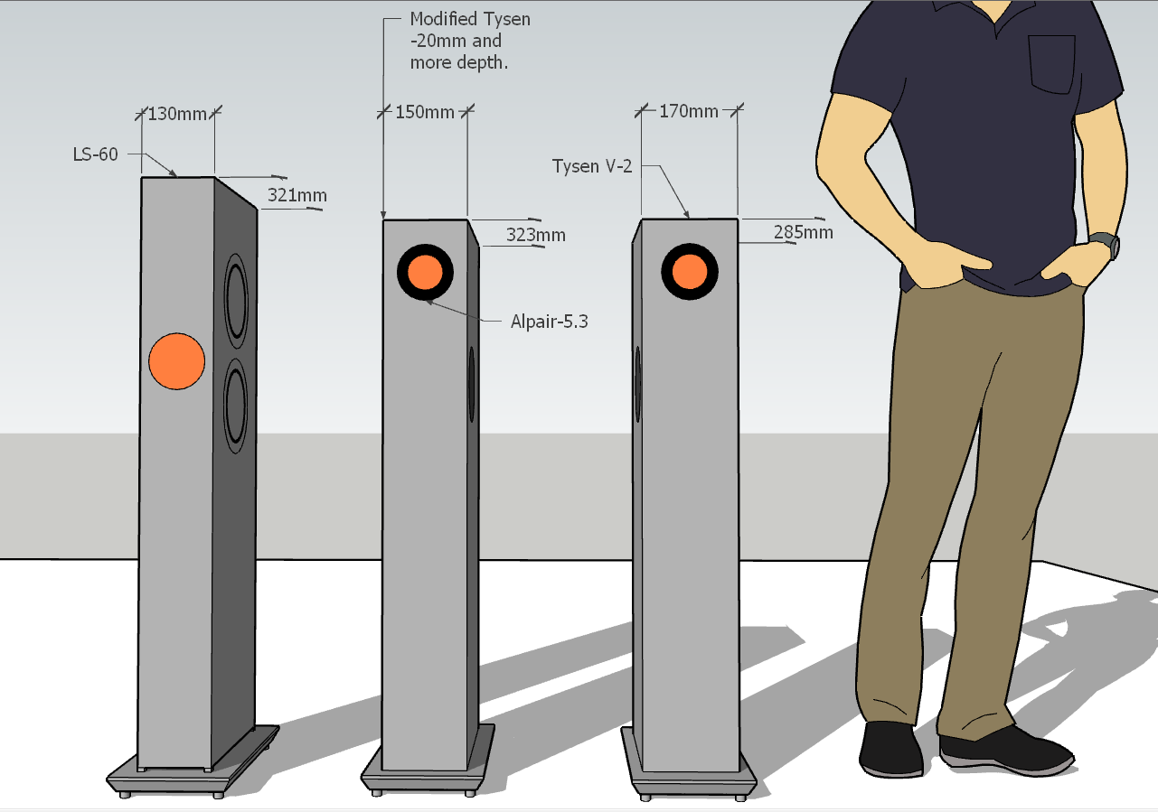

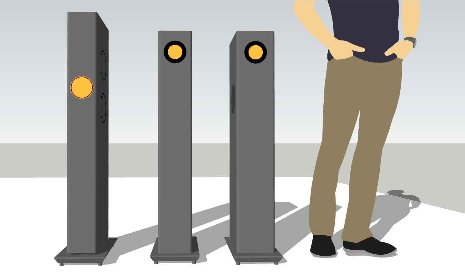

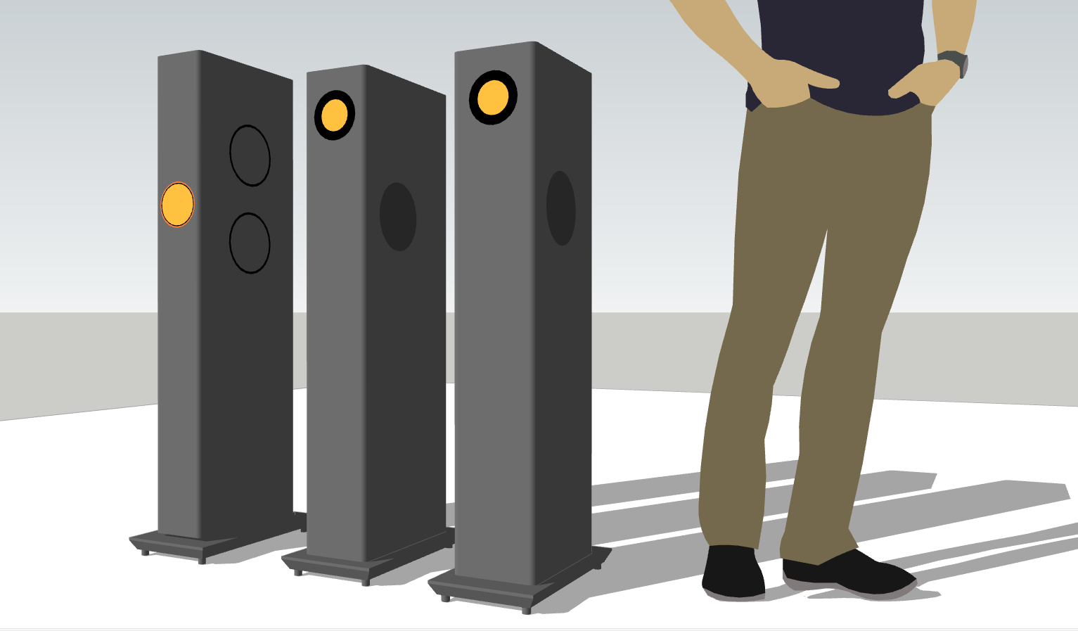

With Navin's proyect of Kef Blade speaker style starts my interest for the Tyson V2, I make some drawings with 2cm. thinner.
Just waitin for answer to my email from Dave to see if its possible and start cutting wood.
