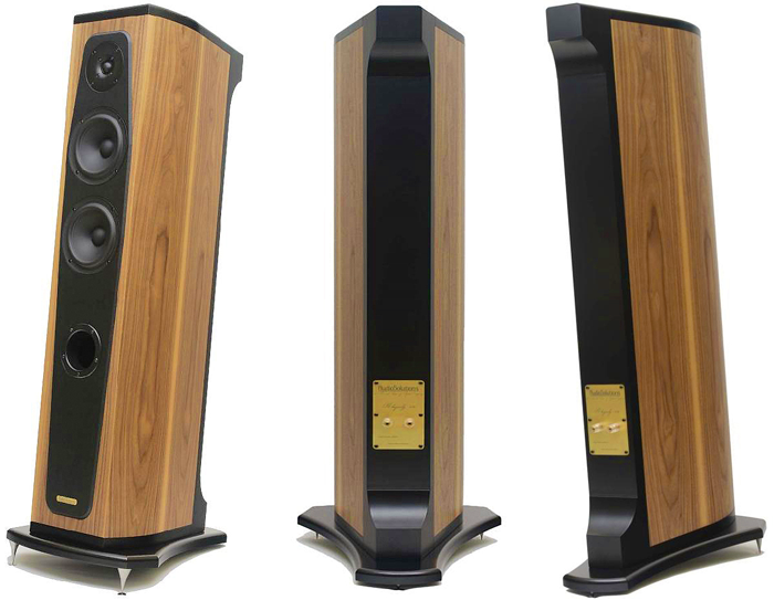

Really? I tend to find a pair of adjustable spikes under the front of a box makes it very easy to adjust the tilt on floorstanders, but YMMV as always.
Yes, of course, but I'd rather not resort to ungainly solutions like tilting spikes (sorry, I want a really SAF-friendly build this time, with me being a bit more of a stickler for looks than the S in question
So, my questions are as follows: is the Pensil 11 good to listen to from a slightly off-axis position in the vertical plane and do the benefits of going for the resonant air coupler over the bass reflex outweigh the drawbacks (cost, slight vertical difference)?
Sorry for bothering you so much!
Yes, of course, but I'd rather not resort to ungainly solutions like tilting spikes (sorry, I want a really SAF-friendly build this time, with me being a bit more of a stickler for looks than the S in question).
Fair enough; I can't say I find it ungainly myself, assuming it was designed with that in mind, but to aesthetics is a personal thing, and I'm not known for my artistic taste. Audio Solutions do this with some of their speakers, e.g. the attached, which is a bit more than I like, but could be worse.
