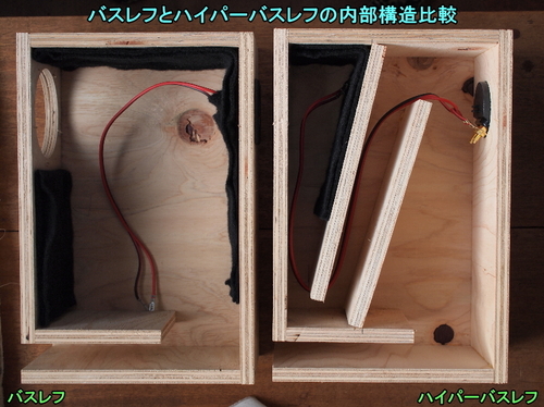

What is "hyper bass reflex"? The second design.Pluvia phd7, seems like the paper version for the pluvia.

![Hyper-BR-constraction-01-thumbnail2.jpg](/community/proxy.php?image=http%3A%2F%2Fpavane.sakura.ne.jp%2Fsblo_files%2Feco-speaker%2Fimage%2FHyper-BR-constraction-01-thumbnail2.jpg&hash=249ce833e445614d122e7722ac89574d)
Google translate says:
Features of the hyper bass-reflex system
① The sound vector (directionality) is located between the bass reflex system and the back load system ② The complex motion type has a simple structure and can be made relatively small ③ By adopting the back load element in the bass reflex system, Bass reflex of the same size can be efficiently drawn ④ The same size bass reflex, it can not be obtained with a sealed sound, it can produce a sense of scale ⑤ Because it is suppressing the movement of the cone by multiplying the hybrid braking, the power enters ⑥ Two partition boards Is entered diagonally, the characteristic aberration and the standing wave are suppressed, and the minimum required sound absorbing material is sufficient
End loaded air cavity will act as a low pass filter into a short 2-section expanding pipe, then mass-loaded.
seems like some kind of MLTL, in ths case an expanding TL.
