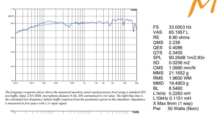

The +5db above 5khz on the (very) smoothed graph wouldn't bother my older ears.
Looks very interesting for those needing a larger driver...................
https://www.markaudio.com/wp-conten...AL-25-Jul-2024-50-cm-measurement-distance.pdf

The SD is >2x of the Alpair 10 drivers; I am expecting that in a well designed cabinet this driver will deliver low frequency output that will be satisfactory to a large part of the wide-band single driver enthusiast community. The increased SD hopefully will give a greater perception of "slam" that can be more limited with drivers with smaller cone are.
The peaks above 5KHz - it would be interesting to hear from early adopters how it sounds a little off-axis, or if a notch filter helps.
That flat impedance should make for an easy 6db crossover, or even baffle step also.
Seems a pricey option for a 2 way….
Then again, just cause it seems to measure all the way up there, may not mean it sounds good trying to do up there…….
