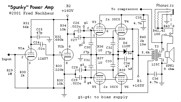

A screen grid bypass cap is essential in most small-signal pentode circuits. Here, the g4 dropper resistor is usually a huge value (hundreds of kiloohms), and a bypass cap is mandatory.Don't forget the bypass cap on the screen resistor.
But, from what I've seen, the bypass cap seems to frequently be omitted in guitar amp output stages. In these, the screen grid dropper resistor has such a low value that it only introduces a tiny bit of negative feedback, and no bypass capacitor is needed or used.
I've seen exceptions, but they seem to be in the minority. The amp I designed and partially described in the "100 buck amp challenge" does actually use a screen grid bypass cap in the output stage. So does the late Fred Nachbaur's "Spunky" amp (schematic attached), which also uses a zener diode to stabilize the screen grid voltage.

Some Results- and more confusion
So... on a completely different topic than what has been recently mentioned... Got some results.
I installed the smaller screen resistor in my amplifier (500 ohm) and It raised the power substantially. I then experimented with the bypass cap on the screen. With the same input, I got output powers of
With Bypass cap - 5.4W
Without - 5.1W
Either way, they pass my requirements, so thats awesome. I assume adding the bypass cap gets me a little more power because B+ is bouncing around a bit as the current drawn by the tube varies, and therefore the screen voltage does too. As it drops, the power output does too, slightly.
Because of the feedback, however, the Harmonic distortion is lower without the bypass cap.
I then came across another strange issue: The oscillations returned with high preamp gain. I am reposting my schematic because it will be easy to reference places on it.
I used the scope to start looking for where the oscillation comes from. I started where the "1" is marked on the schematic, and it turned out that the oscillations were detectable there. The frequency is 3.3 Hz, and it is always that, hardly any variation. I also noticed that the oscillations need to be kicked off with some input, such as a strum on the guitar. If the gain pot is turned down enough, the sinusoid gets damped out in a cycle or two, but with the pot turned up, the oscillation is not damped out.
Now, to the reason the oscillations stopped before. It turns out the node marked "2" in the tone circuit was shorted to ground. So I shorted it to ground again with a clip. No oscillations.
You can take the clip off, set off the oscillations, and then put the clip back on, and the oscillations immediately stop. Considering the tone stack follows the second valve, I find it strange that the oscillations are apparent back at point "1".
Now obviously the overall preamp gain is considerably less with node 2 shorted, as the load is significantly lower impedance. But does the load have any effect on capacitance on the grid? I'm trying to figure out why node 1 oscillates. And it isn't that the oscillations are there all the time, but filtered out when node 2 is grounded. They disappear on node 1 when node 2 is grounded.
Do you think I am being bitten by feedback and variations on the B+2? I have a single bypass capacitor for all the preamp tubes. It seems like a controversial question, so I am almost afraid to ask, but do I need to make v1.2 into a cathode follower? Maybe change the decoupling capacitor to reject 3.3Hz?
Honestly, I like the way it sounds with node 2 grounded. The amp has a good tone and is great to play, maybe slightly heavy on the highs, good level of distortion with the preamp cranked, clean when you back off, but I said I would build a tone control, so I would like to get this working, or it won't look good on me.
Without - 5.1W
Thanks,
-Kevin
Also, clearly I can approximate the accidental short by turning P5 and P6 so they are shorted. Starting with them shorted, and applying a muted strum input for an "impulse". With node 2 grounded, I see on the scope, essentially and impulse. As I start to raise the pots, The time constant for the oscillation increases.
Reading up on this and thinking a little more, I am starting to think it is feedback through the B+. 2 amplifier stages for about 360 degrees of phase shift, feeding back, definitely would cause oscillation. And the level of the feedback is likely not high enough when the gain of the second stage is reduced to cause a problem.
Does this answer sound about right? I am going to try adding another dropping resistor to the B+ and another cap to filter the feedback out and kill the problem.
