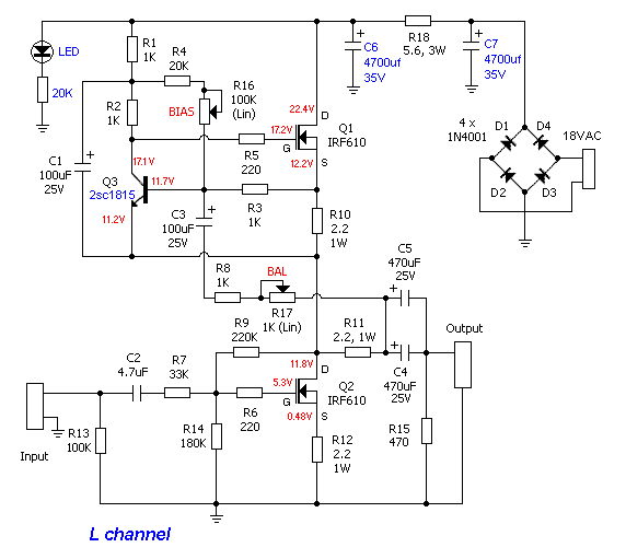

C2 voltage value?
I just picked up two of these boards from another member on the forum. How critical is the voltage value in this circuit?
Can I get by safely with 50V? At first blush, the C6 and C7 caps are rated for 50 volts, so why 63V to 100V ratings? Was it just expediency at the time? Thanks in advance!
