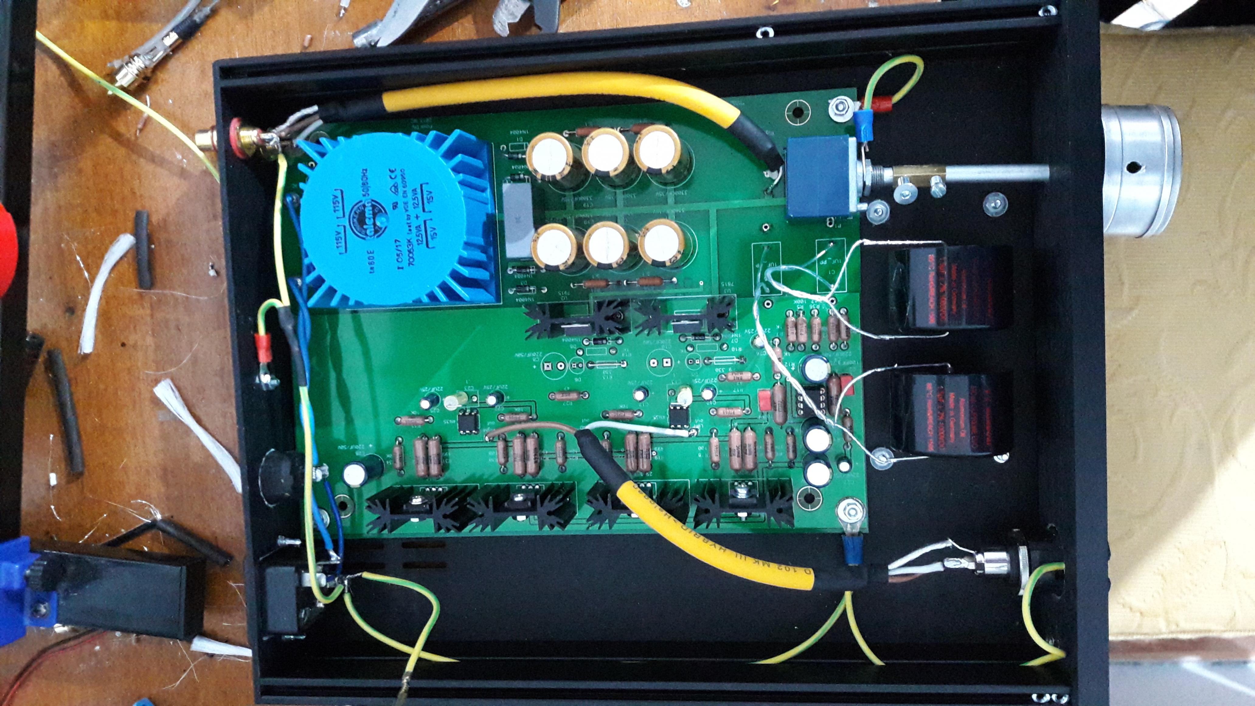

In a pin of the c7 there was no contact between the tracks in the two sides of the pcb, being a double layer probably the pond had not passed into the hole, then using a shielded cable and connecting all sides of the enclosure to ground I solved all the buzzing problems

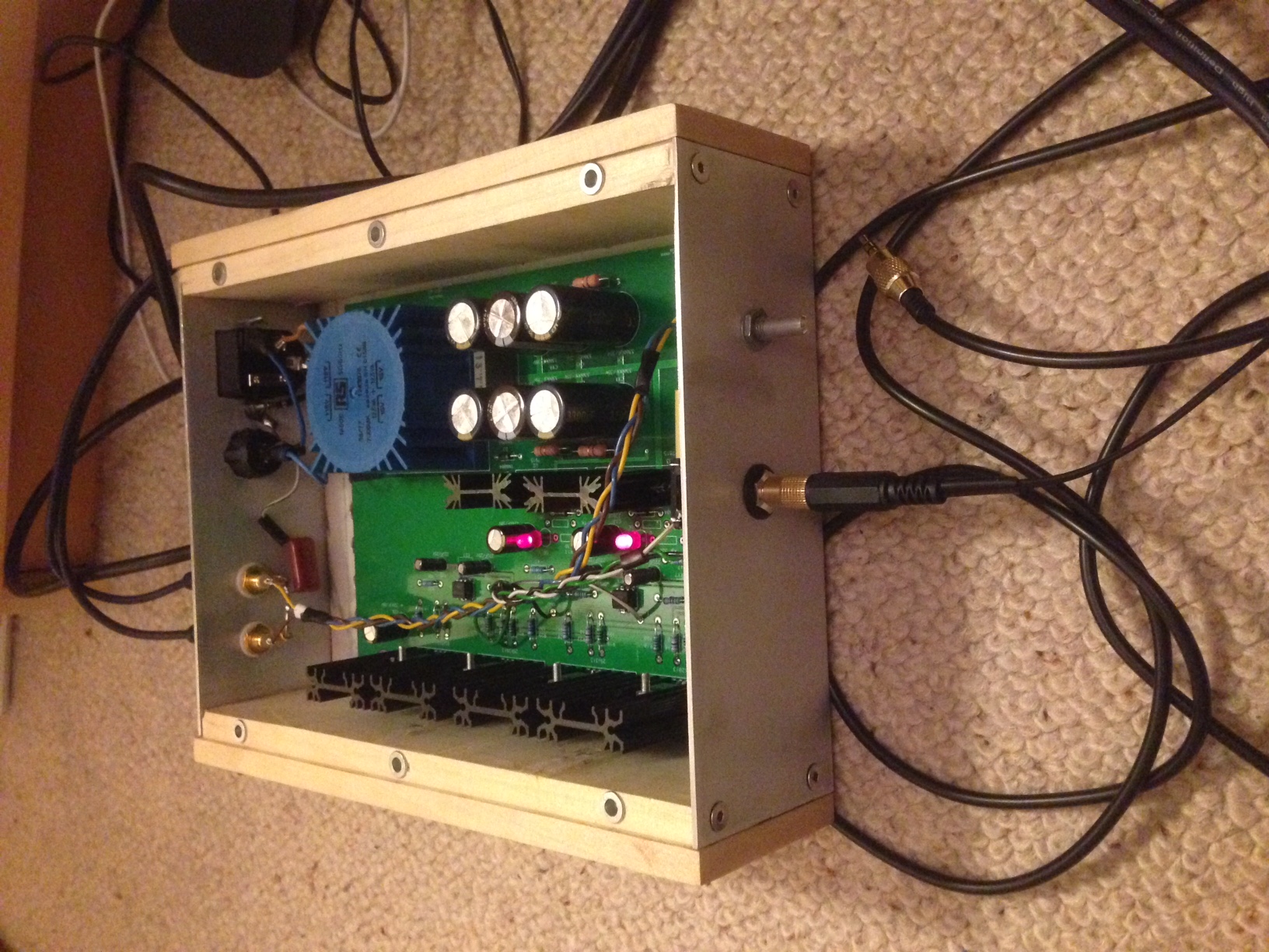

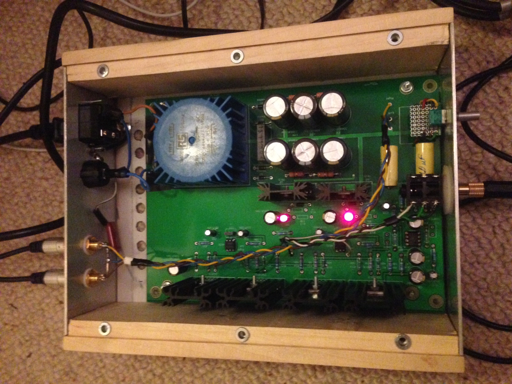

Looking at the finished assembly, it looks like it could have been designed to be mounted with the board rotated anticlockwise by 90* - the volume pot could have an extension shaft and be mounted off-board except the o/p transistor heatsink is in the way - maybe lay this down or cut a groove thru it - maybe on the next version?
It's surprising to see the long tracks between the input IC and the Left (on the photo) output stage, but it obviously doesn't affect the amp's operation or stability ...
What are the vertical axial caps next to the opto ICs?
Thanks for looking. Axial Cap is vishayLooking at the finished assembly, it looks like it could have been designed to be mounted with the board rotated anticlockwise by 90* - the volume pot could have an extension shaft and be mounted off-board except the o/p transistor heatsink is in the way - maybe lay this down or cut a groove thru it - maybe on the next version?

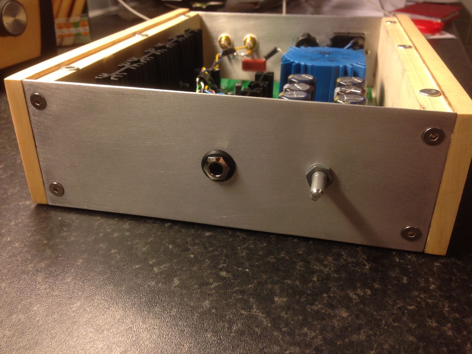

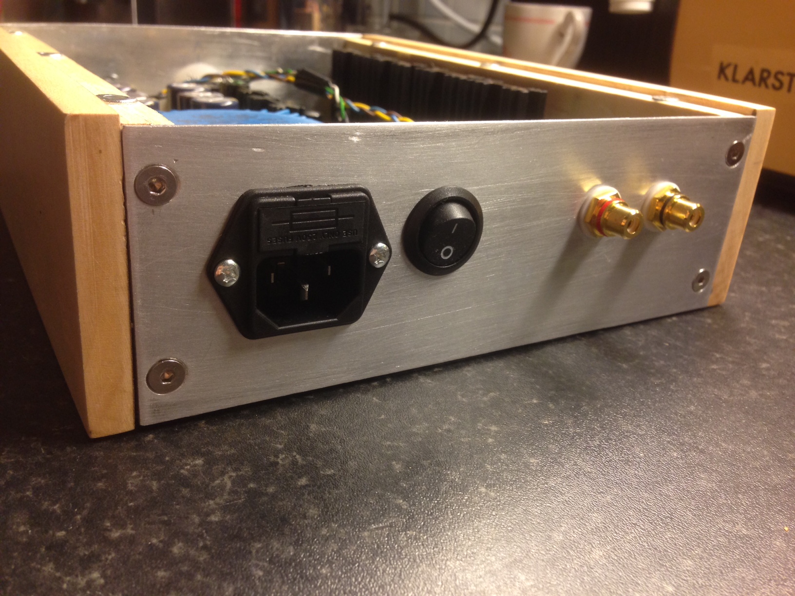

Finished today (I've spent almost the whole day in a cold conservatory in order not to have have to clean my electronics mess in the kitchen for the meals).
Op amp ne5532 for now. I have lm4562 ready for this one (never listened to it in anything). I've ran out of loose Opa2134, but I will take one from c'moy as well.
First tried with some test phones (they survived), then with Senn PX100 (also survived), now listening through Senn HD595 ;-)
First impression: very nice amp! Very quiet. Somehow I never managed to get rid of some hum in my Marcello's Zen HPA (all deficiencies are my fault, not designer's).
Thanks to Wayne!!!
