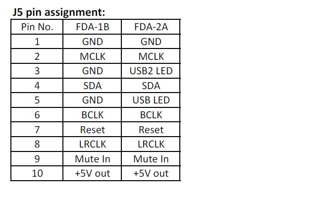

Short pin 1 and pin 2 of J1 to pin 3 (ground) to have default = (0,0) or I2S as input from J5. Short R171 to un-mute the I2S input or use the pin 9 of J5 to control the mute from external source. Mute is active High.

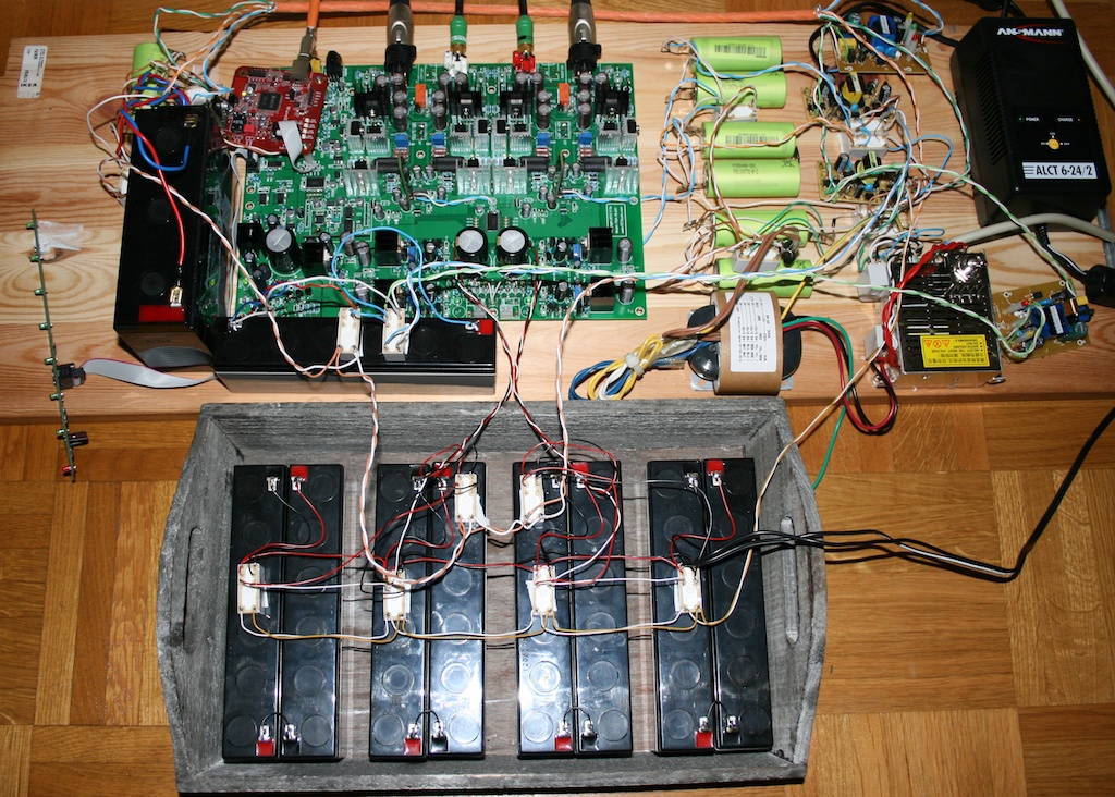

Hi folks,
i was very impressed of the dynamics of this DAC from very beginning, but the sound was after a short time of listening fatiguating. I´ve changed the i/v resistors with dale resistors and PIO capacitors K40Y-9. This was better but not enough. I decided to try batteries.
These are the changes:
- OCL! all output caps shorted, DC offset adjusted to 0mV
- analog supply PCM1794A - two separate belleson +5v reg with LiFePO 2x3,3v
- digital supply PCM1794A - two separate LiFePO @3,3v
- a huge improvement in sound was the battery supply for the discrete IV! 4x24v lead-acid batteries
- 12v lead-acid for the receiver
The WaveIO USB receiver (XMOS) i´m using is also fed with 6v lead-acid and a 2A-5V belleson reg. The onboard isolator with 3,3v LiFePO
The change is huge! It´s another DAC! It´s not fatiguating at all, it has tremendous dynamic and the treble is not so "hi-fi" like. Bass is very, very controlled and deep. It´s maybe the best DAC i´ve heard for a long time!
Give it a try!

Pin 3 is also an input pin for FDA-2. Pin 3 can be short to ground using R97 (default become 0 = ground).
When R97 is shorted, then short R107 and open R106 to have same function as FDA-1B.
FDA-2 is more flexible to have 5 input or 4 input and thus jumper(or resistors) need to be set properly. Of course a new control board is required.
