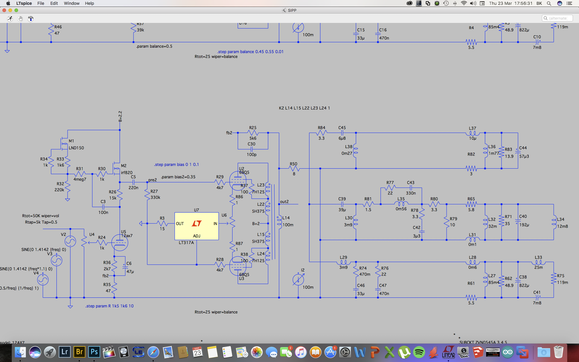

There is a self-inverting PP amp that you could investigate. You could use one 21AX7 to drive 2 channels with no inverter. The outputs are configured to drive one tube via the cathode signal.
Thanks for your suggestion. I investigated the SIPP and designed something like an odd block with EL84's and a hybrid ecc83 mu-follower in the front. It was a nice exercise, but the gain of the output pair dropped to half of what it is when using a dedicated phase splitter while still keeping the same bias point. It seems to me that efficiency and output power must drop to half too. Driving EL84's with more than 12V leads to grid conduction in the output tubes. Serious limitations if you ask me. 15 or so watts is enough, but I wouldn't go lower.
On a side note: distortion in the output of a SIPP seems high. Maybe I'm just doing/simulating it wrong, so correct me in that case.

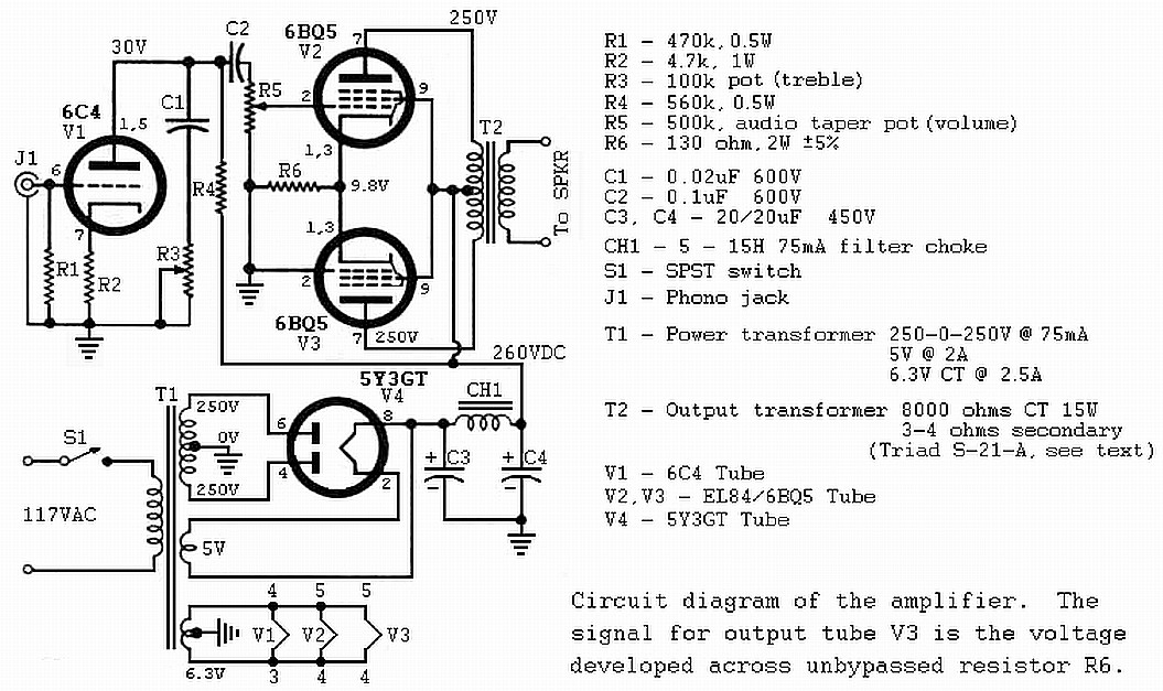

It doesn't have to be that complicated. This is the idea for a starting point I'm working on. But I'll use a 12ax7 and eliminate the EQ and volume control components and add a GNFB circuit, and build it stereo. The bias is set depending on the plate voltage and power dissipation. The drive signal stays under bias voltage. Not sure why you have a concern about grid current. Just don't overdrive it.

> grid current starts to occur when the output stage delivers half the power when compared to driving the same tubes from a cathodyne or ltp. Ergo: output power must be limited too
No. You have to apply twice the drive voltage.
If each push-pull EL84 needs 10V peak, the self-split will need 20V peak. (Still not in grid current.)
However if "distortion" is of interest, the self-split is generally not the best path.
Fisher got fine hi-fi performance with a dual-triode and a team of 7189 (hi-spec EL84). The '84 has so much gain I am not sure you really want a pentode voltage stage or fancy loading on the gain stage. As you see, high total gain makes stability problematic.
Not a too big surprise. As in every LTP, in SIPP the cathodes are on a signal level of half the input signal, so voltage gain is halved, too.
