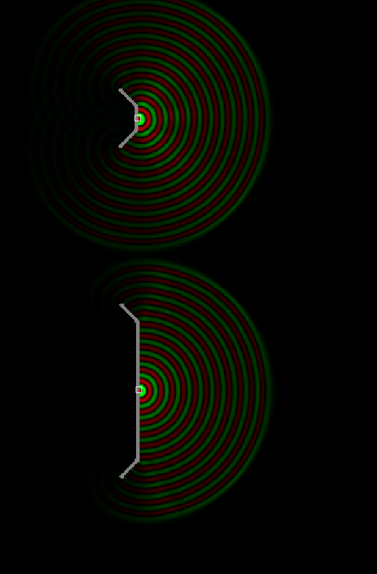

There are proponents who say that a larger flat baffle area around the tweeter delays the diffraction events, increasing their angle to the listener and rearranging their polars.The current "best practice" for a non-waveguide tweeter is to (1) make the baffle around the tweeter as small as possible,
What is not often said is that it allows clean establishment of more of the overall radiation, meaning that less of it sees the edge and gets diffracted. In addition you gain control for it to be more narrow. As there is some frequency dependence, there are factors to analyse case by case.
Here is an example of the narrower baffle having greater higher order mode coverage.

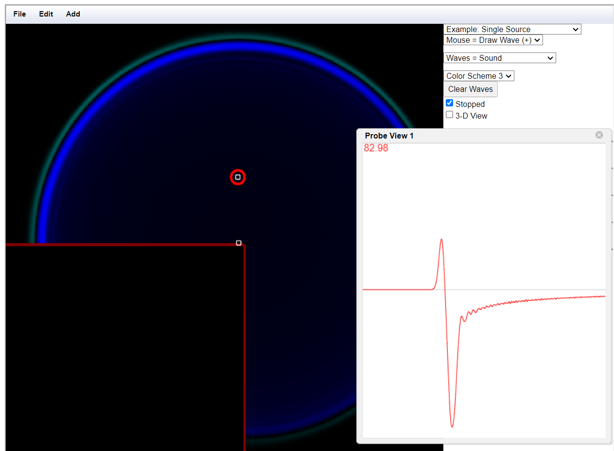

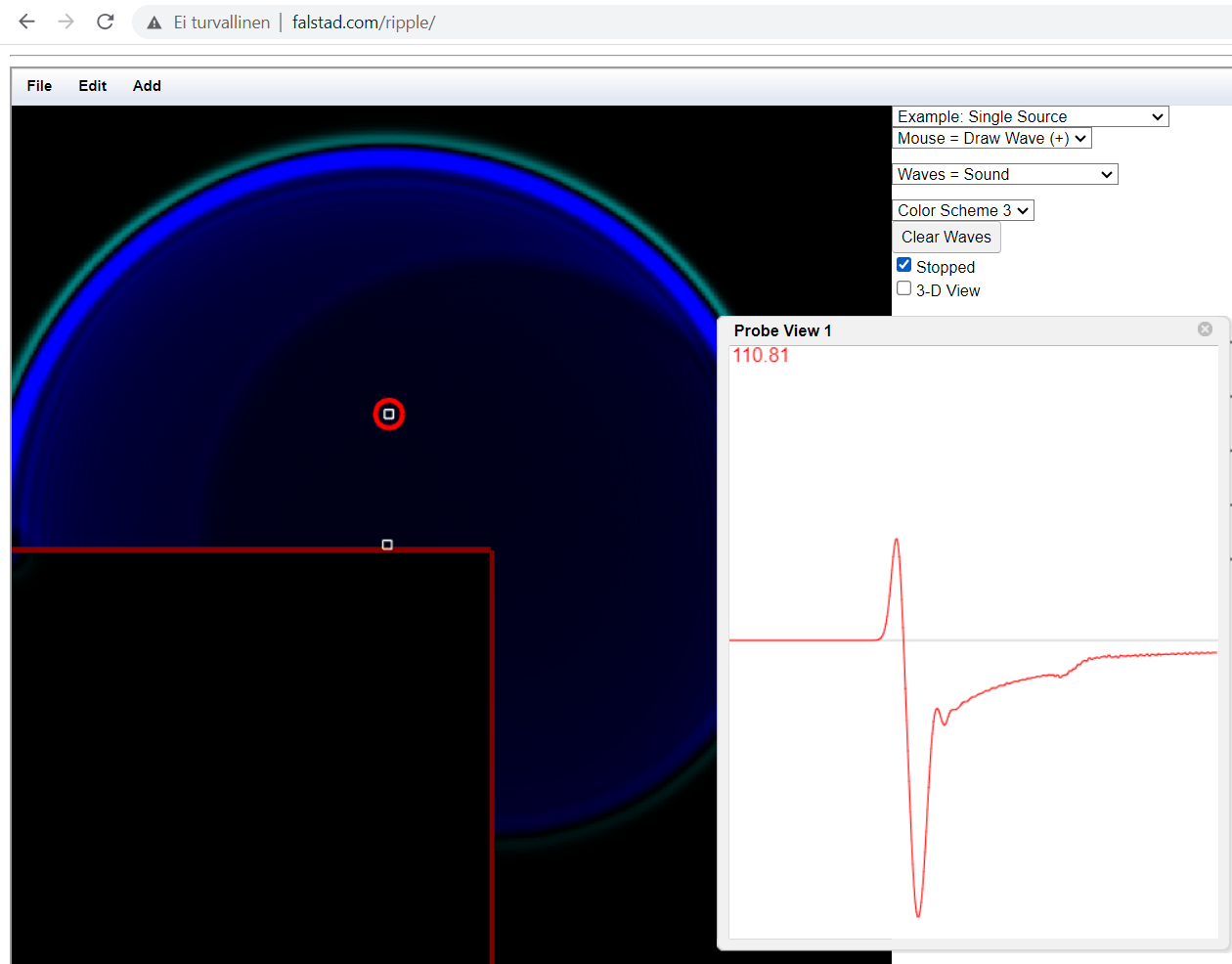

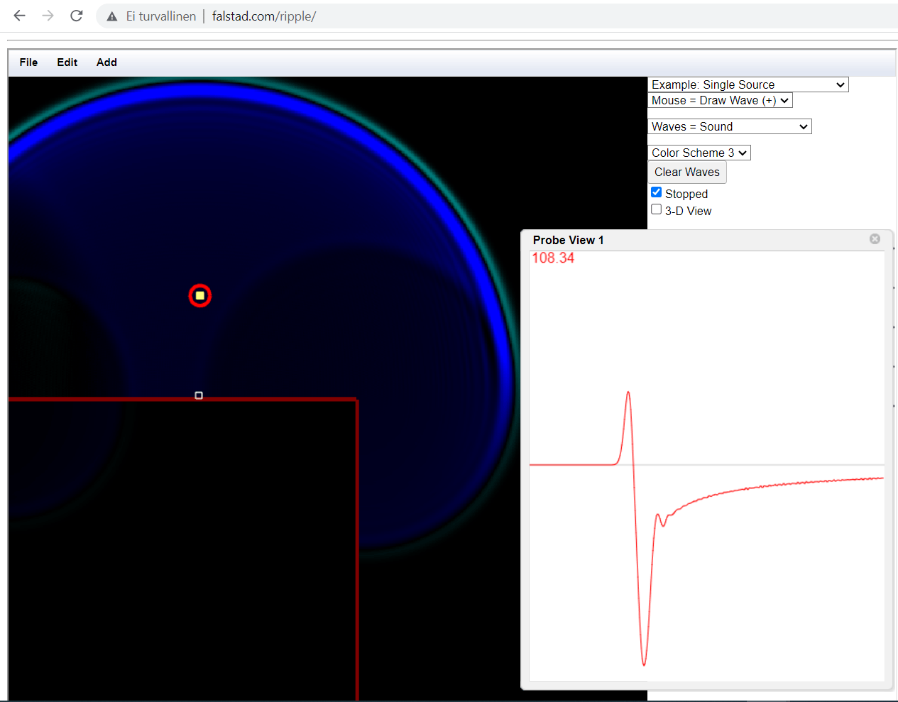

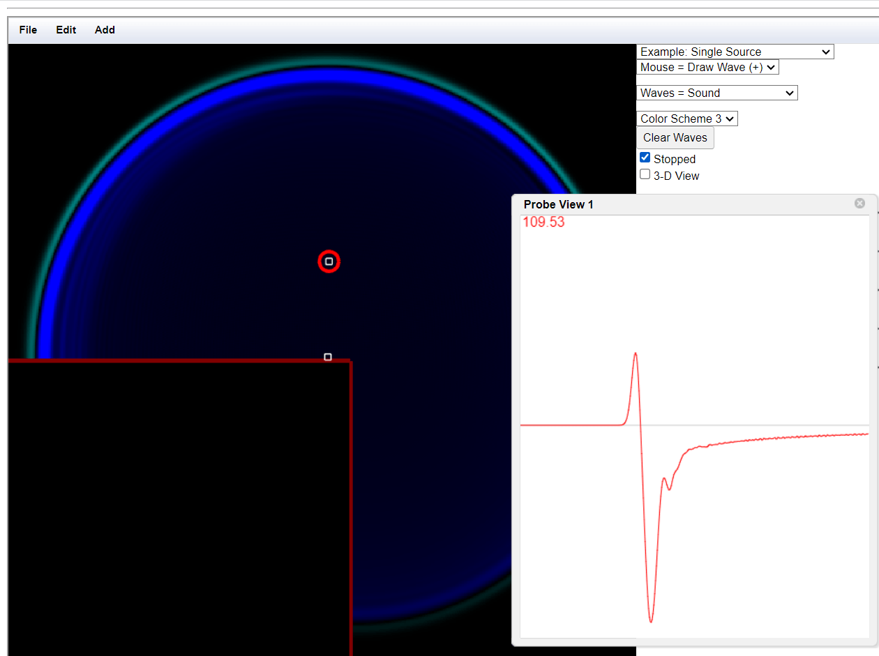

AllenB I think I see your point, when the edge is far enough the pristine direct sound has made the audio impression before the secondary sound of the edge arrives. I'm not sure how brain processes the stuff it and what is the time interval required and so on.
Here is ripple tank sim , when the edge is close, the impulse itself is changed, unless its very close, or very far.
![at-the-edge.png at-the-edge.png](https://www.diyaudio.com/community/data/attachments/1090/1090934-605dd2a8c7a92f1a7ec44284d2774f04.jpg)
![farther-1.png farther-1.png](https://www.diyaudio.com/community/data/attachments/1090/1090933-06860946c9a0d106b4d0b8d70646658d.jpg)
![farther-2.png farther-2.png](https://www.diyaudio.com/community/data/attachments/1090/1090932-155133093b6175012e75faa4d98ffaa1.jpg)
![farther-3.png farther-3.png](https://www.diyaudio.com/community/data/attachments/1090/1090931-7c919f1126d357fb8f3af7ffdfd09098.jpg)
![farther-4.png farther-4.png](https://www.diyaudio.com/community/data/attachments/1090/1090930-b17bd6af1774962e98e79c405719459f.jpg)
