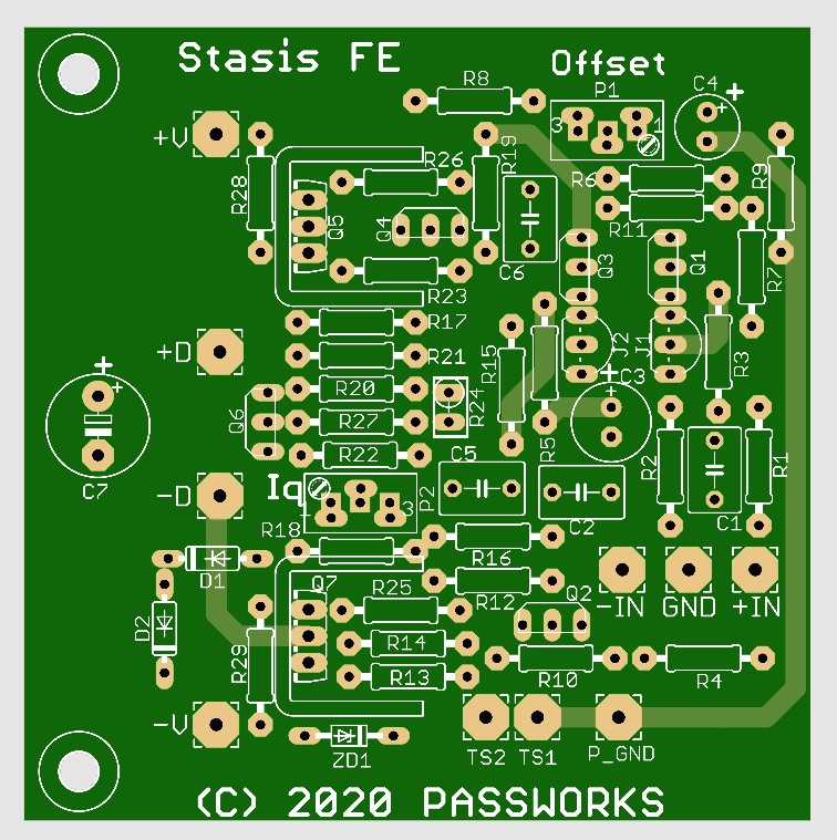

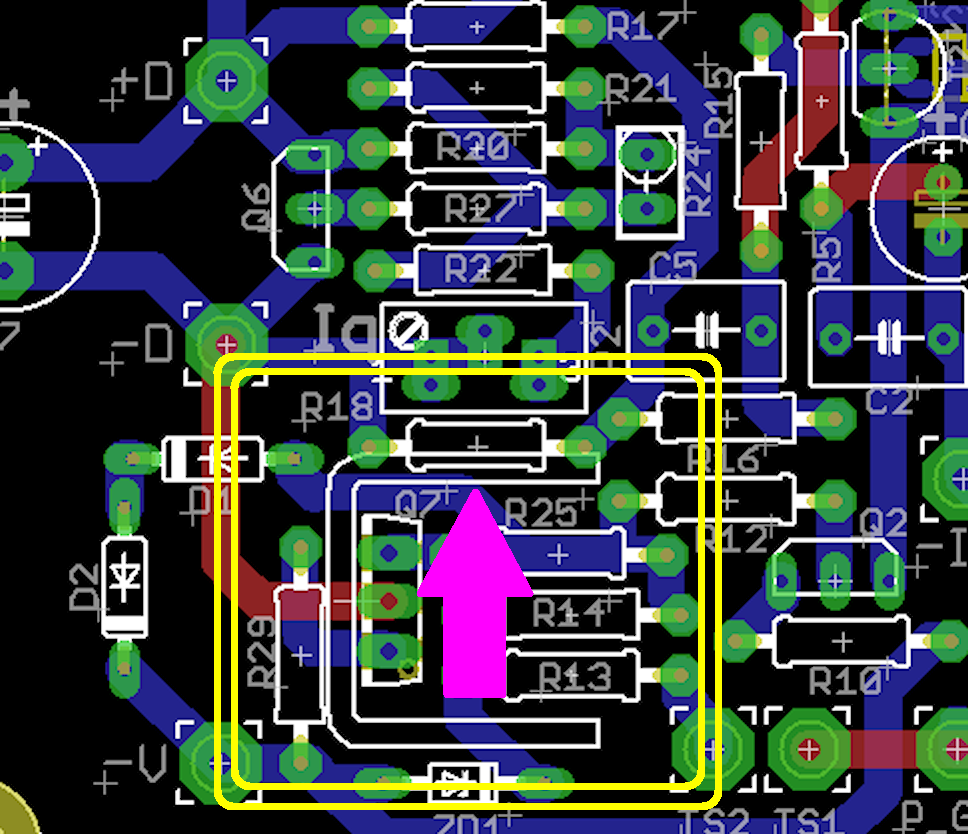

as intended by Might Moi - heatsink is not pcb mounted, free mounted on puny critter, pins not fully seated in pcb
so, as I imagined, clearance there is at least 5mm
cunning plan is that builder needs to have brain engaged for most of the build
with T0220, I'm starting to worry about proper chunky size mounted and fixed heatsink at double dissipation (here less than 1W)
if thinking about my clumsiness during assembly and work, so unintentional brush on part with free mounted heatsink - lets just be more cautios
or, to avoid that - bigger pcb, care about traces beneath heatsink strictly routed at copper side etc etc
of course , when mounting fixed on pcb, some plastic spacers between sink and pcb are always cunning (again) to implement ...... had enough cases (in my service praxis) with scratched pcb stop lack, making all sorts of unexpected problems
so, when routing a pcb, I'm always taking in account worst case dumb move I can make in future; besides putting two same sex parts in complementary pair position, there are plenty of ookups I'm capable of
enclosed example of proper heatsinking of puny parts, just for giggle

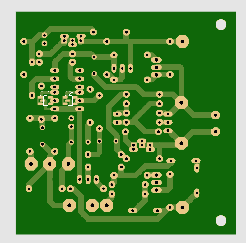

Q7-to-R18 overlap is frightening
so, it was welcome nudge
enclosed results

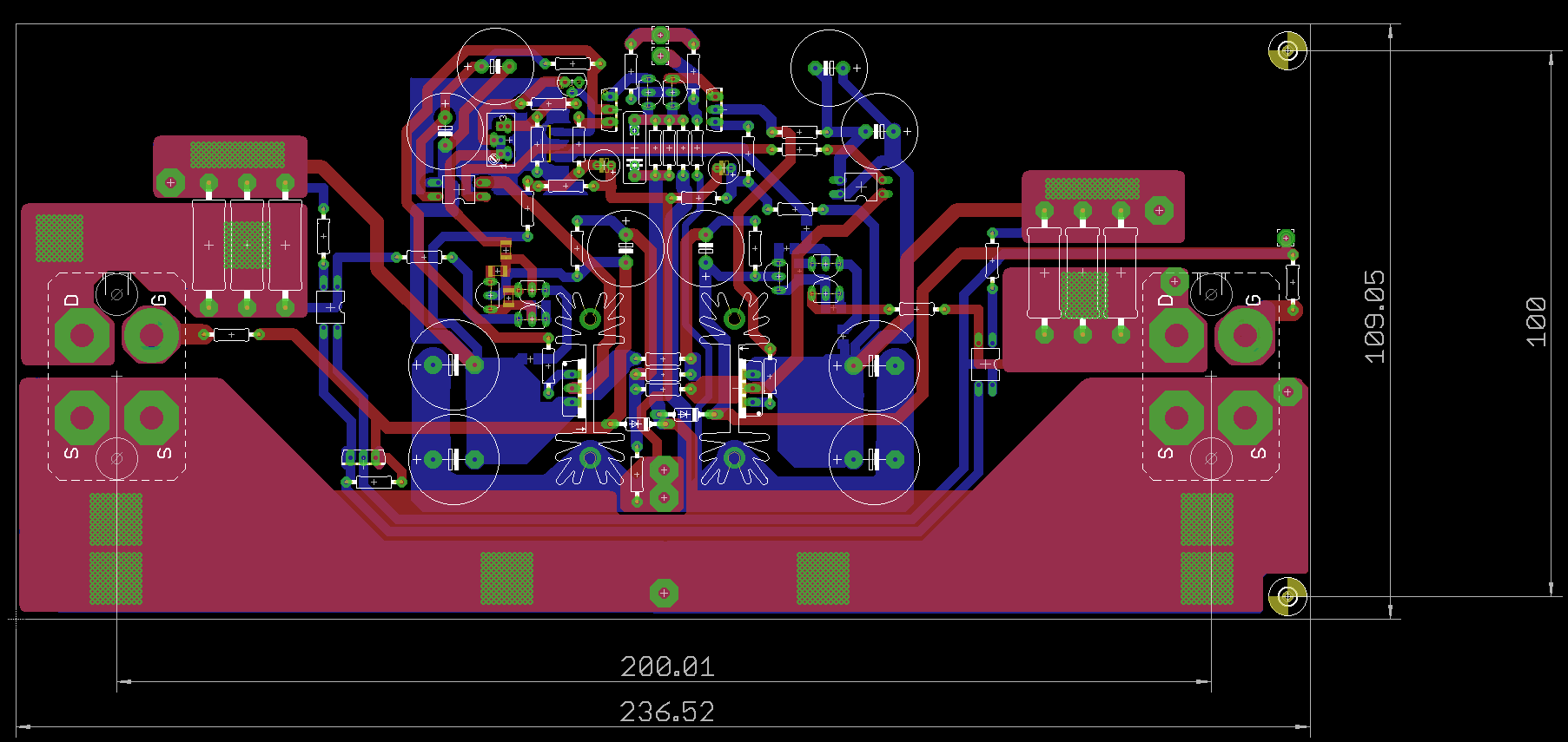

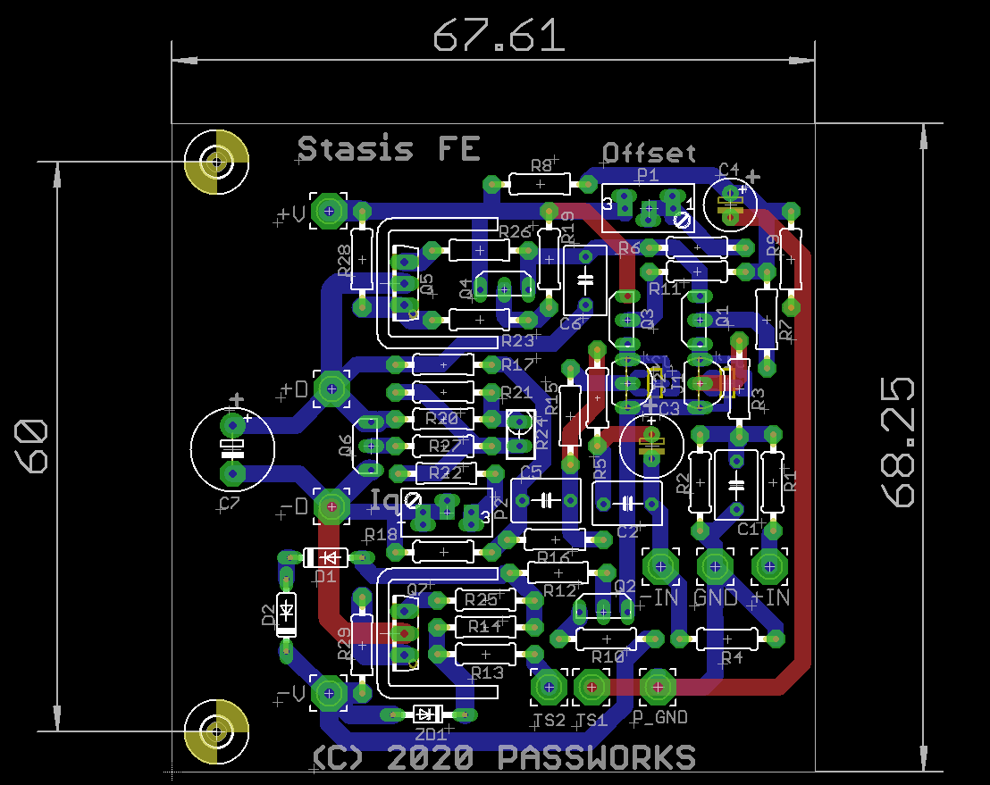

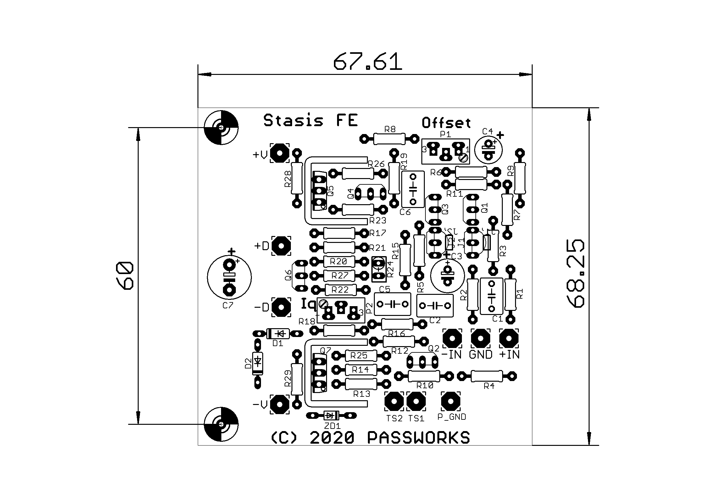

Your FE board in post #250 looks great to me ZM, I also like the idea that Mark came up with to mount it on the OS board with a couple of standoffs and very short signal connections between the 2 boards. So this FE board and the 7+1 OS board in your post #232 look like an ideal set up - has my vote for what I want to build. As a back up though I have ordered papa's FE board as well from post #1.
When and papa are happy with it all, then you can post new gerbers and away we go - but no hurry. Do you intend to test your new FE pcb design first I wonder.
Cool Stasis FE pcb gerbers is ready available in post # 1
Thanks to the One and only Mr. PassWork
Could be possibe share pcb Stasis archive gerbers of the power output stage ready made in the past?
Updated DIY Stasis version post #1 nominal specyfications are ? Thanks and Kind regards
Look at post # 1 two stages FE and OS have ready short connections..very short signal connections between the 2 boards.
Well if one uses say a 10mm board spacer between the 2 boards, then those connections will be 10mm long, using say a piece of tinned copper wire link. When you look at ZM,s 2 layouts the lands for those connections line up with each other. One can use what ever spacer length they like, to make sure the components mounted on the OS pcb have clearance from the FE board.
