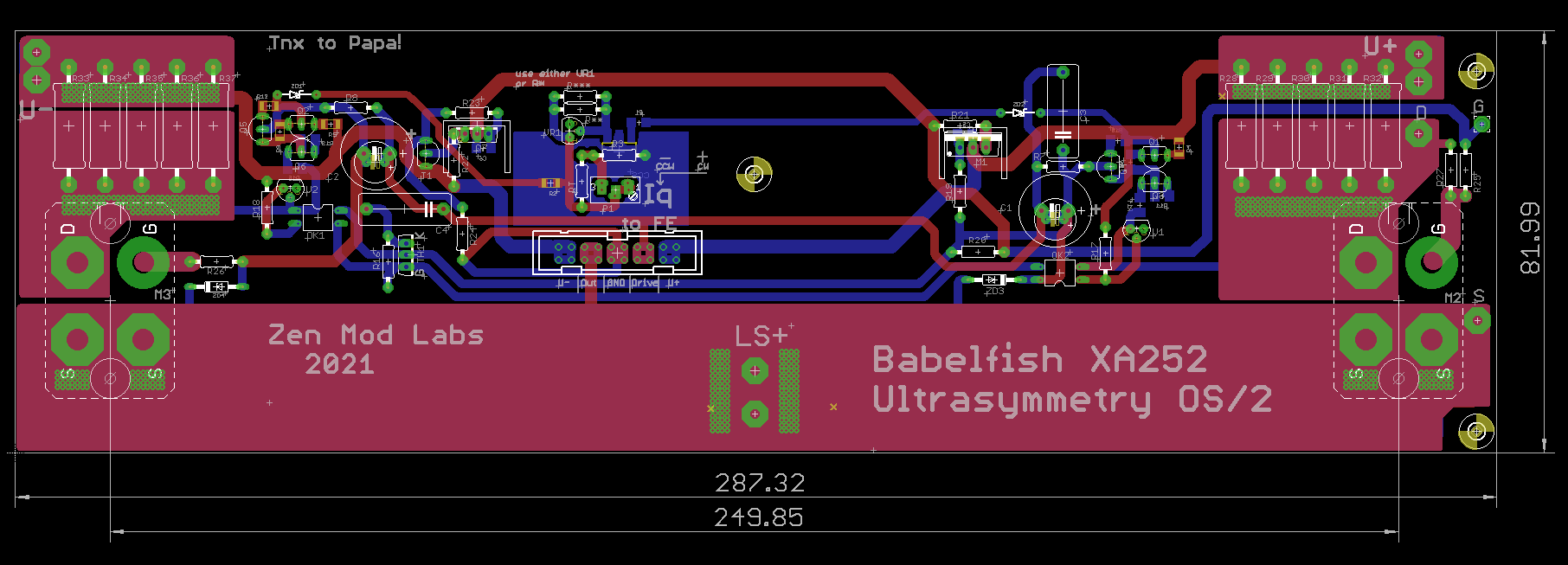

for me, it's trivial to make - just arranging appropriate pcb for Babelfish XA252 OS
in fact, I already have them, prepared for (future) work on bridged/Ultrasymmetry/FluxCap/42 Babelfish XA252
but, dropped down on priority list
just for your amusement, Eagle sshot, don't have pics of pcbs on shelf ......

So what is this FluxCap/42 stuff about? Would it still be able to be set up as SET or SIT with the SUSY? That could be interesting on some nice panel speakers.FluxCap/42 Babelfish XA252
if you observe Eagle sshot closer, there are all parts needed for level shifter mosfet follower, same as additional pads for connection of outboard SIT, and additional mounting holes - needed on right side when SIT is used instead of mosfet puck
what should be outcome - lower power in some amount, vs. straight mos
