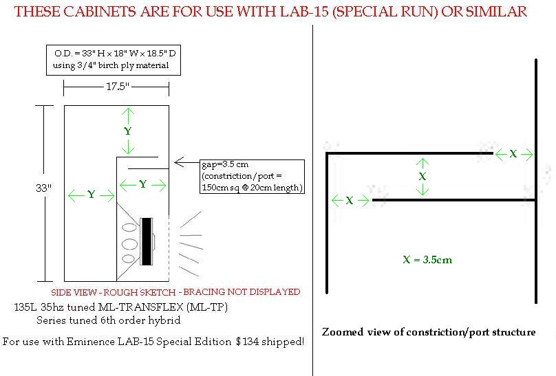

Here is another sketch with some more explanation and details of measurements on the ML-TRANSFLEX for the Eminence 15 (special run) ...
I think i might arrange version 2 of the 50 liter cabinet for the Alpines in this same manner, with the constriction/port placed at the top right of the internal divider/baffle panel ... The cab sims a little better that way, and gives us slightly more path length while only increasing the total cab size by a few liters... This arrangement is also more likely to place any additional bandpass resonance (developed by the small chamber being energized from rear of the cone) closer to where it is needed which will be between the 3rd and 5th harmonic of the box's main pipe resonance...

Thank you - I printed your prior version and wrote in the dimensions.
BTW - your new version looks much nicer than my hand-annotated version.
Again, I appreciate your efforts.

how does this special lab 15 sim bottom exit and enclosed side?
Captain! The "end-firing" version sims close enough to the same, and should work just as well, FB might shift down slightly , and you would probably want to use an access panel with that arrangement ..

The special edition Eminence Lab 15 works in a 135 liter version of that same design ...

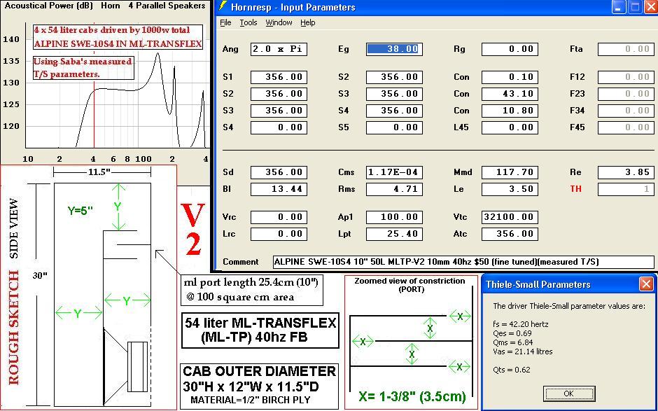

NEW VERSION OF THE ML-TRANSFLEX 10S4 BOX !
Here is the fully updated 40hz ML-TRANSFLEX version 2 for the Alpine SWE-10S4.
Enough "splitting hairs" for now ... I think i am satisfied for the moment with this Box's level of fine tuning ..
- I moved the constriction up the path some, and i extended the total path as well by a small amount.
- Added a few more inches of height. Shaved off a little depth. The added internal airspace amounts to 4 more liters in this version, but a flatter response with a little more output are gained from these changes so it is a worthwhile compromise in my opinion.
- Better damping (less "saddle" and also less peak at FB. These improvements often associated with reduced group delay means a more natural sounding roll-off on the bottom end).
- There is more detail in the sketches now and the proportions are more accurate.
- Simplified Hornresponse inputs by removing an unnecessary segment.

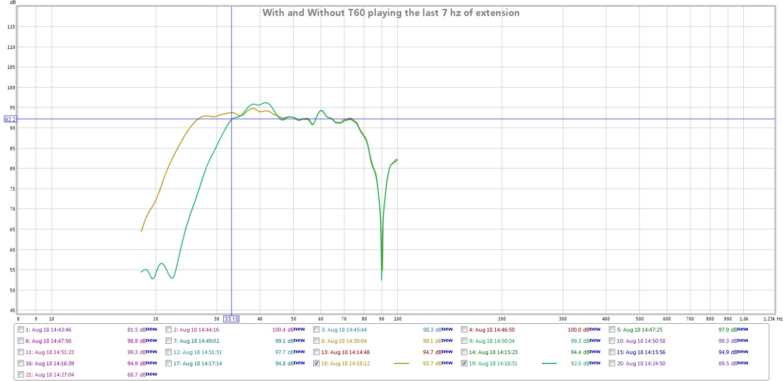

Also, ran some frequency response measurements and here is the "tamed" frequency response of "just ML-TP" and ML-TP + T60 where the T60 is LP at 32 Hz keeping it's standard HP of 25 to blend in with the TP. It'll make more sense looking at the picture .
I didn't boost the low end at all and in fact my room required a 10 dB cut at 43 Hz (room resonance). Ignore the crazy dip at 90 that's also room as verified by my running a sweep with my T60 running full bandwidth (which has a naturally rising response) and it showed the same massive dive so clearly it's a room issue.
